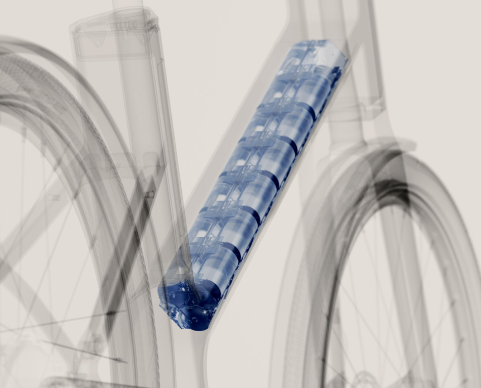

At the time we mocked energy recovery systems because generally on an EMTB there isn't the mass to recover the energy efficiently as there is with a car.
However, for the last 7 years a French company has been working on this and combining it with super capacitors.
Their first bike, available next year, has a small - approximately 50wh battery (650g), which can be charged with USB C in 1.5 hours. This is combined with the Super Capacitor and will theoretically give you a range of 30-70km's. Their bike is hub motored, but also has conventional SRAM brakes so I'm not sure how the energy recovery is working, presumably there's some sensors on the brake levers and the energy recovery kicks in first.
"The other advantage of supercapacitors is ecological. Durable, they are capable of lasting at least 15 years according to Anod. They also do not use rare earths or lithium and are only made of aluminum (100% recyclable) and coal. An appreciable environmental impact."
"However, this technology cannot store energy for a long time, and finds its limits at the start of a journey or on terrain with very low elevation."
