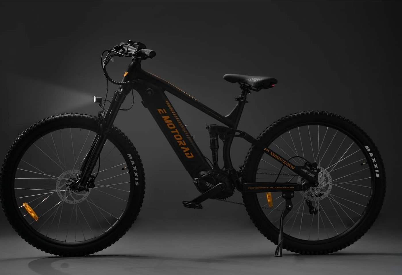

I recently bought a 2023 EMotorad Athena. It comes with a Bafang M600 motor and was surprised that it is limited to a max speed of 25 km/H.
Another model I had tested was not limited so I was a bit disappointed.
So my question is if there is a way for me to increase the max speed in any way? I see other riders in my area blitzing by on their bikes (Cube, Trek, Specialized etc) and I am quite envious.
I hope someone here can help me out, point out what I need for the job and some instructions.
