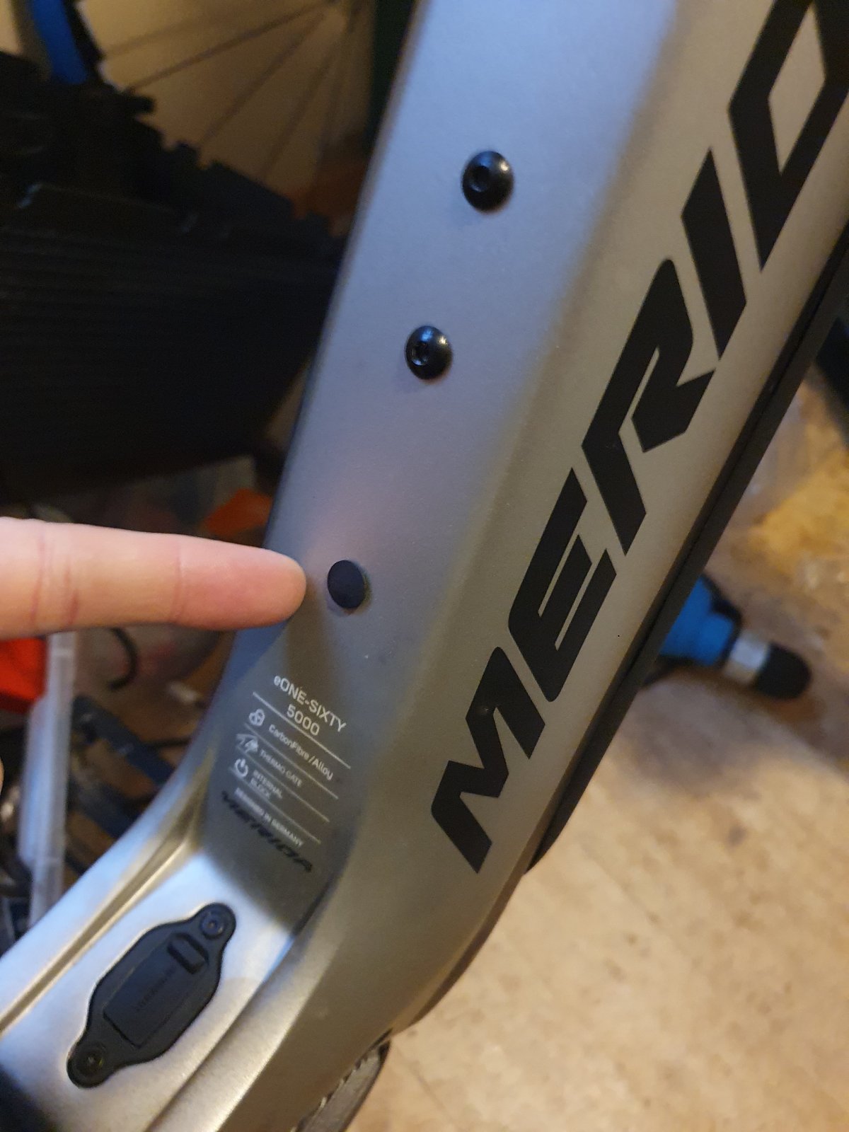

Yeah, chances are it's the battery on the power button. Take a look at the bottom of the down tube. There's a tiny rubber plug. Pull it out, it's easily done just using your finger. This uncovers a hole. Stick an allen key (or similar) through the hole and push. You're actually pressing the battery power button. Most bikes using the integrated Shimano 8035/8036 batteries should have this option. On the Bosch battery the power button is on the other side, so it's most likely accessible by just removing the battery lid. With a few exceptions, such as the Trek Rail.

И такой вопрос! Надо ли менять кнопку, или батарея в ней тоже заряжается от общего заряда или от большой батареи? Не работает только в холодную погоду, потому что не рассчитан на это? Или у него есть срок службы и умирает встроенный аккумулятор? В теплом месте, с плюсовой температурой, с кнопкой проблем нет, исправно работает!

And such a question! Do I need to change the button, or does the battery in it also receive charge from the general charge or the large battery? Does it not work only in cold weather, because it is not designed for it? Or does it have a lifespan and the built-in battery dies? In a warm place, with a positive temperature, there are no problems with the button, it works properly!
This battery isn't easily replacable. If there's something wrong with it, I guess you need to swap the entire power button. But I don't know for sure.
The battery charges from the main battery. I haven't had any issues in cold weather, but I haven't been out in below -10*C for longer periods of time. For all I know there could be a problem with your unit.
