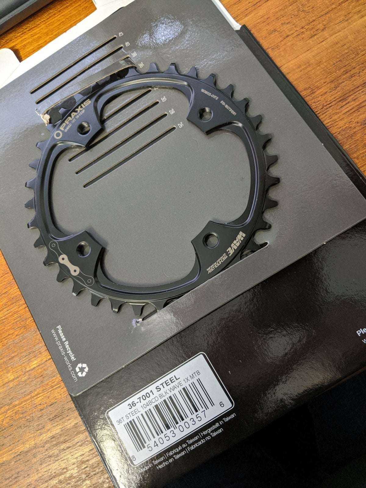

One Month later ... and I finally have my Praxxis 36t 104BCD E-ring Steel ...
Only I'm looking at it and thinking it just doesn't seem right...
It's not, they've sent the praxxis 104bcd steel 36t wave ring .... but not the e-ring !!!
So the raised sections round the thread's which align in to the spider are on the inside, facing the motor, not on the outside facing the back of the spider ..
If I mount it backwards, the "wave" teeth will be facing the wrong way .

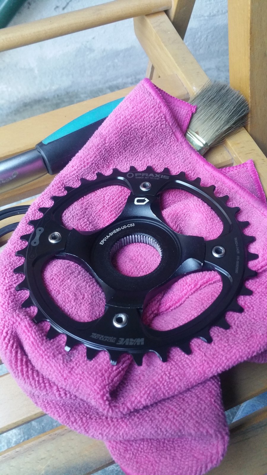

E-ring - you can see the raised alignment parts :

Ordered it from Primera sports. Just looking at @Fire_2 's photo's , I think he also has the Standard WAVE rings and not the E-RING Wave. So I guess they didn't realise there is a difference in the two ring types - or upgrade sent the shops the wrong rings.

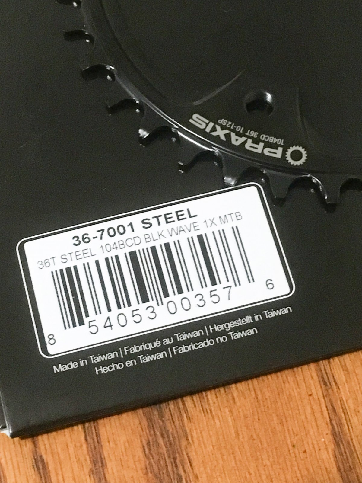

Do you have the packaging?
There's an SKU number on there which would clear it up.
Mine was "36-7001 STEEL" for the 36t version, which matches up with the praxis website.
Looking at a photo I took, mine doesn't look like it had raised bits on the front.
Thanks @Pyr0 ,
My packaging and numbers are the same as yours 36-7001. Looking on the praxxis website, the "-7001" code is the code they have listed on their e-ring page.
So ... it must be the right one :)

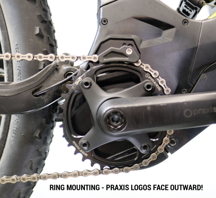

Shouldn't the Praxxis label face outward....am I seeing correctly?
Correct. Your image shows it mounted on a levo, where it mounts to the back side of the spider (but it's guide lugs are on the wrong side, so you have to be careful lining up.
SEBA's pictures are on an e8000 - you can see the shimano e8000 chain guide in the background on the first picture. On the e8000 the chainring mounts to the front side of the spider. You can see more clearly on this image :
Which has the advantage that the raised guide lugs align with the spider.

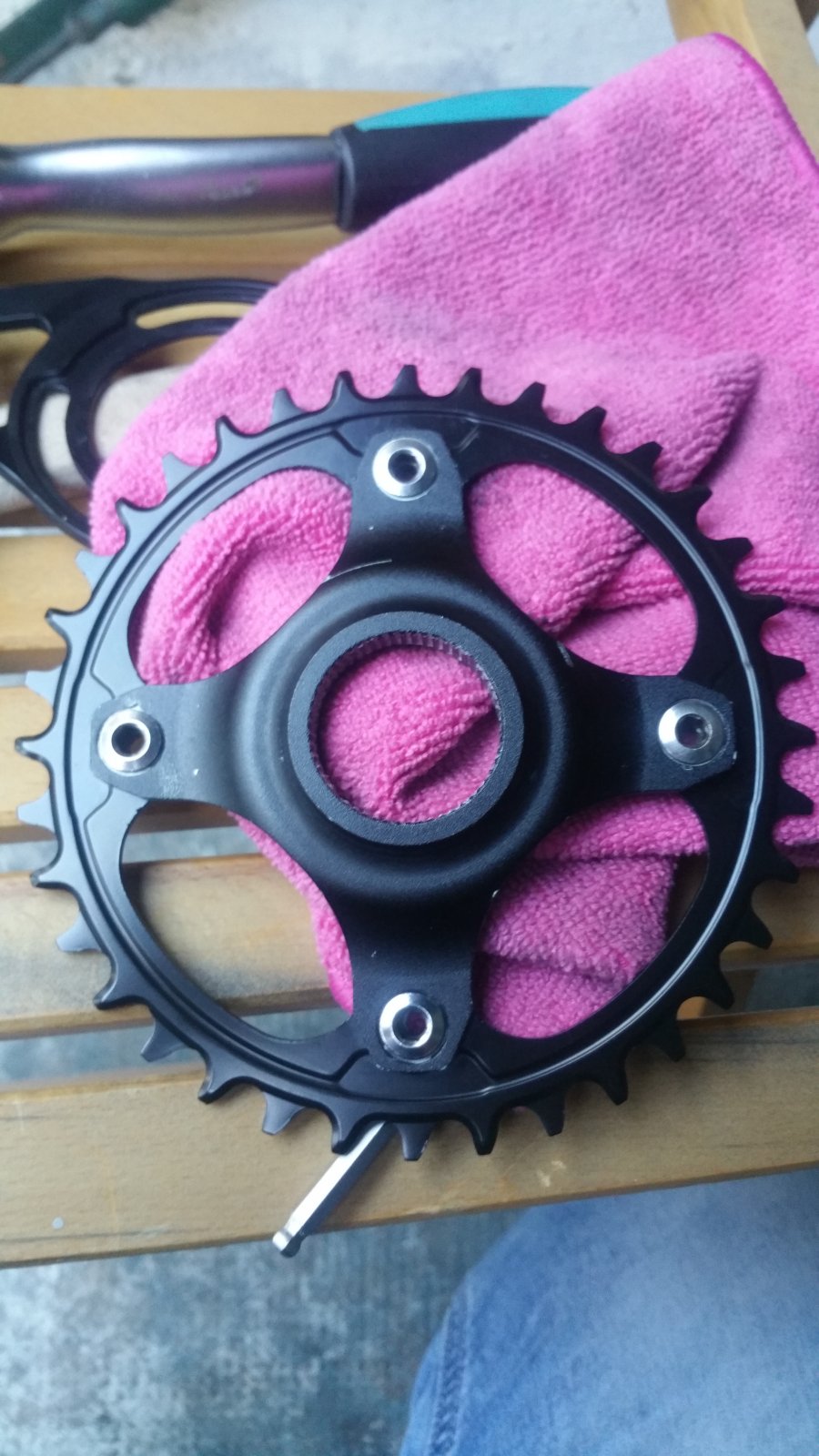

I think I mounted chainring correctly ?! Right ?!
Raised thread is behind the spider
I know bolt are inverted and this is not the normal visual but chainring sitting well bolted well and teeth have good orientation
Also the chainline is preserved
