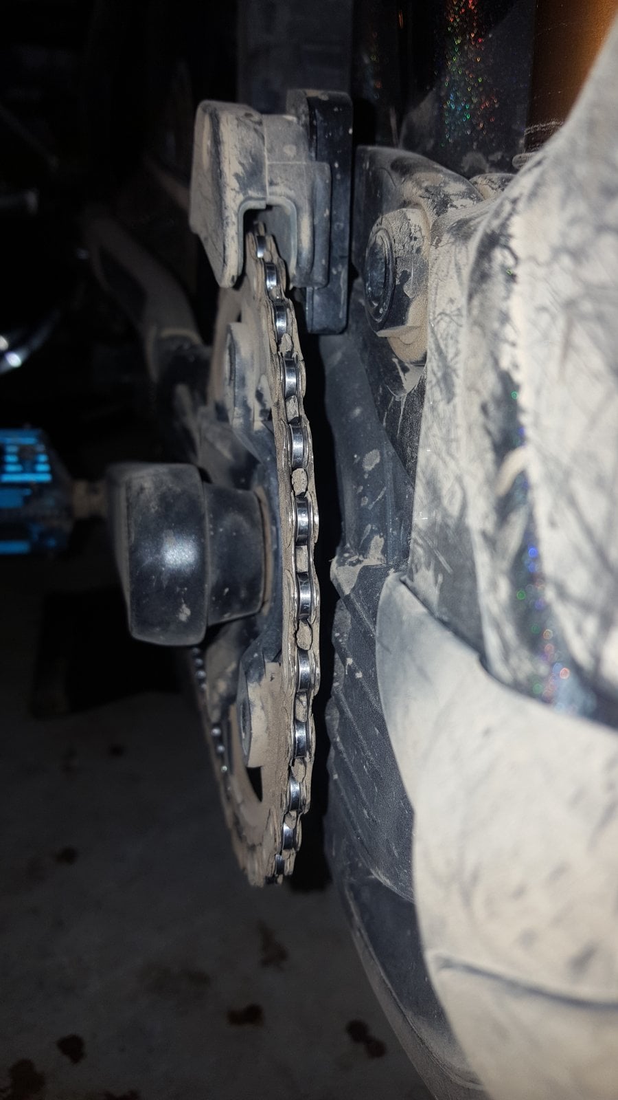

Got my Trance e+ from brand new... and first time I took my chain off (for thorough cleaning) I took note of the orientation before removal - in relation to the Praxis chainring with narrow-wide teeth. This is what it looked like, and looking at the graphic printed on the side of the chainring it made sense...

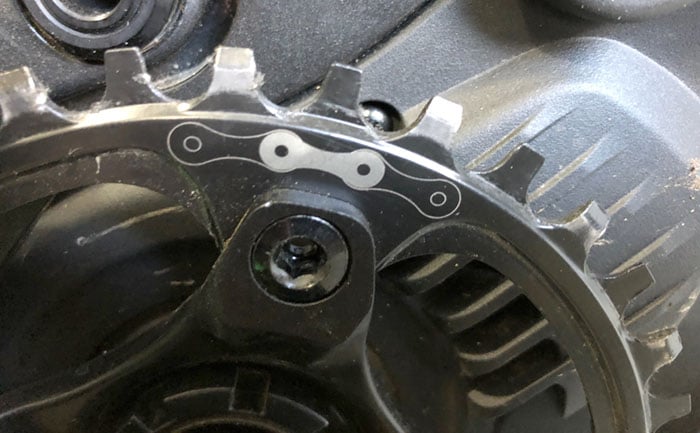

However, when I was about to put the chain back on, I noticed that the machining of the teeth (pic below) doesn't match what the graphic seems to indicate. Maybe it's a poorly designed graphic which can be misconstrued to mean the opposite - but because it was assembled from the factory that way (pic above) plus I didn't notice any chain-suck or noise, I had second thoughts. So reinstalled the chain the previous way.

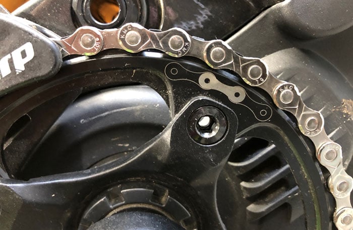

Just to get a consensus, the correct chain orientation is meant to be like this one below, right? (Which is the opposite of one above)

Good tech tip for sure! I certainly noticed the Praxis asymmetrical chain ring & thought that was cool but failed to note the proper chain installation requirement

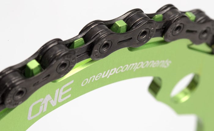

To answer your question, the laser etched diagram on the chain ring reads correctly. The outer links are intended to be installed on the thinner more inboard teeth. That One-Up ring does not employ the Wave Tech feature

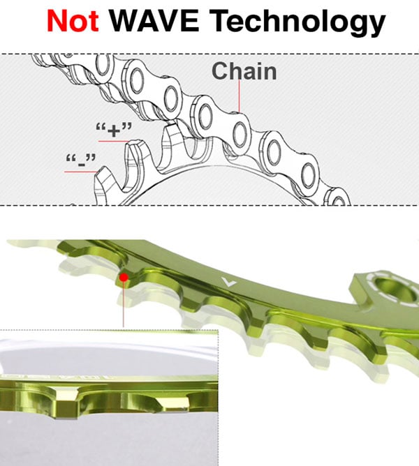

NON- WAVE Tech:
This is the bit that confused me to begin with - because my first eBike has a Bafang motor with an aluminium Lekkie chainring which I'm accustomed to.
  • The teeth have different thicknesses, alternating thick and thin BUT both are centered along the thickness of the chainring. (No wave).
  • The fat tooth goes into the wide chain gap, and the thin tooth goes into the narrow chain gap. Simple.
  • By just looking at both chainrings from side on, they look the same and so I initially mistook the Wave Tech chain orientation to be counterintuitive.
