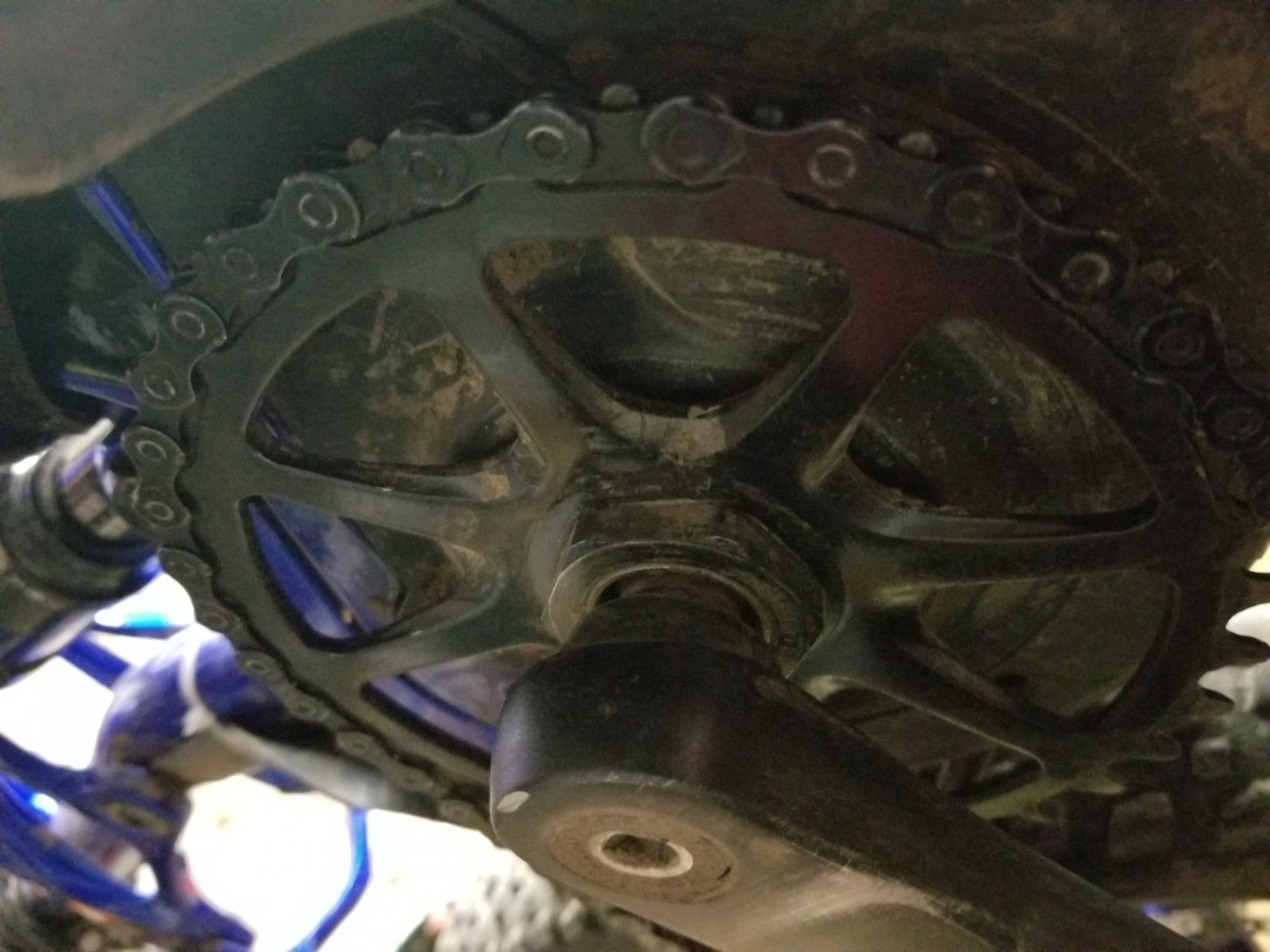

My 2020 Stance-e made new crunchy sounds as soon as I put on a new chain. Fearing somehow it was the motor, I put the old chain back on and the noise disappeared. Phew.
The noise is definitely from the front, not the rear derailleur so I guess the chainring is done.
How do I remove the old one? It seems to be held in place by a big nut. Is it just removing this big nut? Is there anything godlike left-hand thread to deal with.
Thanks.

Does this help?

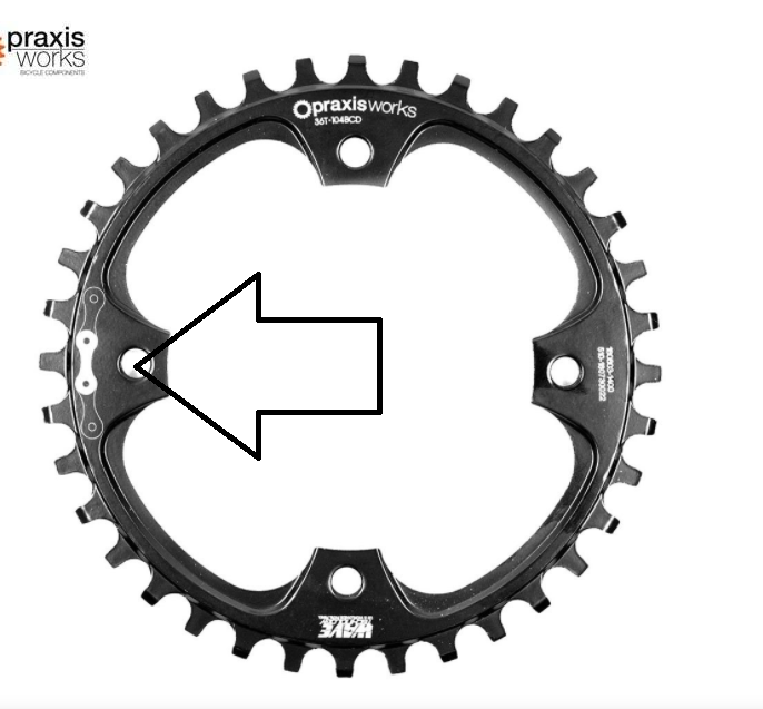

On our Trances the front Praxis sprocket requires the chain to be properly indexed onto the specific cogs. Your sprocket appears diff than ours but check that the chain doesnt need a proper index

By proper indexing do you mean proper shifting from cog to cog? There has been no change in the shifting. Still spot on regardless of new or original chain. I've also made sure that the chain position is right for the narrow-wide ring.

What the previous poster means by indexing is the chainring has a wide tooth followed by a narrow tooth. This has to fit in the correct chain links. If you look you will see the links have a wide and a narrow link
See attached image of our Praxis. Just taking a crack at your issue as your ring type may not need this level of detail

Yes I made sure the chain matched the ring in terms of narrow-wide.

You would expect that nut to be reverse thread but usually it would be marked with direction and torque setting............try cleaning it up to see if you spot any markings??

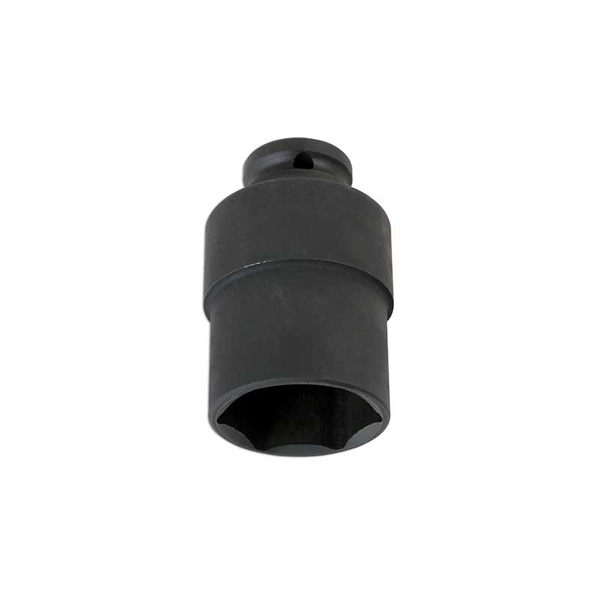

reason i`m asking this is it looks the same as my full e
i used a hub nut socket 36mm from euro car parts, it was the only socket that
had the length to get round the crank shaft, and it was l/h thread
hope this helps
Laser Hub Nut Socket Thin Walled Deep 36mmProduct Code: LAS6279
check sizes first

Yes a regular hexagonal nut and upon further inspection and cleaning, I can see a directional arrow on it for tightening direction. Mystery solved. I'll check to see if it's 36 mm before getting a suitable socket.
