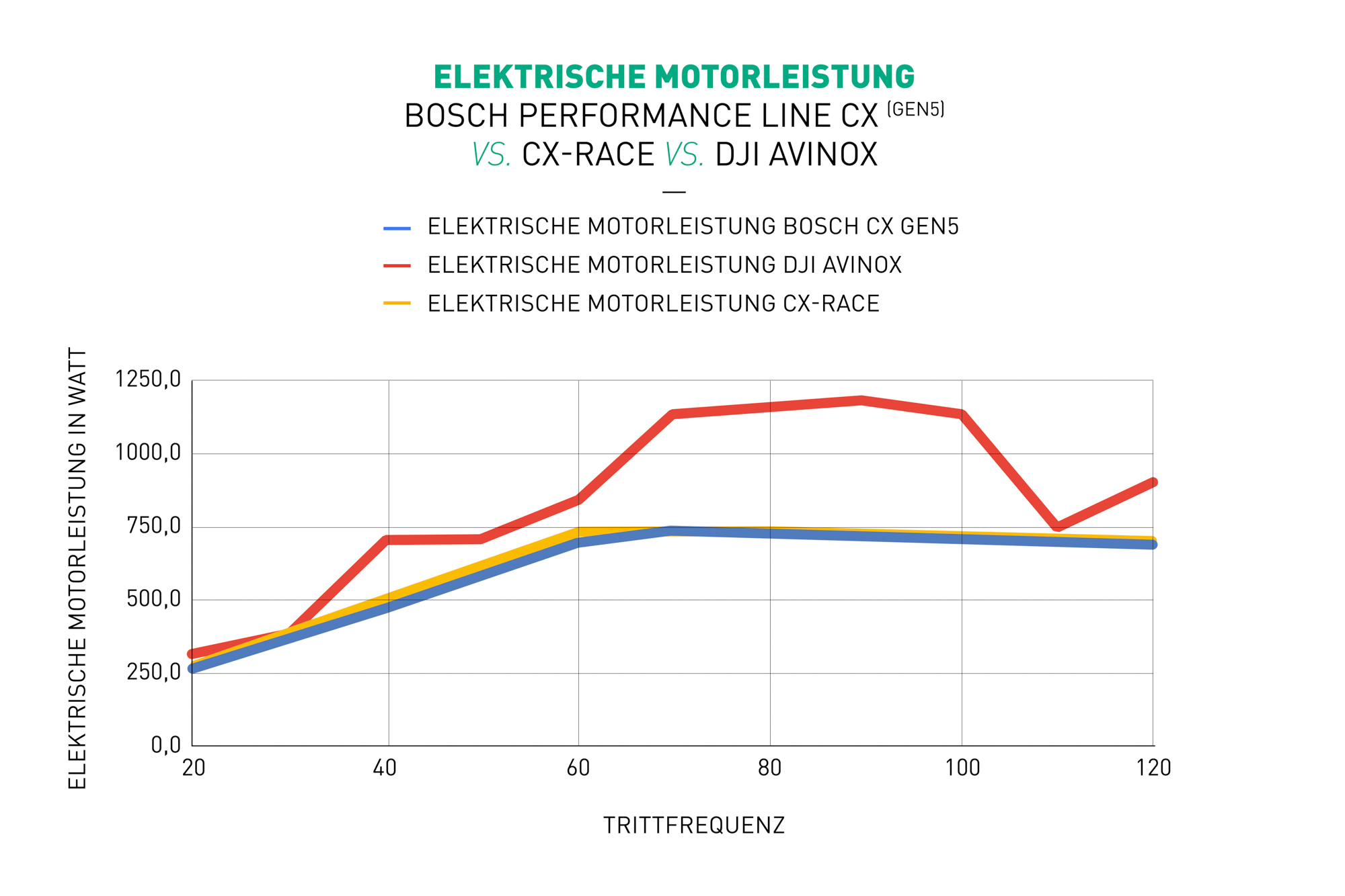

Just look up the power loss in epicyclic gears and you may find 5% loss would be wishful thinking
Decent article here.
They measure the power through the rear wheel
elektrische-Motorleistung-Bosch-Performance-Line-CX-Gen5-vs.-CX-Race-vs.-DJI-Avinox.jpg
From their measurements seems DJI have always been a little bit more "generous" with their power outputs
