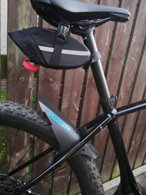

Fitted some cheap ebay mudguards. Decided the fake carbon fibre effect looked dire. So flipped them for a plain black effect and then decided to jazz them up with some ebay Specialized transfers. Bit heath Robinson but it'll do until I find some mudguards I like.

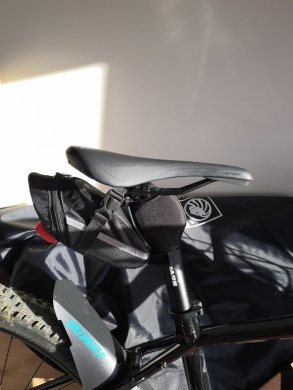

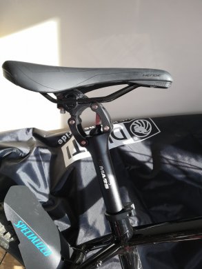

More money than sense moment. Really liked the look of the suntour suspension seat post. Found out a firm called TMARS make a similar one, less travel, but also lighter. Got the last one on amazon. Cheaper from other sources but I'm away on hols in a day or two so wanted quick delivery.
So only 20mm of travel, looks like more, feels like a comfy cushion when on bumpy grass. Will try later in more rutted tracks when kids asleep. IMG_20190703_191434.jpg
Stealthy enough looking when it's got its cover in and disguised more by my el cheapo saddle bag.
It's fairly similar design and quite well damped.

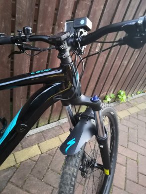

I've just fitted the RockShox Sektors from my Levo FSR onto the other halfs Levo HT......
WOW - What a difference!!!!!!!
The Sektors must be at least 1.5kg lighter than the Suntours, and the ride quality is so much more improved. The front end has been lifted by approx 15-20mm which has probably changed the geometry a little, but the bike is massively nicer to ride.

Well I've been out for a good bumpy ride and I can say 20mm of seat travel makes a much softer ride on a Levo HT. So much so that I went really quick on some lumpy bits where I wouldn't normally and I caught the front wheel in a rather vicious pot hole on a semi-unmade road and just a lovely bump out of my seat, which although scary didn't hurt. Pretty sure I've slightly bent the front wheel. Are the Rovals covered for berk damage under warranty?
