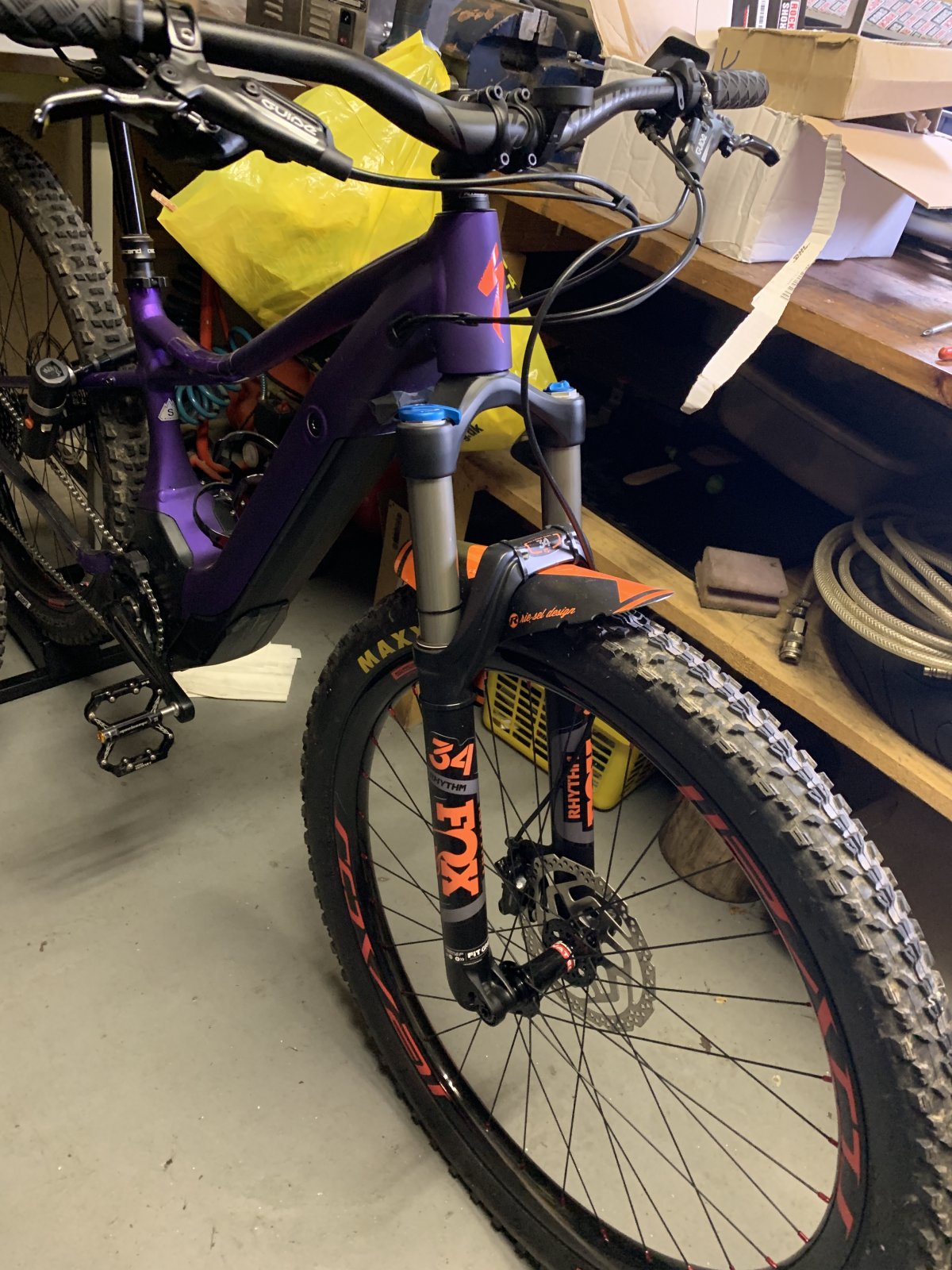

I put a 140mm FOX 34 on my wife’s HT, I got it from eBay almost brand new from another guy that upgraded his bike. Many good offers also here on this site from people upgrading. Going 140-150 mm travel does not put the geometry that far off and actually makes the bike a bit more stable.

I learned the exact same lesson when I installed the FOX 34 on my wife’s HT.

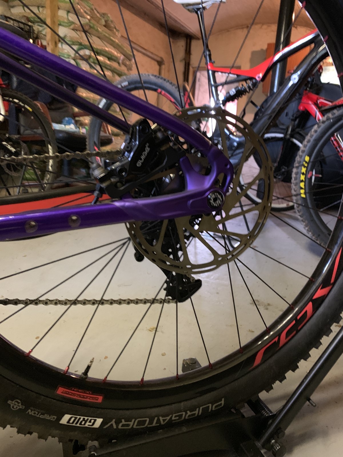

I kindly disagree based on above picture of my wife’s 2019 women version of the Levo HT ;)
It’s like stealing candy from a kid to install a 200 mm setup at the back, what you see is a SRAM 200mm Guide RE setup originally from my own Levo FS.

My wife’s 2019 Levo came with a 180 mm disc front and rear. At the rear it’s 160mm direct mount hence a +40mm adapter to go 200 mm.
I have never heard about a 160mm disc on any Levo. I think you better check the diameter one more time.

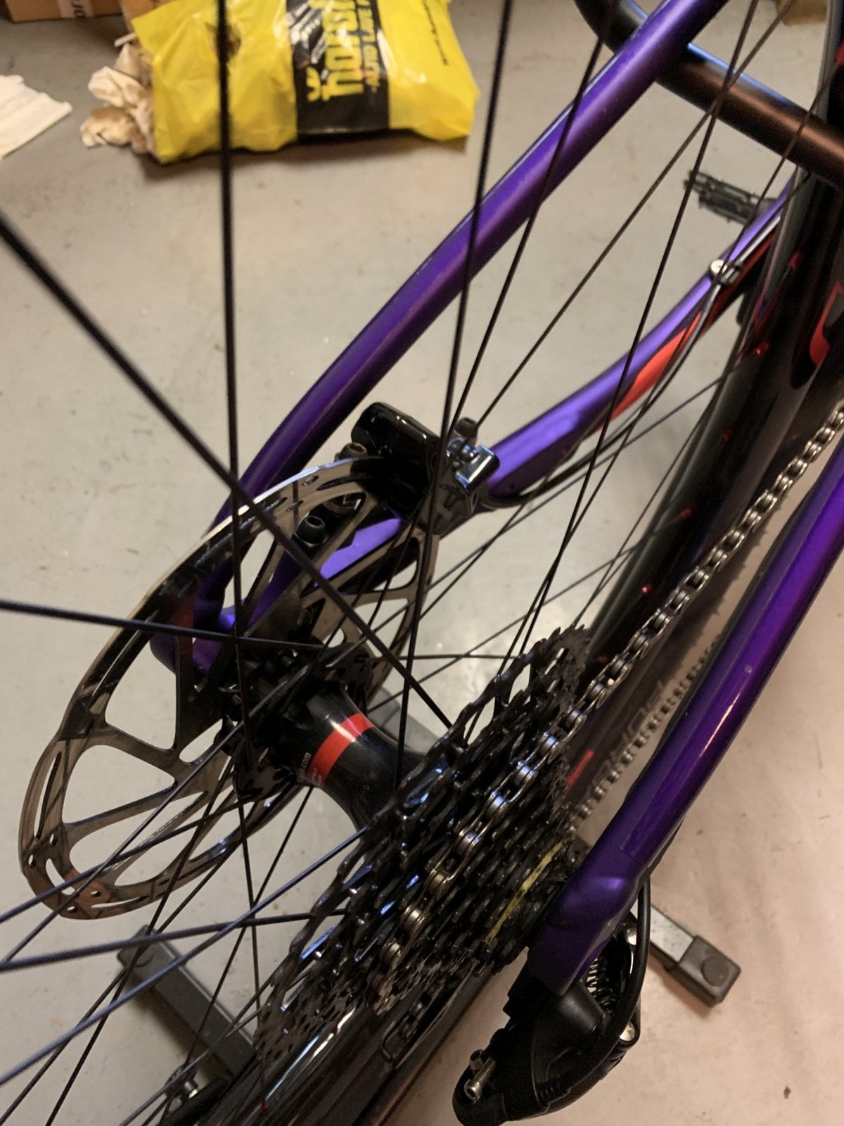

regarding rear I will measure it in morning but evans cycles isn't the only uk bike shop that lists it as 160mm rear and it does look smaller than front but I double check in morning.

It could be that they for some odd reason fitted a smaller disc on the UK market but then I’m sure the caliper is mounted directly without an adapter(direct mount), I can simply not believe they also made a different frame for UK only. As it’s a bit older fork you will also need a +40mm adapter there as apparently the 2017 Pike is a 160mm direct mount too.

Right checked size this morning you was correct came with 180mm rear disc my apologies the lbs had it listed as 160mm which was incorrect I ordered 2x40mm adapters and managed to pick up a set of code r brakes nearly new for £100 so that's the forks and brakes sorted just wish there was a way for the 1.2e motor to produce same power as the 1.3.
