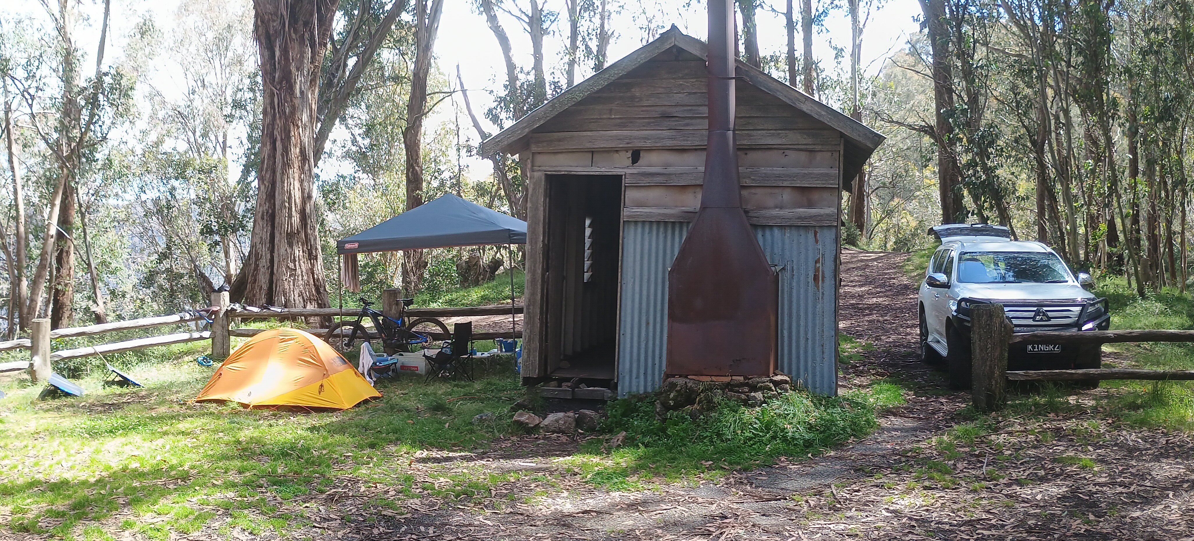

I'm now up to three solar generators when I go away and can keep my 800wh Trance fully charged for three rides a day, with two smaller units for fridge, lights and devices.
I have it written up if anyone is interested at Blogger

I’ll be using it to go camping with the bikes Dave. Take it away full charged, and the bikes fully charged, and we’ll get two days of riding with two bikes (me & her).
Or, as we have range extenders on our lightweight bikes, we can use the range extender batteries first, return to the car to charge them, use the bike batteries, then come back and have another couple of hours on the recharged range extenders.
Cheaper to buy a Power Station then to buy spare batteries for various bikes 👍🏽
