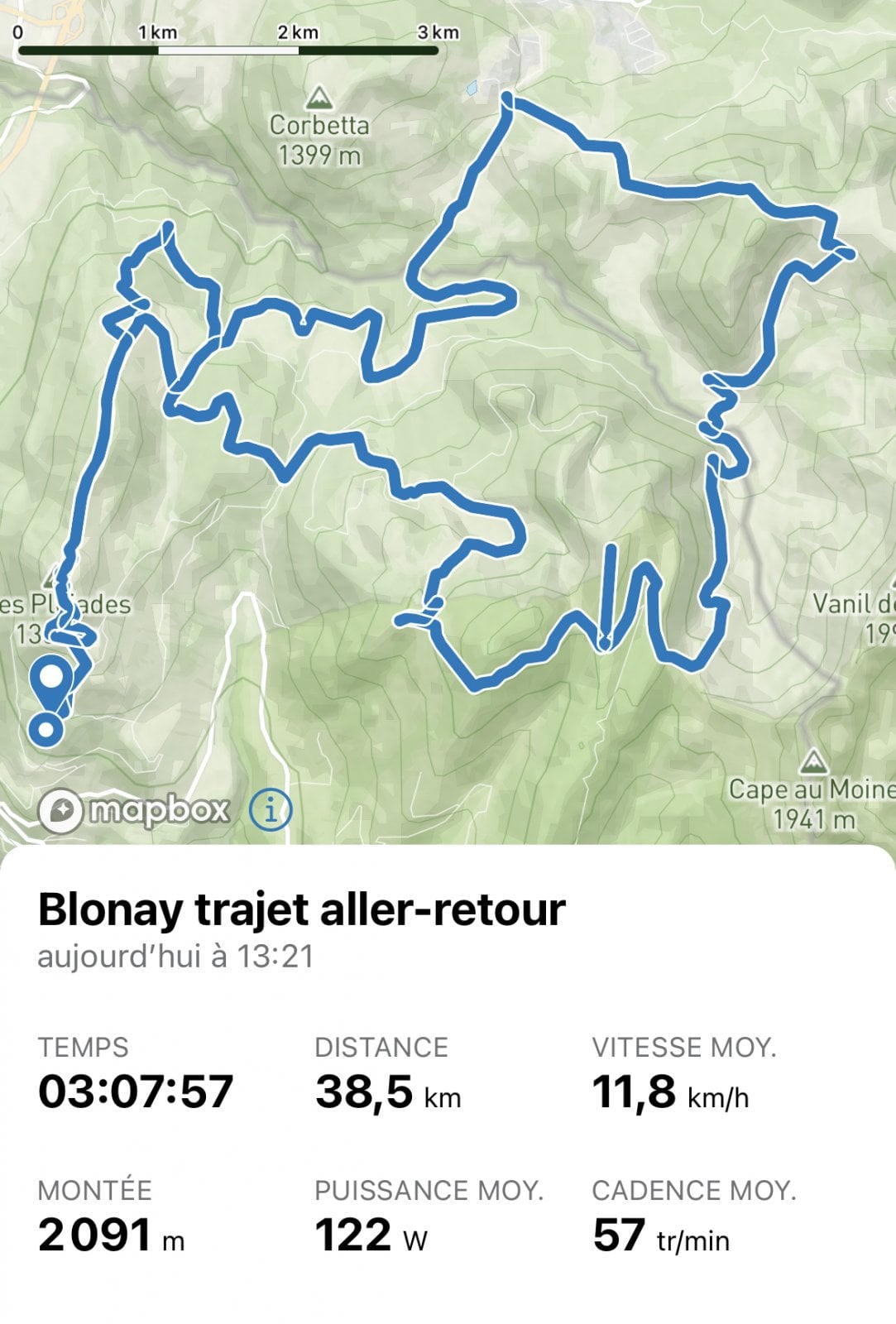

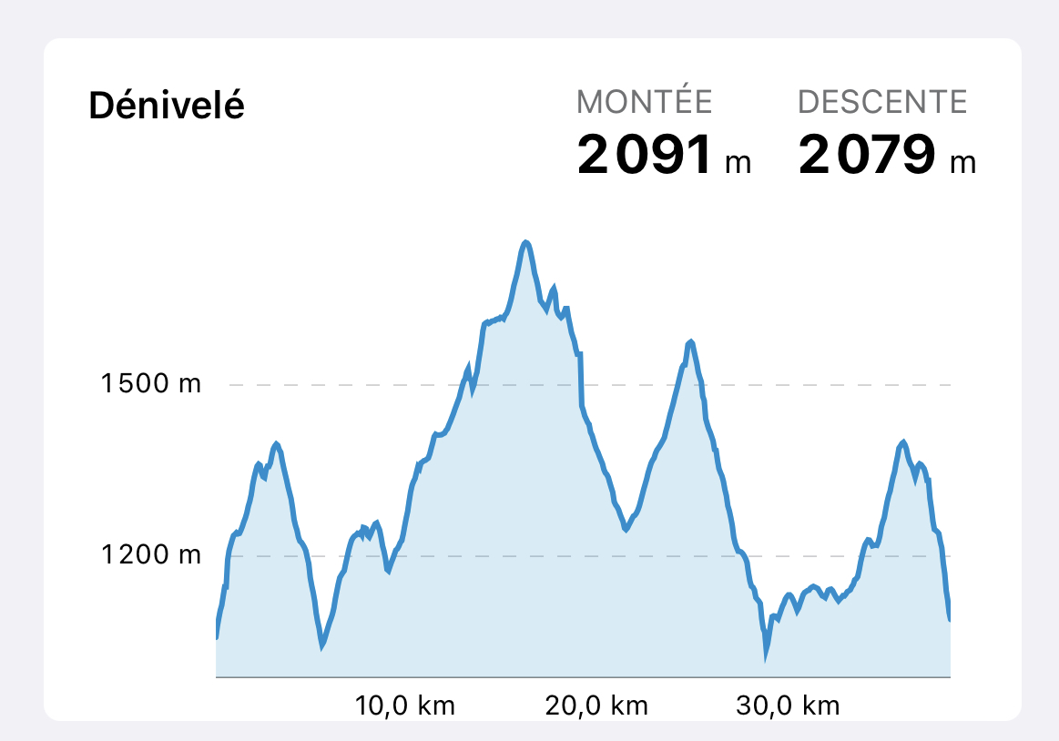

For me the range of my cube seem to be fine... But it's my first emtb so i don't no...
I have started with a battery that was not fully charged. I ended with 4% battery
