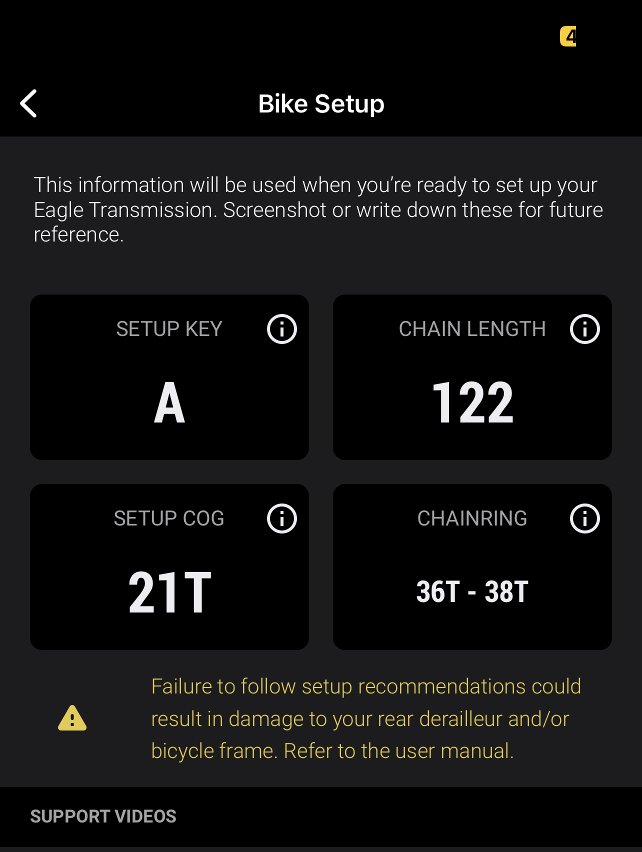

Even after replacing the broken tooth cassette, my original XX still struggled with downshifts even though it was at micro adjust 1 (fully inboard). It’s like it wanted to be in micro adjust -2 or something to be happy (obviously that doesn’t exist).
So…
Replaced my XX derailleur with a new GX and it all now shifts flawlessly in micro adjust 9.
Conclusion is the original XX derailleur was a few mm out of spec and the result was crap shifting, a broken cassette tooth, and a prematurely worn chain. Zero marks on the derailleur from impacts. Whatever the XX derailleur’s issue is, it’s been there from day 1.
Both derailleurs were tested with SRAM’s latest setup guidelines (Key A / 21T /at sag).
I guess the takeaway here is if you’re on the edge of the T-Type micro adjust envelope it’s a red flag that something’s out of whack.
Also, if you’re skipping in a particular gear look for missing teeth - SRAM has etched weird notches on the cassette, some of which weaken the individual teeth.
Hope that helps someone!
