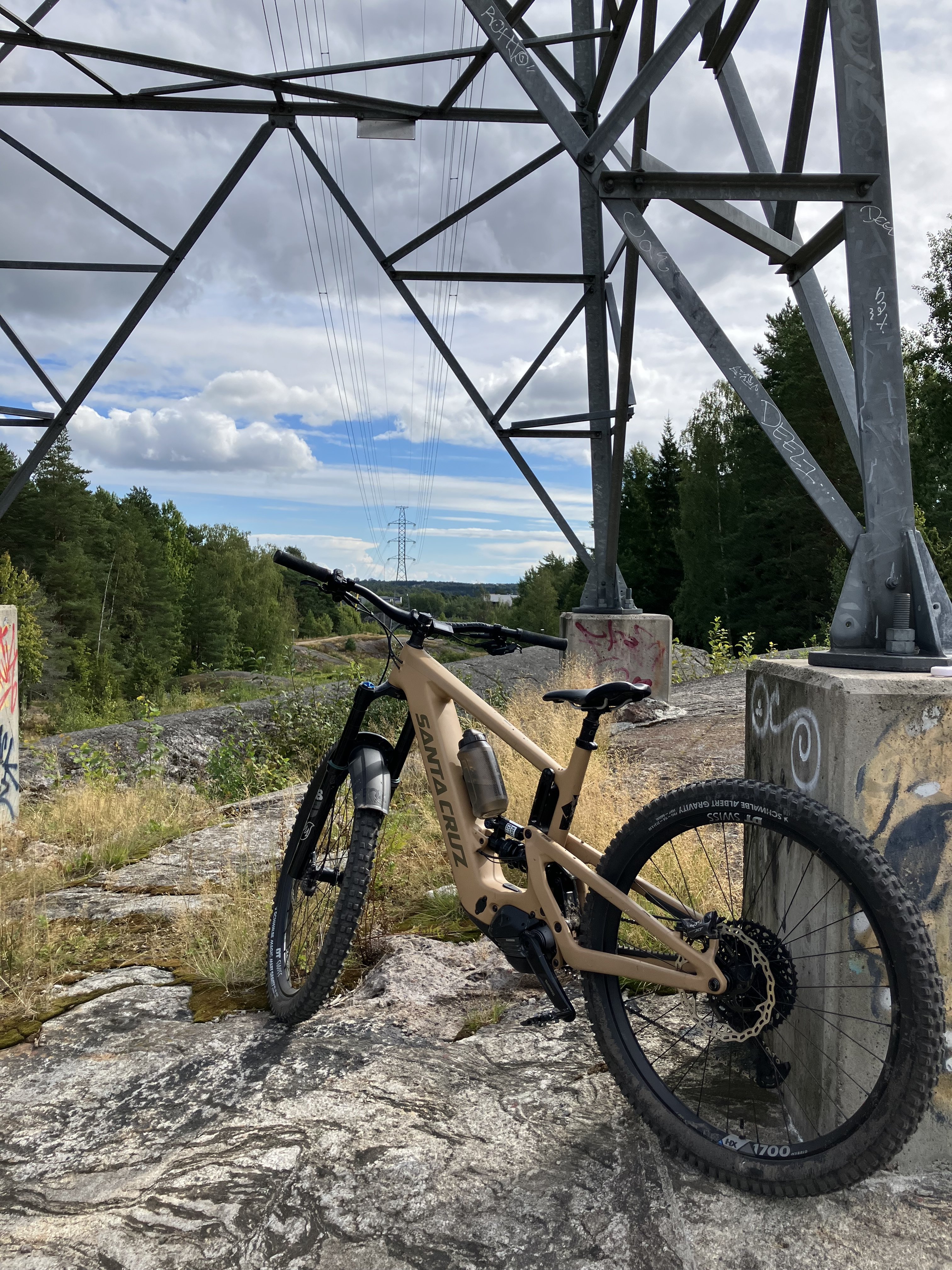

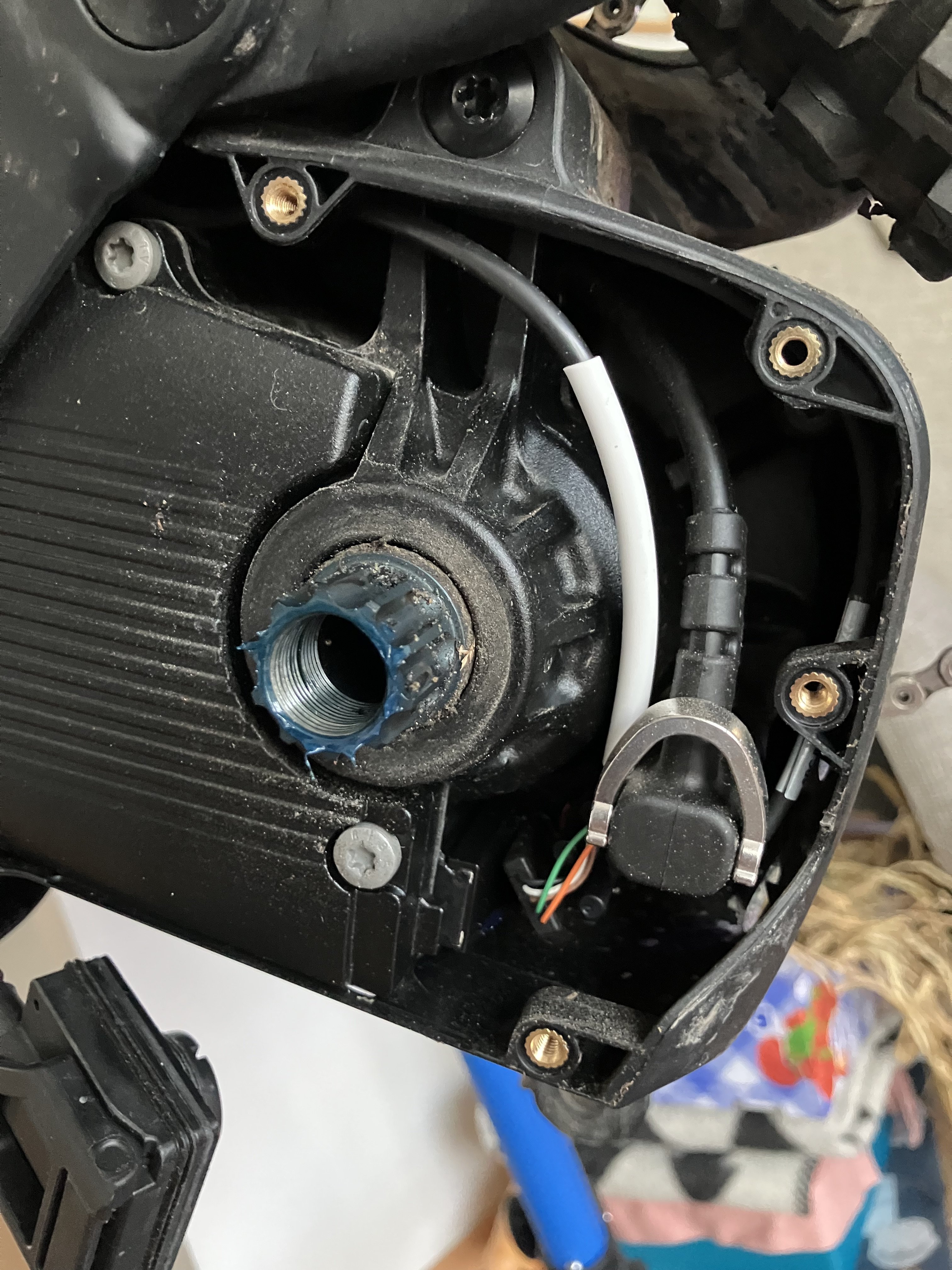

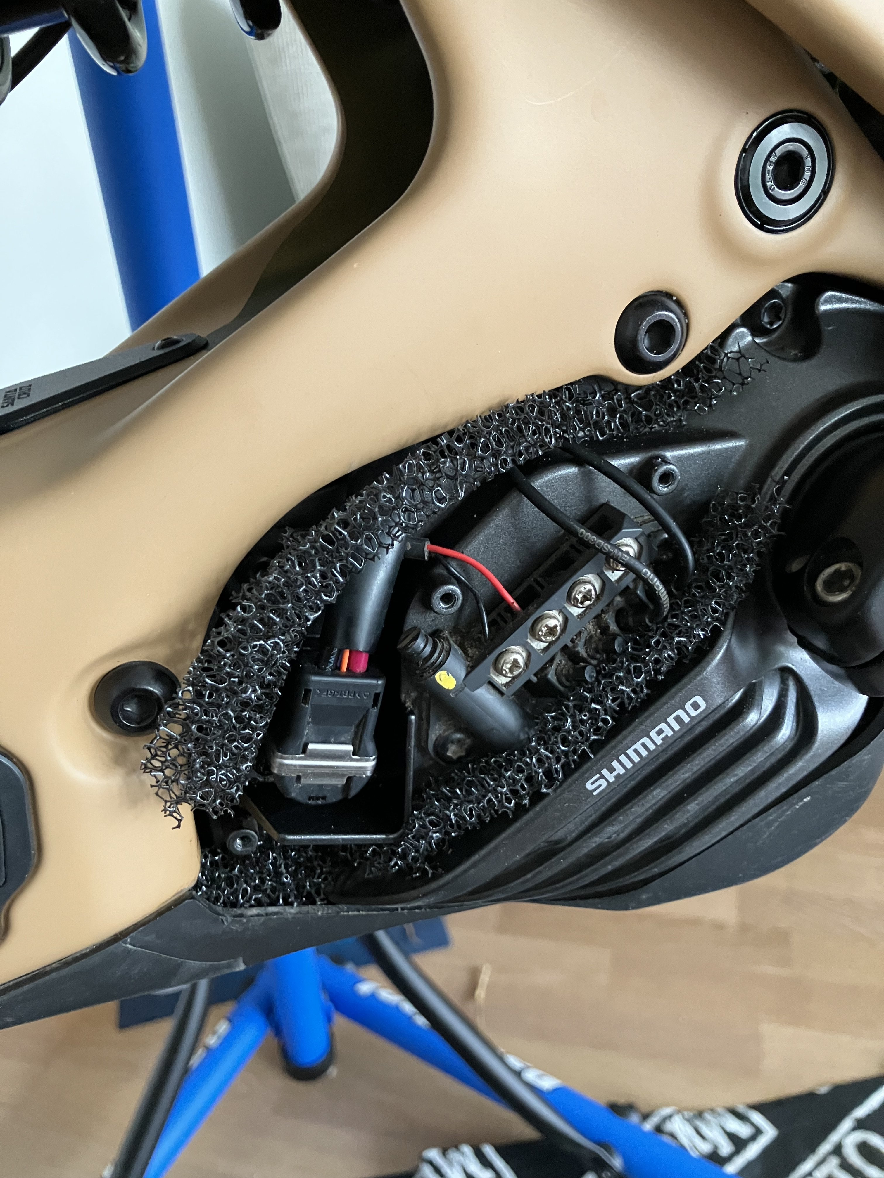

Fifth emtb ride in a week today. Yesterday chill ride with a friend on a Spesh and today full enduro send with Bullit. Got it back from LBS on thursday, it shut down in middle of the ride last week without any reason and no error codes. Shimano says it`s moisture in connector…didn`t specify which..only one I can think of is battery cable behind left side engine cover so I cleaned it with contact cleaner and put silicone grease around the cables so water cannot go through there to the connector itself. Then I put some motofoam under the engine cover to keep shit out, there was two table spoon of damp dirt when I open it 😀 Rode today all rock gardens and roots, all good for now…

Very clean looking. I haven't been in to the guts of mine yet as its been mostly dry since I got it. Saying that the cable it way more protected on Gen 3 levo I'm thinking 🤔.

I think Levo motor cables are very nicely protected. Although this has only around 500km`s on it, but inside looks like new, no dirt. Very well designed, two wholes on the bottom of the motor, everywhere else very well sealed from the elements. I thought I’ll put some foam here too, but after I opened it, I don’t think it needs any. Of course battery cable is different but I didn’t have any problems with gen2 cable so I think this will be fine too…hopefully 😀
I had about 3 replacements for my Gen 2 Levo Expert . Gen 3 has done 900 miles touch wood no issues.

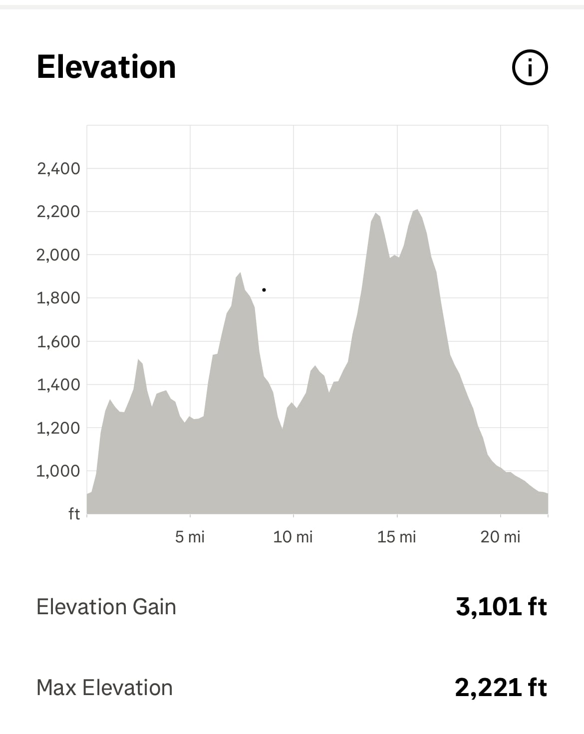

My strava data below.
