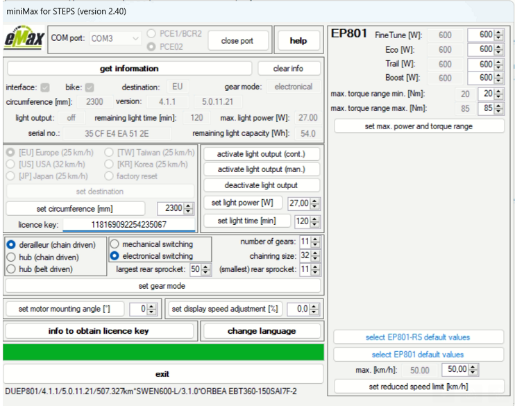

Yesterday I had a online session with eMax from Germany.
They speek/write very good english.
The job was:
- get AutoShift to work.
- raise the speed limiter to 32kmh.
Bike:
- Orbea Rise M20 2023 with RD-M8150-11-SGS 11s derailleur (Di2 LinkGlide)
The bike did turn on a error code E903, when I connected the RD-M8150-11, which was quite strange.
AutoShift is not available in the Shimano mobile app, and not in E-tube Windows program.

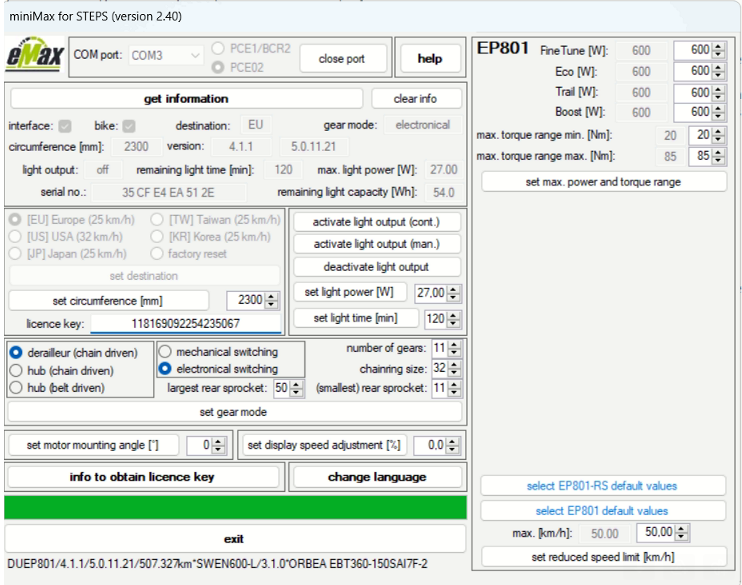

The free miniMax software could change the shifting from mechanical to electric - and this made the error E903 go away and the AutoShift to be enabled - and it did work.
So....the German tech connected via the free software AnyDesk, and I could follow all the steps.
After some minutes he was finished.
I assembled the bike, and did a quick test ride in the rain/dark.
The speed limiter was raised and the AutoShift was working.
I am happy.
I have not had time to look through the software - but as I remember I can:
- set the speed limiter between 25 and 50 (32 is enough for me)
- set the power level in all modes (up to 600w)
- change between mechanical/electric mode for the derailleur
- a lot of reading possibilities.
The prize was €119 and it was worth all the money.
The support is very good.
I had a brutal crash on monday on my Orbea Rise M10 2021 - and I will update the thread if something goes wrong with the bike/software.

I have used the emax function and gone from mechanical to electric shifting.
The error is gone and the shifting is working.

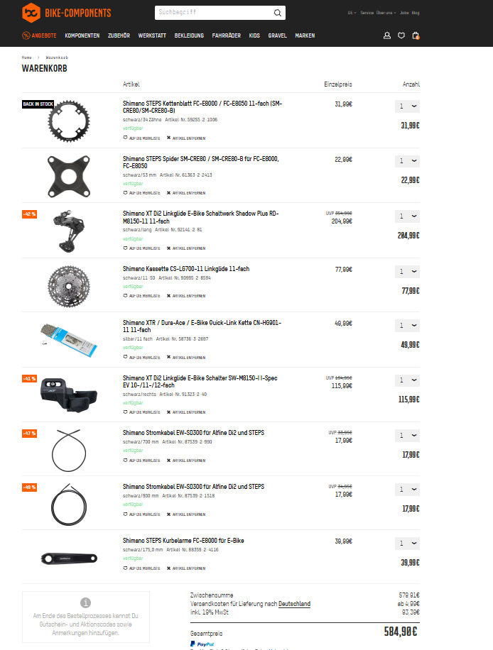

I upgraded my 2023 Canyon Spectral:On to Autoshift/Freeshift. I bought all the parts online and my LBS (Shimano approved tech) did the install. He had to contact Shimano Spain re the software update/change. He said mine was the first Shimano Spain had done.
Backflip
Nov 6, 2023
51
43
Austria
So, you are the lucky guy. (y) :)
Here in Austria and most probably also in Germany, the Shimano represenative "Thalinger Lange" refuses to set correct configuration changes when you have bought and mounted the components by yourself.
Did you have to pay extra for your LBS or Shimano Spain for doing the job of correctiing configuration change for your new Di2 derailleur?
Dhd12
Aug 27, 2023
44
19
Almería (Provincia)
Yeh. you always have to pay in Spain. I let my LBS do it as I didn't know what length Di2 cale I needed and I didn`t want to mess it up

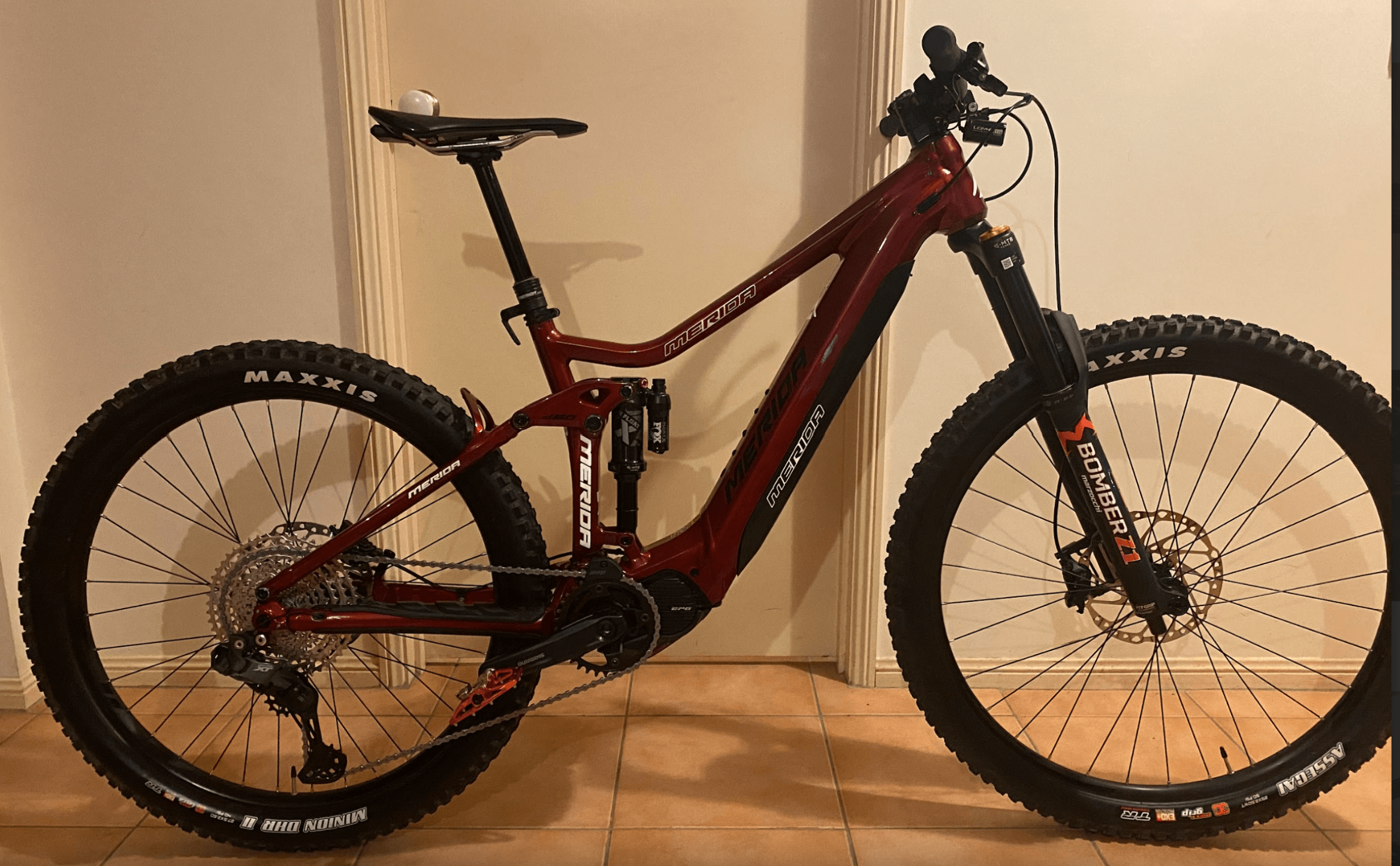

Hi guys,
Great thread.
I have just bought a Merida e160 700 EMTB, with an EP6 motor. It came with 12 speed XT mechanical shifting. I've bought the Di2 Shimano XT RD-M8150-12 Rear Derailleur, and the Shimano Deore XT SW-M8150 Di2 Right Shift Switch.
I plugged them into the EP6 and as expected, I got the E903 error. I have downloaded the miniMax software, and installed it on my laptop. I am going to the store where I bought the bike tomorrow, and they say they'll lend me the SM-PCE02 interface.
Hopefully just a straight forward job to switch from Mechanical to Electronic Shifting using the software. Just a note that the most common SM-PCE02 interface cable, has a lead with a SD50 plug, so you need the SD50 to SD300 adaptor if you get that interface. Then a short SD300 cable to go from the adaptor to the motor's Etube port.
Some other notes is the 12 speed derailleur will only give you FREE SHFT and not AUTO SHIFT, because there is no 12 speed Linkglide Cassette. But a trade secret I've heard is that Shimano may be bringing out a 12 speed Linkglide Cassette in August. After which, a firmware update will allow AUTO SHIFT to be turned on for the 12 Speed Derailleur.
This is why I have gone for the 12 speed derailleur, rather than replace the rear wheel to get a HG Hub, and put an 11 speed Linkglide, and Electronic Derailleur system in. Hopefully my contacts in Shimano haven't let me down.
Whilst I mostly want the FREE SHIFT, I can see times I'd like the AUTO SHIFT.
I also want to increase the bike speed to 32kph, and will take the above advice and get EMax involved, once I have all the Electronic Shifting sorted.
Anyway. I'll keep you all updated. And thank you for sharing all the above experiences. It has made the process of conversion to Electronic Shifting, in such a new motor system, less stressful.

Well ......... the installation and reprogramming went smooth as silk, after the Bike Shop loaned me the SM-PCE02 interface. The only hick-up was the cassette top and bottom gears were set incorrectly by the people who built the bike. So I had to set my smallest gear to 10 teeth, and my largest gear to 51 teeth in the EMax programme, before it would allow me to download the changes.
I took the bike for a ride afterwards and the FREE SHIFT is working really nicely. Whenever you coast. The shifter and motor work together to put the bike in the right gear, dependant on your speed. The extra acceleration it gave me out of corners, because you were always in the right gear, was sensational.
I can thoroughly recommend this upgrade. Thanks again to everyone who posted the help.
The job was:
Bike:
I am happy.

i plan on upgrading to 11 linkglide too, my bike is a m20 2023.
if u go after the shimano compatibilityy list i basically need to change the whole drivetrain...
-did u used all of the stuff shimano recommended or did u kept some old stuff from the drivetrain?
-did u actually got a new rear wheel?
-did the new shimano sprocket worked out compared to the stock e*13?
after getting all parts together in the shopping basket, i noticed the 11 linkglide need a different hub to fit the cassette, the one coming with orbea is microspline and the 11 casette is HG...
sorry for my bad englisch :D i hope u understand my question.. thx
