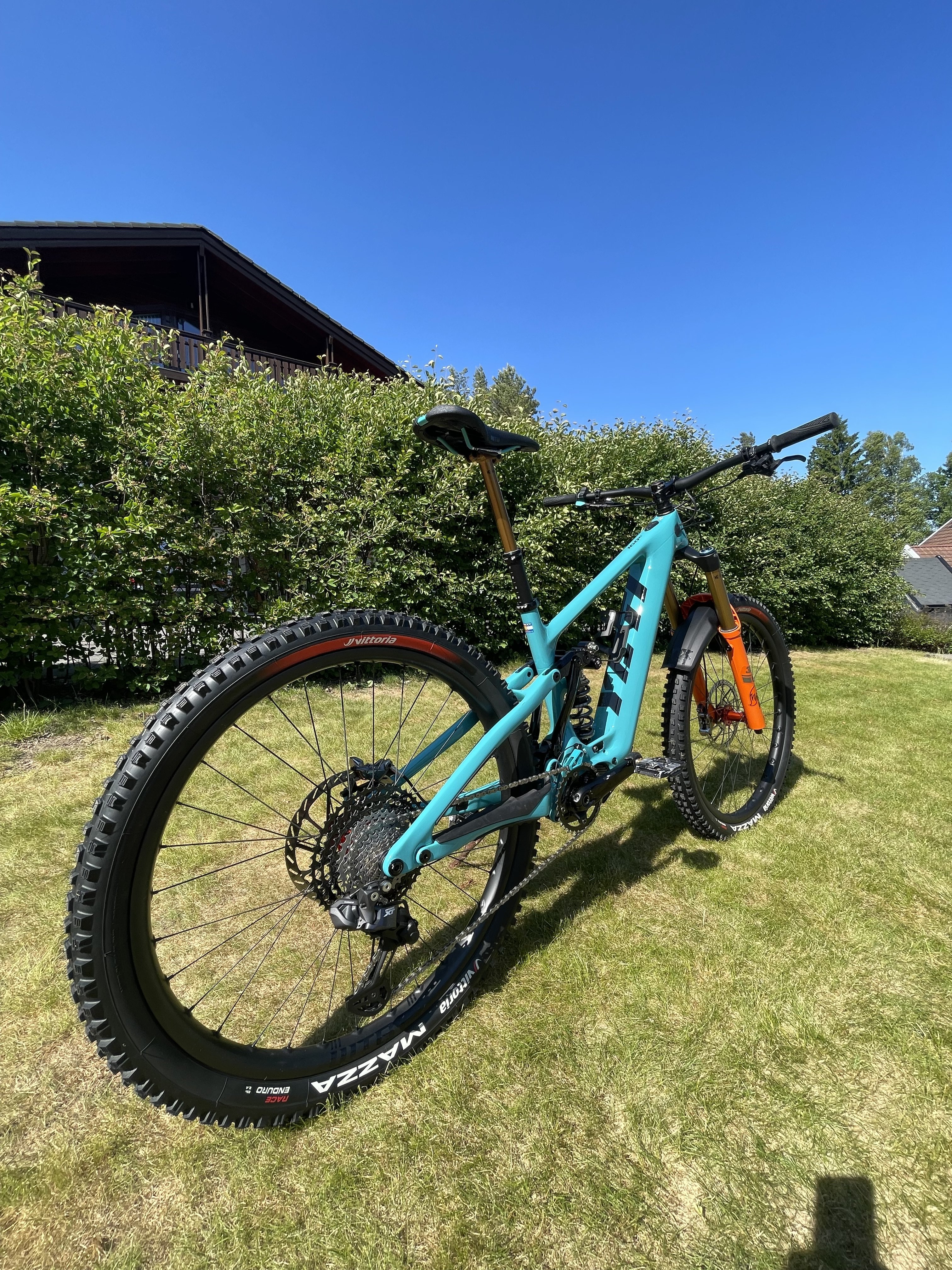

Yes absolut! Once you try it you will love it! Using the free coast shift alot more than i first thought. And the shifting performance is really good
braaten22
Mar 24, 2019
30
29
Norway
You need to go to a shimano service center, they will Connect through the SM-PCE02 diagnostic box and change it under drive unit settings
