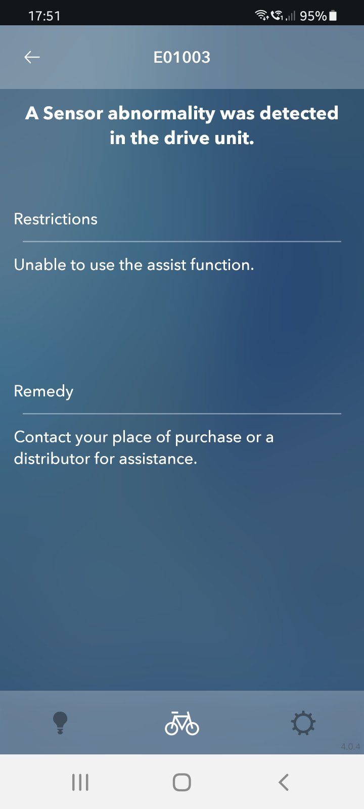

Got the replacement battery today and its doing the same as before, bike doesn't recognise it. Can't have had 2 faulty batteries so it's definitely the bike. The only thing I can think of is that error which a lot of us got after the firmware update the other month. Any of you extender owners still showing that error and having no problems? Just trying to rule possibilities out.
Just had the bike down at my local shop on the diagnostics. Checked everything and couldn't find an error anywhere on battery, motor etc. Updated to latest firmware 4.1.5 I think it was and now when I connect with tbe Etube app I have 2 of the E01003 errors ?.
