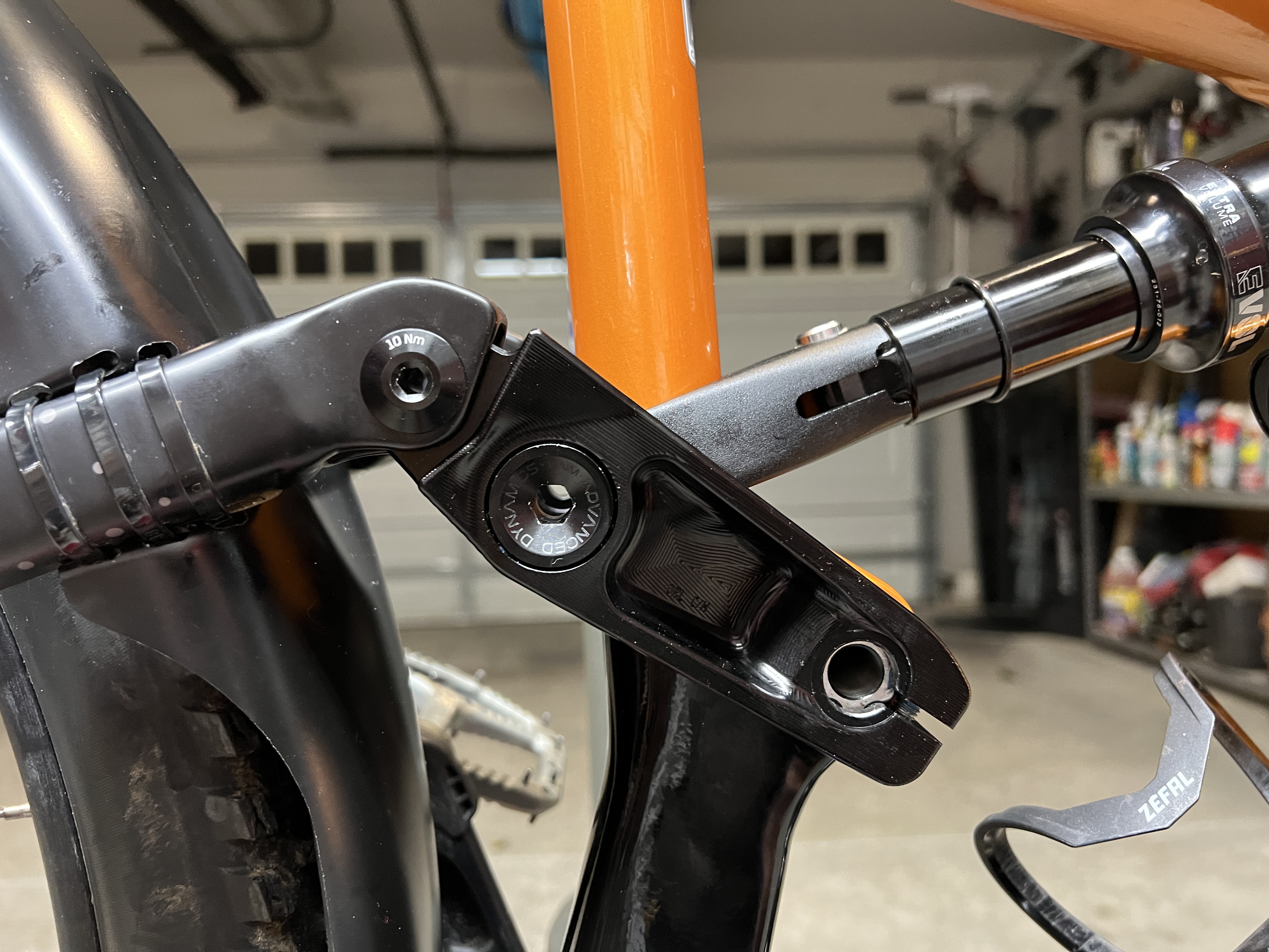

I received mine as well. The design was updated last year. Cascade even commented on a YouTube video of somebody installing the link with that info. I don't know why they don't update the website info. Maybe some legal precaution.
I read on Singletracks that they changed the design to prevent that.
Singletracks Tracks Orbea Rise Cascade Link Review

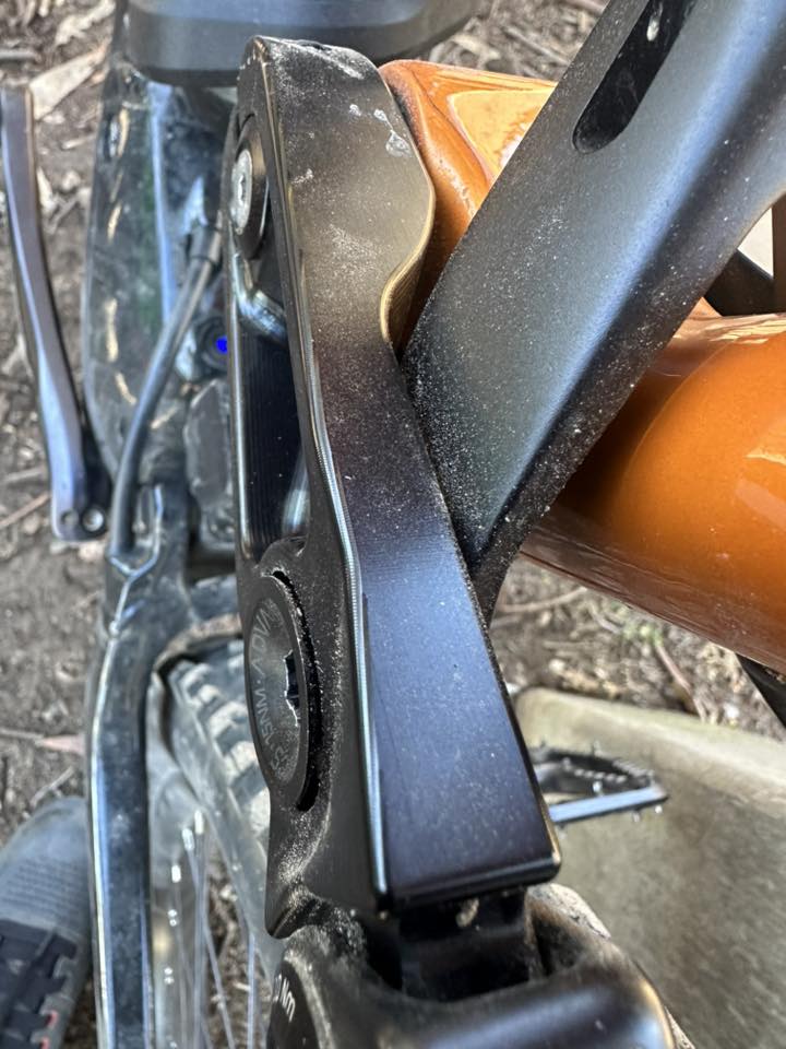

However, Cascade’s website still contains a note stating you may have to file off a little paint.
We have now seen this both fit AND not fit aluminum frames from this same date range. If you have an aluminum frame please be aware that you might loose some paint. There are no structural concerns here so if you feel handy with a file all you have to do is take a little bit off.
I‘ll be installing mine this weekend on my 22 H15 and will report back my results.
I'd image they mean to file a little of the linkage rather than the paint on the frame. If you fit it and find it rubs on the frame, take the linkage back a little so it clears.
Installed mine this afternoon. No clearance problems on my ‘22 H15

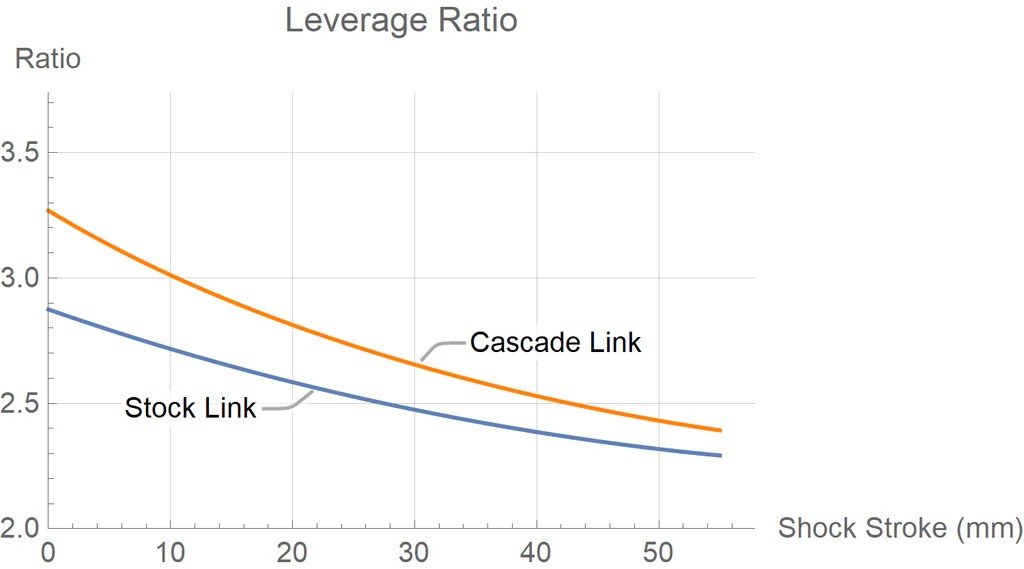

In theory, slightly lower air pressure should result in pretty much the same sag.
Looking at the graph for the cascade link, it's basically firming things up throughout the travel. A slight reduction in spacer size with slightly lower air pressure should get you pretty much back to where you started albeit with 10mm more travel.
I'd say its time to go back to the drawing board with your settings and start again.
Are you sure the shock is working OK? There's no issue with it equalising?
I'd have said if the back end of the bike felt good before the cascade linkage then it should feel good afterwards, just slightly firmer throughout the travel. That would mean a slight reduction in air pressure and volume spacer size.
