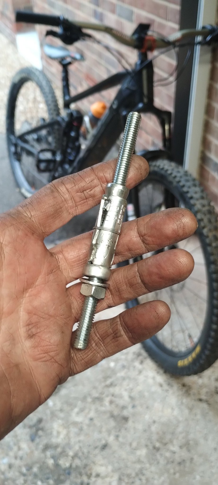

one tip for removing bearings from blind holes is that sometimes a rawlbolt will be of a suitable size and if you dont have a dedicated blind bearing puller / slide hammer then this can get you up&running quickly (presuming you have a selection of rawlbolts etc.🙃)

Works for me. Pack of six anchor bolts, work exactly the same way as a blind puller, cost pennies🥇
