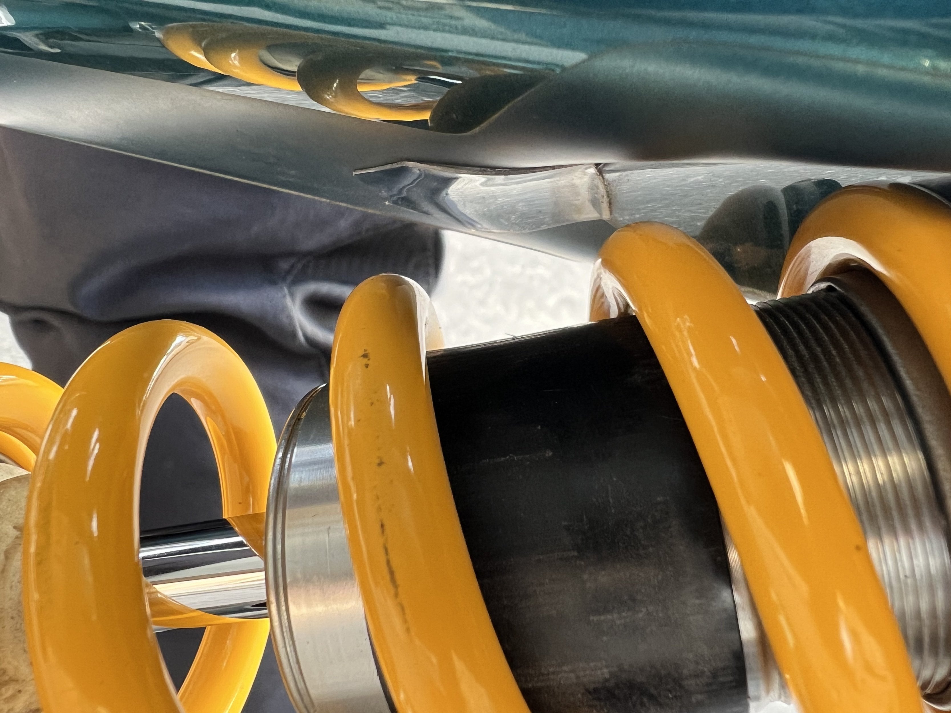

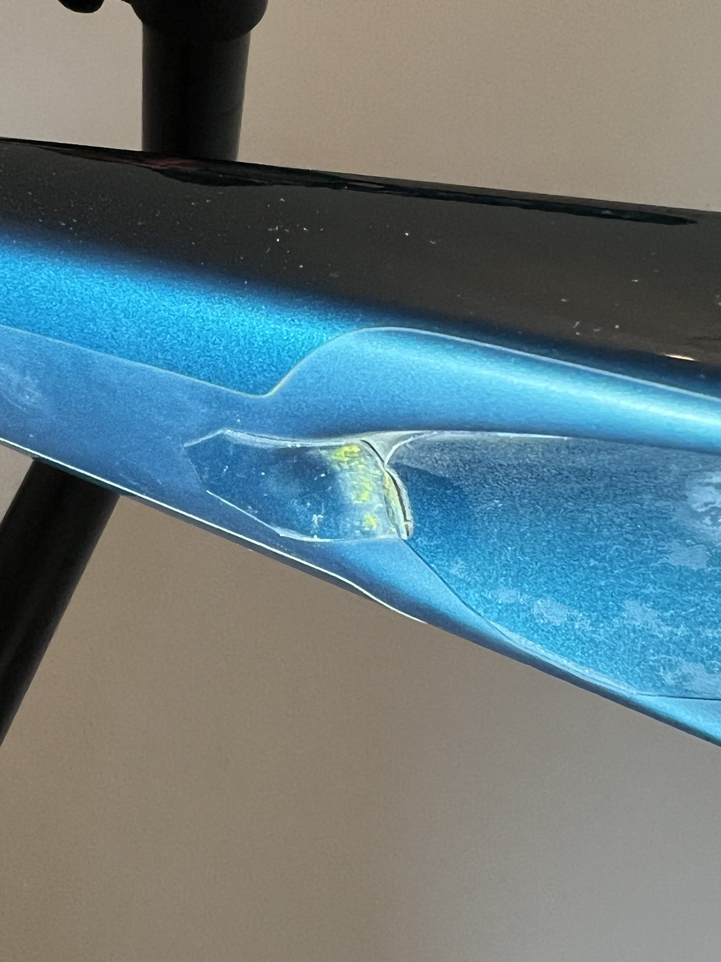

I mounted a ttx22m m2 on rise size M with a 388lb spring and in the biggest shocks the spring rubs the film that I put under the top tube. For the moment I'm using it like this but since I'll have to mount a softer spring, I'm afraid that,in the bottom out, the spring will touch more seriously.
In this photo you can see the contact marks both on the spring and on the film.
the shock absorber is 210x55 with standard bushings and a 18075-07 spring (the one indicated by ohlins)
