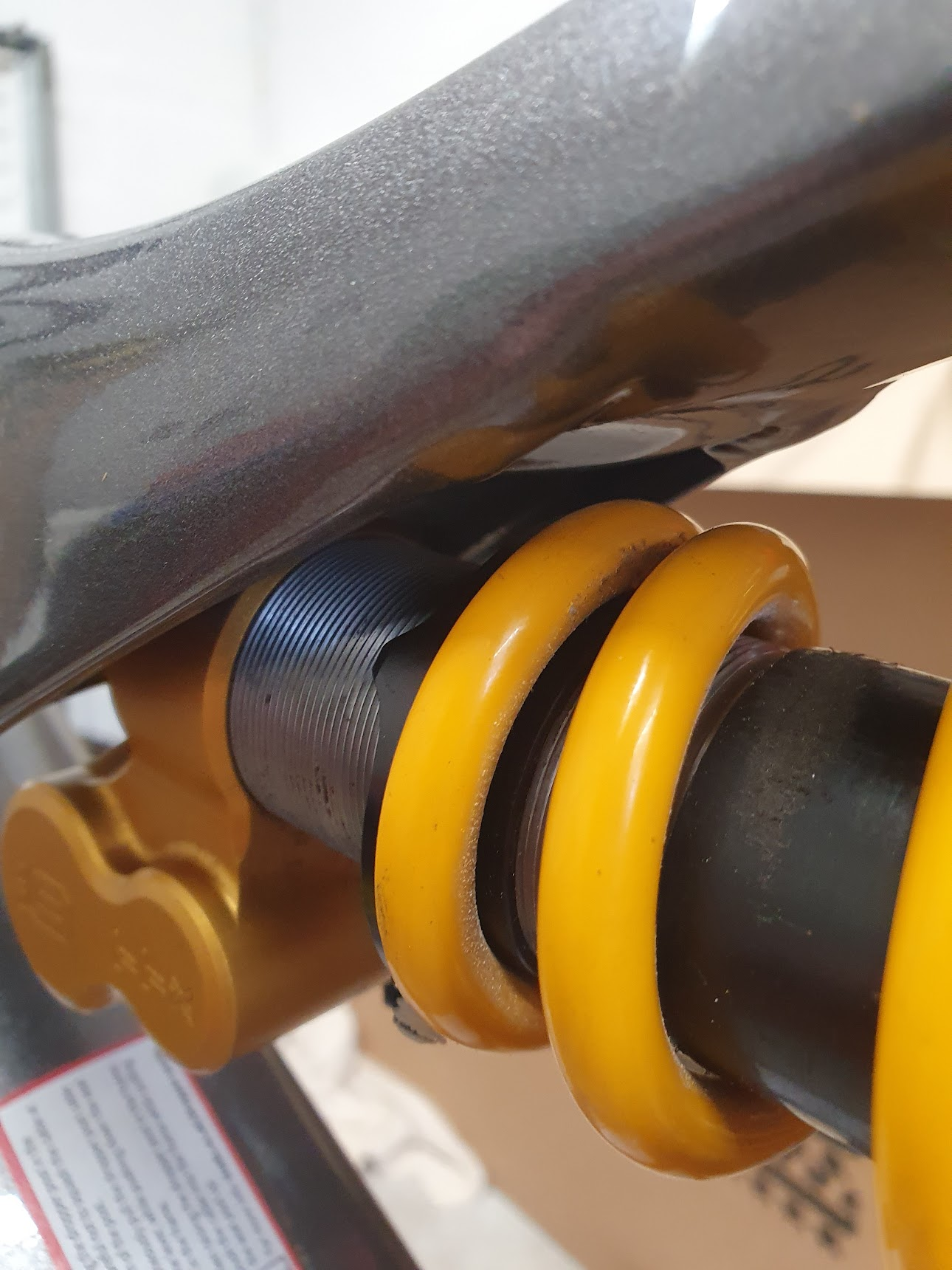

Is there a definitive answer as to will an Ohlins Coil shock fit a medium frame? searching here there both yes and no's posts.
What I can gather some have have it fitted with Ohlins spring, some have it fitted with ICHU spring (smaller diameter) and some say no it won't fit. Those who have fitted it can you post a pic up of the clearance on frame.
Very much pondering buying a Rise after trying one for size and car park pedal, dealer wouldn't let me take away to demo as it was sold. I 'm looking at base model and transfer the majority of my components across inc my Ohlins coil.

Well it fits, bounced hard in garage but not ridden as I've stripped the bike down to frame to add my own bits. No sign of rubbing yet....

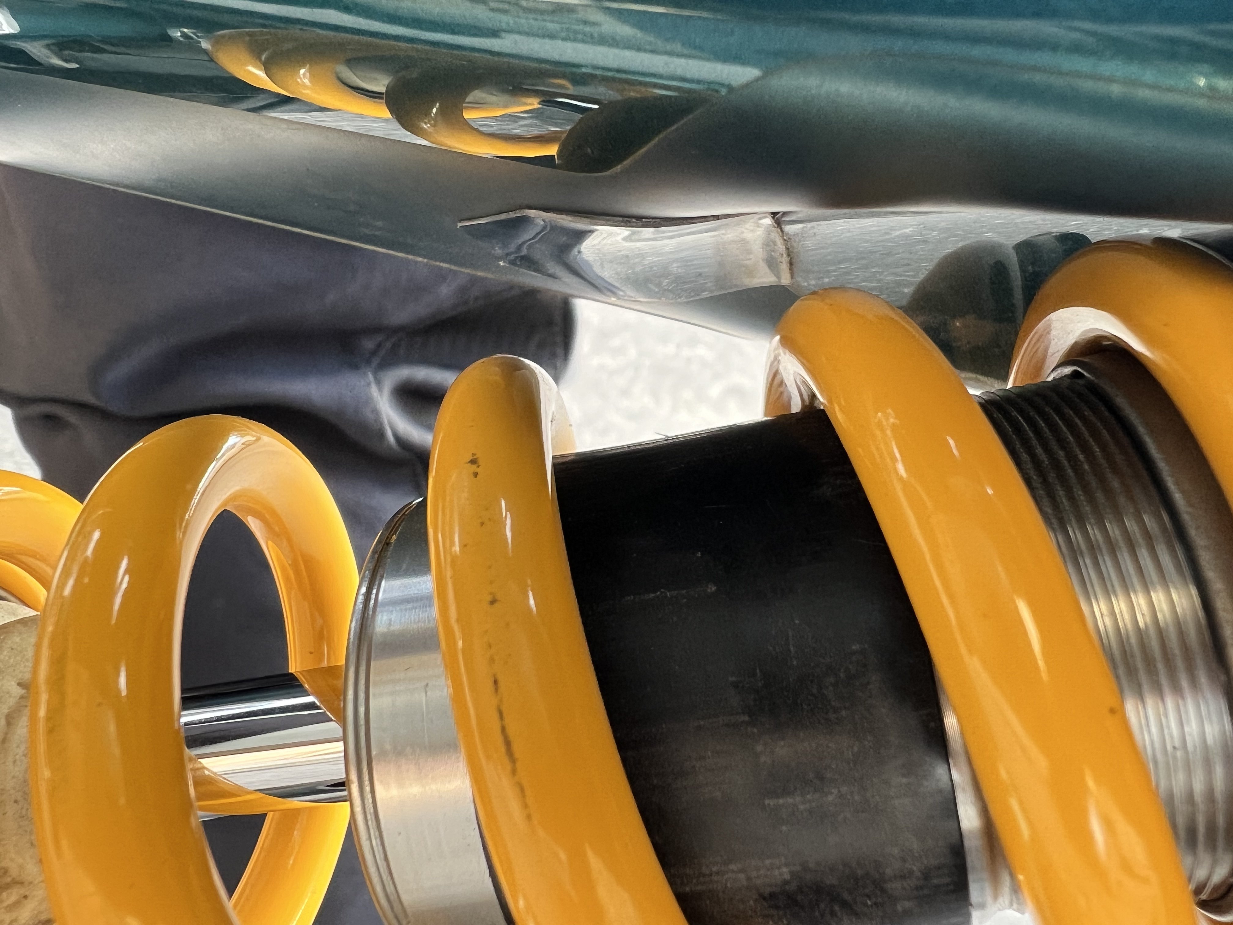

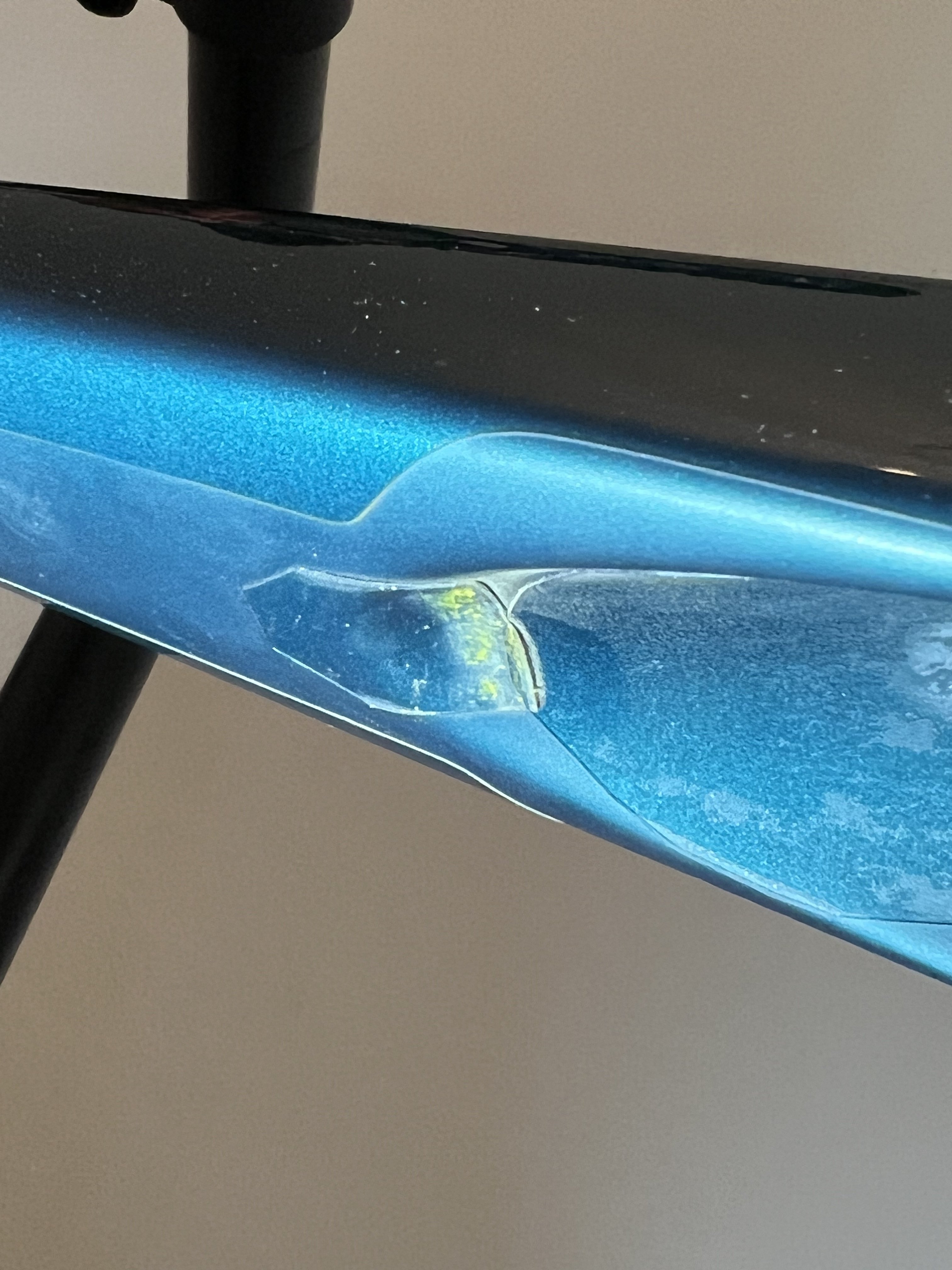

I mounted a ttx22m m2 on rise size M with a 388lb spring and in the biggest shocks the spring rubs the film that I put under the top tube. For the moment I'm using it like this but since I'll have to mount a softer spring, I'm afraid that,in the bottom out, the spring will touch more seriously.
Lumassa
Feb 15, 2023
Italy
In this photo you can see the contact marks both on the spring and on the film.
the shock absorber is 210x55 with standard bushings and a 18075-07 spring (the one indicated by ohlins)
