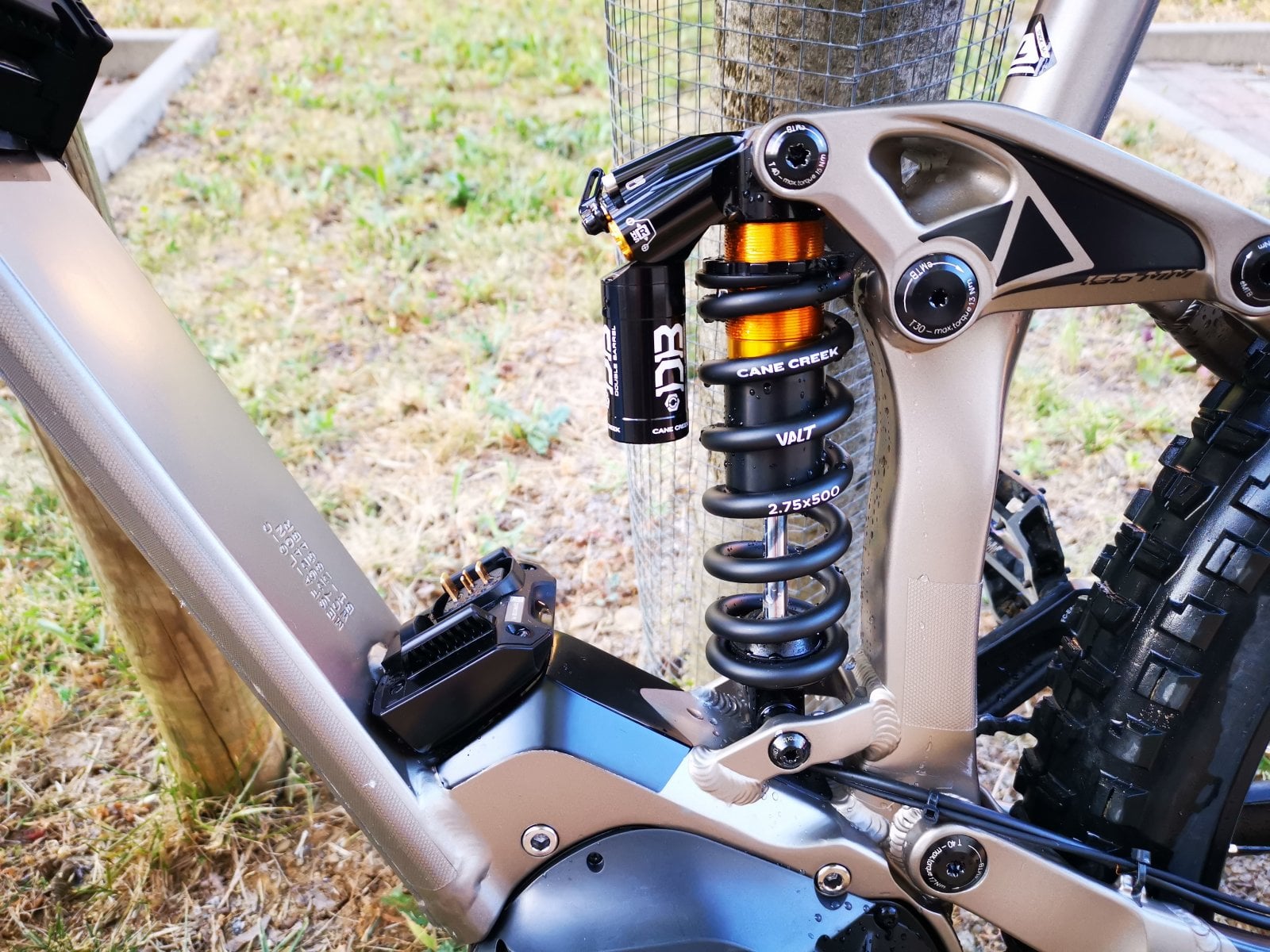

I have an opportunity to buy my mates DHX2 coil shock. Only thing is that its 150mm of travel instead of 155. Will this fit, or should I get it rebuilt to 155mm?

The travel on the bike is not so relevant, the eye to eye length of the shock and the travel is important. 205mm x 65mm is the correct length to fit the eone sixty. The tune in the damper also needs to match the leverage ratio of the bike which makes rear shocks a tricky one as well

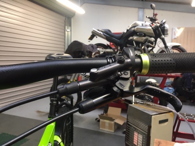

Ive made a few changes. I want to change the stem.
Id like to keep standard bars...although a different bend would solve it, I'd like to keep it simple, and internally wired if possible..
Issue seems to be that the wiring exits the bar at the stem clamp...so choices are limited by this but not only this, also bar size (35mm ). But here's the kicker..
Im not familair with the fork stem arrangements. Can I use a less tall stem and leave a gap between the stem bottom and the spacers on the steering post proper..? EDIT- Perhaps they aren't spacers but the clamping/lock rings that set the bearing tension..? Or do I need to get a stem with stack height of 40mm? Then there's the whole 40-50-65mm thing. Id like to keep it stock @35mm(?) What I want is a rise of say 5-10mm...so an angled stem. 40mm stack height. rise of +5mm, cut out to clear wiring, 35 bar and 35mm long.
Any suggestions. Am I over thinking the fit and finish...
If I fit this..do I have to drop the steering stem through it leaving 4mm proud, thus only gaining 1mm? Nukeproof Horizon Stem | Tredz Bikes

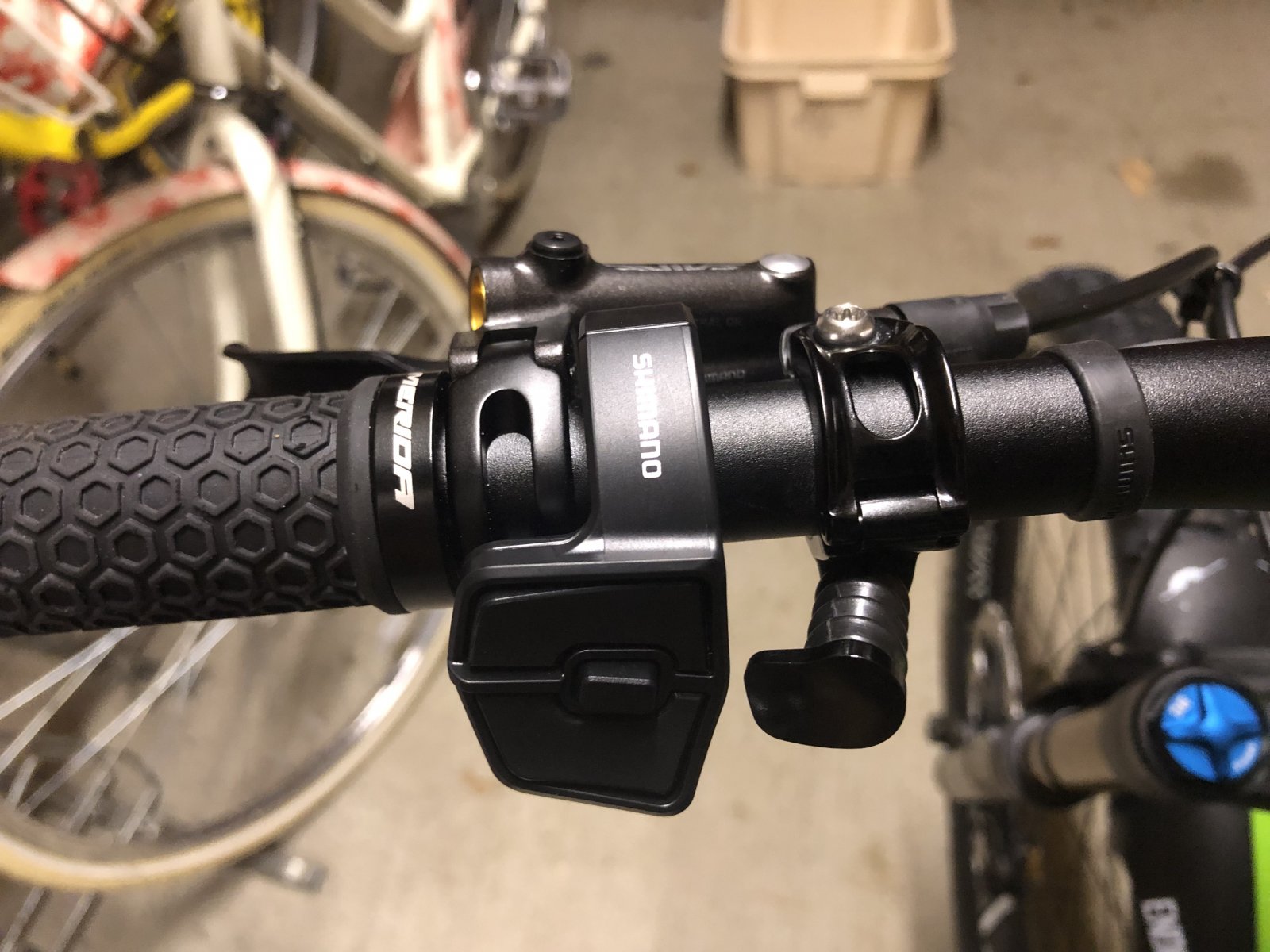

I have fitted E6010 switches left and right; much easier/faster to use and cleaner looking than the trigger shifts. Also, this then allows the dropper button to be moved from above the bar on the right to below on the left, where the ergonomics are much better.

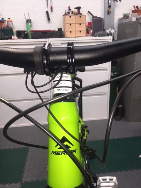

What I was hoping to learn of is a stem that will not obstruct the wiring to the bike computer as they exit the bars. I want to lift the bars- I feel like Im over the front wheel an excessive amount. Its geo, I know...handling isnt the issue however..its cockpit ergonomics..kd like to lift the bars some and rotate them back a bit...
I ordered that Nukeproof. Im already regretting it as the description claims reversible but looking at it, the cut out that would clear the wiring is only on the top....
I hate internet shopping- cant beat having the things in front of you!!
EDIT : Cancelled the Nukeproof stem and ordered DMR Defy 35+ Quite a modest stack height at 27mm (oem 40mm) I hope its man enough. I'll keep yous posted with some pics when it all gets bolted up..!:coffee:

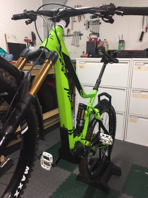

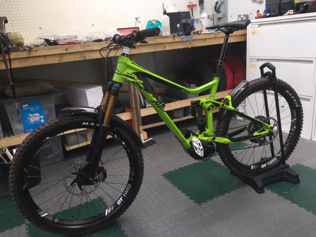

Progress so far..
Anaconda both ends..
Saddle
Bashgaurd from Rallysaloon
Stem ( not the prettiest but it gets the baars up and allows the rotation freely without snagging wiring exit for display)- found some trick spacers too..
Pedals ( match the spacers)
Mudguards ( jeez its muddy without !)

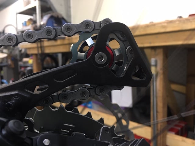

Some decent jocki wheels with ceramic bearings...
pics...

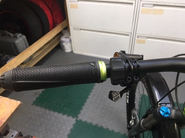

Finally fitted the E7K controller and underbar remote for the dropper...swapped out the grips whilst there also.. So much mess dealt with in a simple switch change.

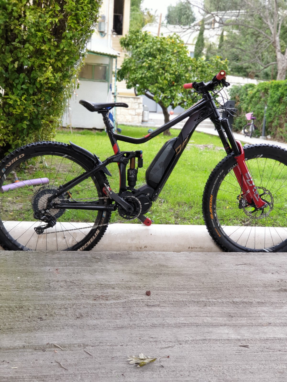

I have done a few changes

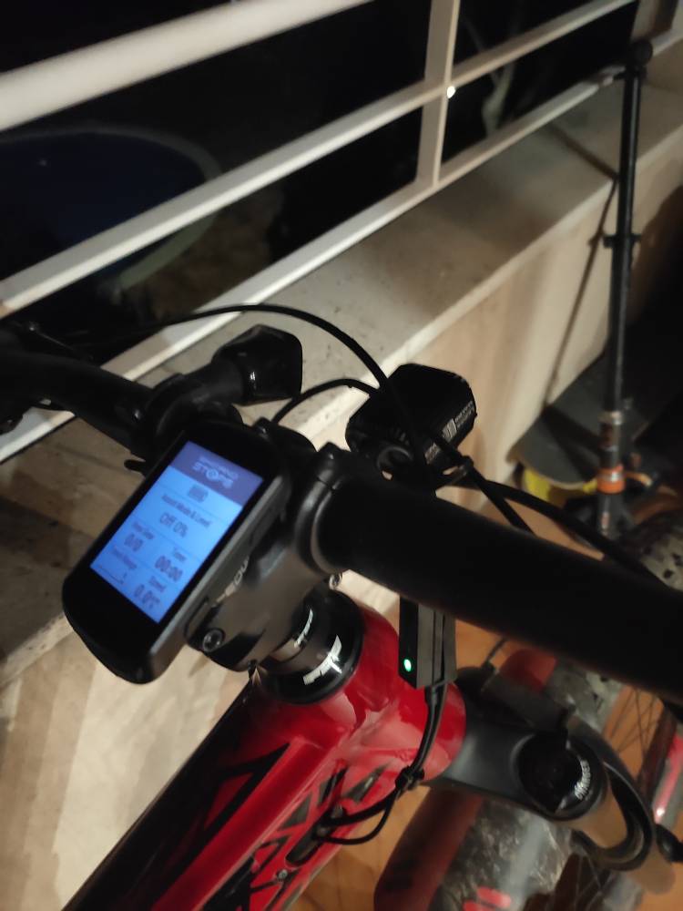

Lezyne macro 1000 connected to the motor, internal cabling
Ew-en100 junction replacing the screen e8000
And GPS showing battery status
Next comes to replace the left gear switch with the e7000, and source me a proper switch for the dropper :)
The E6010 switch is better; it has a third (middle) button which scrolls through the functions on the display, so you don't have to take your right hand off the bar to use the tiny button on the actual unit. This also means you can move the dropper post button to the left and under the bar, where is is much easier to operate.
I've fitted the same light and it reduced my range by 20km and the bike was shutting down at 2 bars. Make sure you turn the battery reserve down to 0 minutes from the usual 180 minutes. STunlocker can do this.

Were'd you get the jockey wheels/brand?

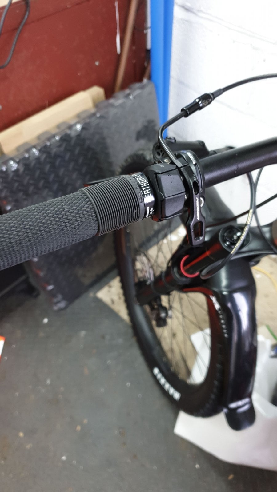

I've just finished upgrading my selector switch from an 8000 series lever style to a 7000 series selector switch. Seems to give a lot more room for the dropper lever, looks a lot neater and works well.
If anyone else wants to do this then be sure you get the 700mm cable option as you'll need it for the routing through the bars! Other than that it's simply plug n play!!

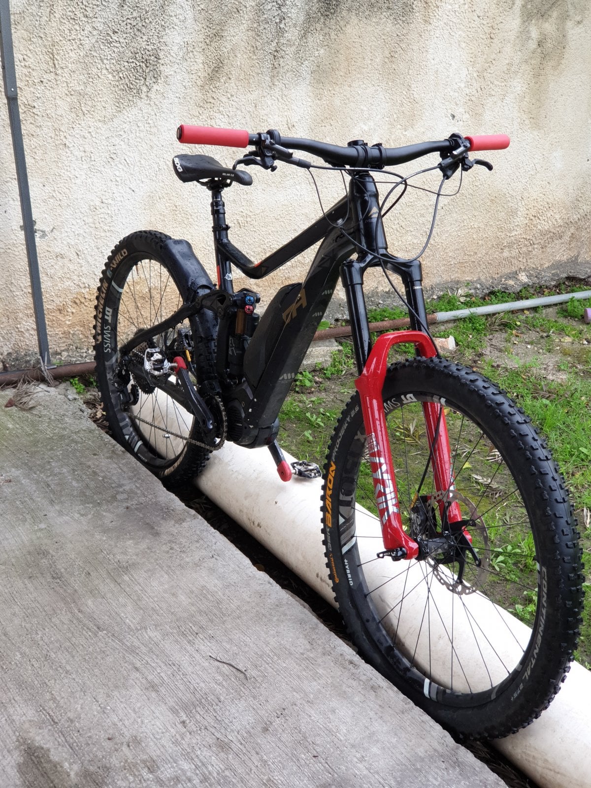

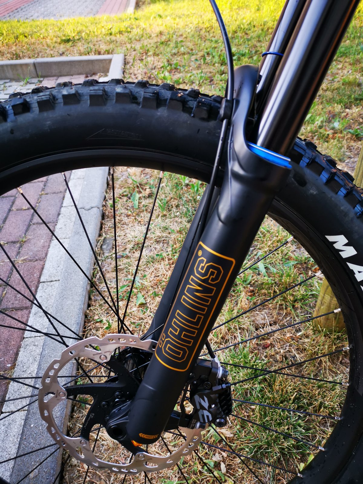

new update new lyrik ultimate 2020rct3 170mm
feels much better the the 36ebike fork .much more popair just cant stop smiling
