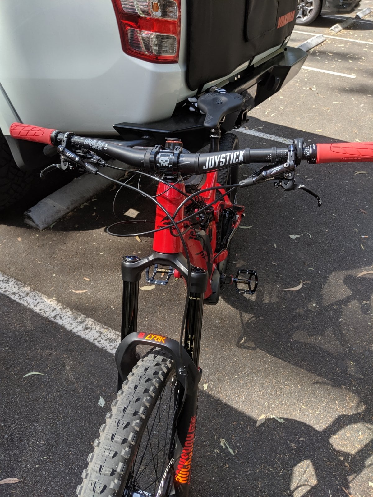

Hi all, I ended up purchasing an E-160 900E yesterday for an absolute bargain. It had 17km of carpark riding done on it so was considered a Demo. I couldn't pass it up! It's currently en-route from interstate.
The only gripe I have with this bike is the lack of water carrying capacity, I ditched the hydration pack and it was the best thing I ever did. However there seems to be nowhere to creatively hide even 500ml of water on the frame. Has anyone have an ingenious solution to carrying some water on one of these bikes? I usually run a multitool in my pocket and my phone in the other (knock on wood never broken it)
My goal with this bike is self shuttling, I am a DH rider in essence, this bike will allow me to train without reliance on a driver or pushing up the hill.... more ridin = more fun :)
My 'analogue' ride is a Stumpjumper evo which compared to the Merida is like a stretched limo in wheelbase and is much much lower in BB height. However I think the mullet conversion on these bikes makes sense so I will throw my spare 29'er up front for a bit more rake.
Rather than go straight for an angleset, can this Fox 36 E-bike fork be extended to 170mm or is 160mm the max travel for these? I'd like to get this bike at around 64.5 degrees ideally. I know the 29'er 36 can go to 170 as I have that fork on my stumpjumper.... unsure of the e-bike fork.
I am considering the badass box for this bike, is this a taboo subject? It's purely to aid in making some of the bigger jumps I ride that require a few pedals to clear. Not looking for doing 40kph on fire roads, just an added margin for the 2% of time I need some pedal strokes above 25kph. Anything I need to be aware of when installing one of these boxes?
Sorry for all the questions.

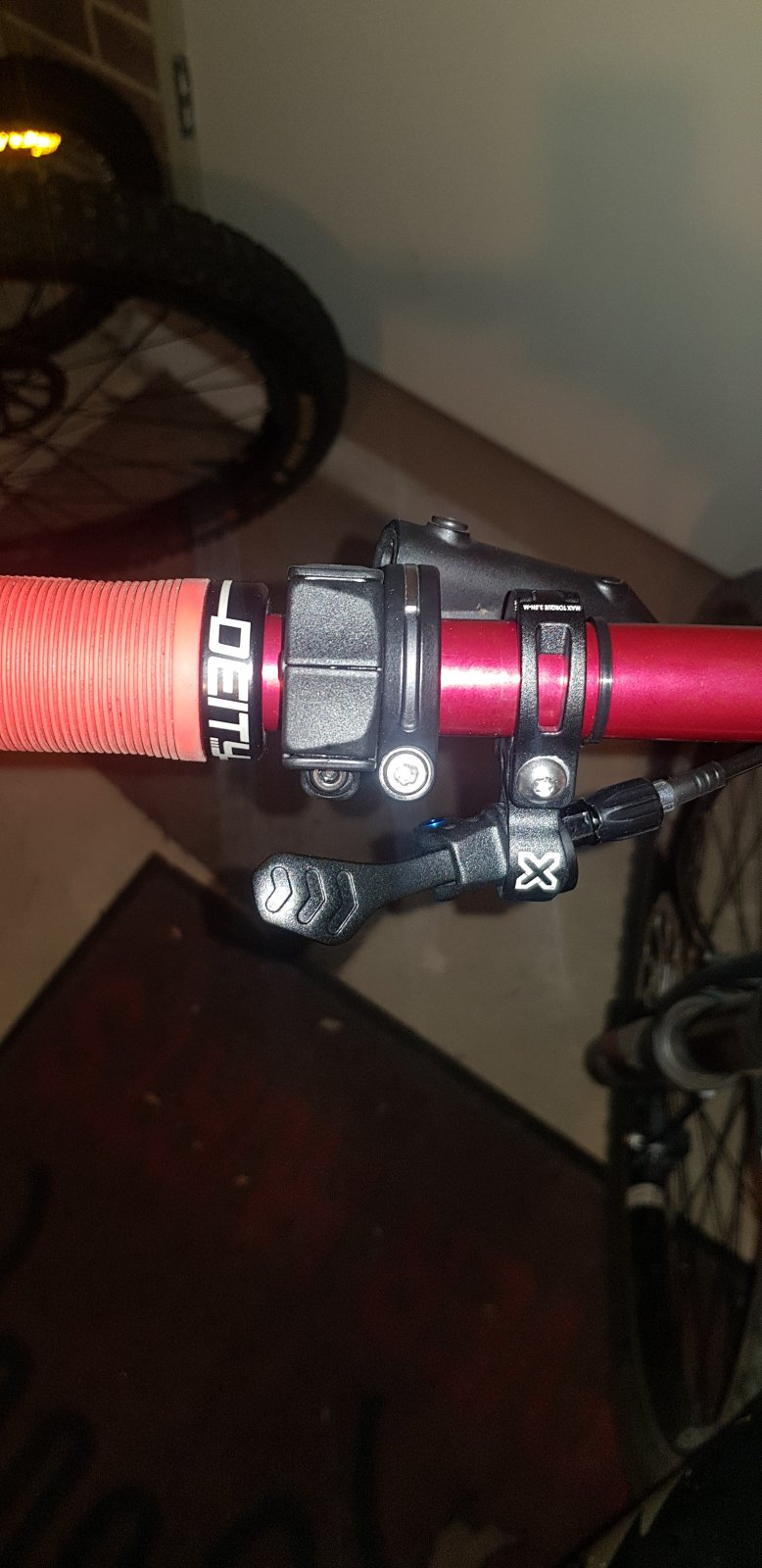

I put a 150mm kashima fox transfer on today along with a pnw components lever. So much nicer that the rubbish reverb.
You need to drop the motor however to do the dropper routing which was a pain. Took approx 1.5 hours all up taking my time. Well worth it. I’ll get some pictures tomorrow. Looks so nice with the black and gold.

I went with the pnw remote. Works great. The transfer for me is so much better than the reverb. I have had really bad experiences with that dropper on other bikes (4 warranty claims in a year) so I thought I would get rid of it early on and get a couple of hundred bucks for it. Plus the transfer looks cool haha.
The hose and fitting would snag something for me on removal hence the motor out job. It wasn’t all bad because it gave me a good idea of how it all goes together and the very basic wiring. I wouldn’t have any issue delving in there again now I know how relatively simple it is. I also tidied up the wiring a little and waterproofed some connections somewhat.

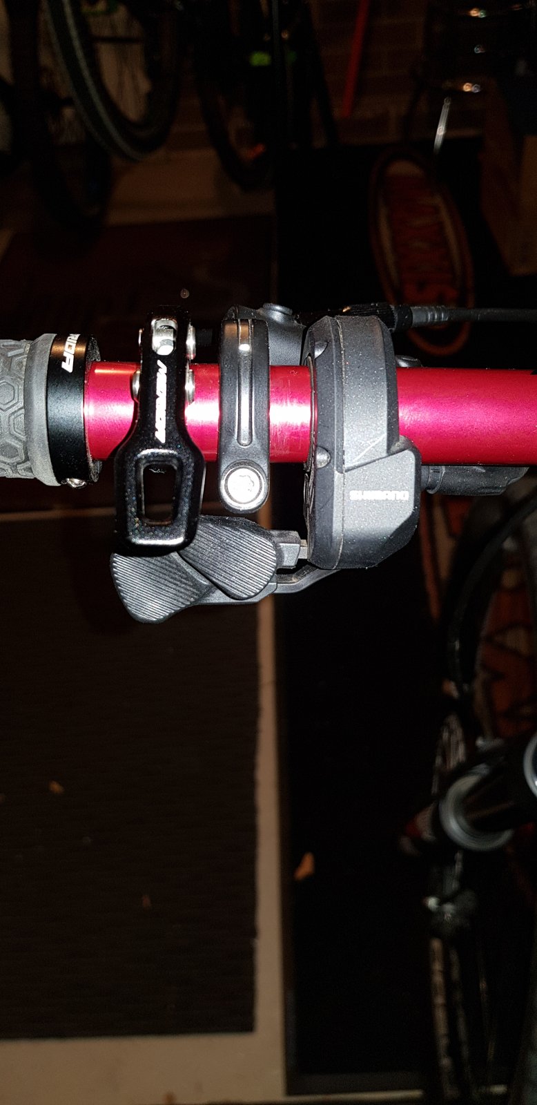

Does anyone here have their original mode shifter lying around after an upgrade. I broke the casing on mine and the inner magnet fell out, gone for good. Based in NZ. Keen to take your old one off your hands.

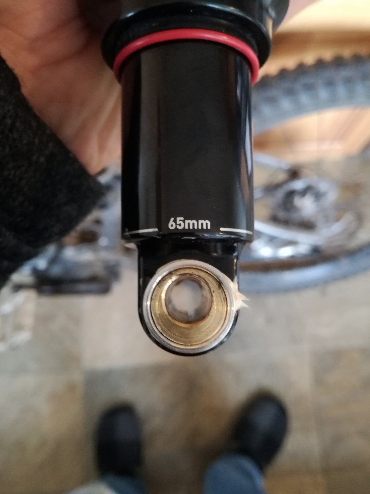

Hi all.

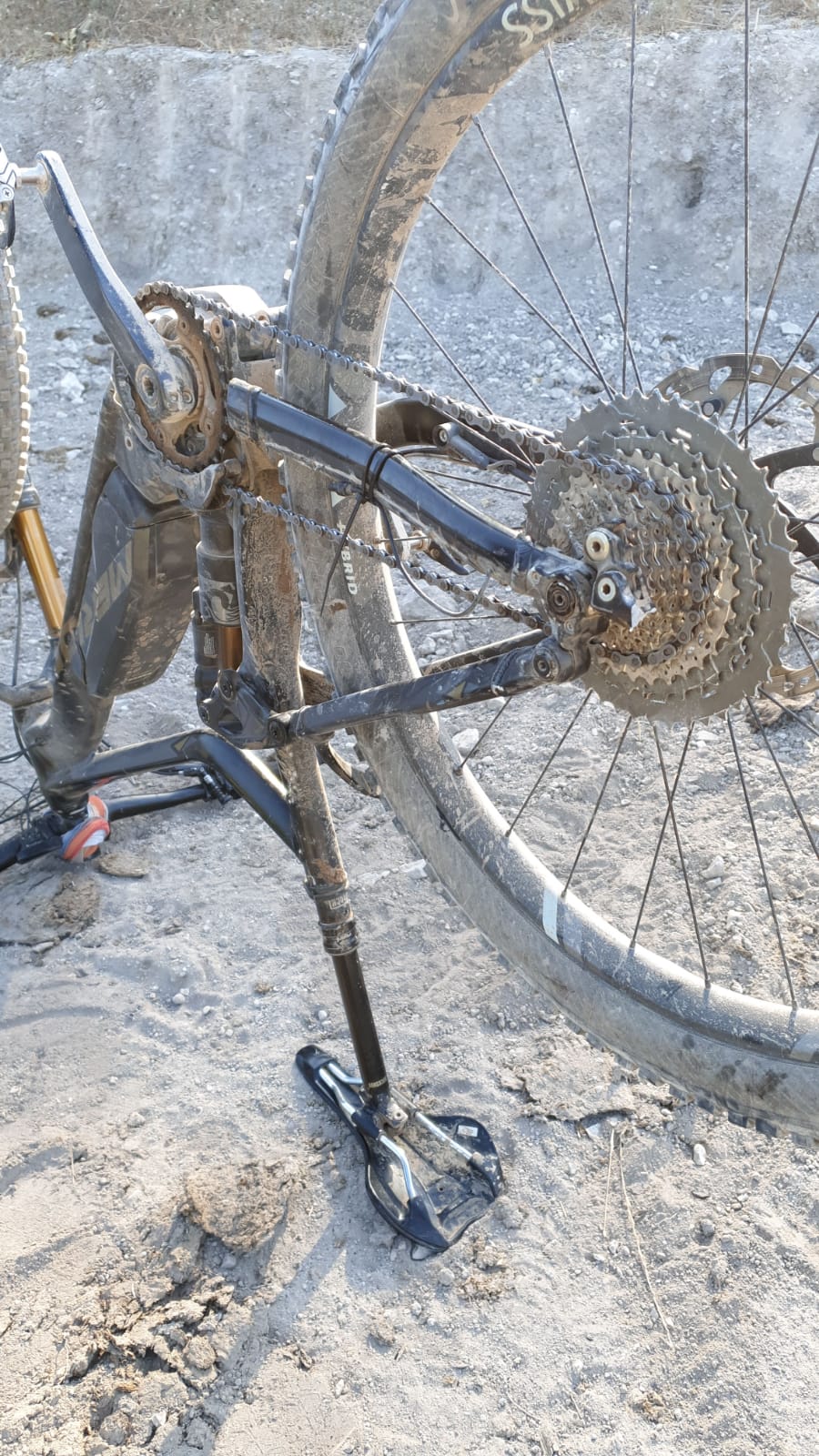

I had an issue where there was vertical play in my rear suspension. I narrowed it down to a bent lower shock bolt (probably caused by casing a jump too hard with the shock too soft/not enough volume spacers).
Ordered a new shock bolt from local Merida dealer: The Merida part number you require for your eOne-Sixty 800 is – 2302002127. These can be purchased from your local dealer: Find Shops - MERIDA BIKES
Ordered a new bushing, but figured I may as well order an offset bushing to drop the rear end as it's feeling high now I have 165mm XT cranks. Since the shock is trunnion mount, you can't actually change the top. The shock hardware is 40mm x 8mm, which is all you need to know to order the bushing from offsetbushings.com. Unfortunately as the bolt size is 8mm, and you can only get a bushing for the bottom, you can only drop the shock by 1mm (=2.4mm @ rear wheel, 1.6mm @ BB, 0.1deg HA). Obviously the BB height change is negigable and I can't notice it, however I figured since I needed a new bushing, I may as well get an offset one and add an infinitesimally small amount of performance to my bike!
Anyhow, just FYI in case you bend your lower shock bolt - vertical play is now gone.
