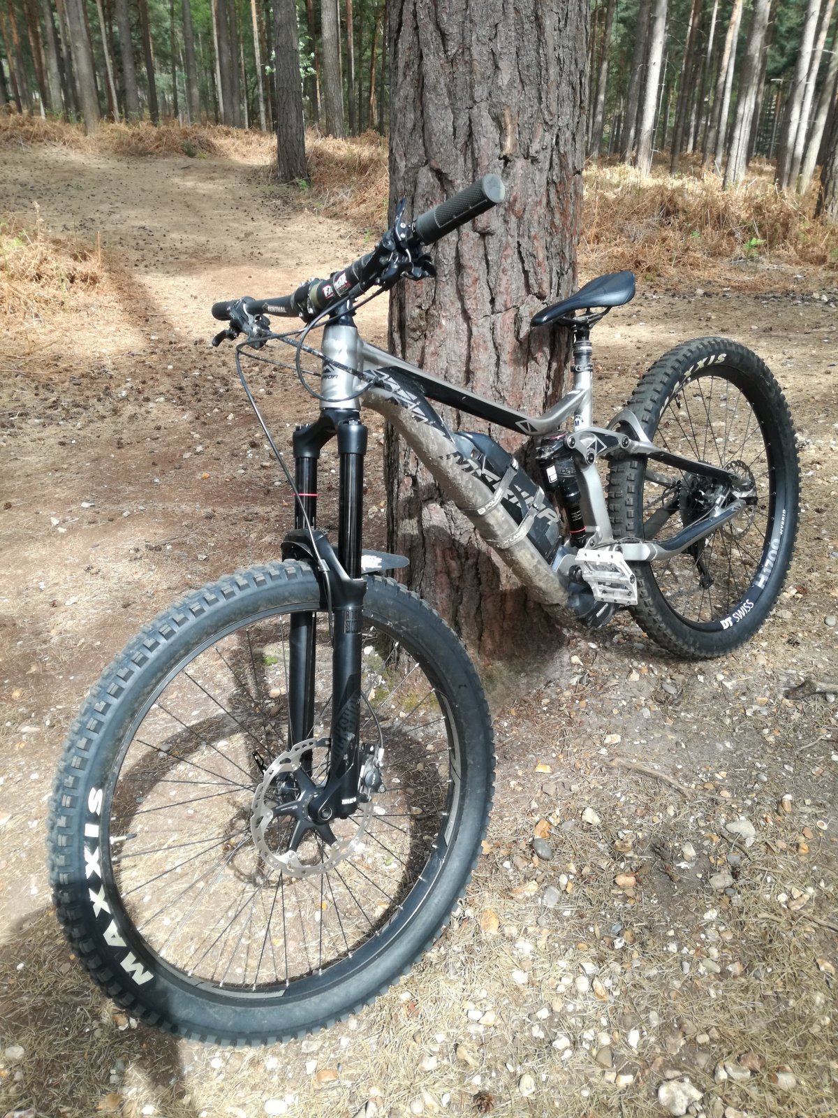

Hi All,
Just wanted to share a few setup changes made to my Merida eOne-Sixty 800:
- Increased bar width from 760mm stock to 780mm, as I found that there wasn't enough leverage to man handle the weight of the bike. This was a significant improvement for me.
- Polaris enduro straps around the battery to stop the system turning off on big drops. I took the battery holder apart and couldn't see anything wrong, and I saw some other dude who had done this, copied him, and it works a treat!
- I tried 29x2.5WT Minion DHF front, but didn't get on with this. Front felt too light, despite dropping the stem, and out of balance with the heavy rear. I like the grip and progressiveness of 27.5x2.8 so I went back. Hoping they'll make an Assegai in 27.5x2.8 at some point, because I feel the DHR2 could do with some intermediate knobs to reduce the sliding as you transition to the edge knobs. I like the feeling of this sliding at the rear so DHR2 at the back is great.
- DT Swiss H1700 spline rear wheel. The Shimano hub broke on me, and I'm glad about it, because the stock rims on this bike are rubbish and I was forever truing them! The rear wheel flex was terrible when loading the tyre up or doing cutties. This new rear wheel made a night and day difference. No more nasty noises from the rear, with a really solid feel. I wouldn't throw away a good wheel, but when the excuse came to upgrade, I have to say I'm delighted. Hub engagement is also really nice with the spline hub, whereas the pawls on the shimano would make a noticeable clunk when they engaged.
- 180mm Debonair and RC2 damper (see comments above about this). Dropped the stem to minimum height (without removing the cup thingy) and reduced bar rise from 20mm to 10mm to rebalance the higher front end. Sensational. Feels better than my Fox 36 Grip on my other bike. Previously the fork felt like it would stiffen up on rough terrain, now it feels like butter, and has plenty of mid stroke support for pumping etc. Highly recommend!
- 2.5 Gnar Dog volume reducer fitted to the shock. As standard the shock had 2 volume reducers. I think you can run 3.5 max (Gnar Dog + one of the stock reducers), which is where I'm running now. Feels super supple, and can now finally take big hits without bottoming out hard - eBikes land hard, so this was a big improvement for me, easy and cheap.
- 10 speed Zee Mech, Deore M6000 I Spec II shifter (fits nicely under SLX lever clamp) and M771 11-36T cassette. My previous drivetrain chewed itself up, but I was never happy with the shifting performance. Shifts feel much better now, and I've saved approx 100g of unsprung mass by not having the 46T granny, that I didn't need anyway as I found I had better traction performance in the 37T cog. Now I only have the ratios that I need and super shifts. Word of warning: there is only just enough capacity on this short cage mech to run in the 36T ring at full compression, so make sure you take the air out of your shock and test the chain length at full compression in the 36T gear before cutting your chain. I found that I only had 1 link to play with (compared to chain in 11T and no compression).
Hoping the Merida dropper will fail soon so I have an excuse to replace that. Never liked the unpredictability of it, or the lever!
Very happy with the Merida overall. Can't even describe how much fun it is to a non-ebiker. Happy riding everyone!

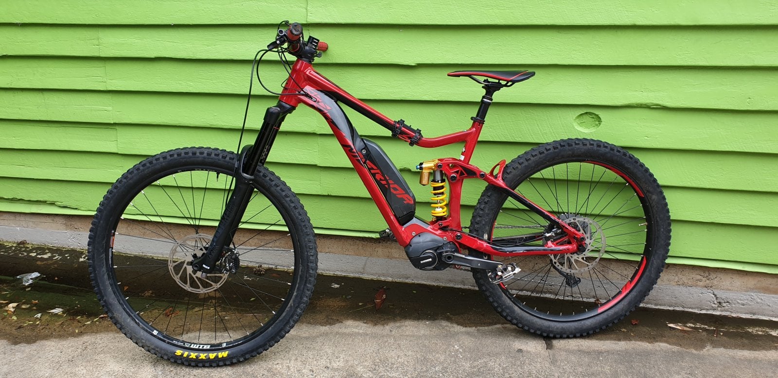

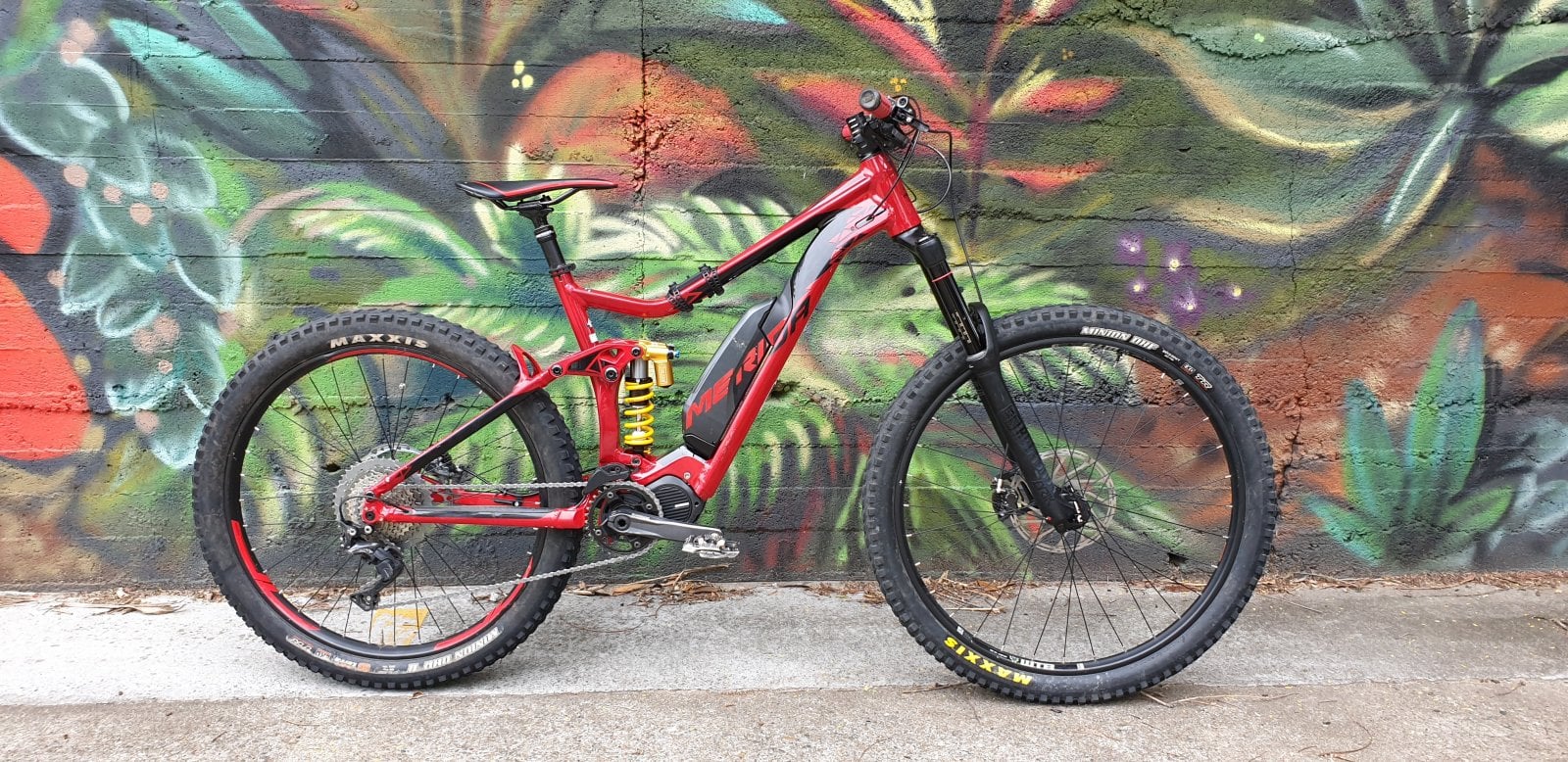

A few suspension upgrades for the eOneSixty 900
- Lyrik upgraded to 180mm Smashpot Coil + RC2 damper
- 29er front wheel running Minion DHF 2.5WT
-> roughly (phone app) puts head angle at 63.4°
- Ohlins TTX22 rear Coil
- e600 switch
- XT 4 piston front brake
First couple of rides have been awesome, traction is off the charts and still goes uphill alright. Just need to add a 185mm Revive dropper and some RaceFace bars to round it out.

That's a really sweet build.
Was it easy to fit the Ohlins TTX22? Is there any way to increase rear travel a little bit? I noticed when I let all the air out of the shock that the rear suspension could move a little further.
How does it ride with coil vs air? I found bottoming on jumps to be a huge issue and fitted max volume spacers in the shock. Is bottoming an issue?
Now I’m gaining more skills on the bike and challenging myself I regret not getting the longer travel 160 over the e120 that I own.

good... the only think I see is.. do you like having differents brakes front and rear?? the feeling braking is totally different.

Thanks.
Not much trouble to fit it, just took the lower hardware off the stock shock & swapped to the coil. That said the suspension shop did the swap so they know their way around it those parts.
Coil gives more grip across the board so more noticeable in corners than jumping necessarily, but still I find more support on the bigger hits too. Haven't found bottoming an issue on my bikes with coils.
We didn't try to add more rear travel. 160 plenty enough for me.
I'm 180 and ride Large.
XT front and rear but 4 piston on front and 2 piston rear, both on 203mm rotors. I'm liking this setup but I am more of a front biased braker so it suits me. I have another 4 piston XT cailper that was to upgrade the rear but I don't think I need it.
