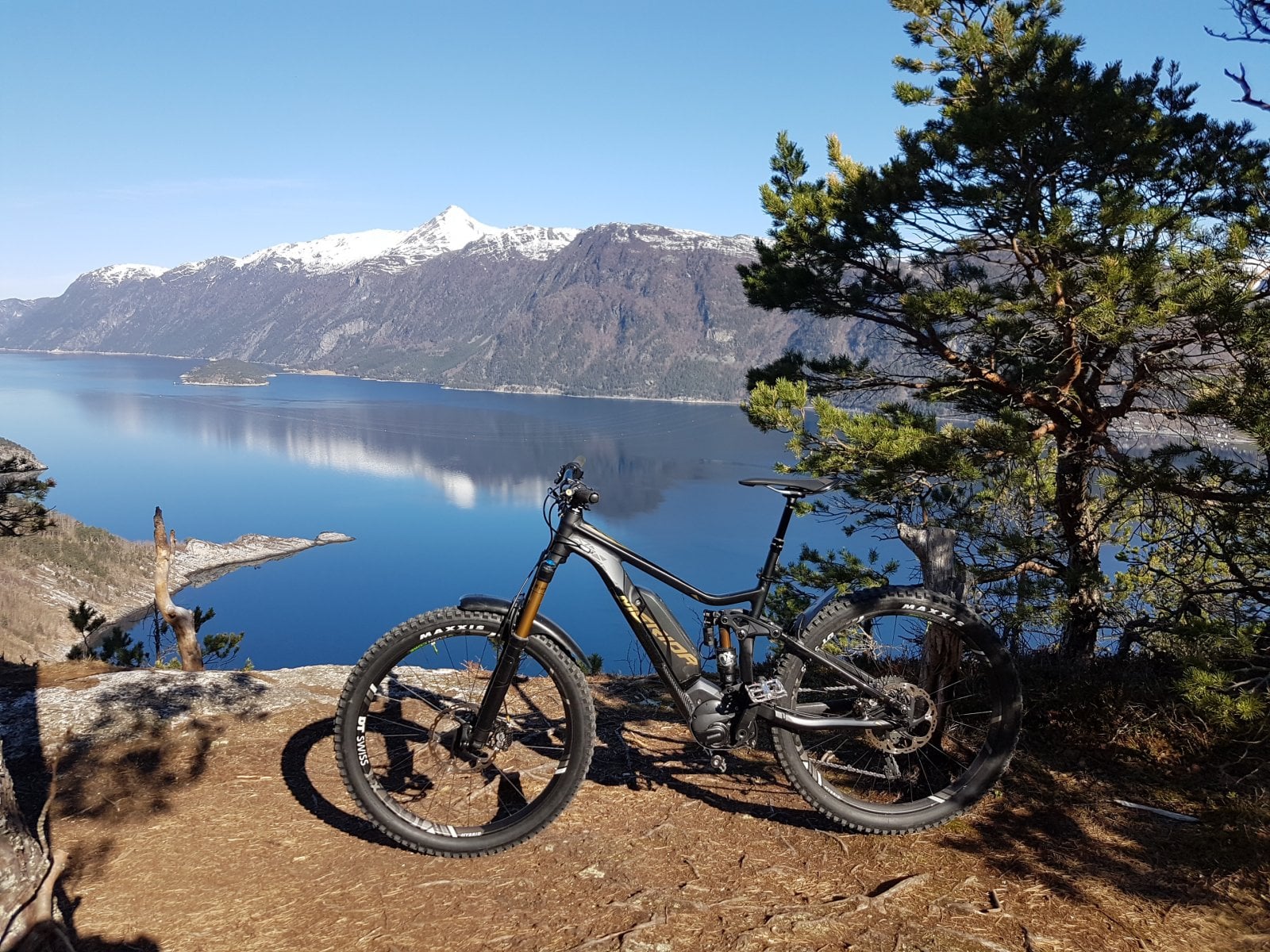

I've read a few people have tested this and generally prefer it. I've ridden the original 2.8" DHR ll rear and both 2.4 and 2.6" DHR ll up front. If you can find a 29x2.8" I guess that wil fit too. The rear can barely take a 3.0" (75mm) tyre. Some 3.0" tyres are bigger than others, so some may not fit. I wouldn't go any bigger than 2.8" rear for my use.
As i am new to proper ebikes, i compare it to manual bikes constantly as i ride.
One of my main thoughts is i think these Emtb's dont need as slack geometry due to the weight placed low, compared to manual bikes.
This bike takes me down pretty gnarly trails with confidence i must say!
And that's while still feeling playfull and poppy!
Ofcourse, slacker and even longer would be better if youre only goal was to plow rock gardens and are willing to sacrifice playfullness, but seriously this bike even does that well!
What are youre thoughts guys?
Are people too hungry for hype's and numbers, and forget how they really want a bike to ride? Sometimes i think so :)
My bike, upgraded with 155mm miranda crank arms, 2x cushcore + a extra battery.
Love it!

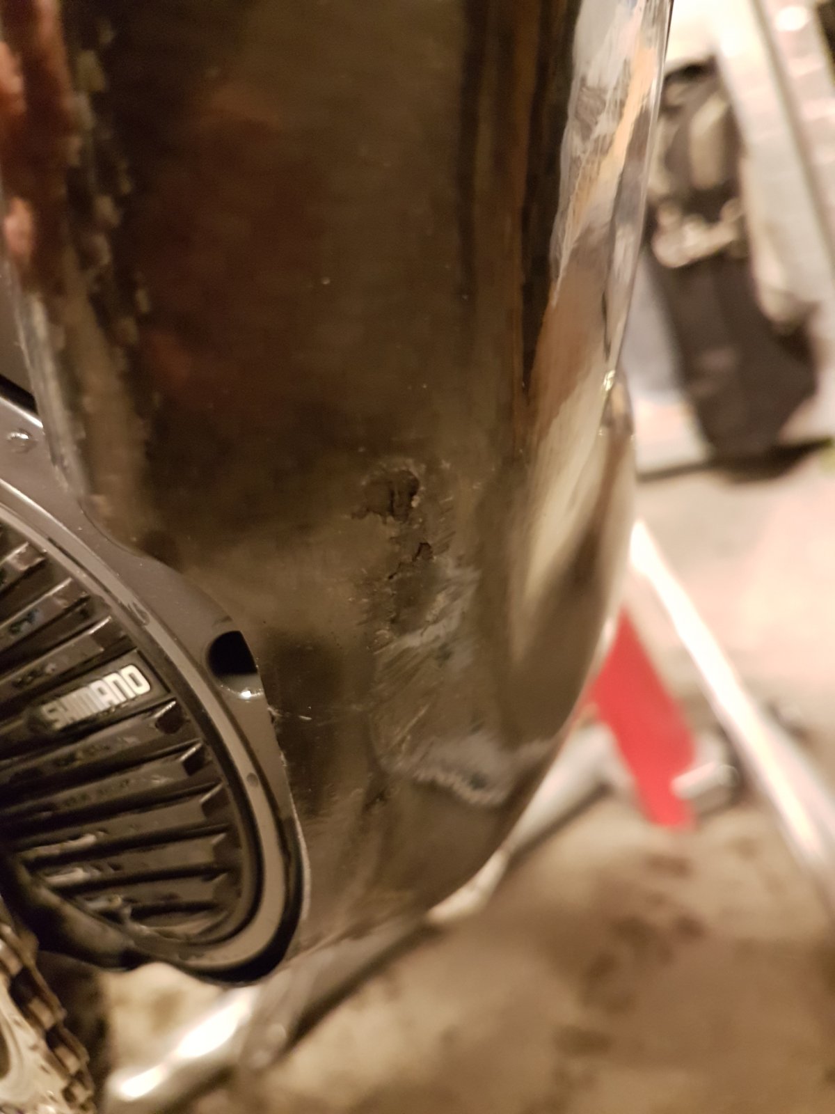

And heres why you should install a ftame protector... A big rock kicked up into my lower frametube yesterday at high speed.. Didnt sound good at all.. Would be a huge scratch, or even a dent in the frame without the protector..
Hard to show on camera, but the carbon got some damage through several layers, and cracked alittle.

I just saw your post with the carbon frame protector. Could you tell me where can I get this or a similar one? Unfortunately I hit a rock last week with my frame and now I'm afraid if it happens again...
You need to think about what you want to protect, cosmetic, stones flicking up or full on bashing the motor on a fallen tree, big rock etc

I’ll not put a link to my bash guards as the internet police will come knocking at my door. I’m sure someone else can point this chap in the right direction though ?
We have spoken about this before but as you have stated that your guard has no clearance between the motor & the frame ( and being plastic will have some flex EDIT thus delivering the impact, although dissipated, directly to the motor /EDIT)it doesn’t offer the total protection of a proper bash guard, still better than anything I’ve seen so far though.
We have spoken about this before but as you have stated that your guard has no clearance between the motor & the frame ( and being plastic will have some flex)it doesn’t offer the total protection of a proper bash guard, still better than anything I’ve seen so far though.
Two years of testing / selling and no one has broken, cracked or complained that they don’t work plus KTM use the same material (actually thinner than mine) on their enduro motorbike sump guards is about as near to giving total protection in my opinion. Thanks for your opinion though.
As I said your guard is the best I have come across, I believe a small gap between the guard and motor would make it better ?
Out of interest do you think using rivnuts or helicoils to secure it to the frame would make it stronger although it would invalidate the warranty?
As I said your guard is the best I have come across, I believe a small gap between the guard motor would make it better ?
There is a gap, depends where you clamp the front two ties. Further up the down tube narrows the gap and further down widens it. On mine the gap is probably 2mm. I did supply the first ones with a strip of dense foam to cushion it but after speaking to the Shimano tech guys they told me the casing is designed and strong enough to “take rock strikes” so I decided it didn’t need the foam. The guard does flex which means it probably does hit the metal casing but the load is spread over a much wider area. All I can say is the bottom of my motor is in as good condition now as it was when it came from the shop which is just about two years ago.
Putting holes for helicoils would definitely invalidate your warranty. Trust me, they are strong enough, I’m 90kgs and smash through everything hard, the guard has never and will never fail. Money back or a free replacement if anyone’s ever did. ?

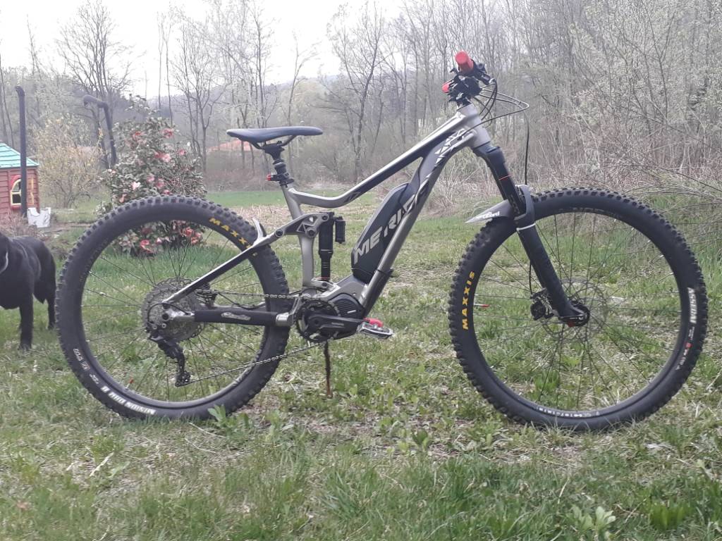

I've had about 4 rides on the bike so far about 120km all together of technical terrain.
Must say I'm in love with this bike. Every ride gets me super pumped. It took me about 2 rides to get used to the bike, and on the last ride I already started feeling really comfortable on it doubling stuff and jumping. Once you get used to the weight, the bike feels super nimble. Bunny hops well and rolls everything. The last 3-4 years I was mostly riding 120\140 mm trail bikes and I guess I forgot what a true enduro bike feels like.
Btw I installed Zee brakes by detaching the lever and caliper of the SLX brake, swapping the bolt that goes into the caliper with the zee one and reusing the SLX hose without having to remove the motor. A small bleed and everything works like a dream. There is no doubt Zee are the right brake for this bike.
I've also ordered a OneUp 170mm dropper and the Shimano E7000 switch so I can install the dropper controller under the bars on the left. In addition I had to install a different derailleur shifter as the one that comes on the bike is Ispec and mounts directly to the break, which I couldn't do with the Zee breaks. Took of an XTR shifter from another bike, couldnt be happier :)
Once I will go through the tyres I will try 2.5 assagai on the rear and maybe a 2.6 in front. Still can't figure out if I live the fat tyres or not :)
Also I was very surprised by Yari's performance. I was kinda worried it won't feel as good as the forks I'm used to (fox factory), but it feels really plush and I'm super happy with it.
