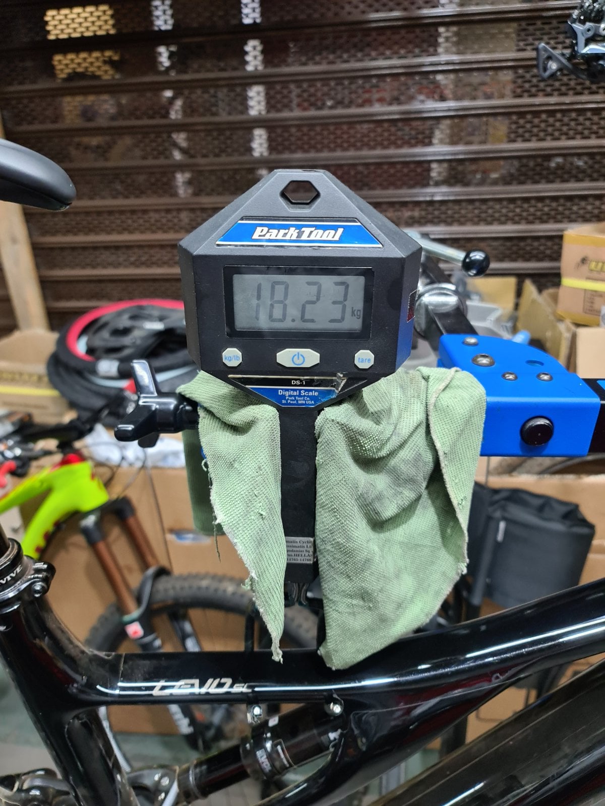

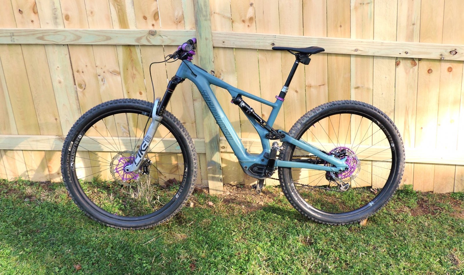

New rotors added :)
18.23 kg so far, not so bad for XL size with coil fork

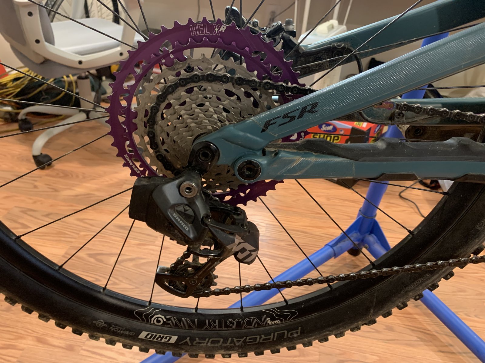

Hi! Has anyone equipped his Levo SL with the E*THIRTEEN HELIX R? Do you need a bigger chainring or is there enough space for chain/chainstay with the 30T?
It works great. The chain does not rub on the chainstay protector and you won’t need a larger chainring. Shift quality is the same as with the GX cassette I ran previously.

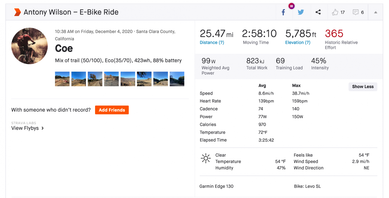

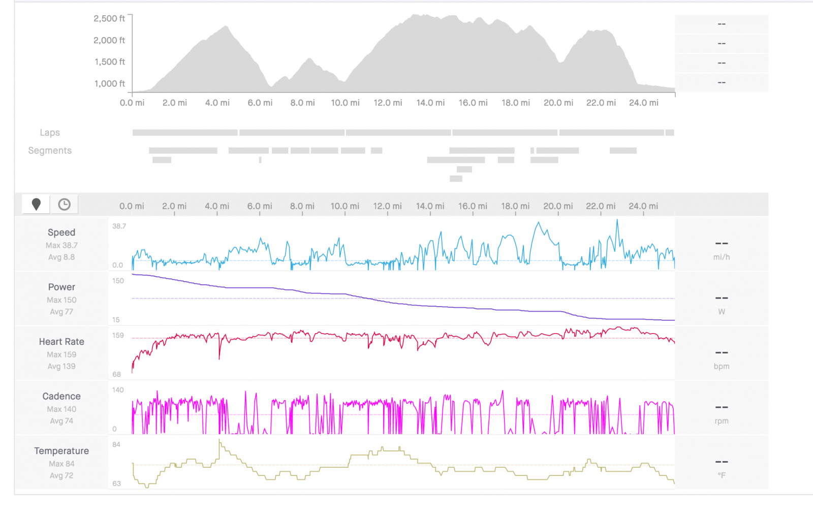

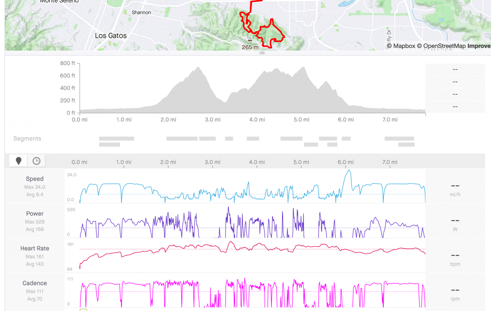

Did a bigger ride in Coe this past weekend. 25.5 miles with 5700' of climbing. Used 88% of the batteries with one RE. I'm 220lbs currently (up a tad post covid ;-)) plus probably a 10lb pack so was pretty happy with this range as I did the first 2000 feet of climbing in trail at 50/100 before I turned back down to Eco 35/70 for most of the rest of the ride. Thinking with two REs I can get up over 40 miles and maybe 8000' of climbing.
I haven't figured out how to get my power input over to the garmin's, looks like the power sensor I'm connecting is reporting the battery charge level and just declines from 100w at the start of the ride? Any tricks or something obvious I'm missing?

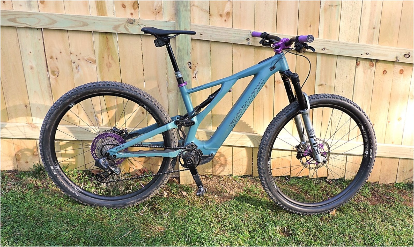

Are those the the 1/1 rims? What do you think of them? I have the same model, just starting upgrades though.
Trail S Hydra. The noise from the hub is just as annoying as the noise from the motor. I love them, and no issues.
