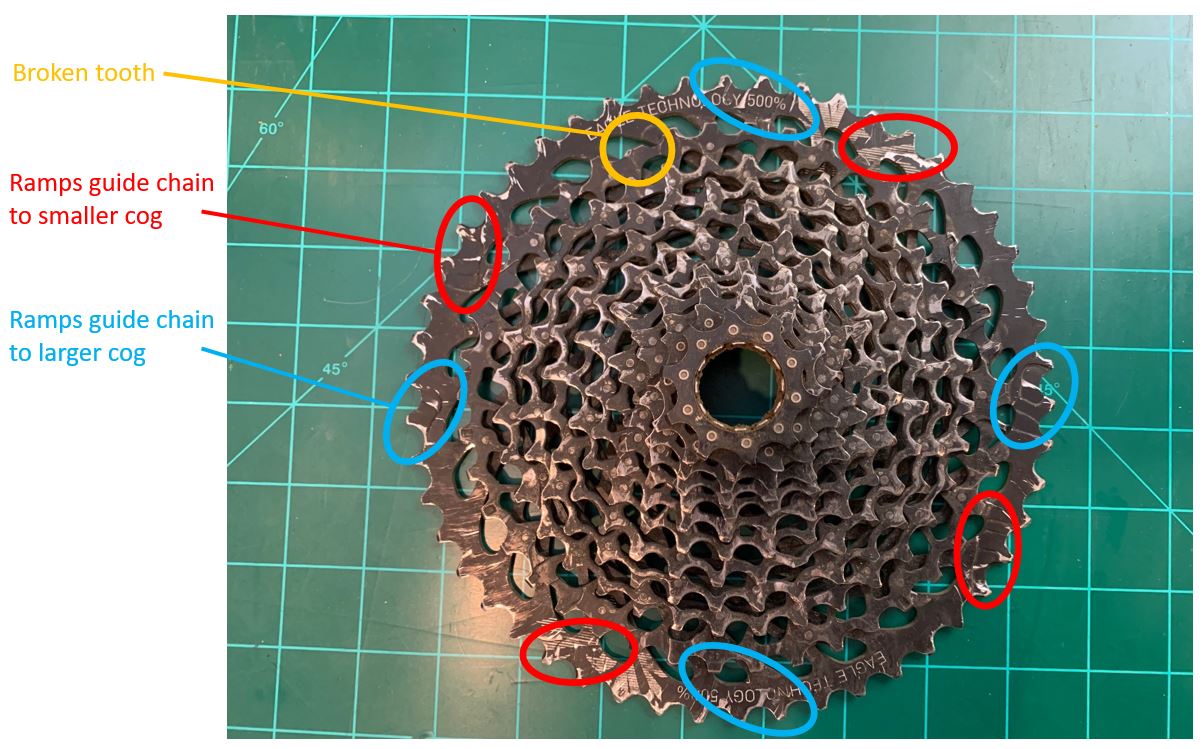

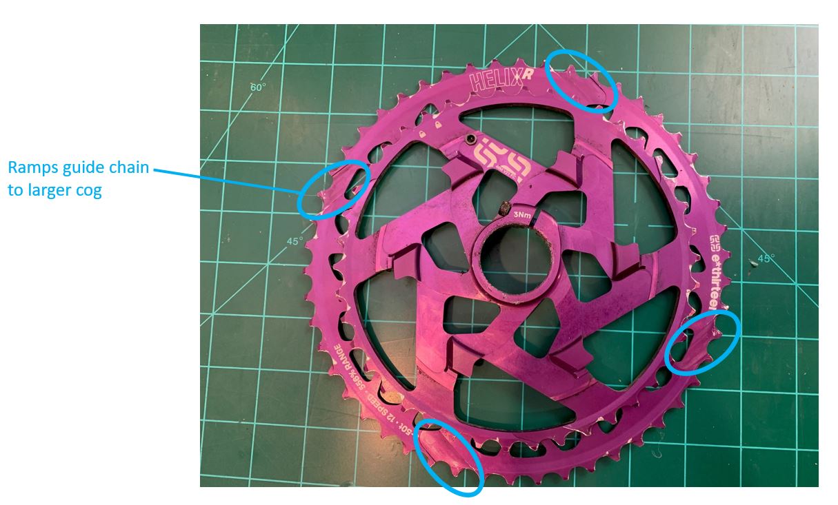

I have been running the ethirteen Helix R for a while now and have some additional comments:
- Shifts to larger cogs are similar in feel to the GX cassette
- Shifts to smaller cogs can be a bit clunky
- To get the best shifts to smaller cogs you have to adjust the derailleur to be a bit more inboard (towards the hub). Otherwise the chain wants to briefly hop to the next smallest cog before settling in the one you want. Adjusting the derailleur inboard means that in the 9 tooth gear the dreaded tick, tick, tick noise appears when the bike is on the stand. I have not heard that on the trail because I spend little if any time in the 9 tooth cog. I have tried adjusting the b gap as well as the other derailleur adjustments to fix this but no dice.
tl;dr - I think the reason for the clunky shifts to the smaller cogs is that the ethirteen cassette does not have ramps to guide the chain to the smaller cogs while the SRAM cassettes do. See the images below. Note the broken tooth on the SRAM cassette; the reason I got the ethirteen is because I wanted a lightweight cassette without having to purchase a whole new one when an aluminum tooth breaks. The ethirteen comes in two pieces so you can replace the aluminum cogs when (not if, at least with my panic-and-shift too late technique) the teeth start breaking off. Plus, purple!
I don't see much difference in wear yet as I have only run the ethirteen cassette about 100 miles / 160 km.
So, the ethirteen Helix R is about the same weight as a SRAM XO cassette, is much cheaper to purchase, you can replace the broken parts much more cheaply, but the Helix R is noisier and finicky to adjust.

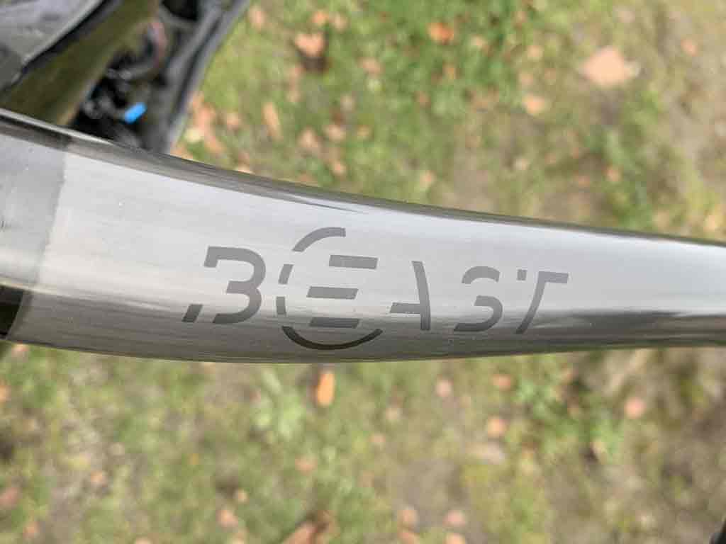

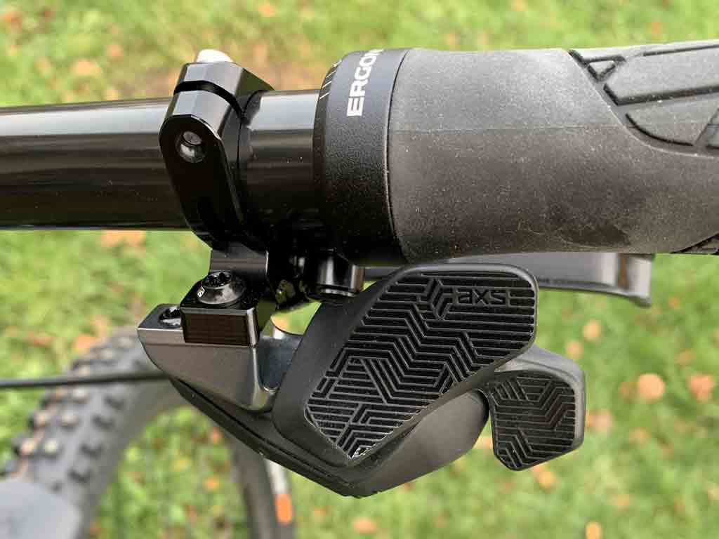

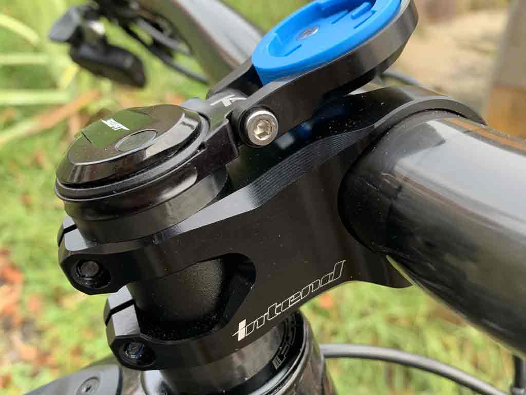

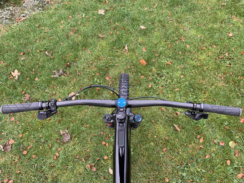

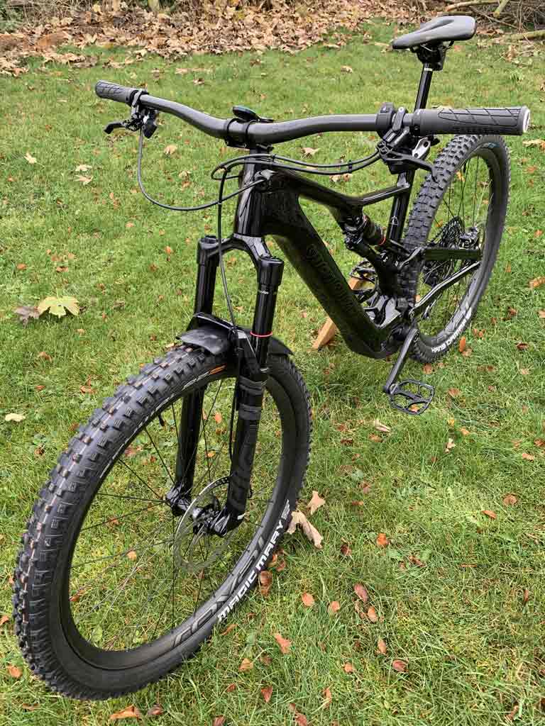

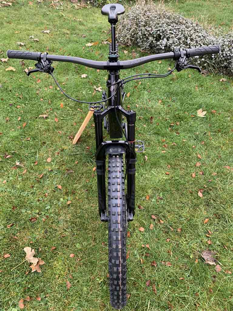

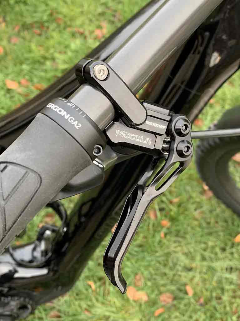

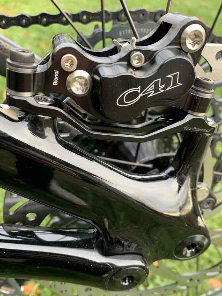

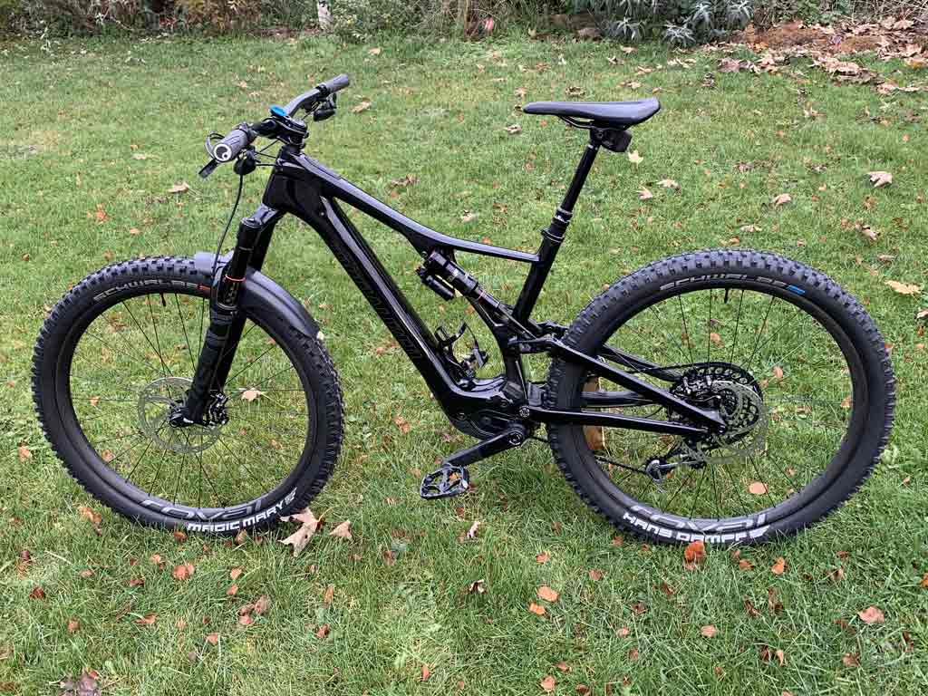

Hi,
I had two days and my SL was rebuilt.
According to the motto, "Black is colorful enough" ...
the black beast :D

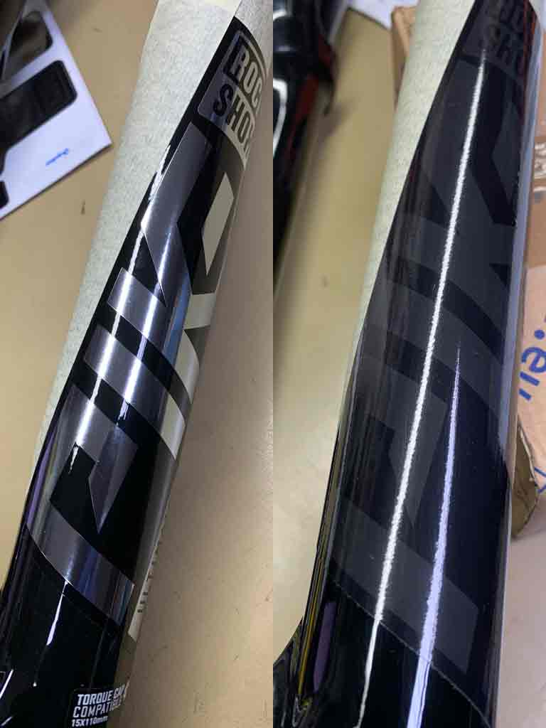

It was not that easy to get everything black, the silver decals of the Pike had to be removed and exchanged for stealth ...
and then that ugly silver scraper the reverb ...
the result...
and a few more details ...
The weight is now almost exactly 18 kg.
Now drive, adjust and test first.
cheers (y)

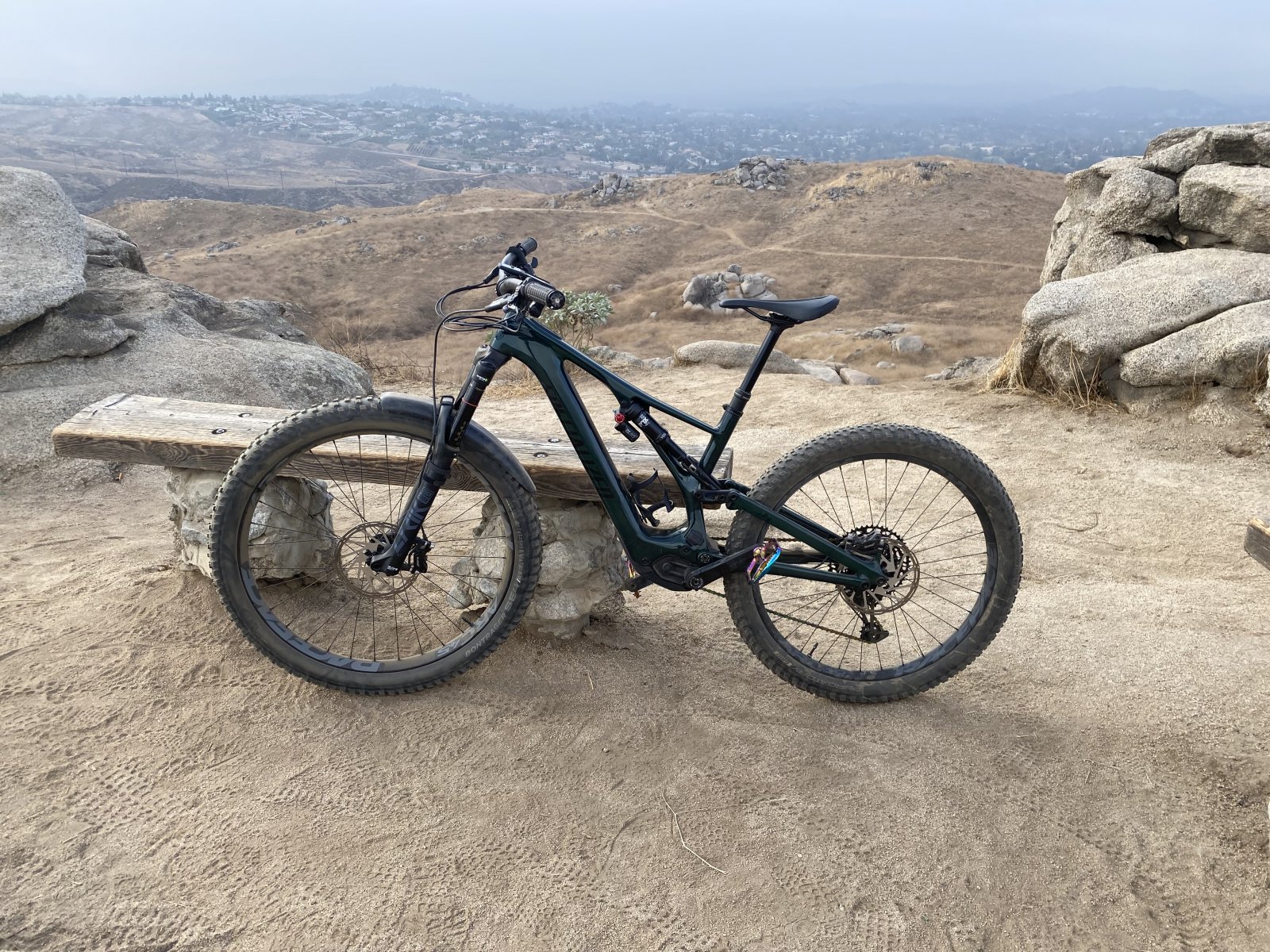

Looks like Sycamore Canyon? I live in Westminster and have only ridden there 3 times.

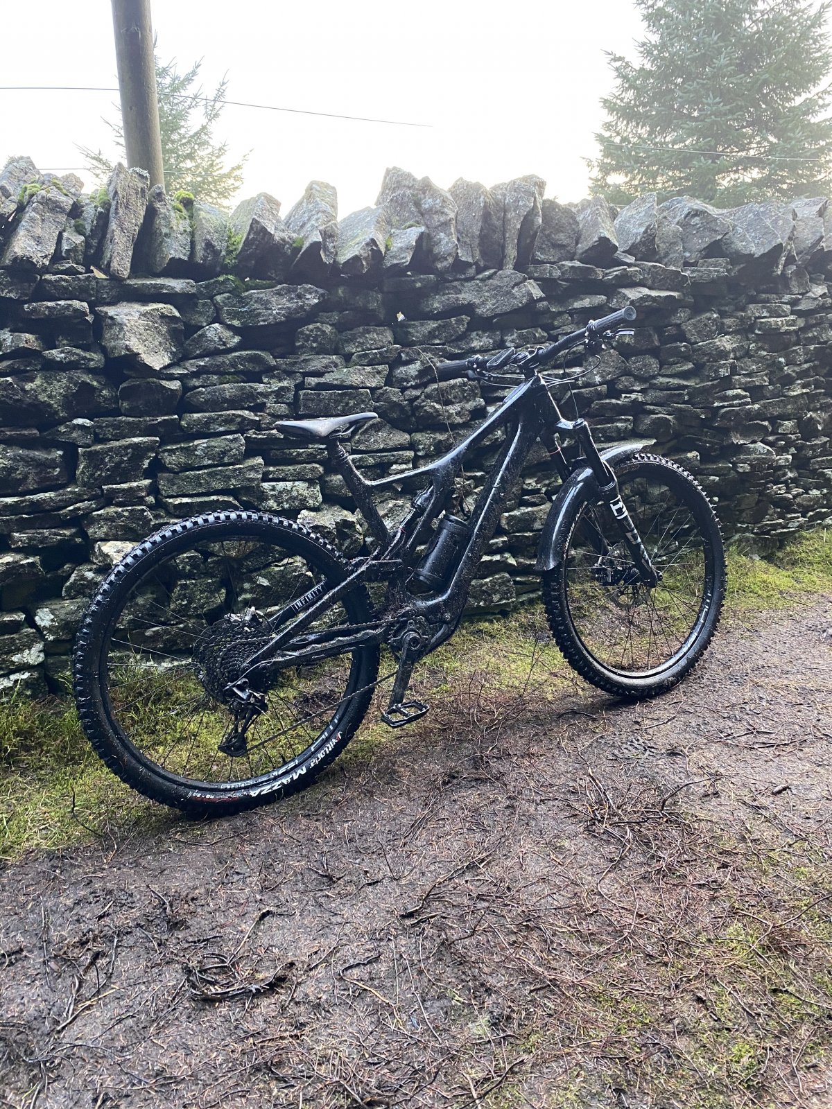

Few more upgrades on the SL, full burgtec cockpit, had to wait on parts since June, rock shot super deluxe shock with megneg, feels like a coil with that added pop. Trying some Vitoria tyres out, stains flow wheels on for the winter, pedal hounds motor cover is perfect. swapped out my hope E4s for some hope v4s and much better braking control . 220 rotor up front .

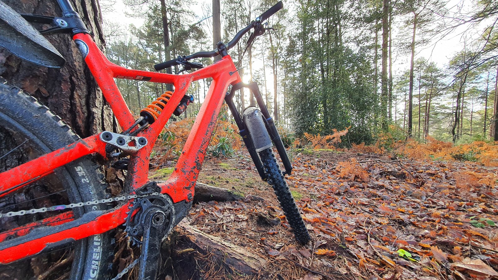

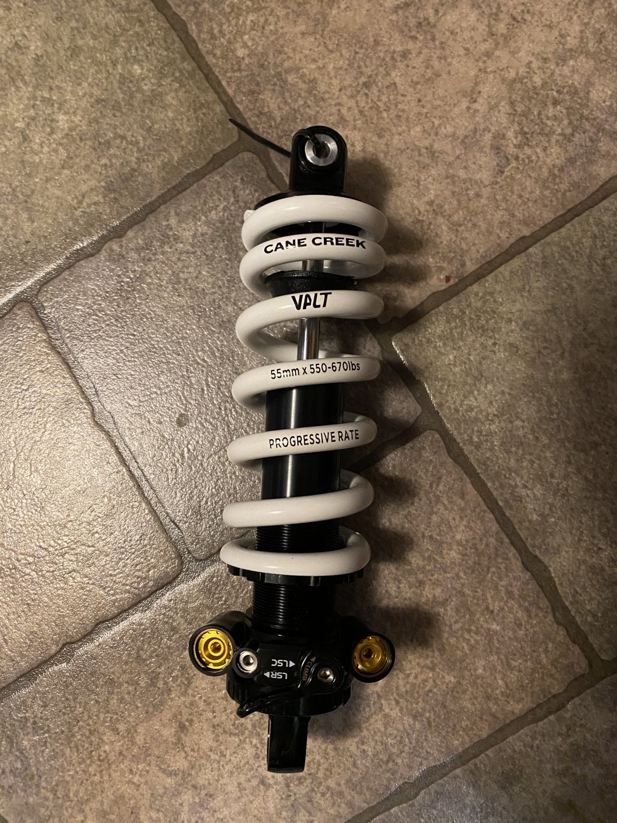

Right - Cascade link ordered, and a 650lb spring to replace the current 600lb I currently have on my dhx2. The 600 is a bit too saggy. It takes 2 turns of preload to get 32%. With the Cascade link, the firmer spring should be just as, or more, supple plus more progressive. I will report back...
Reporting back as promised on the Cascade link for my SL.
I decided to opt for a 700lb spring instead of the 650 on the DHX2. The 650 is borderline for my weight, and with the additional effect of the Cascade link, it makes it possible to go up to 700lb and retain the suppleness at the start of the stroke.
Since getting everything fitted, I haven't had much of a chance to get out, until yesterday when I went up into the Surrey Hills. While it was a total slop-fest, runs like Barrys were in good condition and made a decent test. Happily, everything passed with flying colours. In fact, more than that, the bike felt just gorgeous. It's a bit hard to describe as it is quite subjective, but everything felt smooth and controlled. With the heavier spring there was no loss of compliance thanks to the way the link alters the travel at the top end, and it was just fab. I did some relatively small jumps, and there's no bucking, and the landing is just like "oh, I've landed" and away you go with no drama at all.
Things may be helped a bit by the Ohlins RXF36 coil up front, which I dropped from a 65lb spring (too firm) to a 60lb, and which is pretty stonkingly amazing too.
The bike is now set up very nicely for me, and I like it a lot. It's far more capable than I am, but that's a good thing in my book. Compared with the stock setup it's a huge improvement. And I got the silver link as I'll be stripping the bike to bare alloy soon (damn that Rob guy for publicising raw alloy bikes so effectively). I bought the base alloy SL as I knew I'd be stripping it, and I also wanted to go al-la-carte on the upgrades too.
