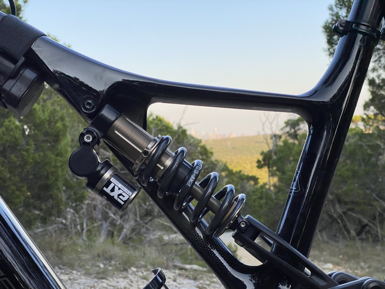

Got my EXT storia delivered yesterday. Took it for a night ride last night and got a little over confident and lost the front wheel. Went out again today and it’s so freaking amazing. Was a little gun shy with the crash last night, but on a casual run down this ultra rough and loose DH segment managed to tie my previous best (5th out of 1500 riders). It’s unreal how much better this shock is than stock. My 2021 Ultimate felt so plush with the stock shock, but in comparison to the Storia is now feels a bit rough :LOL:.
I am sitting at 210-215 pounds in my birthday suit and the 600 lb spring is dead on for the sag I like and I haven’t found a harsh bottom out.
I see a lot of people talking about 38s and Zebs in here. I haven’t heard any local feed back on the zeb, but I imagine it’s as plush as the Lyrik which is phenomenal. My buddy with a 38 took it to Colorado and said it was incredibly harsh on the braking bumps and he feels the chassis is too stiff. Says he misses his Lyrik. I found the 34 was just fine as well. All these people talking about how noodley their forks are I think are being dramatic. I thrashed the 34 and it was perfectly fine and has great damping. The Lyrik is a huge improvement, but the 34 was just fine. I’ve been riding for most of my life. I was raised by a bike shop owner and I now am fortunate to be able to buy any bike/components I want. I think the Lyrik offers plenty of stiffness without much weight penalty. I do foresee an Era in my future though after riding the Storia.
Unfortunately the rebound tune is a touch off with the heavy spring. It’s almost perfect totally closed, but I wish I had one more click, so I’ll eventually send it off when my stock shock gets back from warranty (snapped the shaft internally) and have Suspension Syndicate change the rebound tune to give me a bit more range on that setting. My shock came with a nice plastic tool that has the 12 mm socket and a 4 mm end which allows easy trail adjustment without lugging around a 12 mil spanner. They also sent out a 650 lb rock shock spring, but I don’t think it’s necessary.
only thing that hasn’t been upgraded is the cranks, post and seat!
I did end up going with a 55mm stroke on the Storia. I’ve also ordered a 160mm spring to give it a try on the fork. The 150mm seems fine on the front for enduro runs.

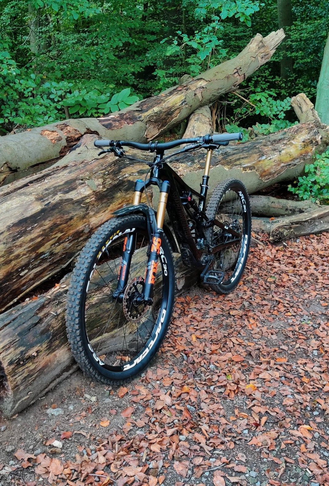

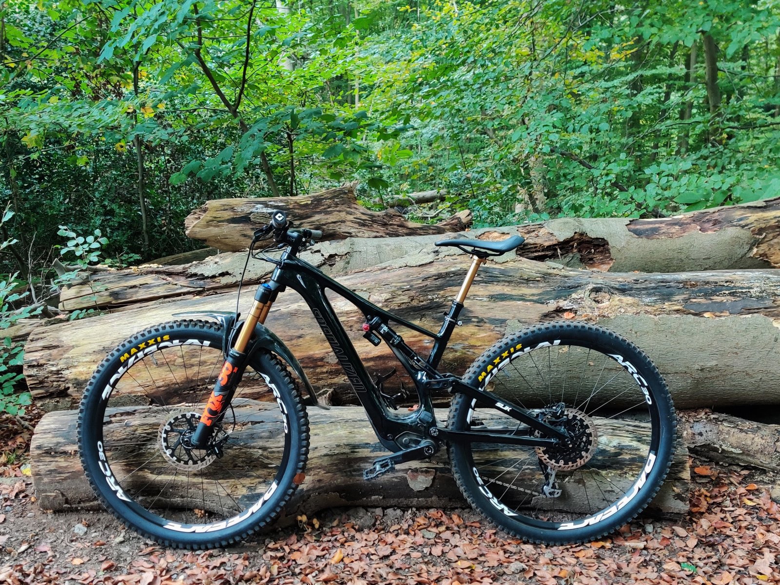

took a 2 week break from riding, but i got the chance to try the 170mm 38 on the SL
It felt good bombing technical stuff. it likes to wheelie climbing steep tech
I liked the agility when i had the 160mm on so i switched it back
i only know how the 2020 36 performs. compared to the 2021 38, the 38 is way better on everything if you don't mind it being heavier
i moved the 170mm to my kenevo to test out a mullet set up

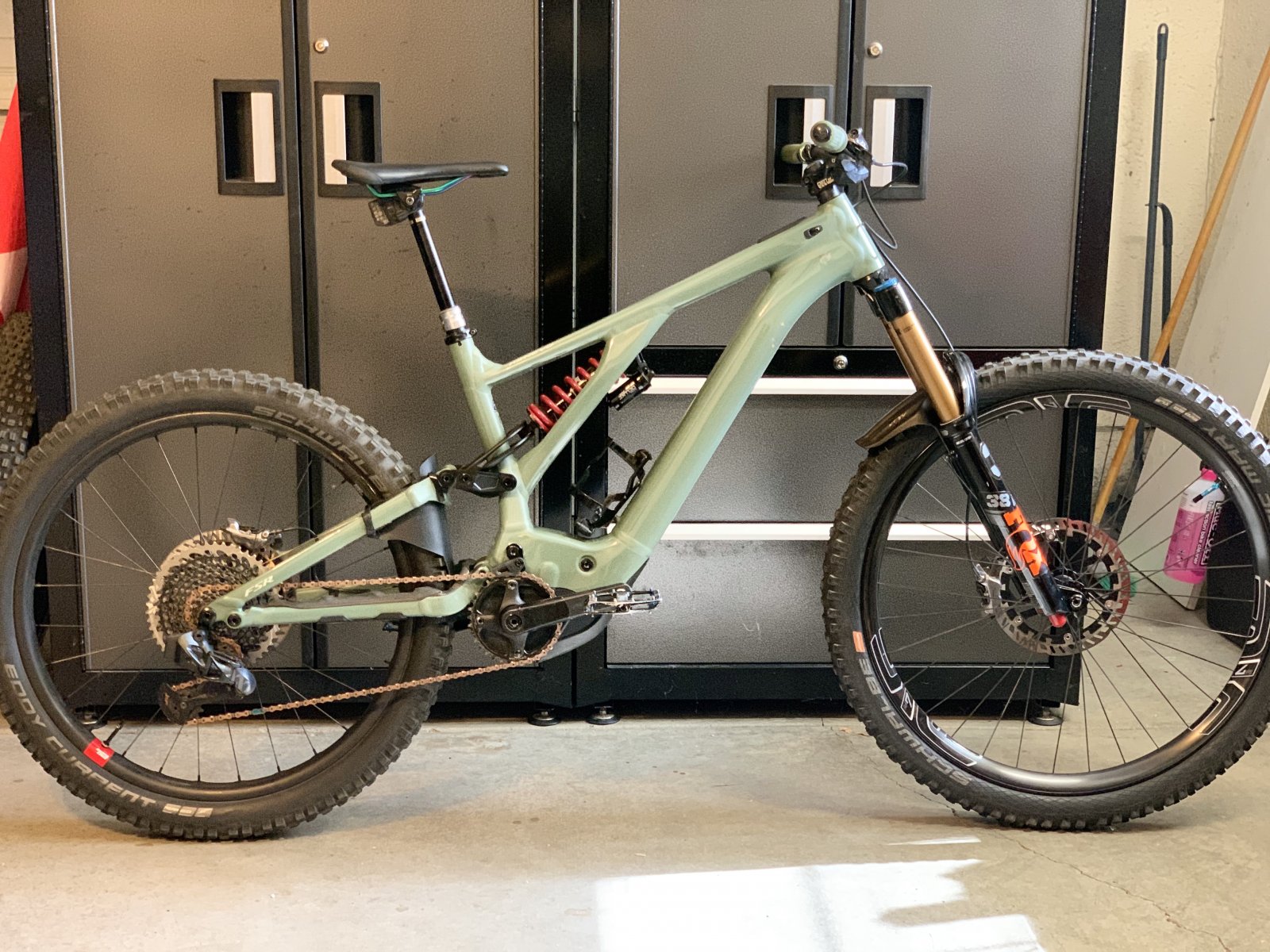

WOW. looks lovely in that colour. Custom job? I too not the biggest fan of black but had little option when I got mine.

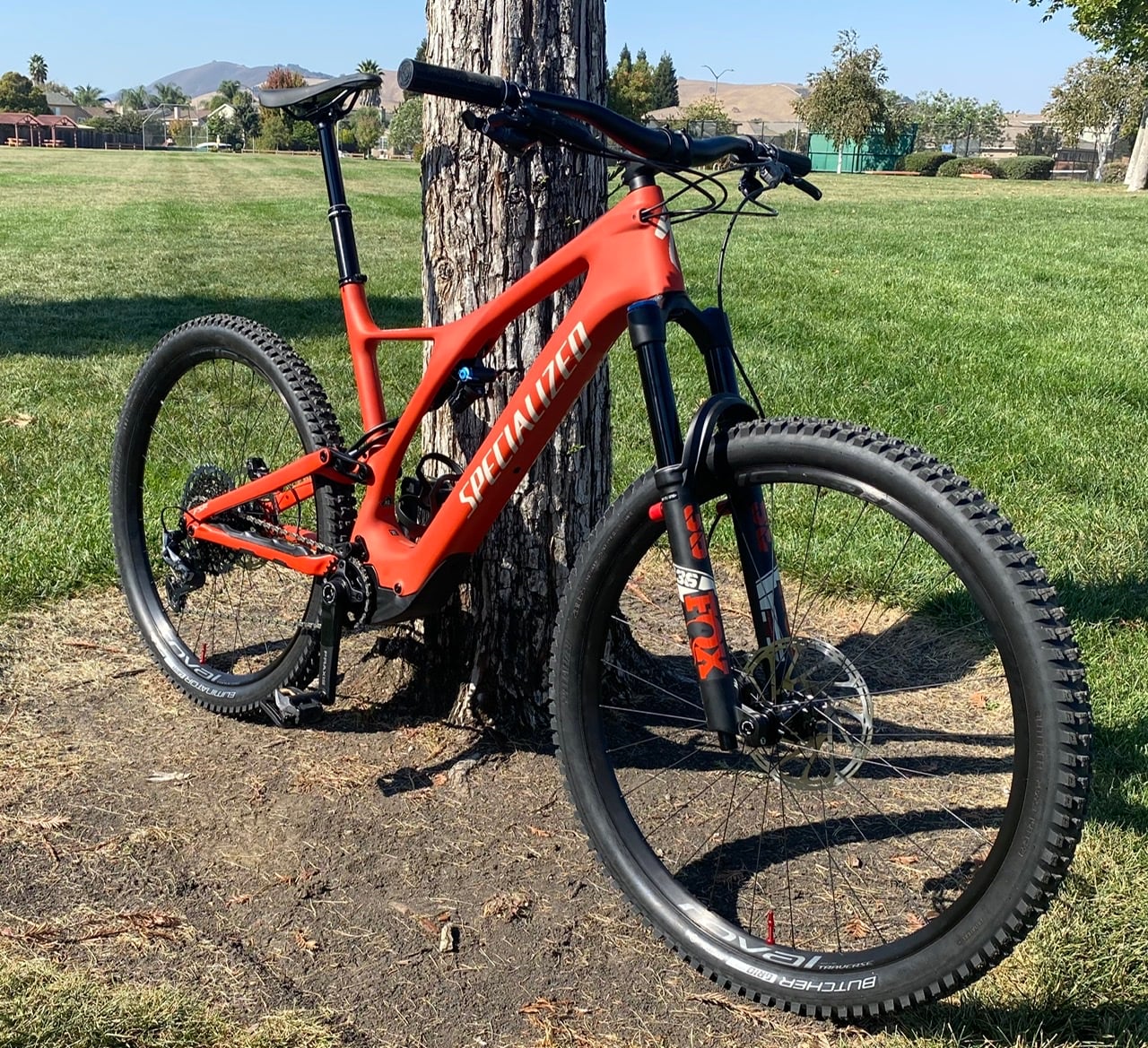

Just picked up a 2021 Levo SL Expert. Was on the fence between this and the full-fat version but seeing as I already have a range extender for my Creo and I need the exercise it seemed like a better choice for me. So far it feels great, they upgraded a lot of the components to what they should have been in ‘20, I’m glad I waited. Ignore the dorky pedals, found out last night my old MTB flats have a bad bearing.
What a great color. My main steed before the SL was a pivot 5.5 in a similar color (I think at least. I’m color blind)
Yeah I wasn’t sure how “Satin Redwood” would look in person but I’m pretty happy with it. It’s the same color as the new S-Works Stumpjumper they just launched a couple days ago as well so Spec must like it. Only tricky part is finding accessories and components to match it since it’s a bit of an odd color and finish.

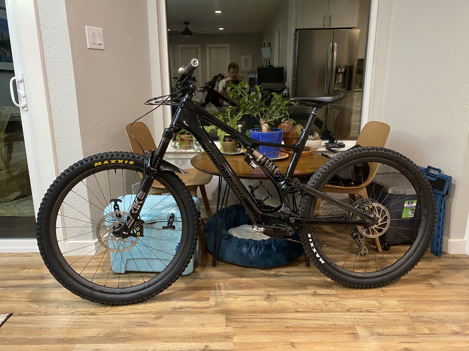

I also have a storia coming for my Levo SL.
I am about 205lb without gear.
My bike has a cascade link and I was thinking I would need a 650lb spring, but by the sounds of it, a 600 or 625 might work better.
I have been running my SL with a 21’ 160 f36 and a 210x55 dpx2 with .6 volume spacer in it to make the shock more linear.(because of the cascade link)
This bike has been great set up like this! But want to try something different
I have a Mezzer sitting here that I am going to pair with the Storia. This should be a good combo!
I have a Storia and Era on my Druid, and it is amazing!

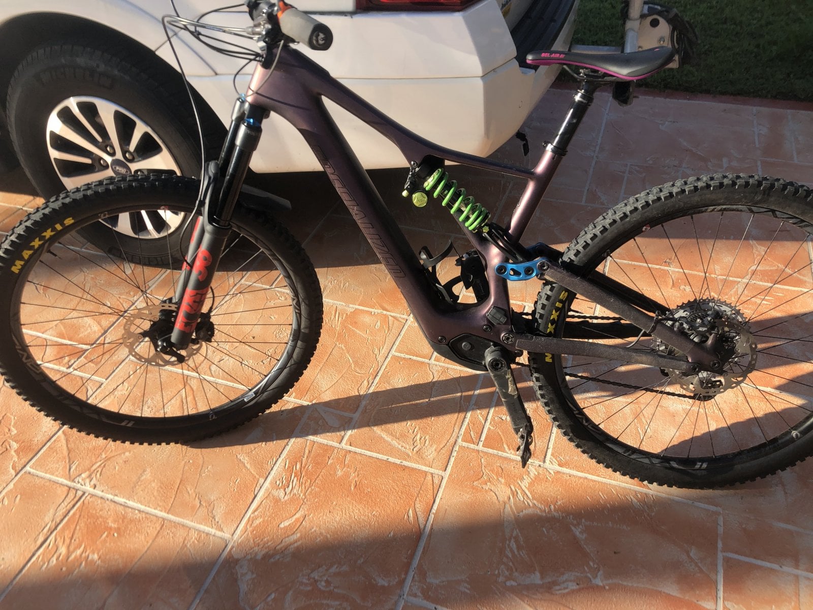

I have about 1200 miles on my SWorks SL that I split time with my modded FF Levo. I’m 170lbs and ride XC primarily. I found the suspension recommendation from fox too stiff for the rocks and the square edges on trails I ride daily. once softened up with 3-4mm static sag (60psi) it has been excellent and equal to the 36e’s on my FF. Before I was always 20 mm from bottoming, now it will bottom and the progressive tune of the fork became noticeable. The shock was identical in setup to my dpx2 on the FF. The SL is near the same feeling I get on my regular Stumpjumper. I love it.
