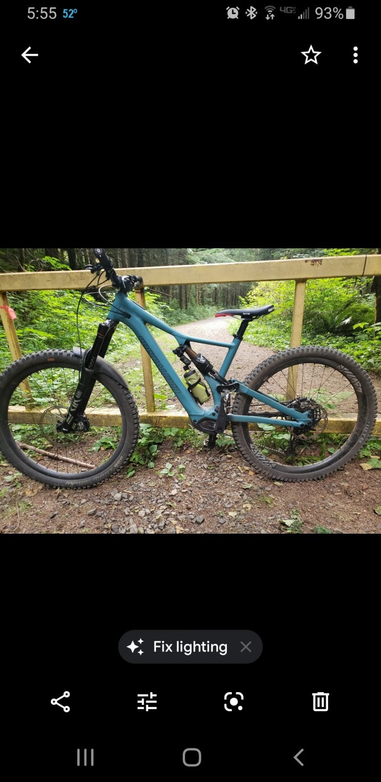

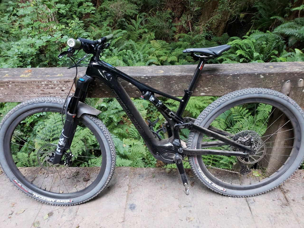

What kinda trails do you ride on those tires?
The trails are much chunkier here compared to the Bay Area. I lived in Santa Cruz for ten years and it is much smoother up there. If you’ve been to SLO or Santa Barbara, that is closer to here in San Diego County.
My bad I was actually asking the other guy with the 35lb bike. I'll probably die riding with those tires riding trails at UCSC or Demo
Like apac said.. You got man tires on your bike lol
I'm riding redwood forest trails. Virtually no rocks. An occasional root. Hard pack cross country type trials and fire roads.
Yeah I figure it had to be those kind of trails, unless you have mad skills.lol . BTW I was kidding about man tire comment :)

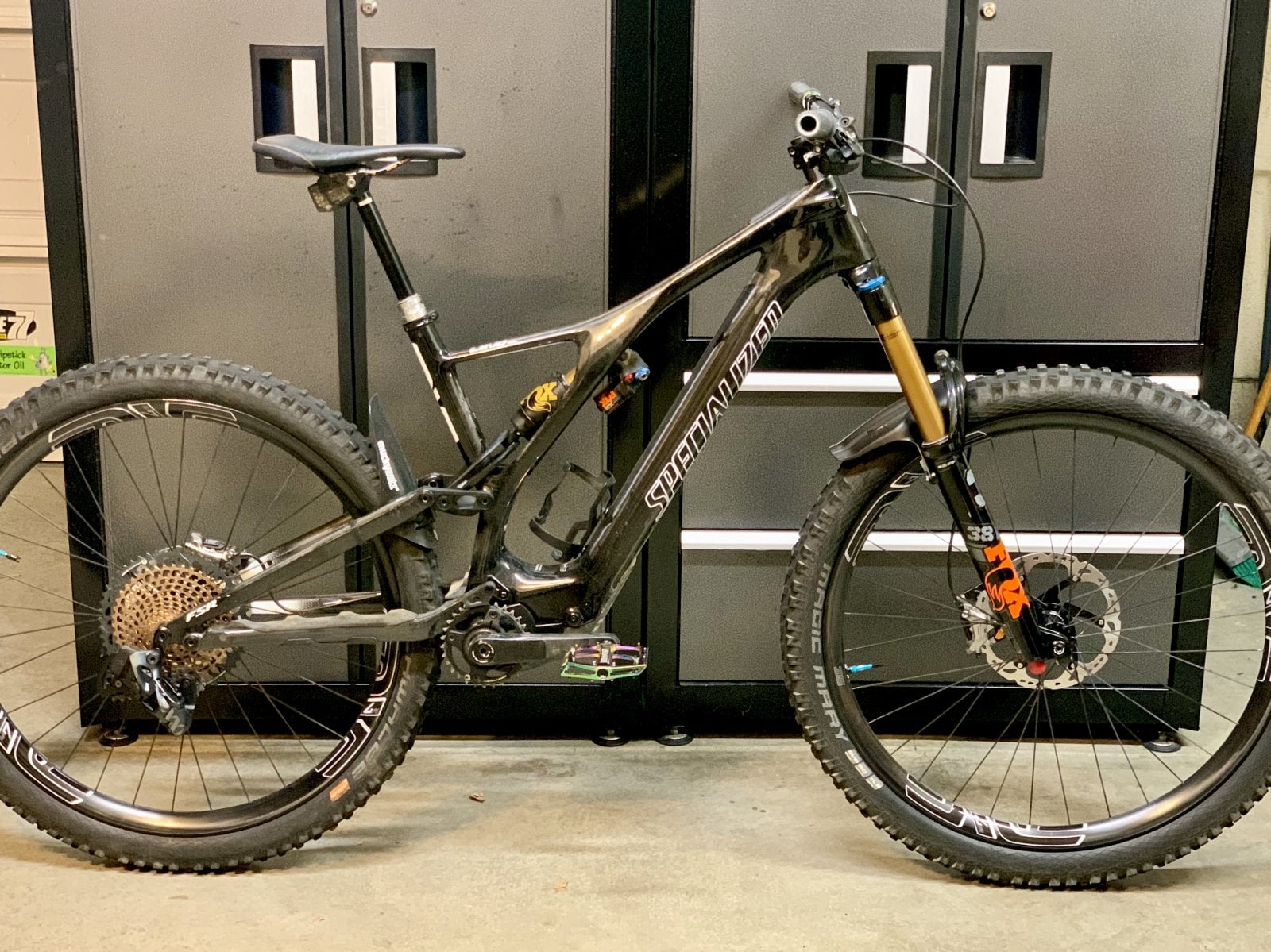

Hi gang, I have a 2021 Turbo Levo SL Comp - Alu-minnie-um with SRAM Eagle SX. (in hi-vis orange mislabelled rocket red)
I am converting to SHimano XT for the full hyperglide+ experience.
I have read through this thread and just want to confirm my understanding. All the SRAM can be swapped with SHimano XT,, with two exceptions:
REAR HUB
Mine is a Specialized OEM hub (maybe from Formula). Consensus is that the freehub body cannot be replace with a microspline, so I will have to by a new hub and have it re-laced or get a new wheel. Sounds right?
FRONT CHAINRING
No shimano chainring for the 94BCD available as wolf does not make a conversion, and Praxis does not make a spider for Shimano. I can still use the SRAM, but I must use a SRAM chain link connector on my XT chain (width issue, length issue?!?!) It this really the case? Can I just take the lathe to it?
thanks for the help
im running XT/XTR drivetrain. Xt chain on the stock chain ring works fine for me, quick link and all.
Same here, no issue with the chain ring and a 12speed Shimano chain. I have had issues in the past with wide/narrow non-Shimano and the Shimano 12sp chain. Got lucky this time I guess.
Has anyone installed a headlight using the main battery with the light splitter cable? There is very little information about compatible lights and the splitter cable does not seem to be available online.
I have that exact bike with an XT setup. You need a microspline hub, I used a Nukeproof Nuetron V2. Cost about the same as getting the roval relaced for me.
I used a Garbaruk 94bcd which when ordered off their site can be speced for Shimano 12 speed.
It shifts like a dream and is a massive upgrade over the NX eagle I had before.
