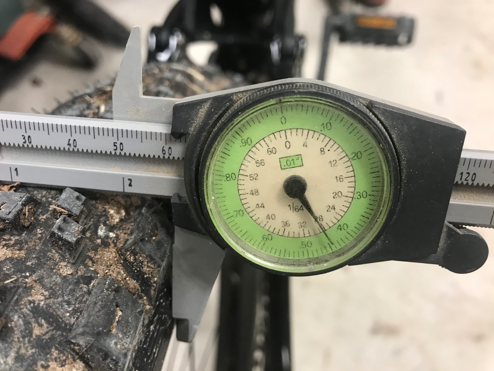

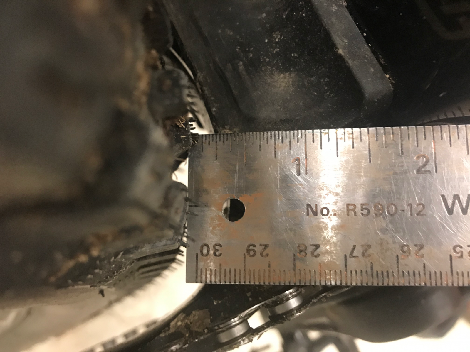

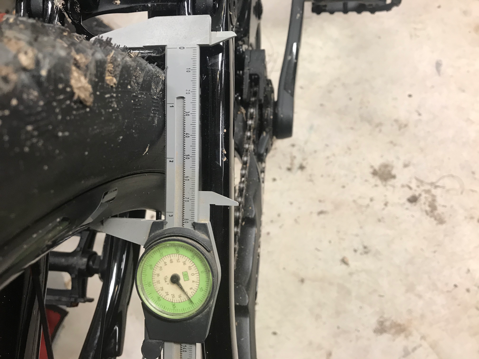

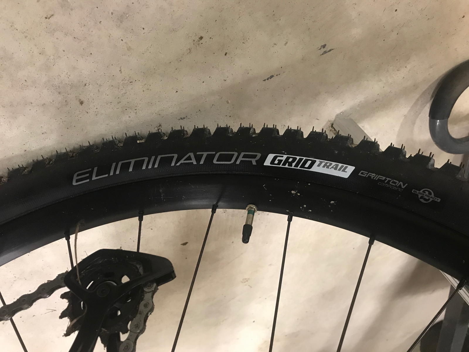

How fat of a tire do you think you can fit on the rear? Would a 2.6 fit?
Original back tire
At 25 psi
Rim to top of tire = 3-3/16”
Clearance top of tire to mud guard = 1/4”
Tire clearance side = 5/8”
Tire width = 2-7/16”

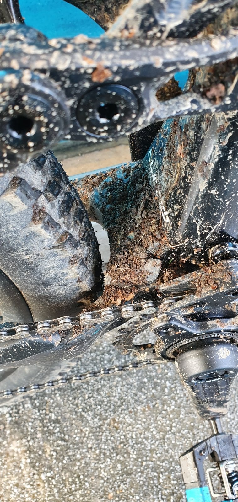

Has anyone with an SL put on 2.6 inch tires front and rear? Any problems?
I have had issues with traction with the 2.3 stock tires and am hoping to put on 29x2.6 magic mary tires.
I ordered one of these.
chwalbe Eddy Current Rear Addix-Soft, SuperGravity, Tubeless Folding HS497 MTN Bike Tire
Will mount it and find out.

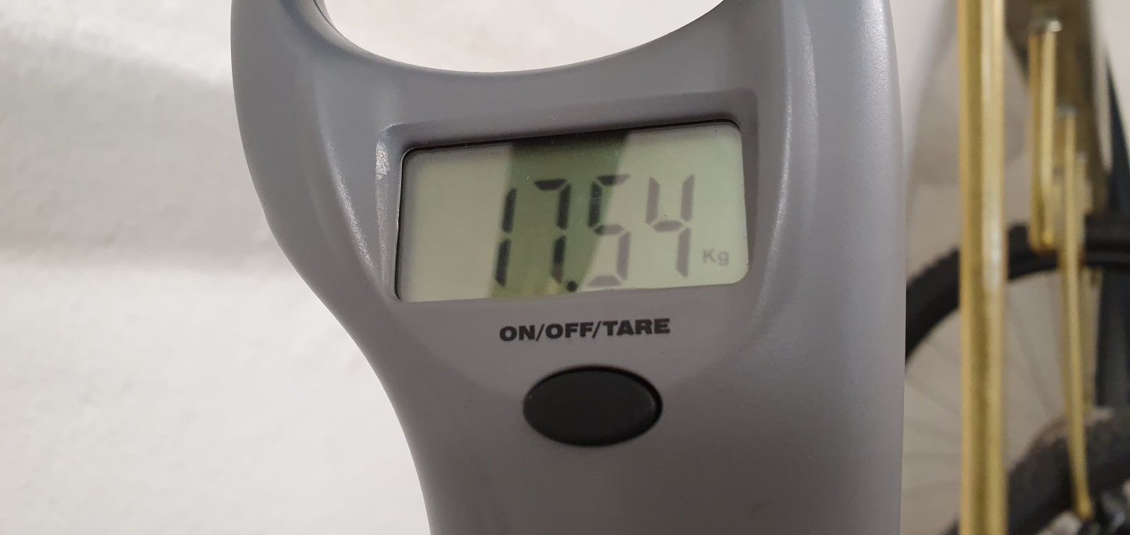

Just double checked the official brochure:
"The S-Works Levo comes in at 17.35KG in Large".
Take the tubes out and you lose 400g (or 350g in my case above with a lot of Muc Off sealant).
XL frame will be slightly heavier - not sure how much.

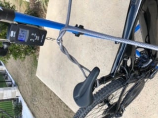

Levi SL Comp CarbonMedium weighing in at 18.14kg (no pedals)

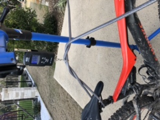

My dirty S-Works Stumpjumper Fatty medium stock except Maxxis tires and no tubes but race face Chester pedals were on it weighing 340g so 13.32kg-.34kg = 12.98kg
Levo SL starts off 5.16kg heavier (with tubes)

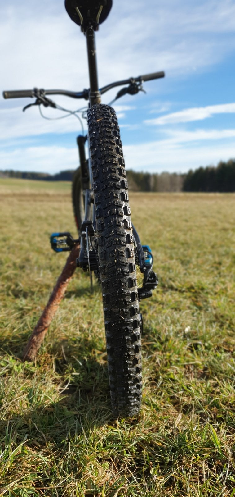

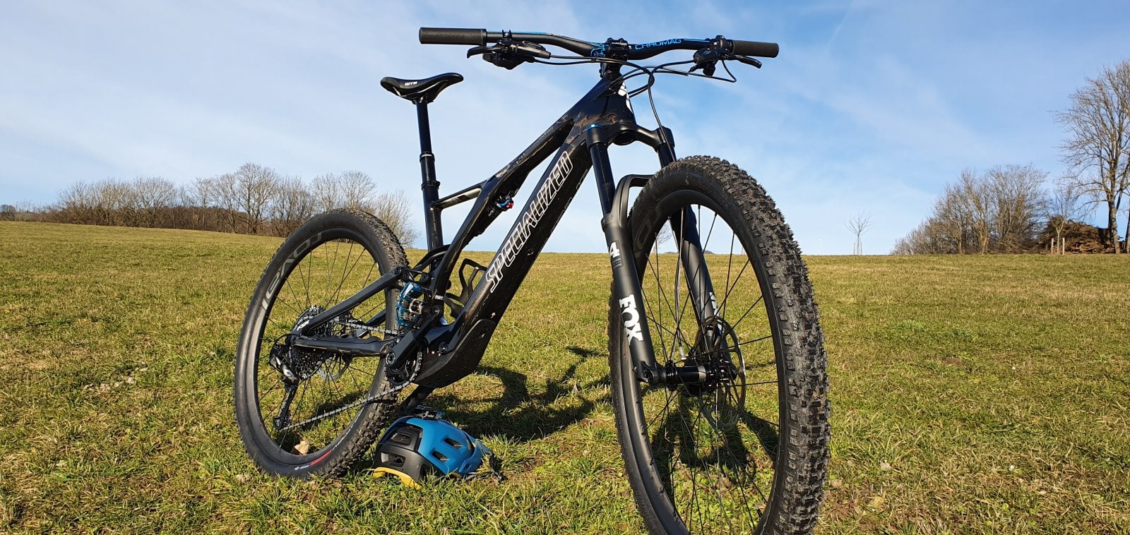

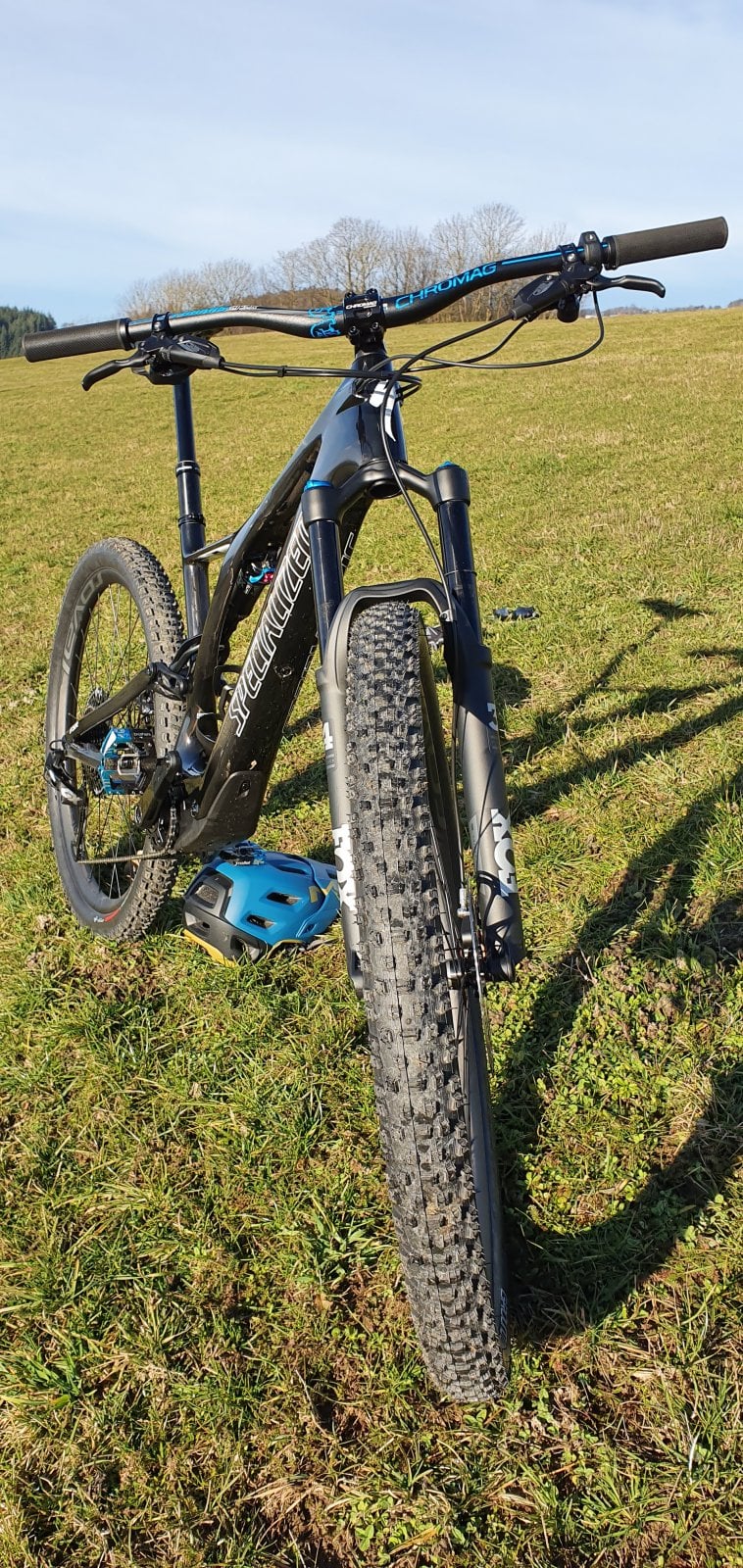

There you go...
Changed tires immediately and made tubeless. Ground Control and Purgatory work so much better than i thought and saved around 500g.
Also changed stem, saddle and handlear to my personal preferences.
I´m blown away by the bike, so natural. I did not know how natural E-MTbiking can be, i definitely stay with the SL and won´t go back to the clumsy LEVO.
