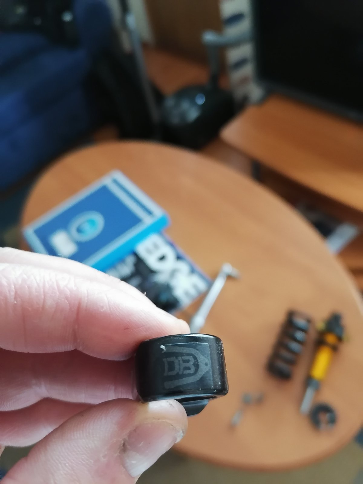

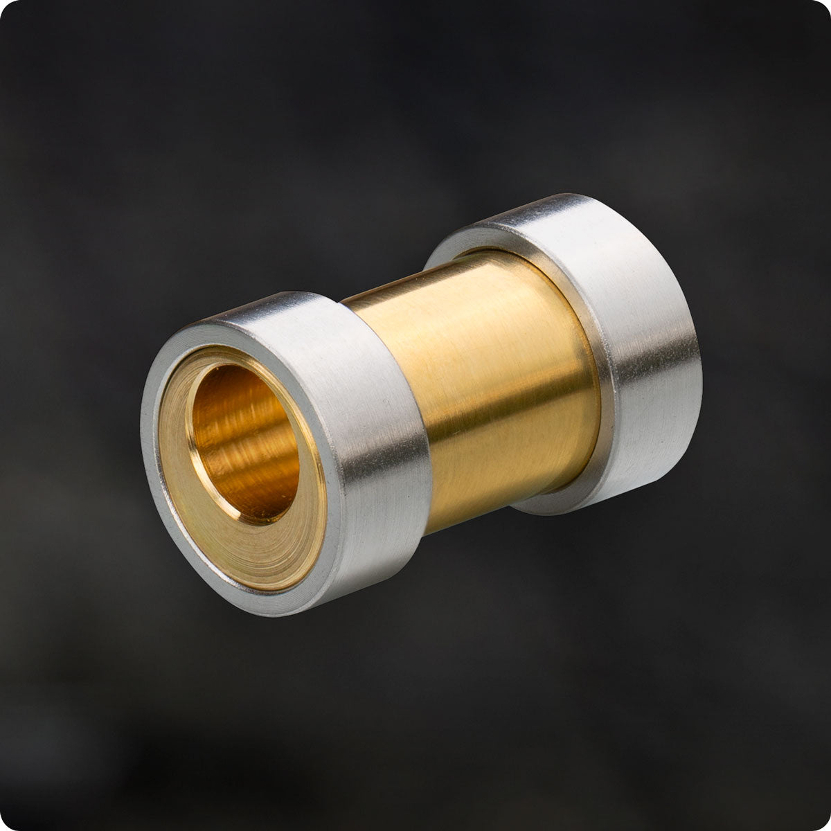

has anyone found an offset rear shock bushing that fits? the Burgtec only offers 1 in the m6 bolt and its 23mm wide. I believe the sl needs a 21.8
There are a few on eBay from Poland but take about 2 months to get from order. Made to any size.
looks like Offsetbushings.com offer this size:
ordered one up! thank you for the info!
2 months from these guys too

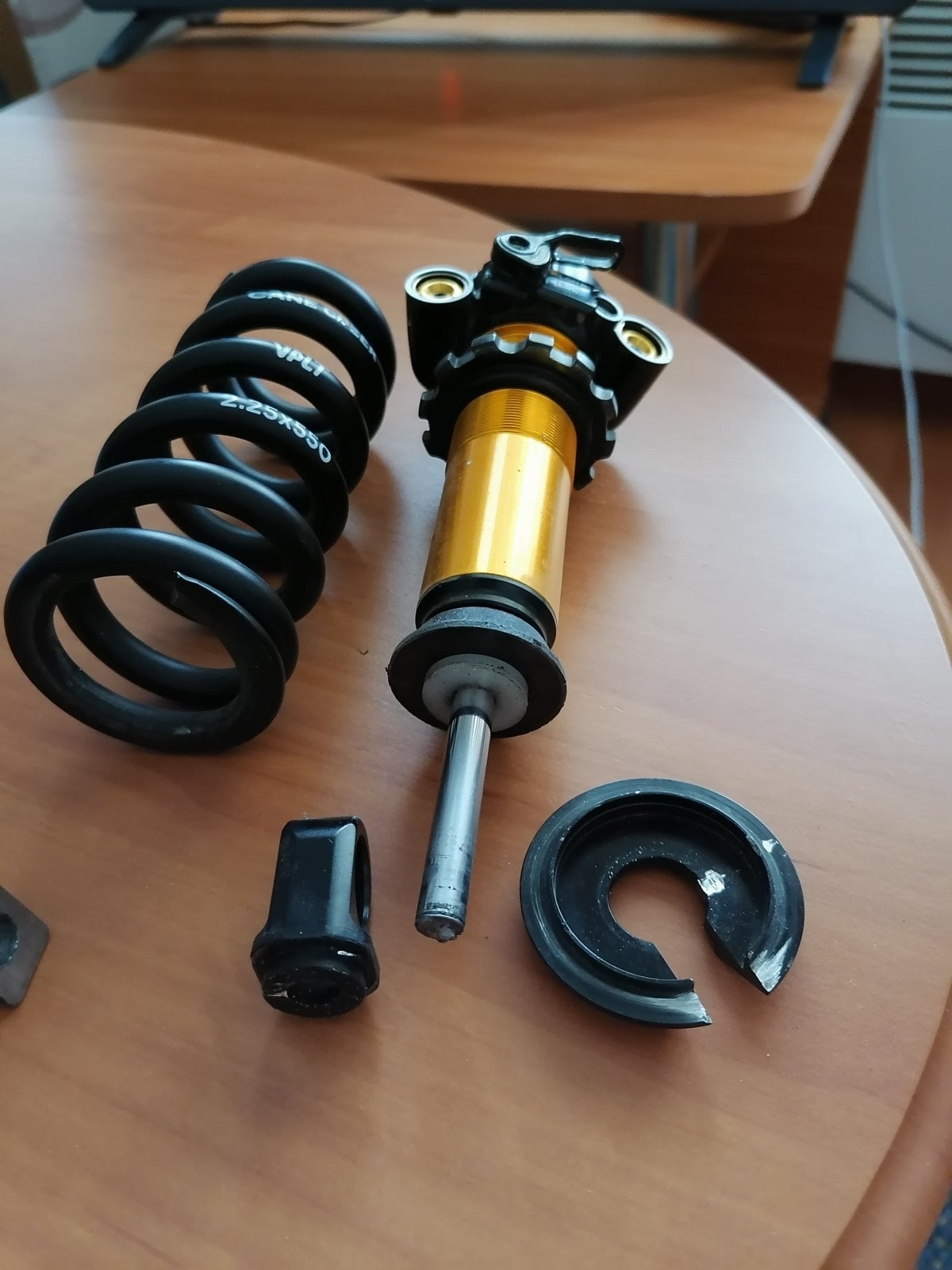

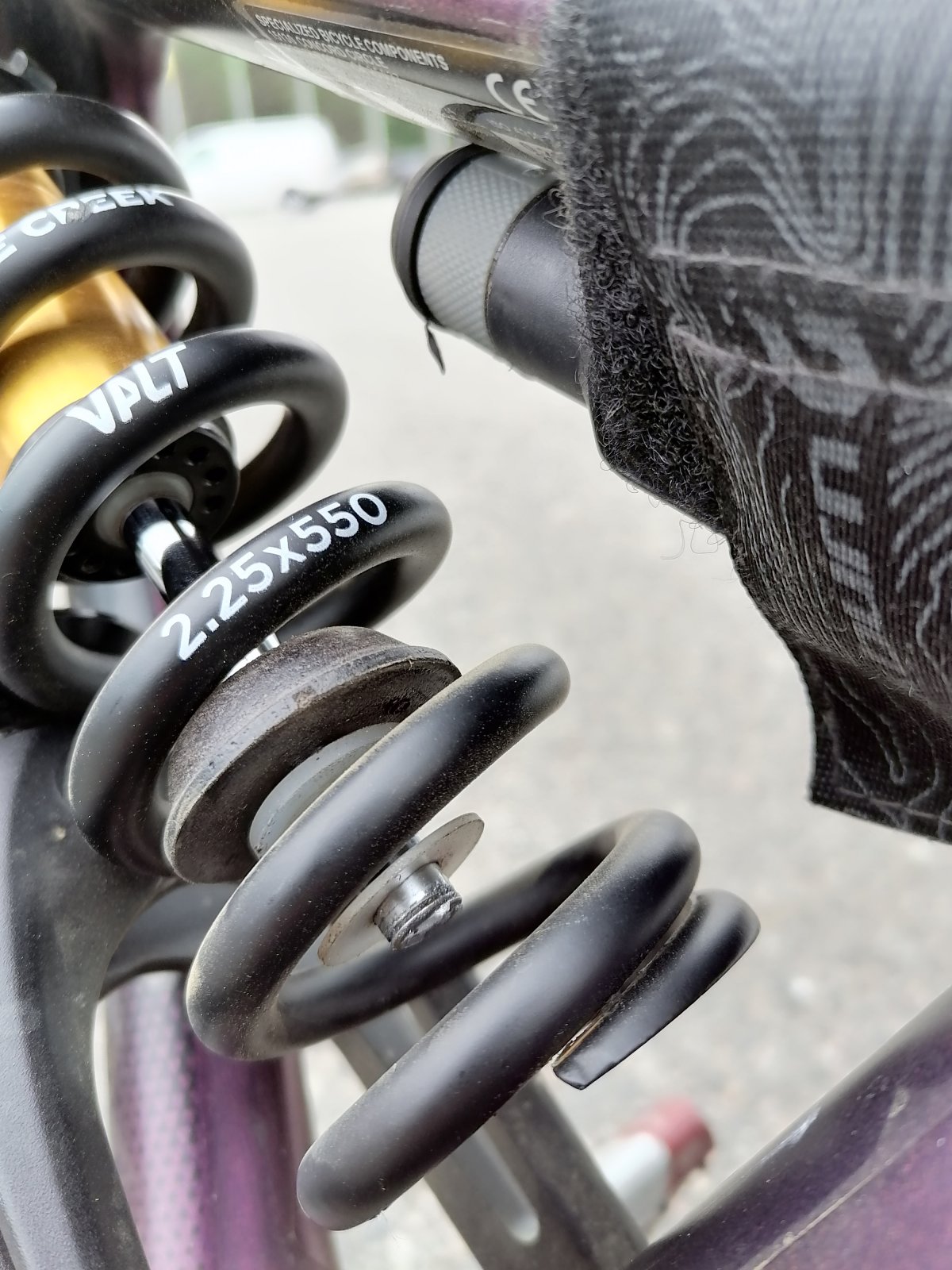

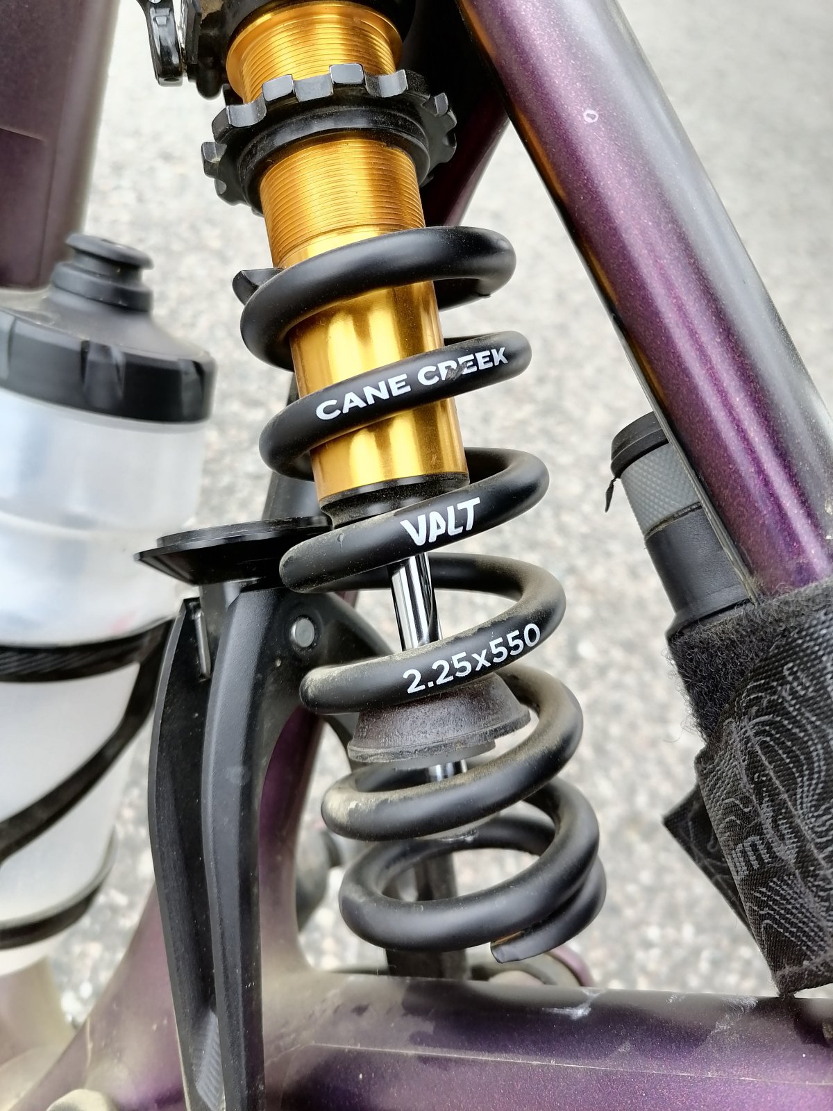

The cane creek shock issue is a real worry. I just got the all black version from TFtuned Here in the U.K and it's the newer one guaranteed for use on the levo. I would be sending it back to the Cane creek distributor in your area. This is the second or maybe third snapped CC iL shock I've seen on this forum alone.

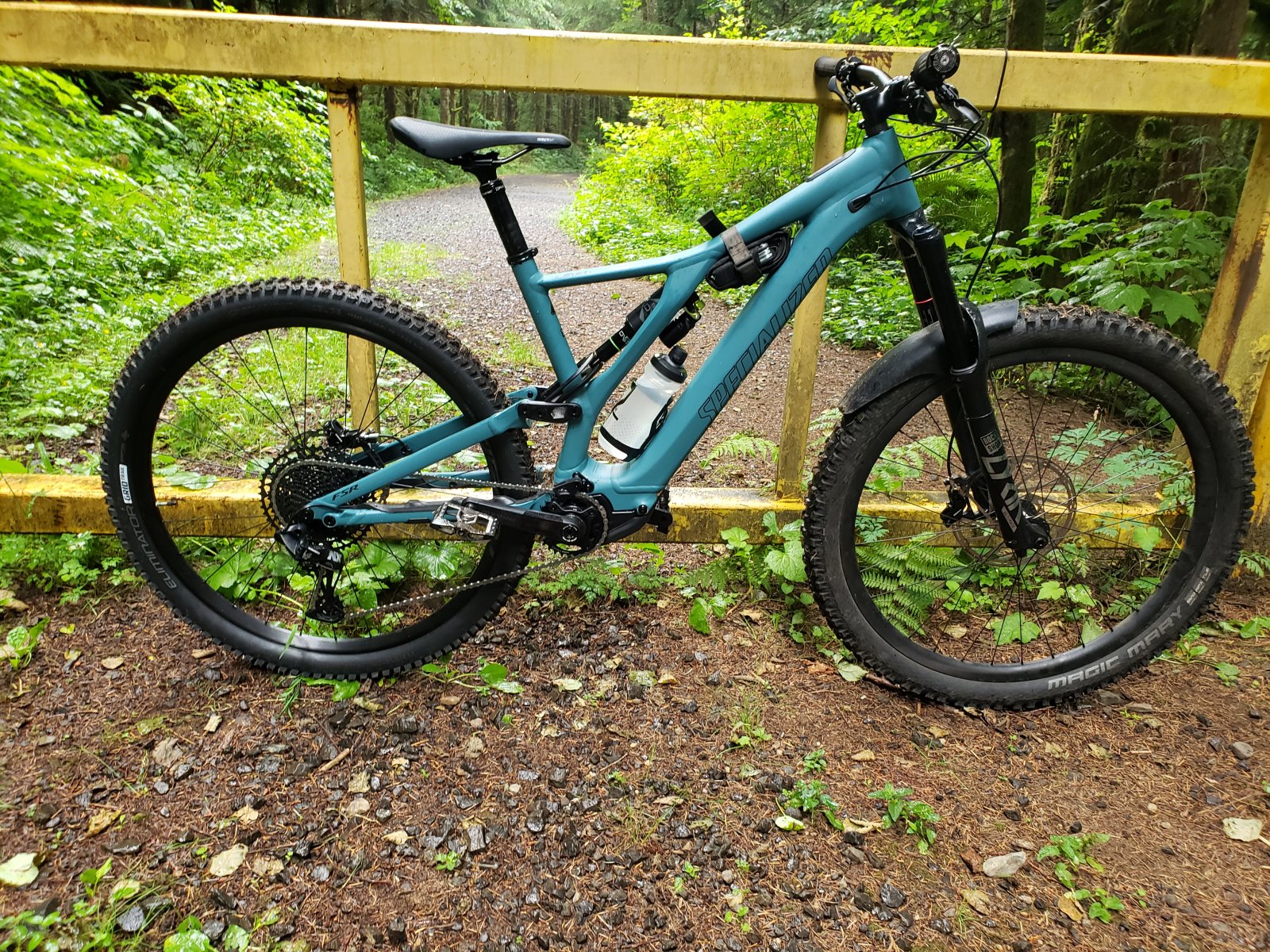

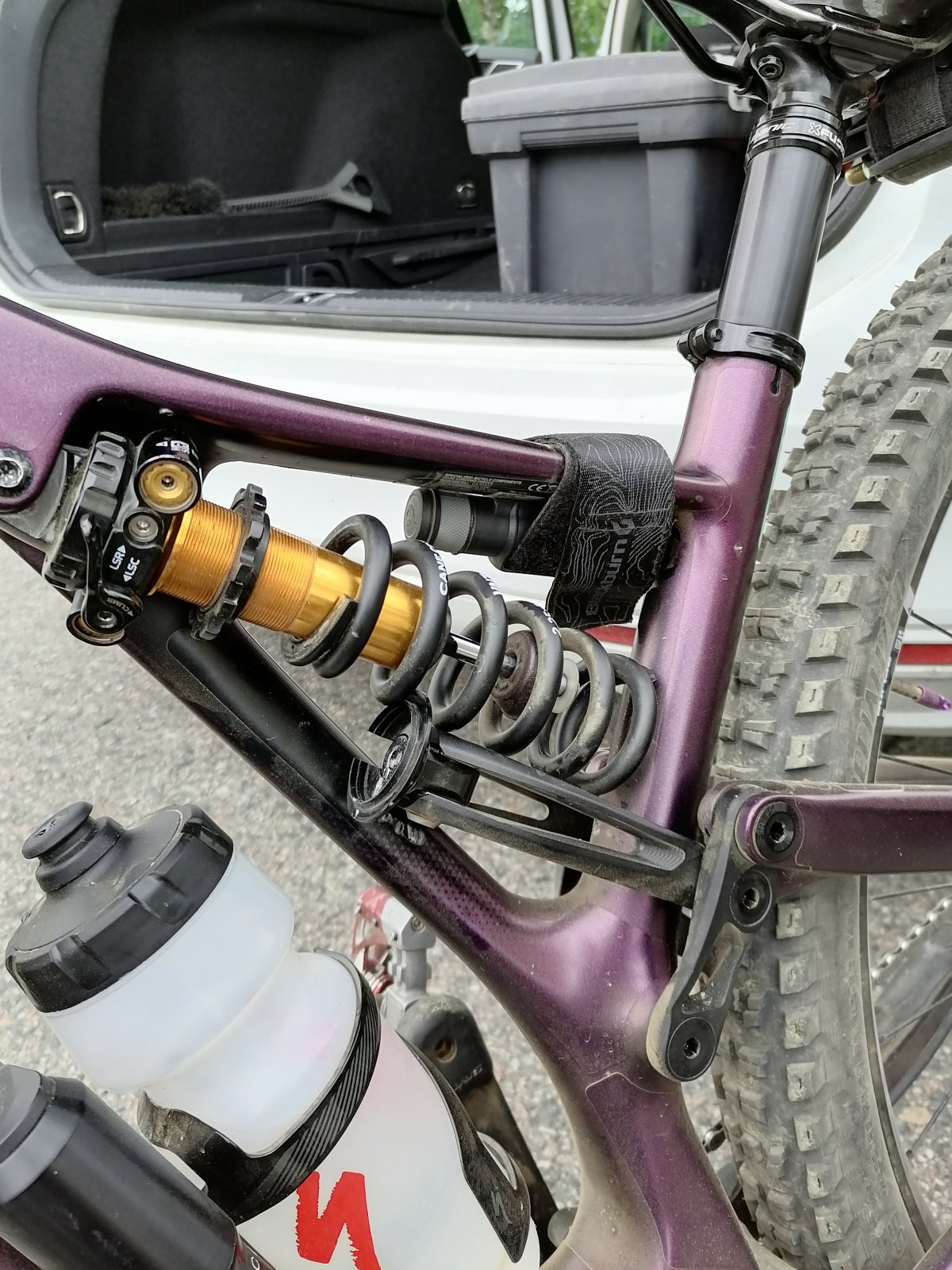

heres my new levo sl comp. wanted a carbon comp but they were all sold out and didnt want to spring for the expert since I just need the frame. been trading parts from other bikes I have. added a 160 lyric fork, 210x55 dvo topaz shock, one up 200mm dropper, light bike carbon wheels, xo1 52 tooth cassette. coming soon, saint brakes cascade components link, praxis carbon crank arms and a offset bushing. weight is a tad over 42lb far lighter than my other ebike, commencal meta sx
really liking this bike. for a trail bike it handles dh pretty dam good . really rides and feels like a regular bike. been chasing a creek somewhere near headset. think it might be internal cables because I've greased everthing!
oh ya, I had to use a different bottle holder that sat lower to use the RE battery due to the shock valve.
