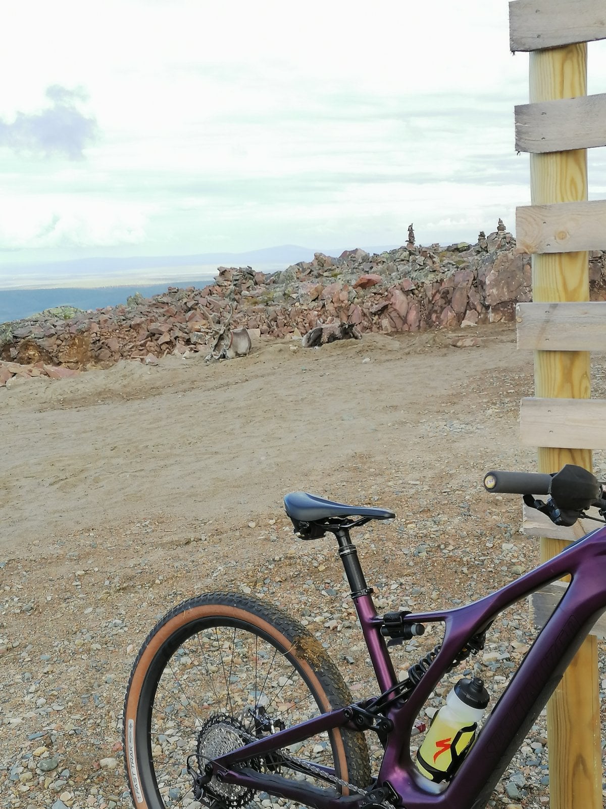

My office for next 5 days. Finish lapland!
And yes, that is reindeers shit on rear wheel! ?

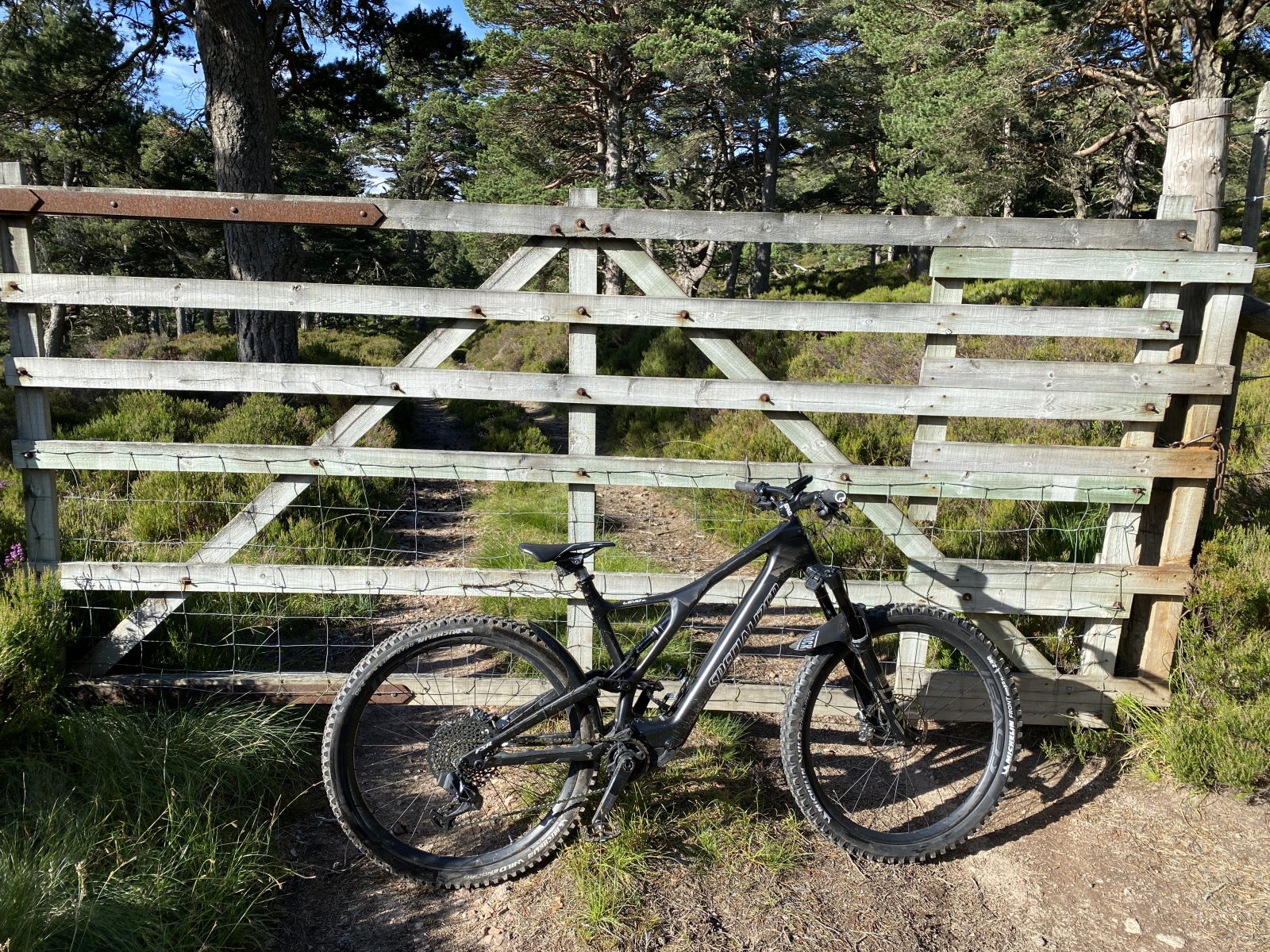

Here’s a great reason for having a ~17kg bike! After riding for 17 miles (900m elevation), and about 5miles from being back at the car, I reached a locked gate. No way round it, and 8ft fences into the distance. I had to scale the wobbly gate with my bike in 1 hand, then carefully lift it over the top... and down the other side whilst maintaining my balance.
Certainly wouldn’t have fancied doing that with a 23kg+ eMTB!

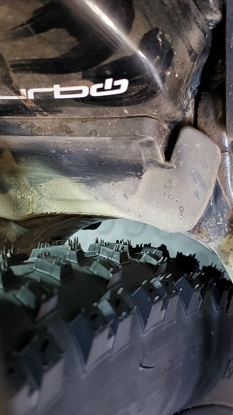

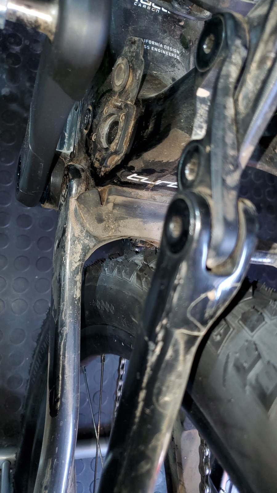

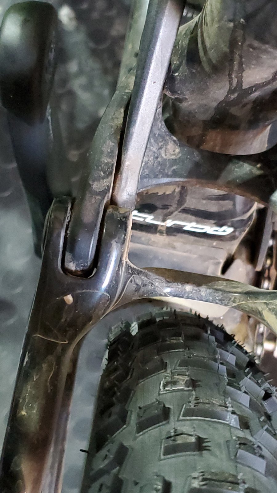

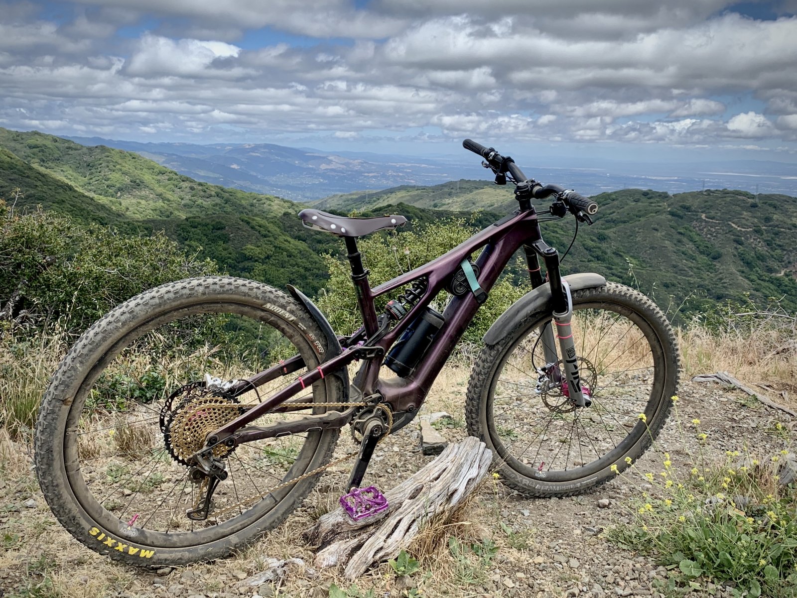

Am I correct that we are limited to 2.3 tires on the SL? Look at a set of 2.4 but concerned about clearance in the back next to the motor.
The image on the post above shows a Michelin 2.4. Others can confirm, but looks like it should work.
I just put a 2.6 Grid Ground Control on the rear wheel of my SL. 30mm iw rim. Plenty of clearance.
