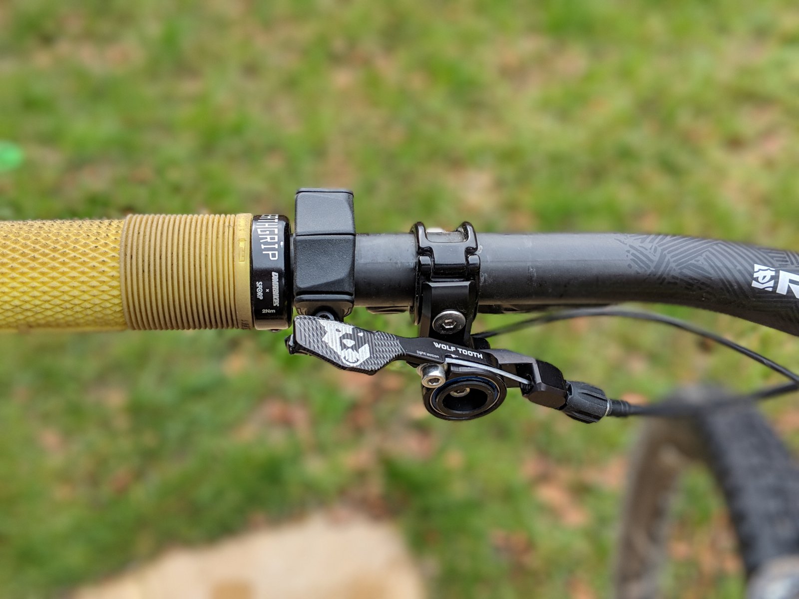

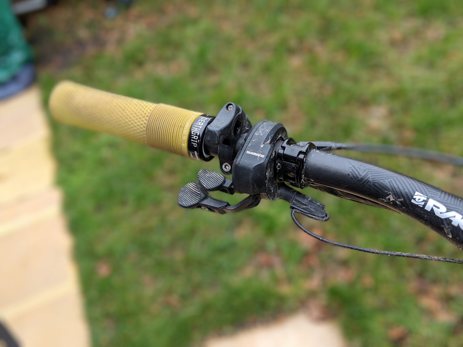

So I finally got around to ordering the E7000 switch and took it out for a test this weekend. Loved it, it's got a really nice feel to it, doesn't get in the way, I didn't accidentally change modes which happened with the E8000 and ofcourse the dropper remote is now in a natural position and much better quality
Before
After
Much cleaner and uncluttered. I wish canyon would bring those to North America. Unfortunately they have no plans todo it
I had to but it from Germany and ship it over to the UK. They are plug and play so they are easy enough to install.

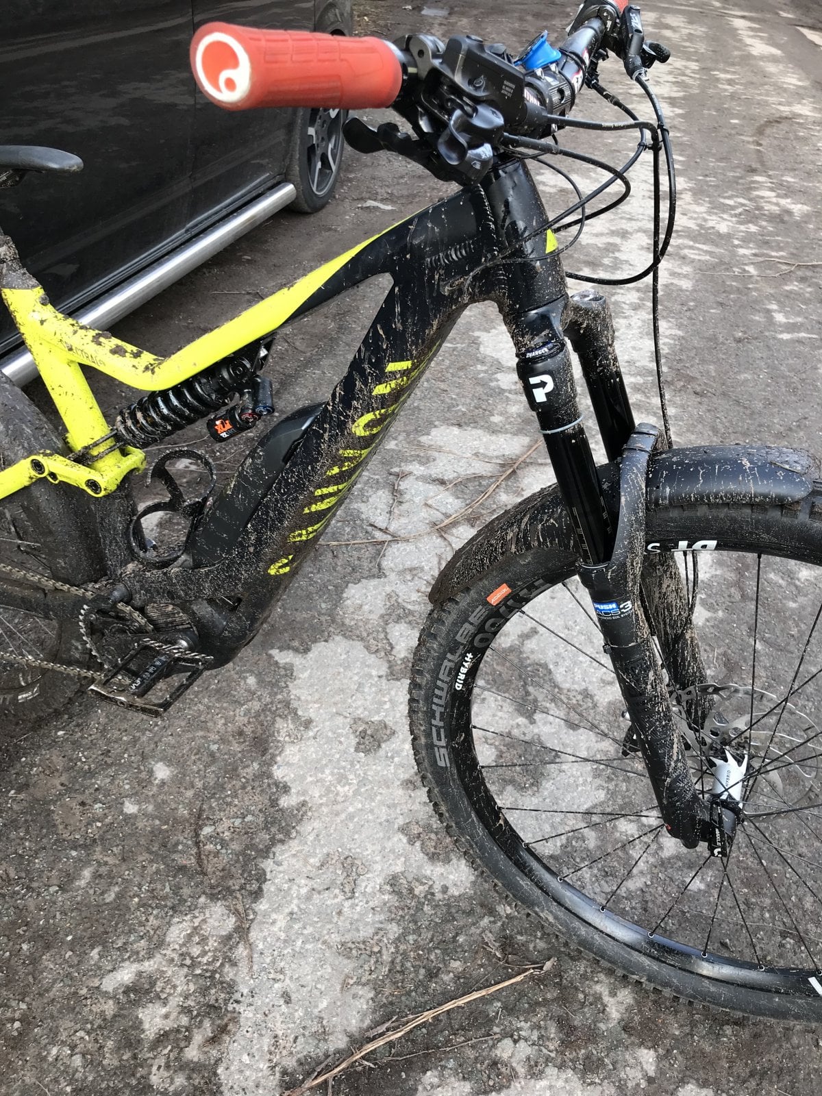

Fox dhx2 and push acs3 coil fork kit tested today,and wow its blown me away plush but plenty of mid support, on the dh runs its so much easier on your body spesh arms and shoulders. Plenty of pb’s without trying,as so easy to go quick?God help me when i fall off ?

Very nice set up - if you get eh coil set up dialled in at both ends then the ride is something else
Is it stock coil on dhx2? What is outside diameter of the coil? Did you have any clearance issues with fitting it.
Yes standard fox coil spring, not sure on diameter.
Nope no clearnce issues at all,and i’ve gone 230x65mm which gives me 160mm travel,on full compression it clears the seat stay fine with a 2.8 eddy current.
Thanks. I thinking about fitting Ohlins TTX 22M and not sure about clearance issues...
The only way is to try one to see if it clears the battery b4 you buy, also i know the ohlins springs are a slightly bigger diameter than fox.
It should clears the battery with no problem. Ohlins has smaller valves body. Can you measure a clearance between Fox coil and top frame tube?
