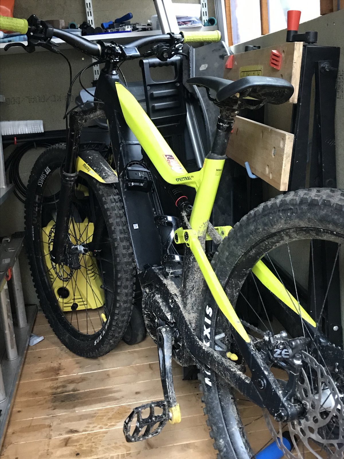

Degreased the chain, indexed and lubed and the noise is gone. I may buy a spare chain just incase it does snap at some point. It happened under high stress getting up a very steep bank

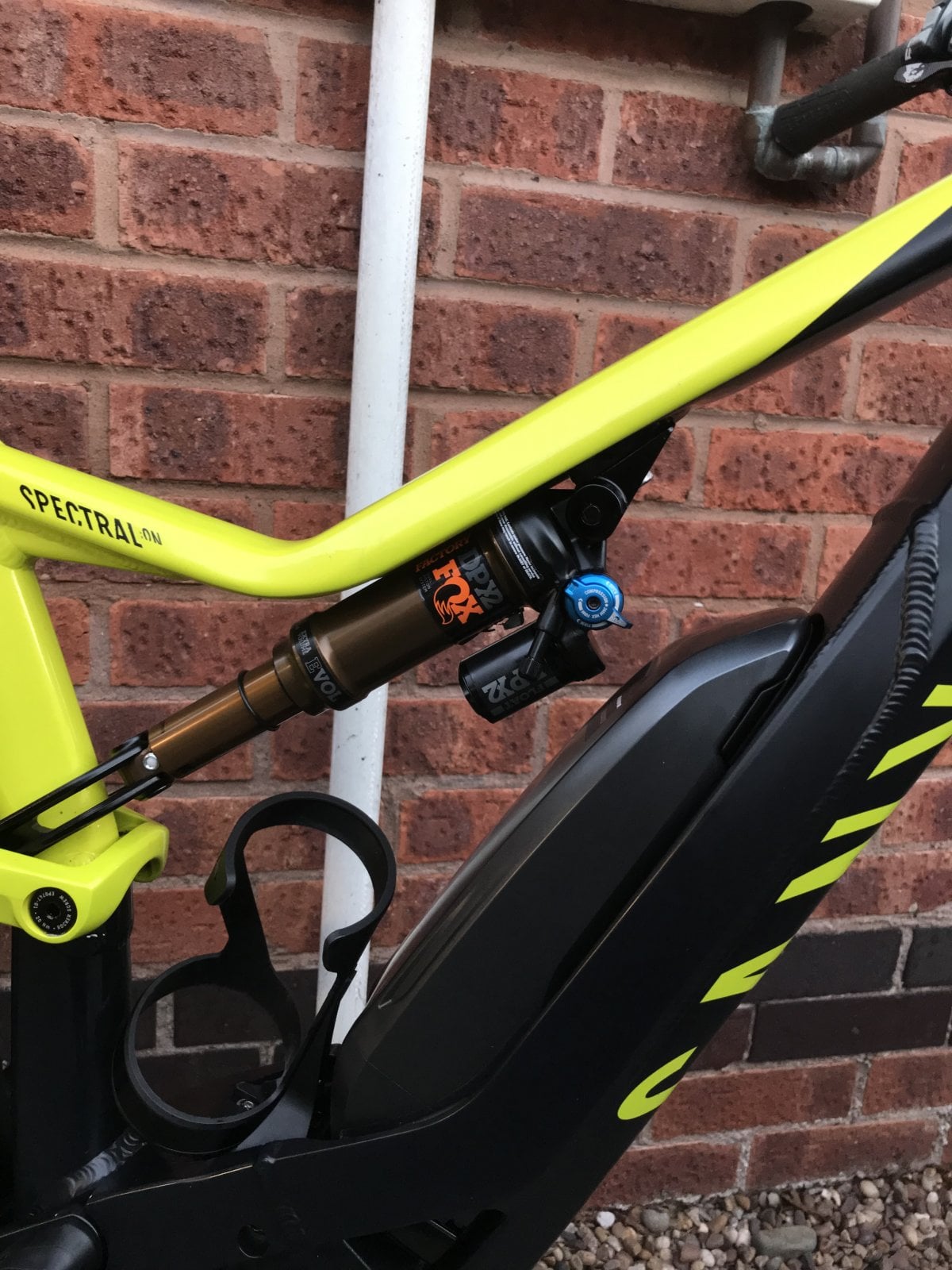

If anyone fancy’s an upgrade of shock the fox dpx2 factory 2018 fits lovely.
Out on a test ride tomorrow View attachment 8460
Does it make removing the battery out tricky? There's not much clearance between the battery and piggy back. Also does the shck stay in a perfect straight line all the way through the travel? If it angles downwards it might be an issue...
Does it make getting the battery out tricky? Looks awful close to the piggy back...
Nope,it must look tighter than it is as you can turn the battery on and off easy enough and taking the battery out is just the same
Looks lovely. What size is it? And where did you get it? Just curious, obviously :)
230x65 its actually off my yt jeffsy pro race so it now 160mm travel as the strokecis 5mm longer, i’ve only popped it on to try tomorrow but i must admit on the yt the shock is awesome. Maybe the tune will be wrong for the spectral

Just as i thought it would it rides like a dream,i really thought the standard rockshox delux was very good but the dpx2 is in a different league, i can’t fault the fit and perormance. Looks like when i put this back on the yt jeffsy i’ll be buying a new dpx2
