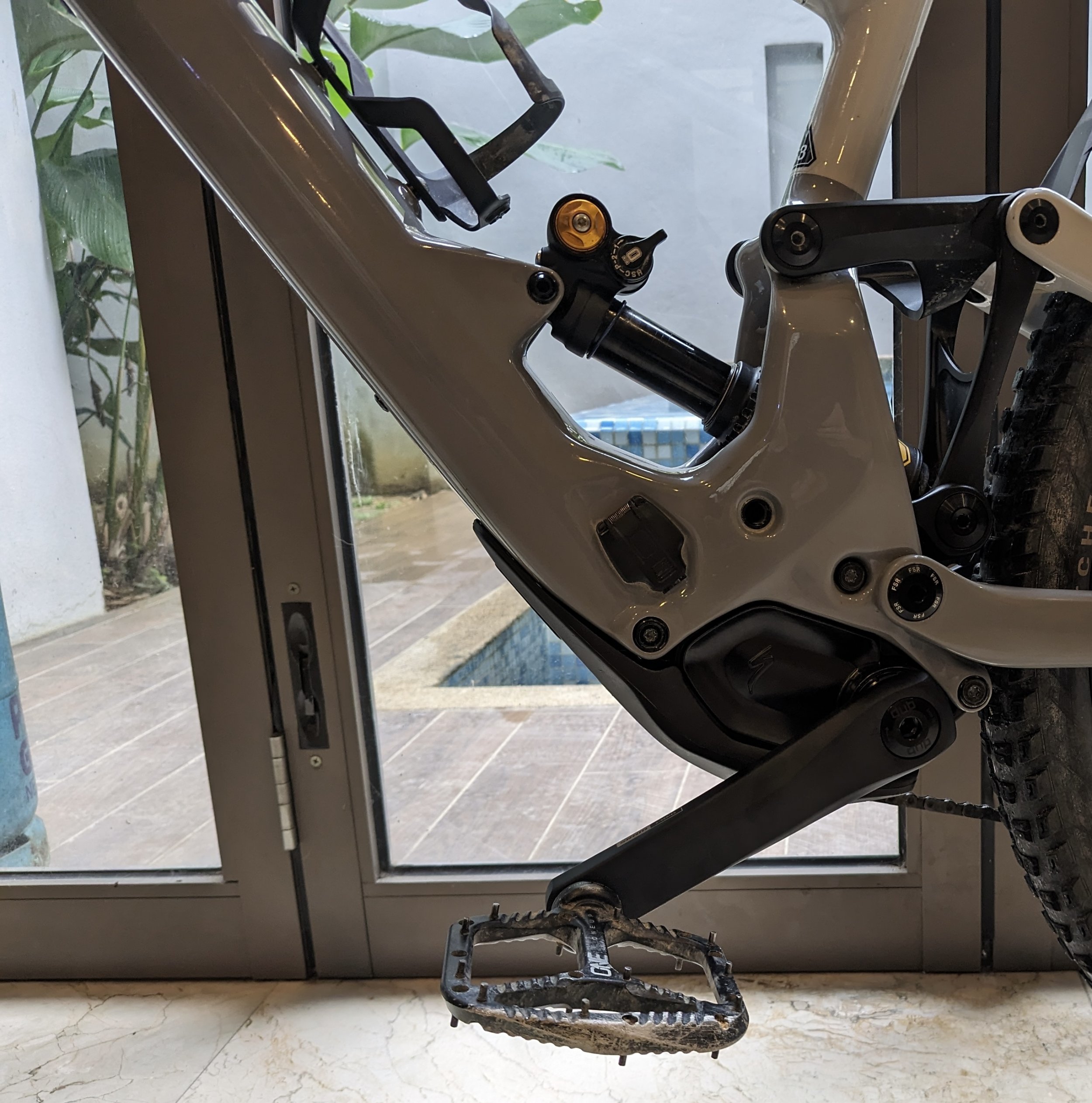

I fancied a bit of a trail bike to go with my kenevo FF And Kenevo sl, so picked up a new Levo sl gen2 comp, but fancied having the more powerful motor in the KSL so did a full internals swap (tech, motor and battery). Took about 30mins, didn’t even need to remove the chain rings. I now have a quiter and noticeably more powerful KSL :), and a less powerful but lighter Levo sl Gen 2. Happy days, KSl with the 1.2 and The t-type transmission has me falling back in love with the bike. The original KSl bashguard fits well with some minor modifications.
