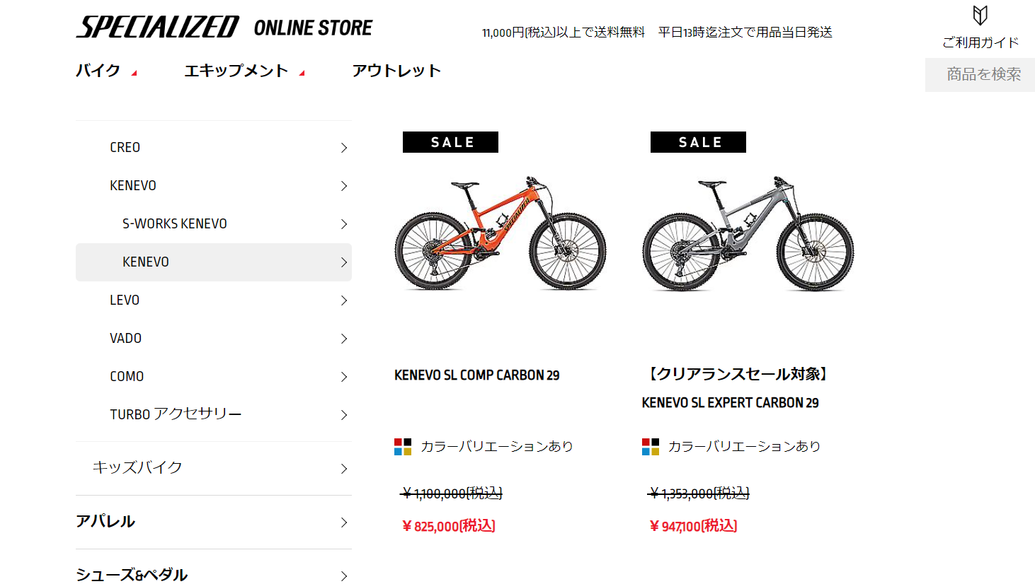

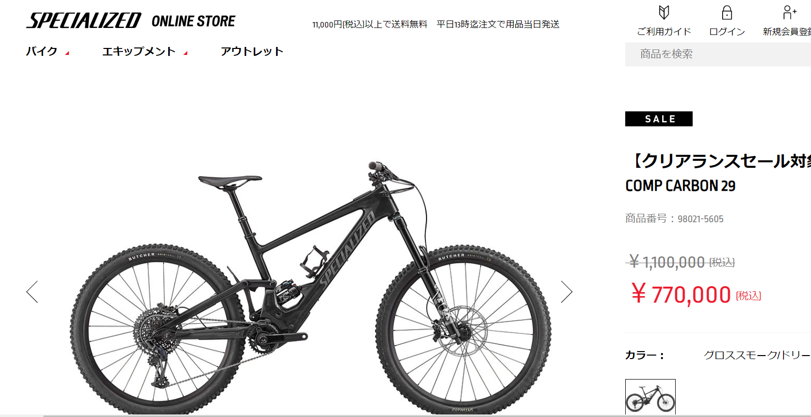

New 2024 Kenevo SL or maybe a typo on their website?
An excerpt from Specialized’s website with some details on the 2024 Kenevo SL 2024 model:
Turbo SL System​
UPDATE FOR 2024​
For Model Year 2024, Kenevo SL is updated with the Specialized SL 1.2 motor. The rock guard/motor cover are updated to fit the 1.2 motor. The cranks, spider, and chainring are also different than earlier versions.
MOTOR​
Specialized SL 1.2 motor is 30% more powerful than the 1.1 motor, providing 320 w / 50 Nm of peak power, and 250 w of nominal power.

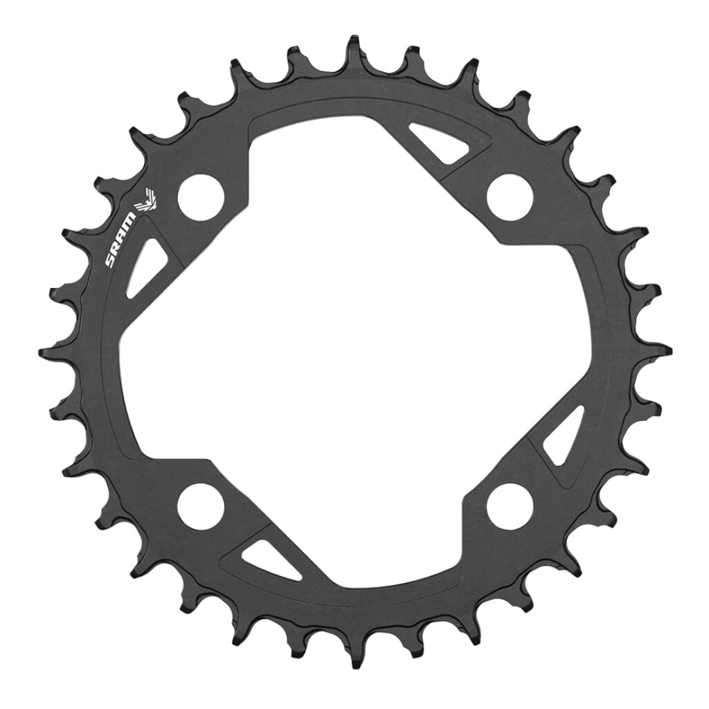

Burgtec do a 94 bcd chainring as well. Maybe you can get one of those locally
Unfortunately it isn't compatible with T-type chains. I ended up going with a 104 BCD spider replacement and Wolftooth chainring and bolts.
I found this. I think it will be released soon.
But I don't know how to buy it.
