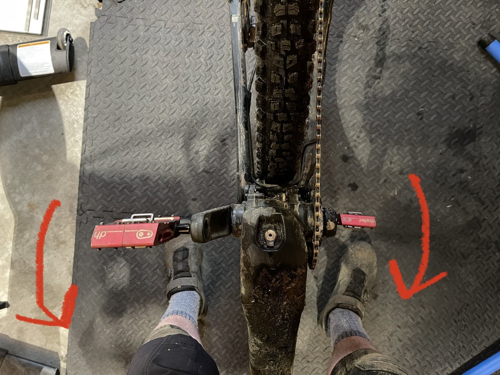

Anyone ever hear of a bent crank/motor spindle?
On my 3rd set of alloy Praxis cranks (warranty… they’ve been great about it) and just realized the this newest set of crank arms feels bent right out of the gate.
It’s not the pedals - cross checked those on my other bike.
There’s a healthy about of huck to flat in my zone, but never bent a pedal or crankset before the KSL. Pedaling with a bent setup is starting to graduate from annoyance to a real pain in my knees so definitely want to get this sorted.
There’s a healthy about of huck to flat in my zone, but never bent a pedal or crankset before the KSL. Pedaling with a bent setup is starting to graduate from annoyance to a real pain in my knees so definitely want to get this sorted.View attachment 81344
I’m guessing you are an aggressive rider to have bent so many cranks. I’m fairly aggressive and 200lbs. No bent cranks yet, but I’m worried about it. I sure wish someone made a good crankset for this bike. I have Dev5 cranks on my analog bike. They are strong and a work of art. I asked and they told me they have no plans to make cranks for the SL motors at this time.

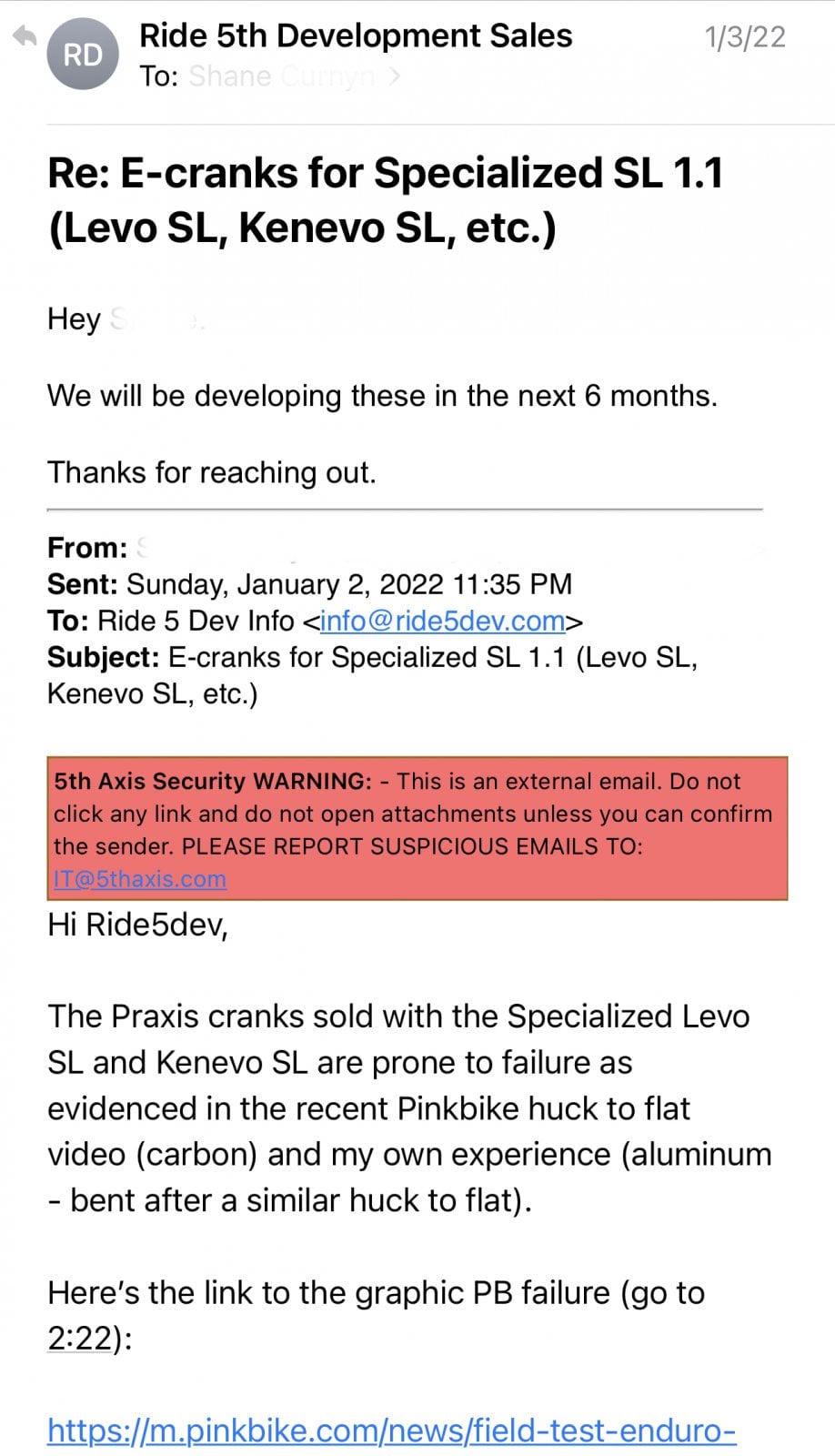

Thats super weird… I got a very different response. When did they tell you they had no plans to make SL cranks? Seems like a slam dunk market. Literally zero competition except for Praxis (who’s cranks failed in graphic slow mo on PB).
Maybe the cranks shown in the prototype? shown above are already the ones they were talking about. That would be good news as I'm a fairly heavy rider too who rides aggressively.
I’m am 300 lbs and the alloy cranks on the KSL Comp haven’t been a problem.
The ones that cracked during Pinkbike’s huck to flat test was the carbon version.
I’ve read of a couple of people beendig their alloy cranks too.
Beginning to think I bent the actual spindle (not the cranks) seeing as I just put on a new set of cranks and they immediately felt off.
Yeah, KSL frame came with carbon cranks that I swapped for alloy after seeing the PB fail.

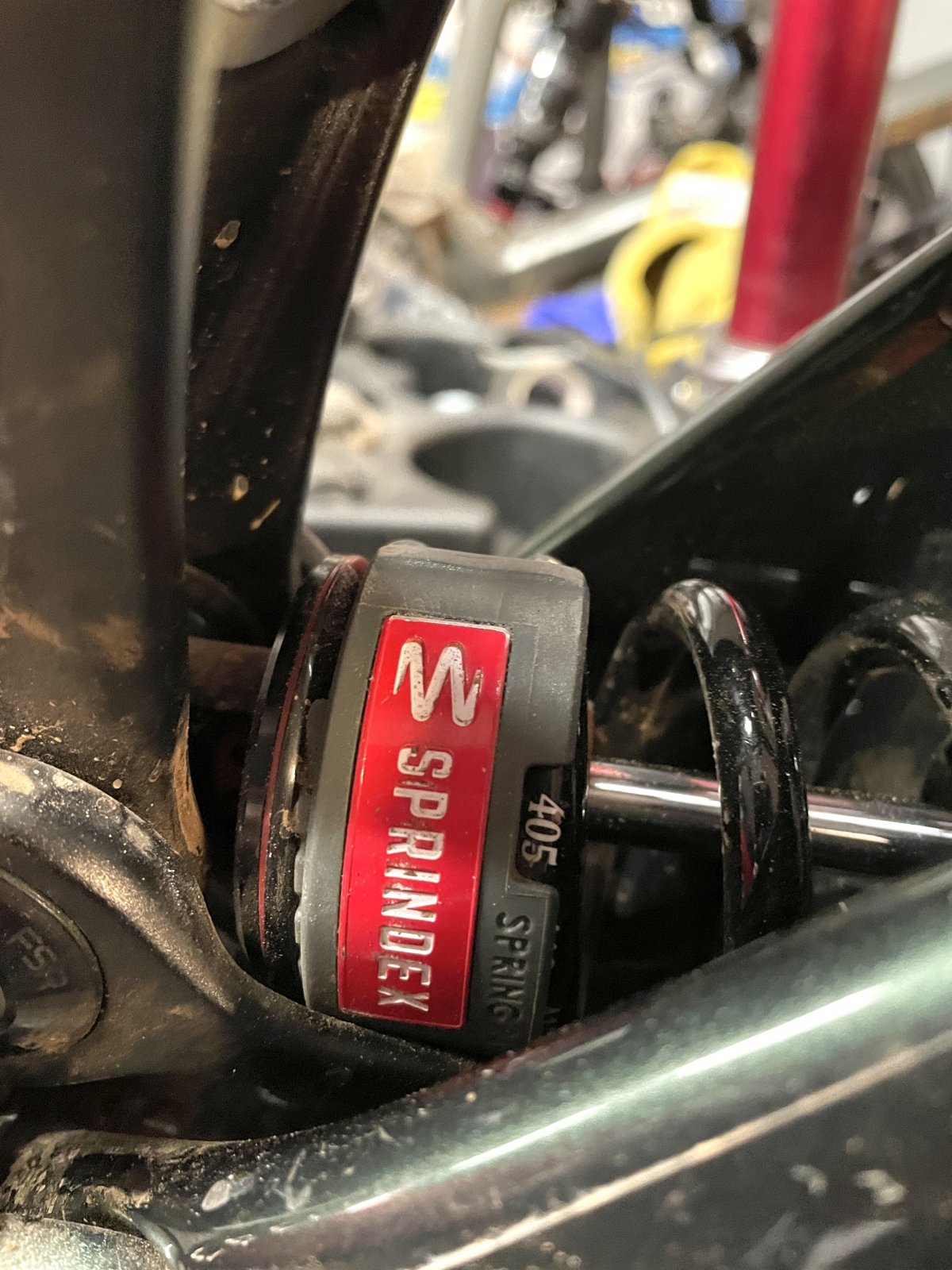

Just a note for anyone who may want to run a Sprindex - make sure you grind down or cut off the tab that sticks up. I just noticed today after a few rides that the tab had been scratching up the inside top of the shock tunnel. Luckily, there was no damage to the carbon. I'm still able to easily turn the adjuster without the tab.
That is weird. I didn’t save the email from them so I can’t post it. I ordered the cranks for my Stumpy Evo build about 3-4 weeks ago and asked them at that time about any plans for Kenevo SL cranks and they responded “not at this time”. I hope the response you got is the correct one. I agree with you that they would sell a bunch of them. They are expensive, but if you have the money for these crazy expensive bikes you can probably afford them. They are machining art. I almost hate to ride them and scratch them…almost😂.
Fingers crossed! Maybe they didn’t realize Kenevo SL & Levo SL are the same platform (?). We’ll see. Probably makes sense for them to wait until the new levo SL comes out in case Spesh switches it up.
About a month ago when I ordered a set of cranks for my Stumpjumper Evo. They told at that time they had no plans to make cranks for the SL motors. Hopefully what they told you is correct. I’ll be first in line to order a set when they do.

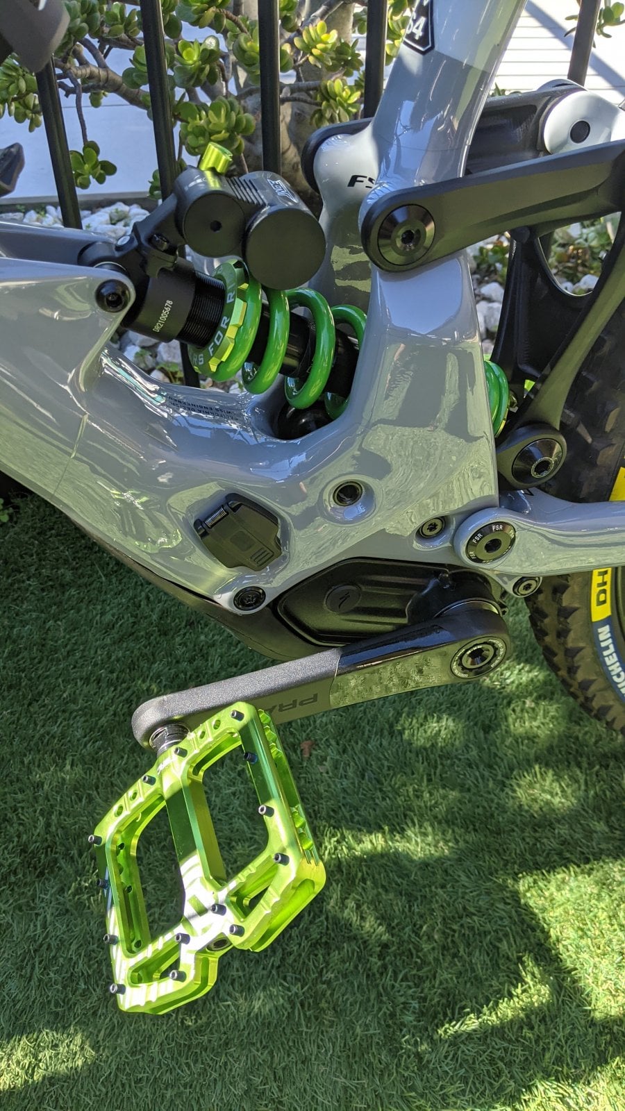

I didn't like the X2 on my KSL. I just had a DHX2 fittet at my bikeshop and can't wait to go for a ride. Unfortunately covid crossed my plans.. 😩😤 Need some time to feel ready to go out on the trails..
I am considering an upgrade to the Kitsuma coil with Sprindex spring fitted. Did someone install a Kitsuma coil before? Did you go with the standard fox "hardware"?

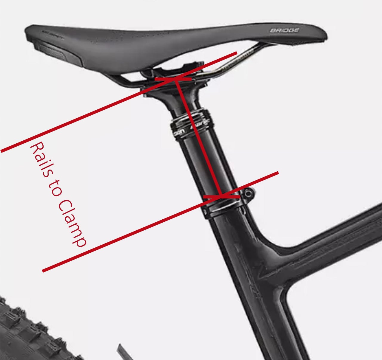

I know there are various measurements on this already in this thread (I've read all twice), but they are all sort of random since most didn't slam it and measured arbitrary distances (bottom pedal to top of some saddle, etc..) none of which are universal sadly.
Could someone with S3 size and either 150mm or (better!) 180mm OneUp v2 measure this length as pictured (slammed saddle, slammed post, and centre of rails to top of seat-tube clamp. Pretty please! Very grateful:- )
It's impossible to measure this purely from existing seat-post insertion depth because I can't measure how much from insertion depth is due to actuator and how much without.
Also I wonder, how much different is the insertion depth between 34.9 and either 31.6 or even 30.9 diameter. I know Specialized uses 30.9 AXS version often, I presume this is due to their reaming/actuator space difference.

Using this measurement I have 125mm with the post slammed on a 210mm dropper shimmed to 200mm drop.
This is on an S3 frame. This is definitely inserted as far as it can go into the seat tube.
Thank you so much! Ok, that would line up to insertion depth of 205mm with OneUp v2 then (Specialized web says 197mm full diameter depth, and 210mm for X-Fusion Manic).
For me (32"/82cm) inseam means 180mm OneUp v2 shimmed to 160mm would have same height when slammed as stock 150mm Manic. Eh.. some improvement I guess.
All the benefits of dropper's low-stack height don't matter much when insertion depth of frame sucks.
I wonder if the V2.1 actuator fits on v1 170mm dropper. Such combination would yield ultra-low 465mm total length for 170mm dropper. 180mm with 480mm is big jump from 150/420mm.
