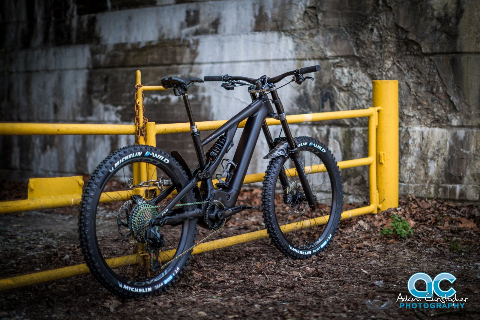

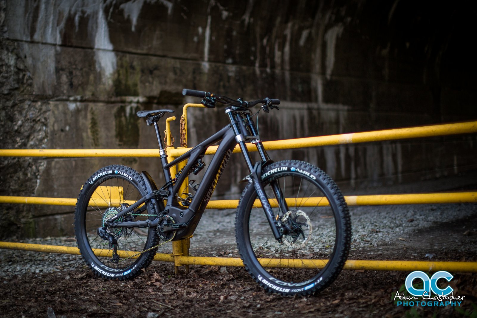

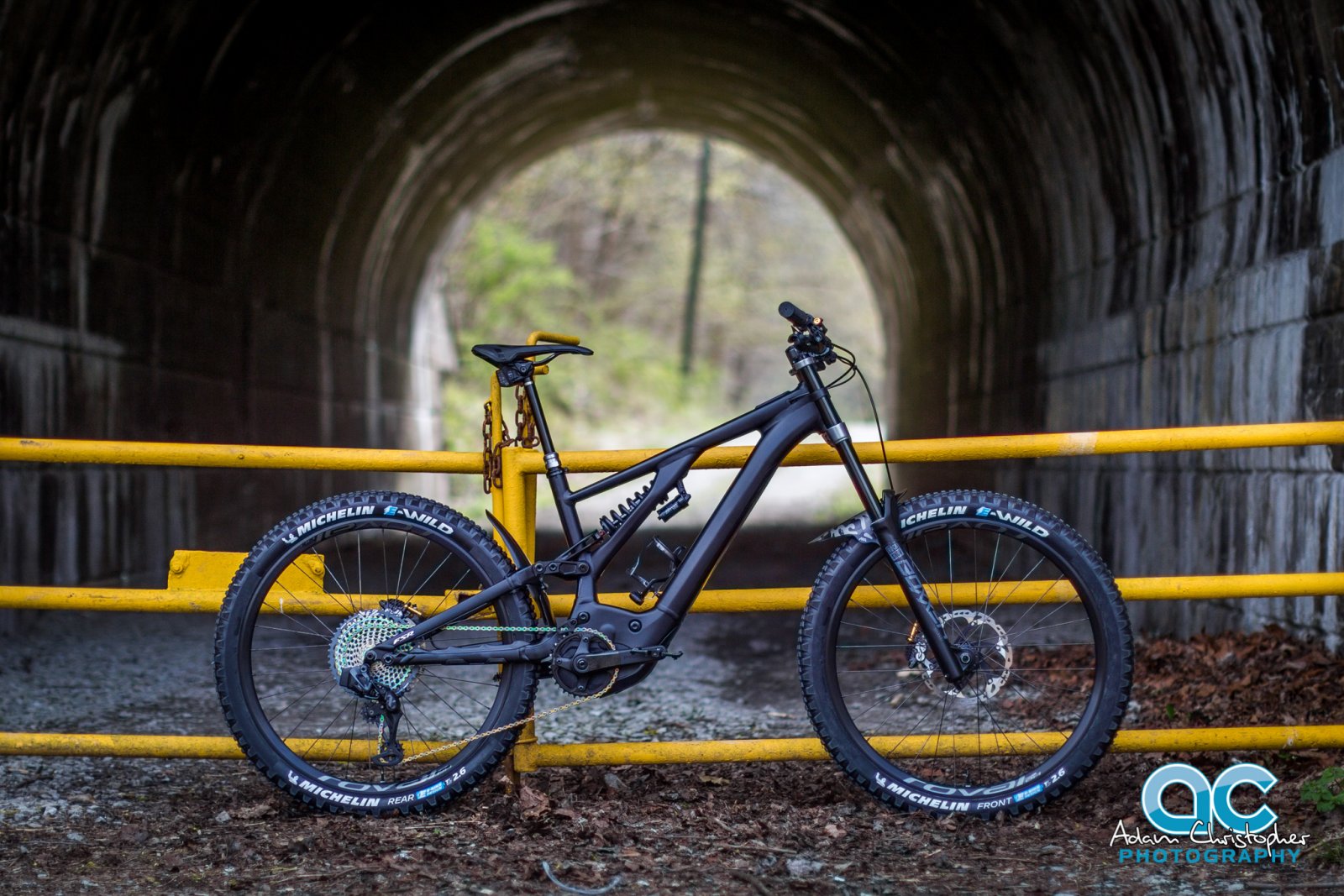

I snapped a few photos of my new bike while it was clean.
I think the competition has just started ?
Argh.......can you move the 1st Pic to the day thread ?

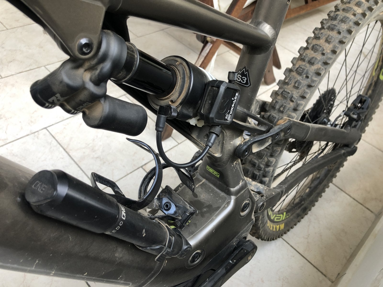

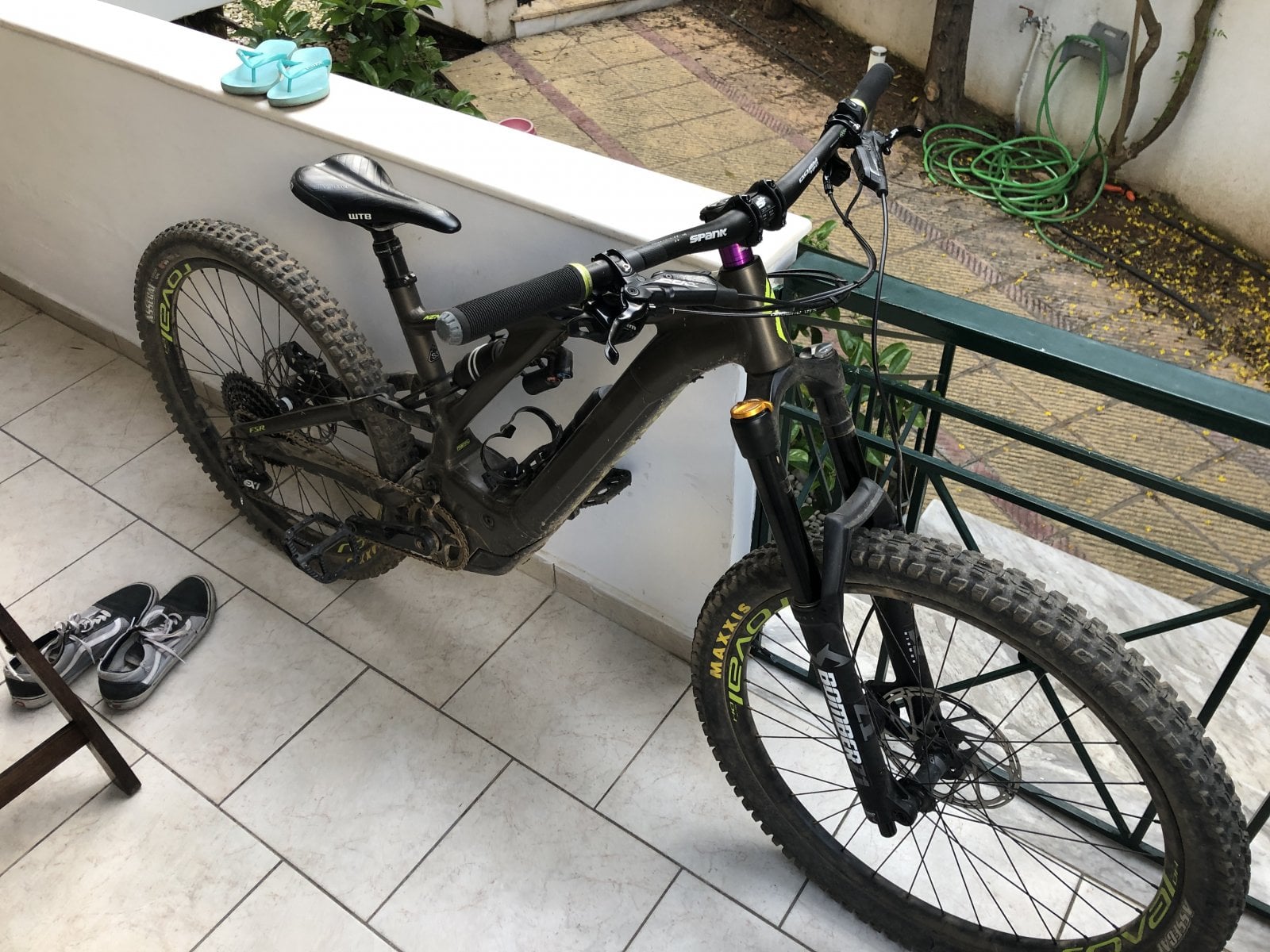

This is an update on my setup in case anyone is interested how the project is coming along.
I recently purchased a 2020 Fox Float X2 for my Kenevo. I've been riding it for a couple of days and I have been impressed. A few notes:
1. The shock was custom tuned by J-Tech suspension. What an awesome service... The instructions were to just set the sag and go ride. Volume spacers adjustment was spot on, rebound was spot on, compression was just two clicks firmer than what I needed. Excellent!
2. The Marzocchi Bomber CR coil shock removed and I think there was a slight oil leakage from the shaft seal. During the last weeks, I have been adding rebound and compression to keep constant performance, however the shock was simply not working properly. The Marzocchi shock and spring are for sale.
Next upgrade will be the fork. I have found a DVO Onyx D1, brand new, for the same money it would cost me to upgrade the Marzocchi Z1 damper to GRIP2 at Fox along with a full service. I am afraid the DVO will be less stiff than the Z1. I have also talked to J-Tech regarding availability of the 2021 GRIP2 damper and if it will be backwards compatible to the 36 chassis. We will have to wait for a few weeks.
The bike is awesome, the more I ride it, the more I like it.
Brgds/Nikolaos Tsivis

Onyx is definitely stiffer than a 36 and a Lyrik and is a better fork imo. I'm guessing the Marzocchi chassis stiffness will be similar to the 36. I tried the GRIP2 damper in a 36 and preferred the FIT4 damper that had been vorsprung tuned.

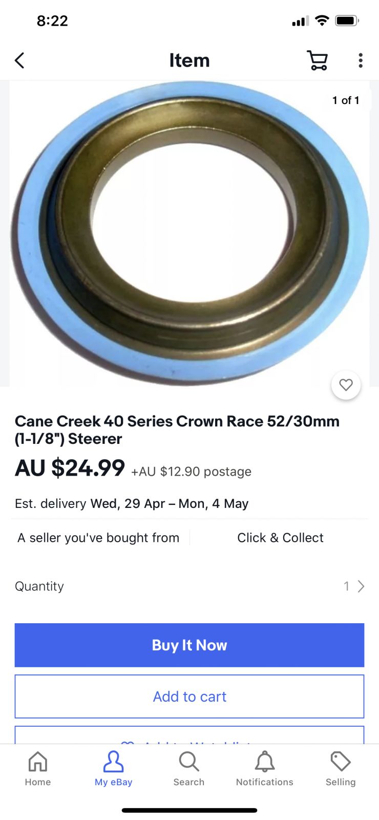

My brother had the exact same issue. Got the fork replaced and it was still there. Ended up replacing the crown race to a cane creek crown race and it solved his issue. The factory one has a split in it and is a poor design imho.
I’d check the above mentioned things first though as that could also be the issue.
My Kenevo Expert with Boxxer has started doing some creaking noise from the handlebar area, it's a bit hard locating where the noise is coming, but while riding some rougher terrain there's quite prominent creaking happening. Tried losing and tightening again all the bolts on the stem and fork, but the creaking noise won't disappear. Any ideas what to try next?
Can you tell the exact part number for the cane creek ? Does also resolve the "gap" ?

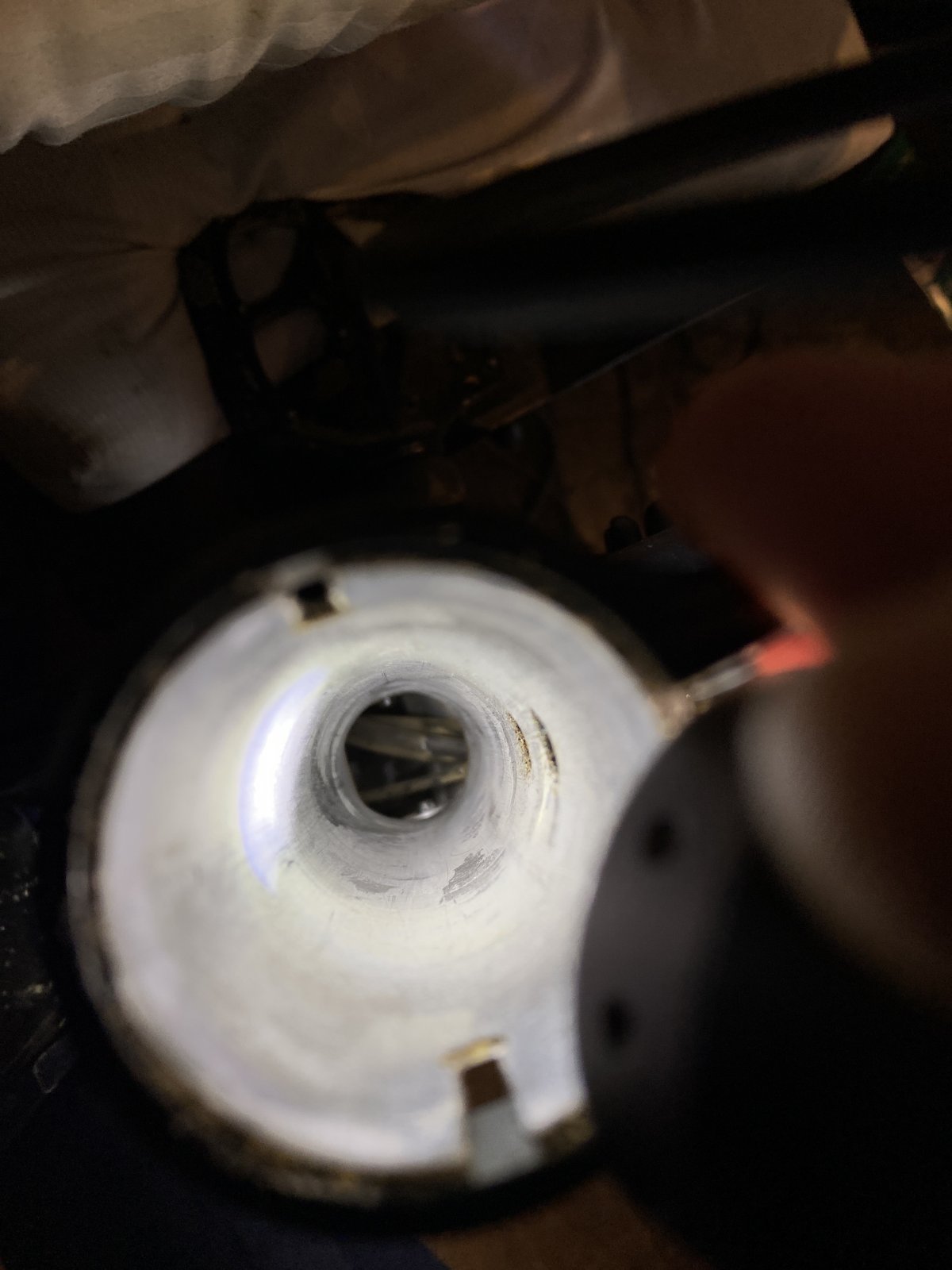

Lazy question but does anybody happen to know the max insertion length of the seatpost on the S4 Kenevo? Just looking at the 180 and 210mm OneUp droppers and wondering if I could get a flush fitment.
240mm before it hits the bolts that protrude through the frame by about 3mm. There another 20mm below that before it hits the plastic cable guide.
You could probably re route the cables around the dropper if you wanted to. Would probably be a motor out job though.
Thanks Christian!
  • Like
Reactions: CjP
Thanks Christian!
In case could help , I'm running a reverb AXS 170mm completely inserted 245 mm + 20 mm of valve ;-)
