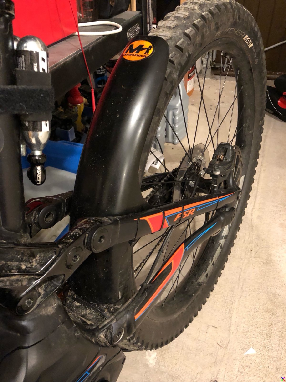

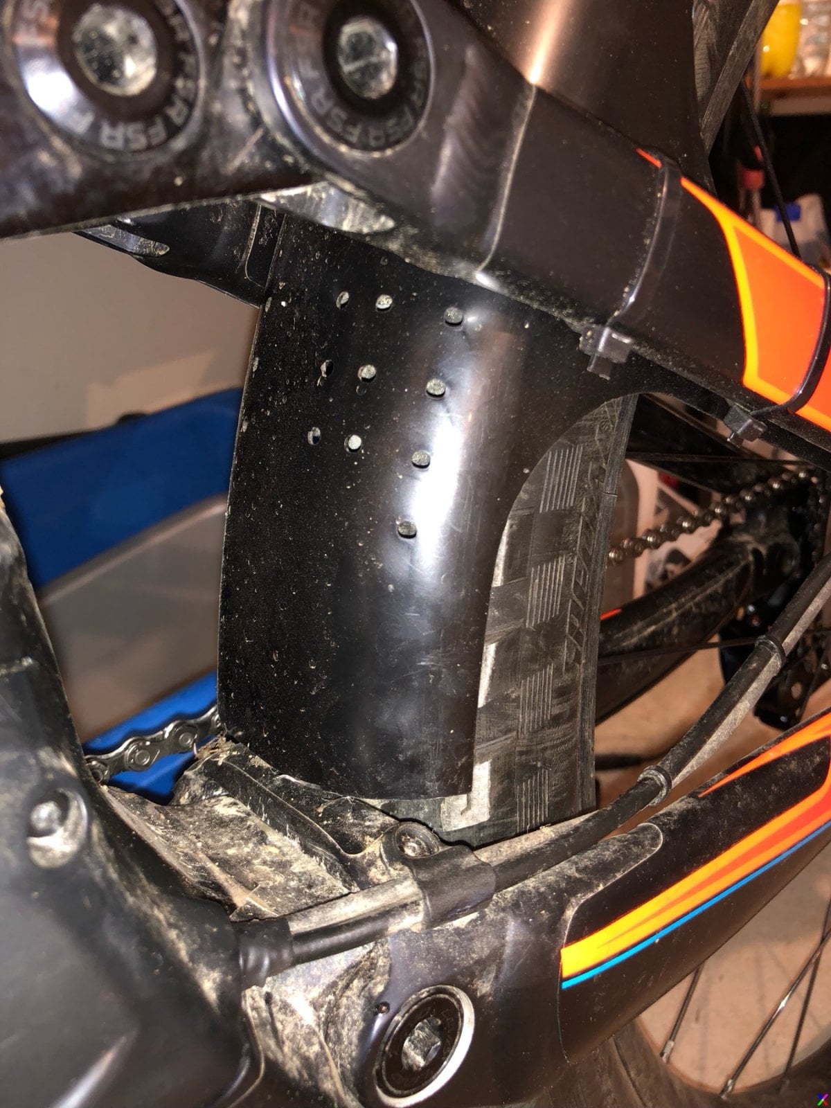

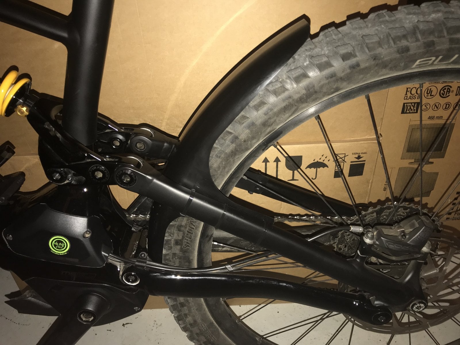

Replaced my ugly rear mudguard with a mudhugger ("front race"), looks much smoother now.
Had to cut off the mudhugger at the motor housing area by 3-4cm, cause it had contact with the tyre nobs there. And drill some holes for a third pair of zip ties to keep it at the designated position. Will provide a better pic in the mudhugger-thread soon :)
Hi Donnie. SNAP! I literally just got back in from the garage to post some photos after you commented on my Mudhugger in the other post on durability the other day.
Also Front Race and cut the front and also added a third pair of zip ties!

Hi Donnie. SNAP! I literally just got back in from the garage to post some photos after you commented on my Mudhugger in the other post on durability the other day. View attachment 4278Also Front Race and cut the front and also added a third pair of zip ties! View attachment 4277
Haha, what a timing @c4s2rs6 :LOL: Thanks for taking the photos, i'm sure it will help others anyway.

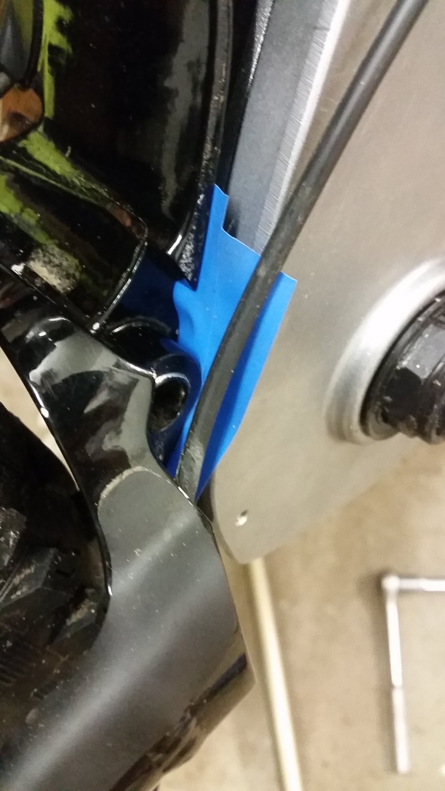

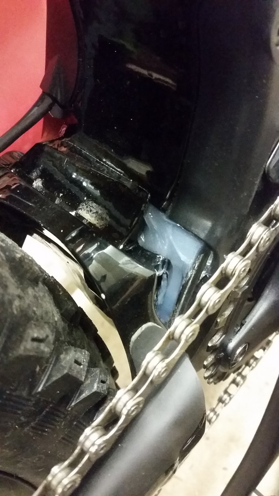

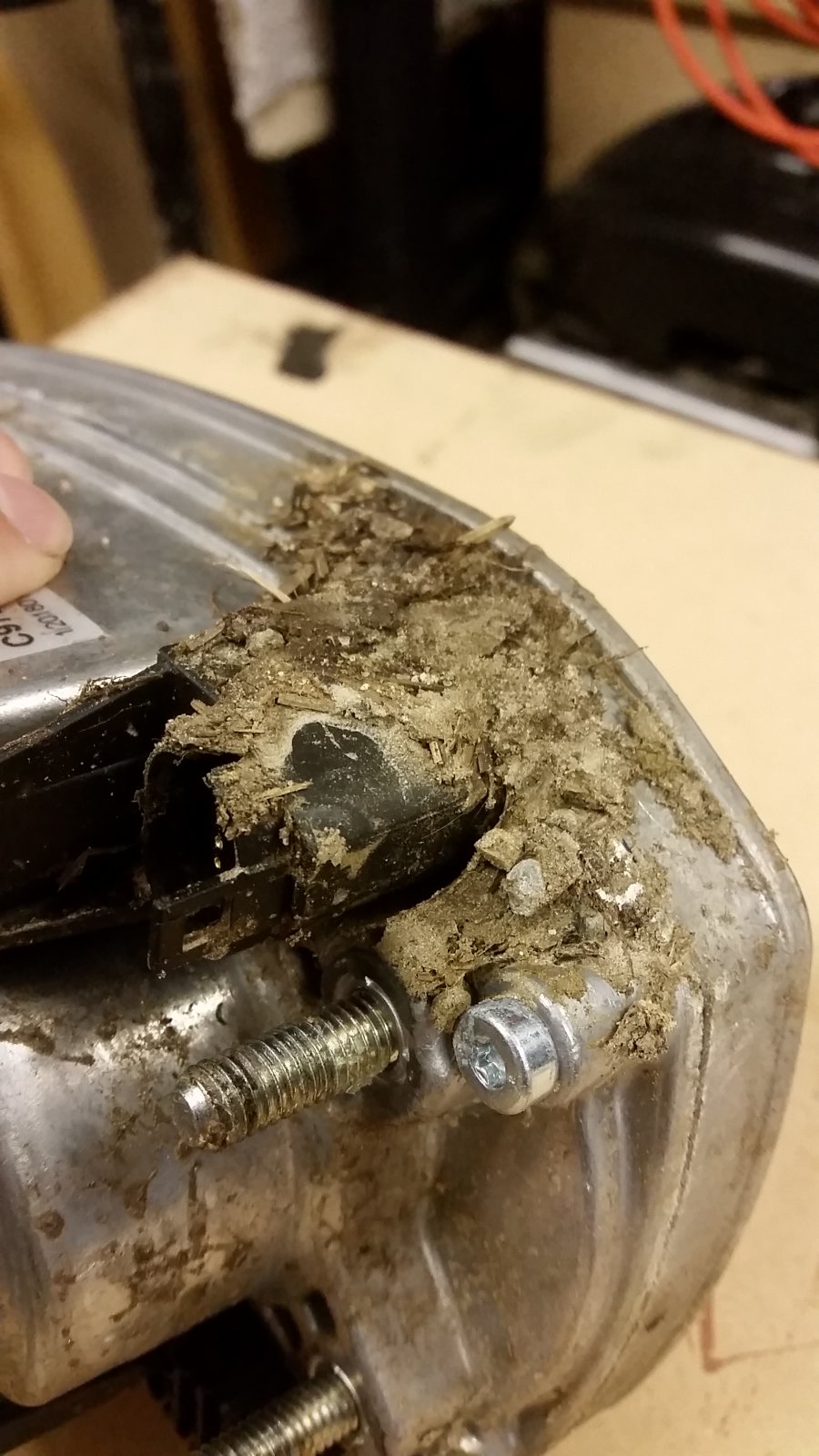

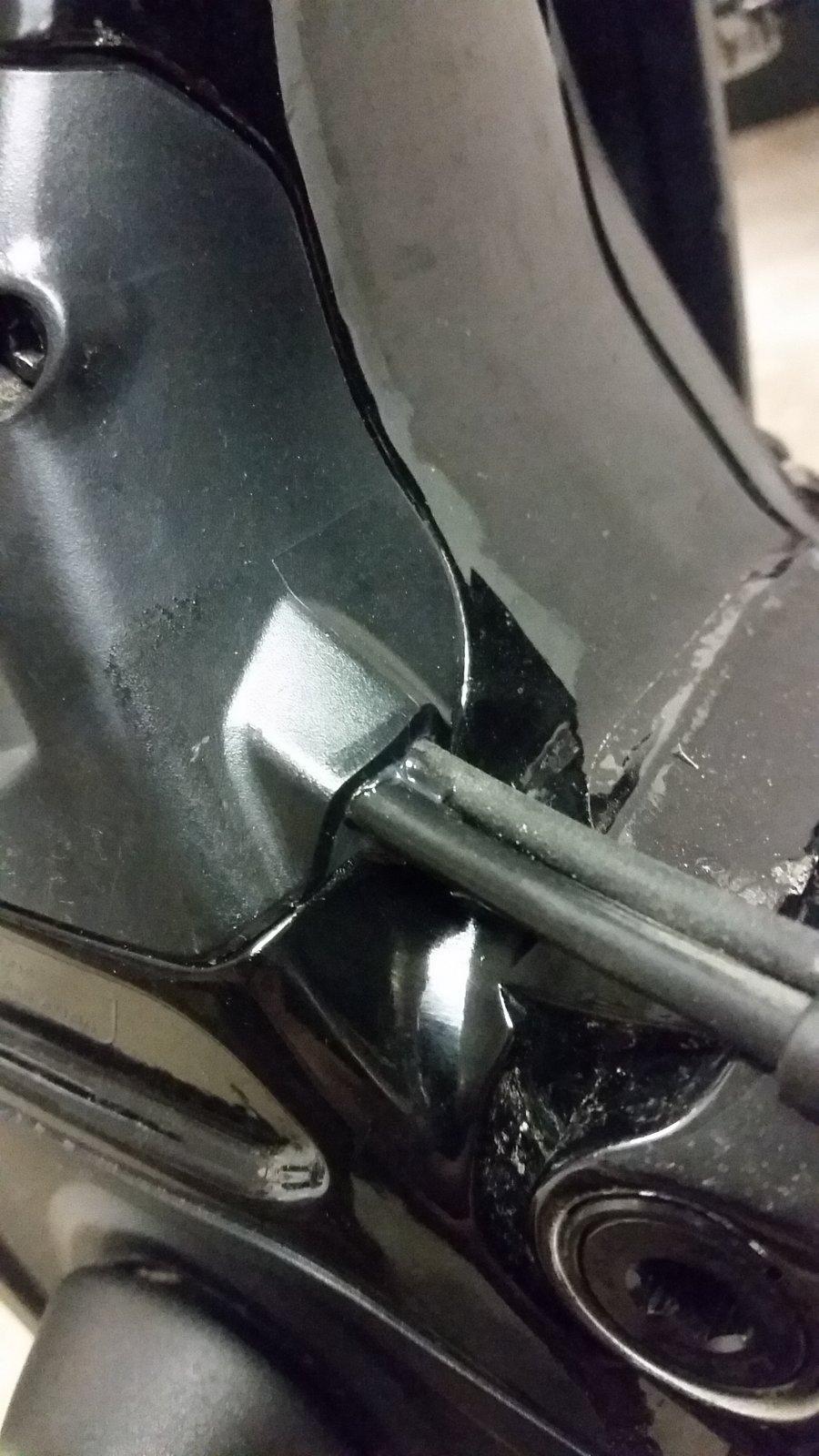

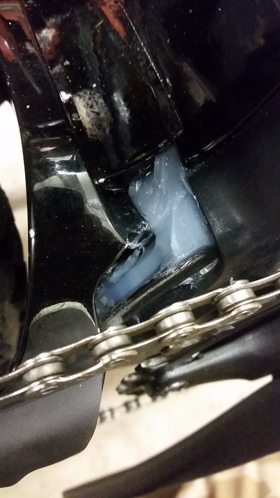

Having seen all the gunk and mud getting into the gap near the top of the casing on the drive side, I decided to strip the motor out and have a look. It was much worse than I thought - all of it congregates around the power lead input. I'm sure others may have come up with alternative fixes, but I went for a good blob of silicon. Rather than just pump in loads which would get all over the motor casing, I carefully fixed some insulation tape to the frame cradle, away from the motor. When the cover is fitted back on, you can just fill up and smooth flat. I'll see how it goes, and if it works, I'll update you all.
I put a little in the front of the casing too - but there was no ingress of dirt from this side so not really necessary.
Silicon is easy to pick off - so if it doesn't work, then there's no issues. Nothing ventured - nothing gained !!!

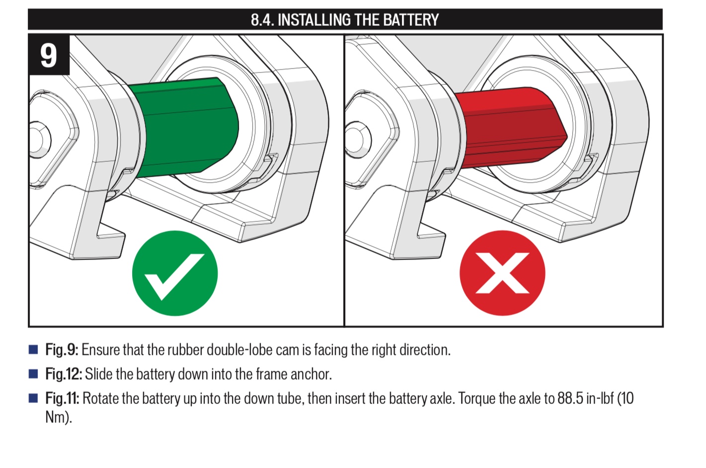

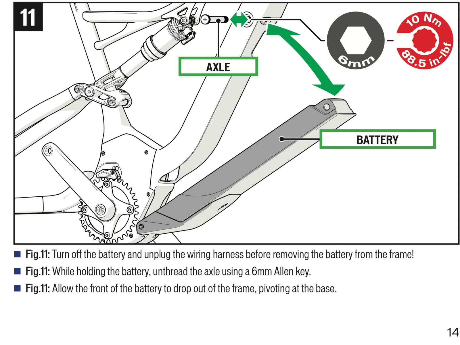

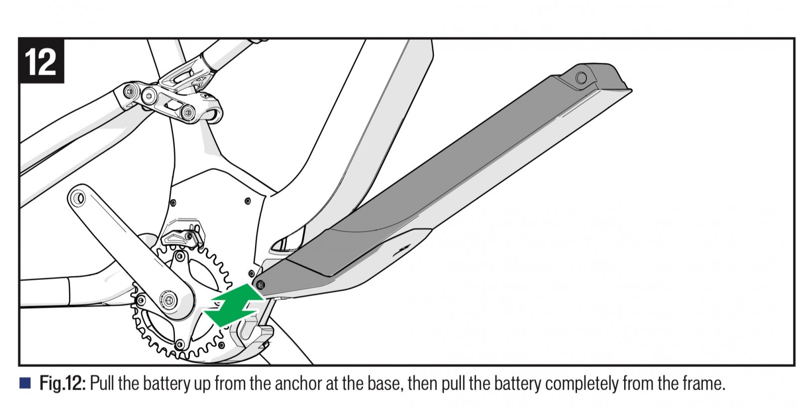

Hello folks - anyone experience difficulty aligning the thru bolt with the female thread when replacing the battery? Threads are perfect, bolt threads fine without battery however with battery there is a mm misalignment which has stumped me
I was struggling to get my battery back in snugly, until I noticed that one of the cables wasn't clipped in properly in the downtube
Mk1 clomptometer?
Check the orientation of the locating cam, as described in the manual
Dax, Sammy can you please describe the solution simpler for a german language speaker. I face the same problem after appx 10 battery in/outs. Bolt doesnt fit as battery doesnt fit for appx 0,5 mm into the frame any more (no problem at the first battery in/outs). I can amange it if I press the battery on the upper side very strongly to the frame but this cannot be the solution especially as it workes well in the beginning without any problems.
