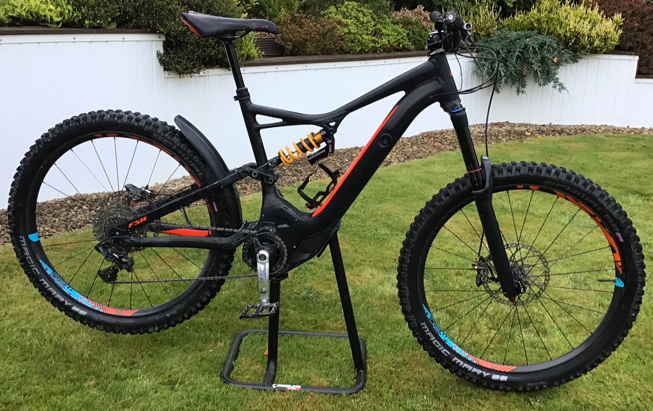

Not on a Kenevo but on my Frankenstien Levo I have been running 2.6 Ultrasoft DH version Magic Marys.
Please note, they are a lot heavier than what you are running but they very grippy and have very low risk re pinch punctures due to their super thick carcass
I am running them at 25psi front and 27psi rear with 120ml of Stans sealant
