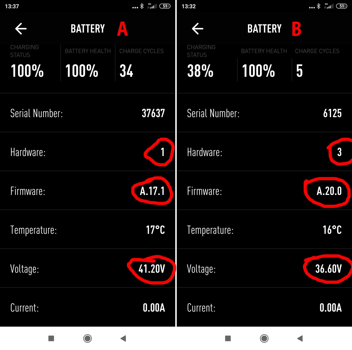

hello,
does anyone know what the differences are in these 2 exactly same batteries for kenevo and levo? been used on same bike kenevo expert 2019. differences circled in red.
one battery works longer than the other, i'm wondering if because of different hardware/firmware? why such difference in voltages?

Does Bat B still show 36V when fully charged? - Surely should be nearer 42V?
Battery B looks like a newer version. Mine is Hardware 2 on a 2019 Kenevo, with the A.17.1 Firmware. Not sure if firmware 1 & 2 can be updated to A.20.0 (@Al Boneta ??? do you know ?)
The lower voltage on battery B is because it's only 36% charged, so the voltage drops as the charge level drops.
For the battery health, MC generally shows 100% no matter what. For a more accurate idea you'd need to check with blevo or egenesis.
bought the bike in july 2019 with battery A. bought battery B in january 2020. battery B works way better than A. i've seen battery health below 100% on friends' bikes so it's not true that it will show 100% health no matter what.
i don't know what blevo or egenesis and don't have motivation to look into those. it's already bad enough you can't go ride without a phone, or can't adjust settings without phone.
this battery difference from A to B is just something i noticed in lasting power and when i looked at both i noticed the differences in hardware and firmware, that's why i asked on this forum if maybe someone knows, because sure specialized ain't gonna answer this question if i write them.

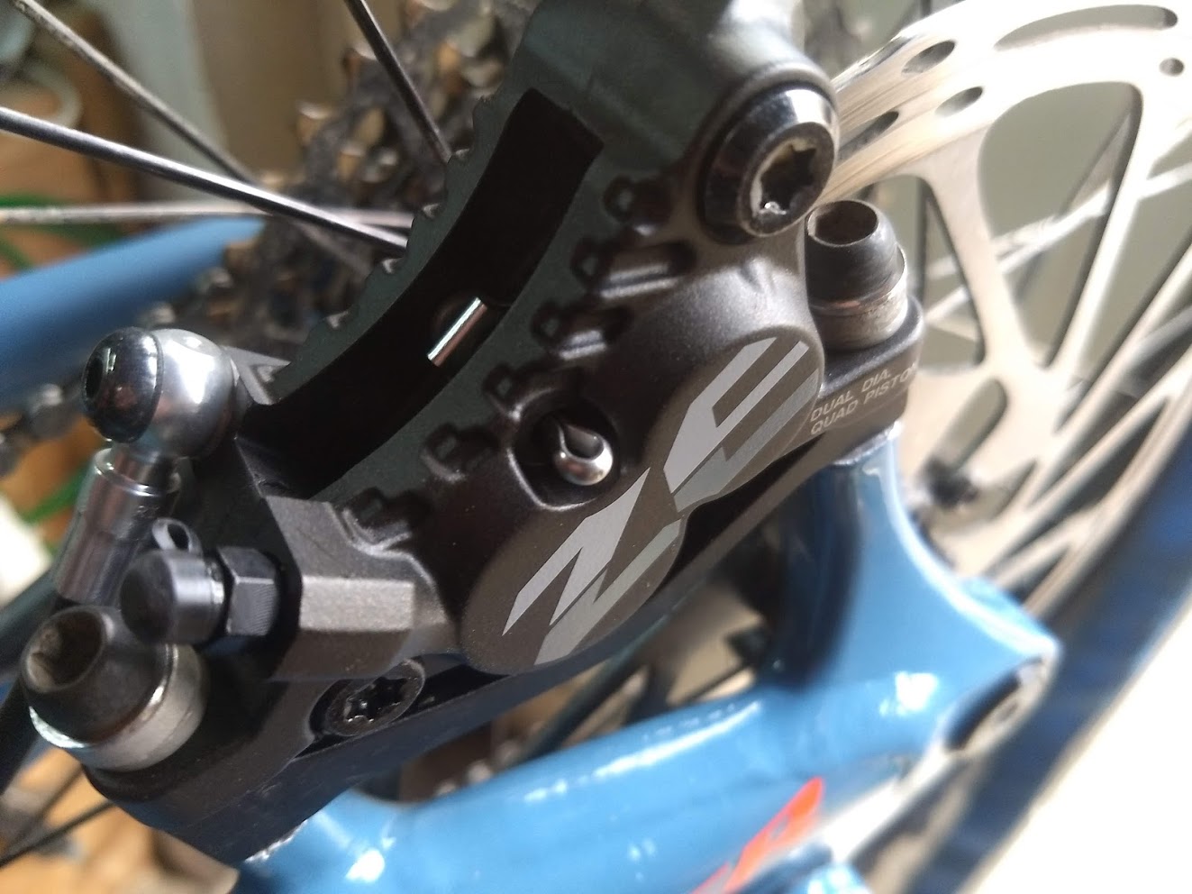

Installed a Zee caliper and lever. This is an easy straight swap and everything lines up and works correctly with the SRAM rotor, thanks @Dirtnvert .
The Code-R lever and the Zee lever are both basically the same shape and size, so they both feel the same from that respect and running the code on the front and the zee on the rear doesn't give any weird hand feeling.
The disk was thoroughly sanded and cleaned.
A quick ride to bed in and clear some fallen trees off the fire roads for a test.
Interestingly .. they still scream ! So it is the SRAM 200mm rotors which resonate. They only screamed once wet.
Feel wise, for me I prefer them. I didn't find them grabby - this was a super slippy sloppy mud fest and I felt like I had perfect brake control. I found them to be more predictable and effective - especially when wet. The SRAM's sometimes feel like you're just squeezing a sponge wondering when it's actually going to do something, the Zee's just add more braking corresponding to how hard you pull the lever. The SRAM's performance drops off hugely when they Scream, the Zee's felt exactly the same when screaming or not screaming :-)
I'll be changing the front's next and will probably change the rear rotor. The front rotor I might upgrade to 220, maybe even the SRAM one. I think a few people have said that the 220 doesn't scream and whilst I'm not descending 10000 meters at 100kph, there is most likely a performance improvement, even if it's only in subtlety ..

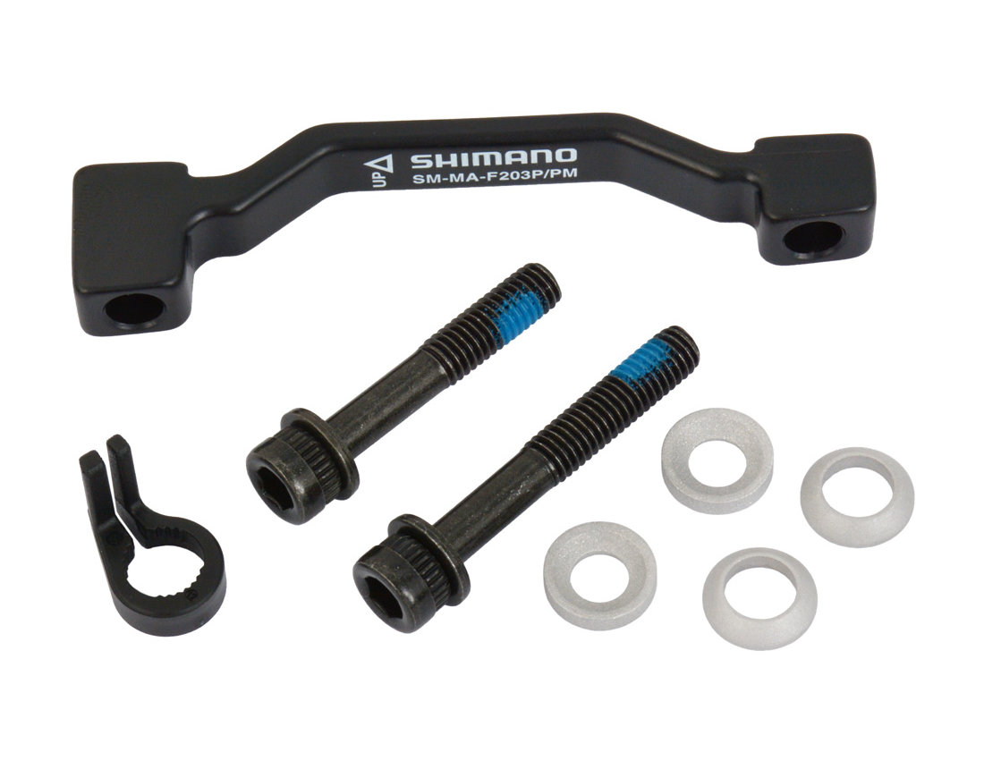

You're gonna have a hard time riding on shimano rotors with SRAM brakes and vice versa. if you run max size rotors. Shimano runs 203mm rotors, while SRAM runs 200. And obviously their calipers are shaped differently, thus their adapters are clearanced differently as well.
If you're running code brakes, their adapters will clear THEIR 200mm rotors. NOT shimano 203mm rotors

Thanks Yokev. Yes, the rear Zee works fine with the SRAM rotors and adapters. If I was to swap the rotor for a shimano, I'm not sure if the shimano caliper design would incorporate the extra 3mm of disk (1.5mm of rise) or if I'd need to space it out. I'm guessing the extra is worked into the caliper design, otherwise a standard fork/rear which would mount a SRAM caliper with no adapter would then need a 1.5mm adapter if the manufacturer put Shimano's on. But who knows ..

I can tell you this from experience: The 3mm needs to be accounted for. Sram makes a spacer 'kit' with various sized individual spacers, and I tried using it to mix/match SRAM/Shimano years ago. It ended up being a clusterfuck. Never could get the pads to sit flush with the top of the rotor(s), and I couldn't get 'em to stop dragging. Now mind you, the older I get, the less patience I have, but all kidding aside, using a spacer kit in place of a proper adapter is wonky.

MIght wanna consider them. If you have 180mm post mount forks, then you simply get 40mm SRAM adapters. If you have a Kenevo, you have 180mm post mount front and rear.
