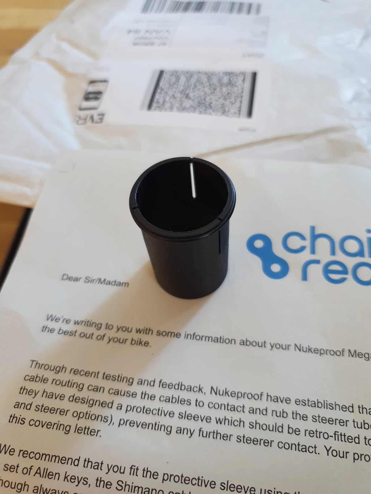

This might be helpful to other owners:
I received and email from Evri(Hermes) with a parcel due from wiggle to my parents house :unsure:. I panicked thinking someone hacked my account because I'd placed no orders recently, doubly strange it would go to my parents place. Checked all my cards, pay pal, changed passwords etc.
I had a in cling it could be some about my Megawatt (Originally shipped by CRC to my folks place as I was away). Turns out the assumption was correct. Apparently cables have been chafing the steer-tubes on early bikes and they have released a fix for it.
I wished they had emailed, me rather than just send a parcel blindly (and not to my address). Doesn't look like a permanent fix (ie it'll chafe through that shim), but I don't have it in front of me so at least they put out a fix such is life. Comments also suggest Vitus have the same headset and therefore the same problem.

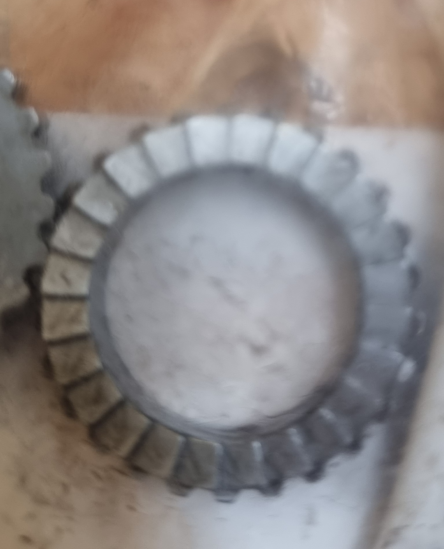

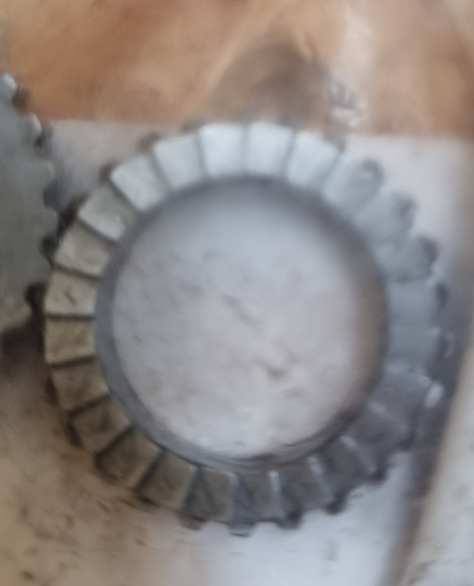

Does any one know what ratchet is in the megawatt factory rear hub (DT Swiss H1700 SPLINE 30, 27.5", 6 Bolt, Shimano Microspline Driver, 148x12mm)?
For a while I was wondering what felt off with my bike then I realised the engagement is to slow for me. Kind of throws me off balance like the chains dropped or I over stroke into a pedal strike. I'm used to Hopes 44T (which was the first upgraded on my old bike over the stock sloppy hub)
Does it have the stock 18T atm? I see DT do a 54T engagement but also a 36T. I'm pondering if 54T might not be such a good idea for both longevity/over engagement. Not sure I could live with 36T if I was used to 44T. I don't really want to be chasing this with money (I assume testing them means no refunds).
Fyi I think it was 24t ratchet fitted to mine (see attached). Fitting the 54T was so painless, easier than fitting a tyre. Totally tooless too if you don't count removing the wheel and the guy doing the job.
The bike feels more stable now (no wandering pedals) in a light gear and I can ratchet pedal over things without the pedal dipping to low.
