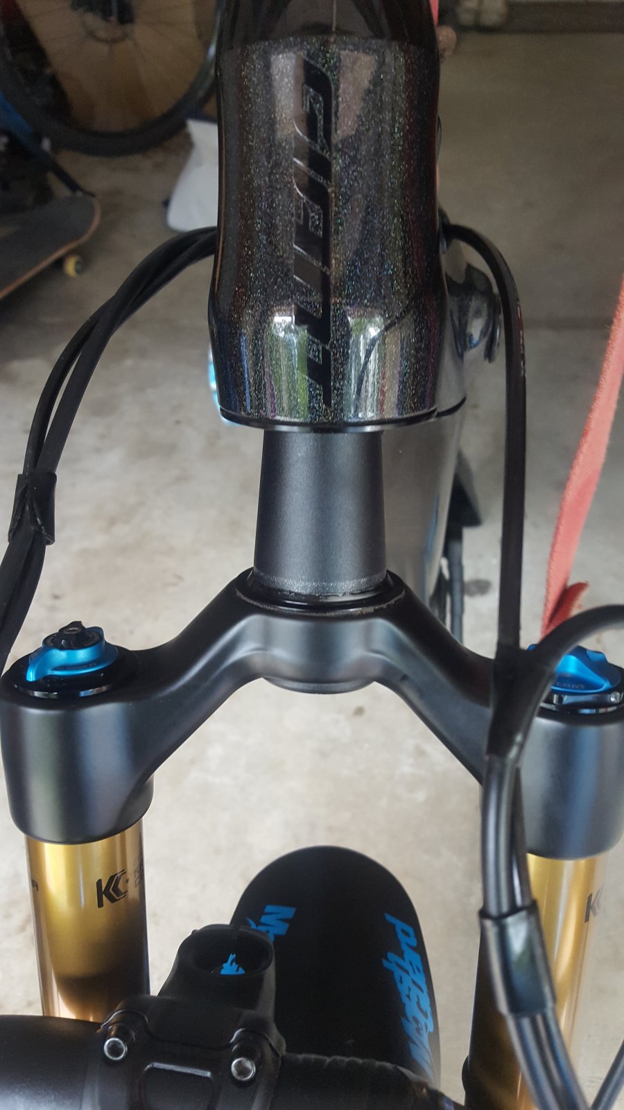

My front fork creaks when I lean my considerable weight over it at a standstill..... but i can't hear it when i'm cycling.

G'day Fat, i pulled my Giant front end apart on the weekend because the bike developed a creak that was annoying the crap out of me. It was coming from the front somewhere. Cleaned all the mating sufaces, stem spacers, stem, bars etc. Regreased and re-assembled. Creaking is gone. It has been dry as a chip here and pretty dusty. Don't loose interest mate, it's just the bike talking to you telling you it needs some lovin.

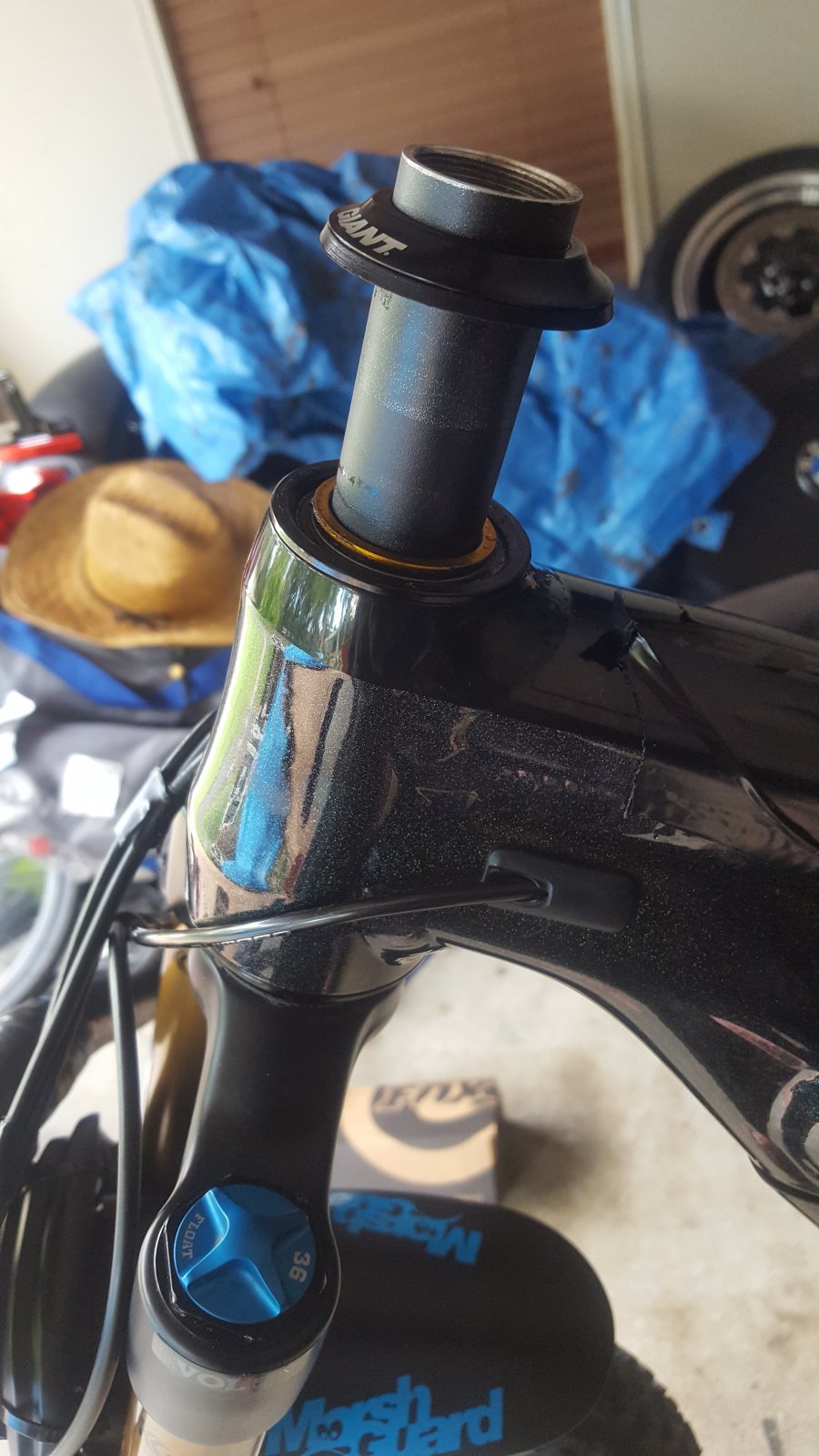

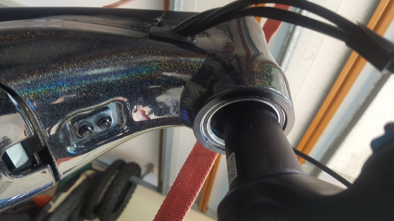

Quick update
Thanks for all the advice and help.
I changed, lubed and yes cleaned components individually to see if/when the nose would go.
Cleaned bike - no change
Swapped saddle - no change
Removed and lubed seat post - no change
Headset - removed/cleaned/lubed top bearing - no change
Headset - removed/cleaned/lubed lower bearing - oh my god it’s gone, the noise has gone.
Phew
Thanks again

One thing that may help...……..when I stripped cleaned and re greased my headset I noticed how easy it was for fine dust/grit to get to that bottom bearing seat ( the black split seat that sits at the bottom of the steerer tube) through the small gap between the frame and the fork. When fully assembled I pushed grease into that gap allround with my finger. It has been very dry and dusty here since then and some rides have been on sandy moorland but I have not had to service the headset since. The idea is that the grease captures that dust/grit before it gets to the bearing set. If it does get to the bearing seat, the fact it is a split bearing seat allows the sand/grit to get between it and the bearing cartridge effectively spreading the split seat and therefore giving a bit of play that then rattles.
