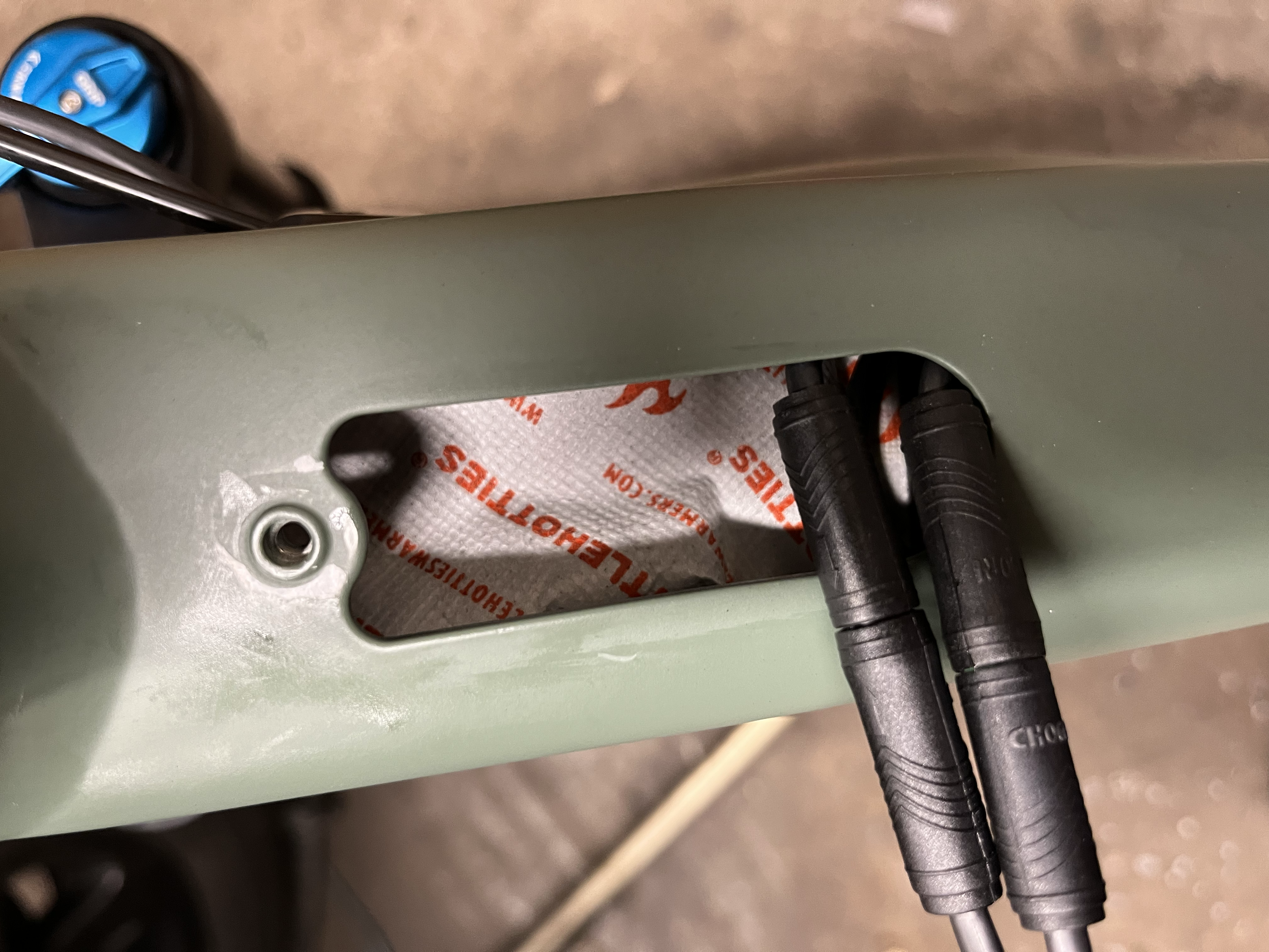

Hi all Ive just purchased a 2022 Levo comp, first time to go out on it today and it came up with error code on TCU, 1 red bar then Error code no.4 - Battery & Motor, the TCU has an issue with the temperature sensor in that if its below 6 degrees it comes up with the fault and can't start it,
I heated the TCU up with a heat gun and it started working, tried this a couple of times to make sure and its temperature related.
Ive used 2 hand warmers stuffed in the frame under the TCU for a short term fix as specialised Switzerland are working on fixing the issue at the moment.
I'm heading into the snow today...
Not sure if its all bikes that will have the issue but my friend has same model and developed the fault after 6months but his wife's bike has no issues and slightly older, bike been in cold garage all day and the hand warmers have solved the problem
