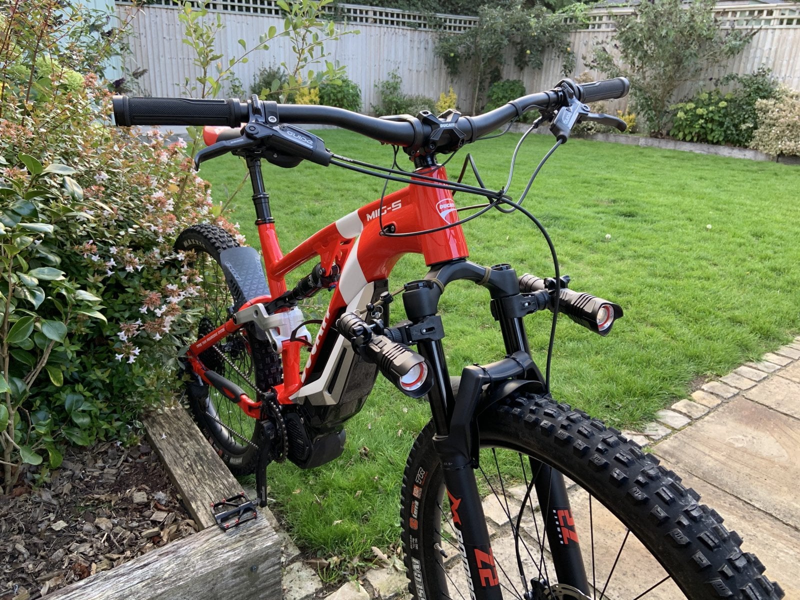

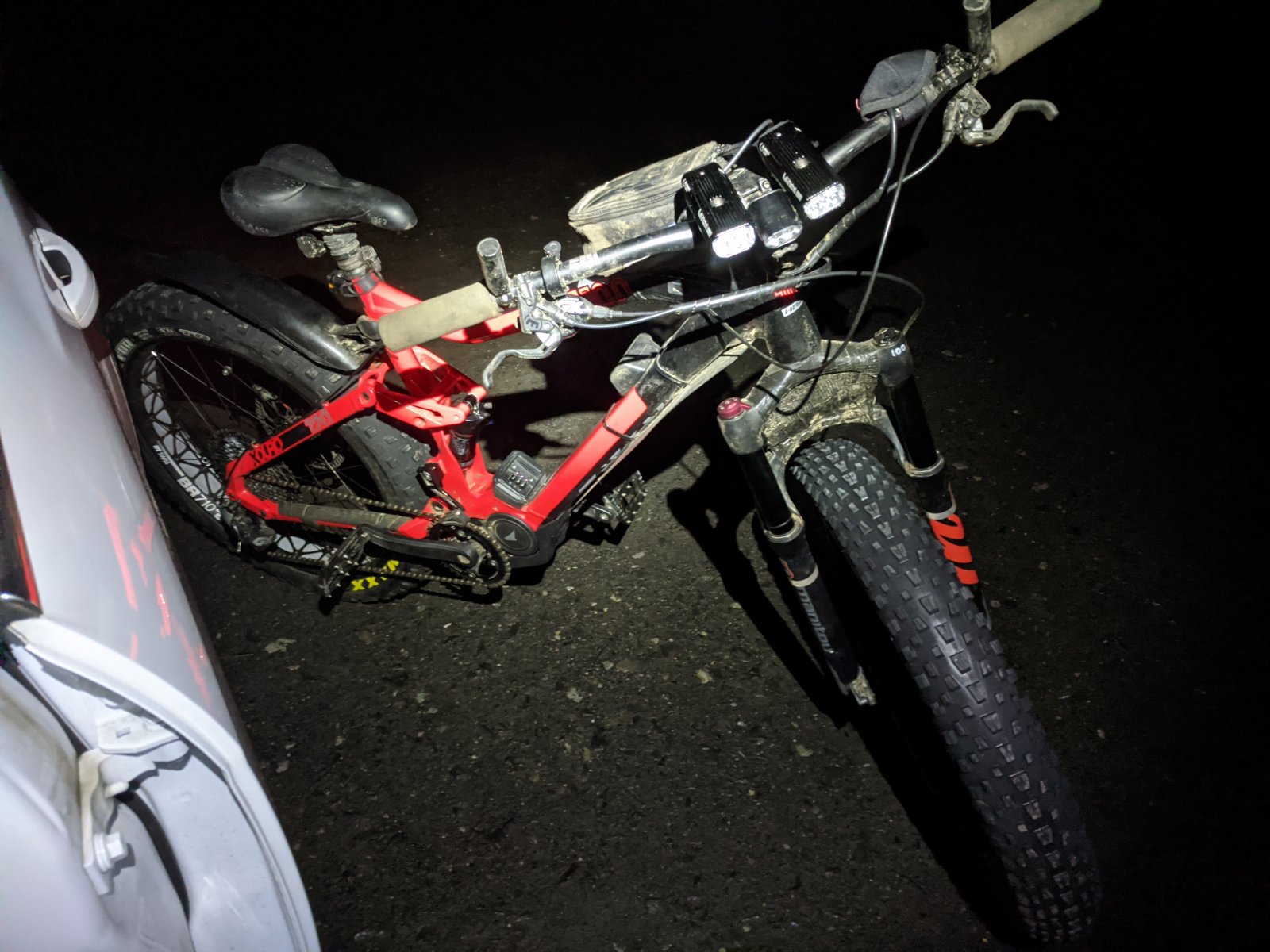

At least now it's fairly easy with ebikes to mount at least a 500lm front light to give you a basic level of illumination.
This was my setup last year - a 500lm wired into the bike (limited by the system lighting output), and 2 Lezyne 1800i with battery packs in the top tube bag. I also have a 600lm helmet mounted light.
