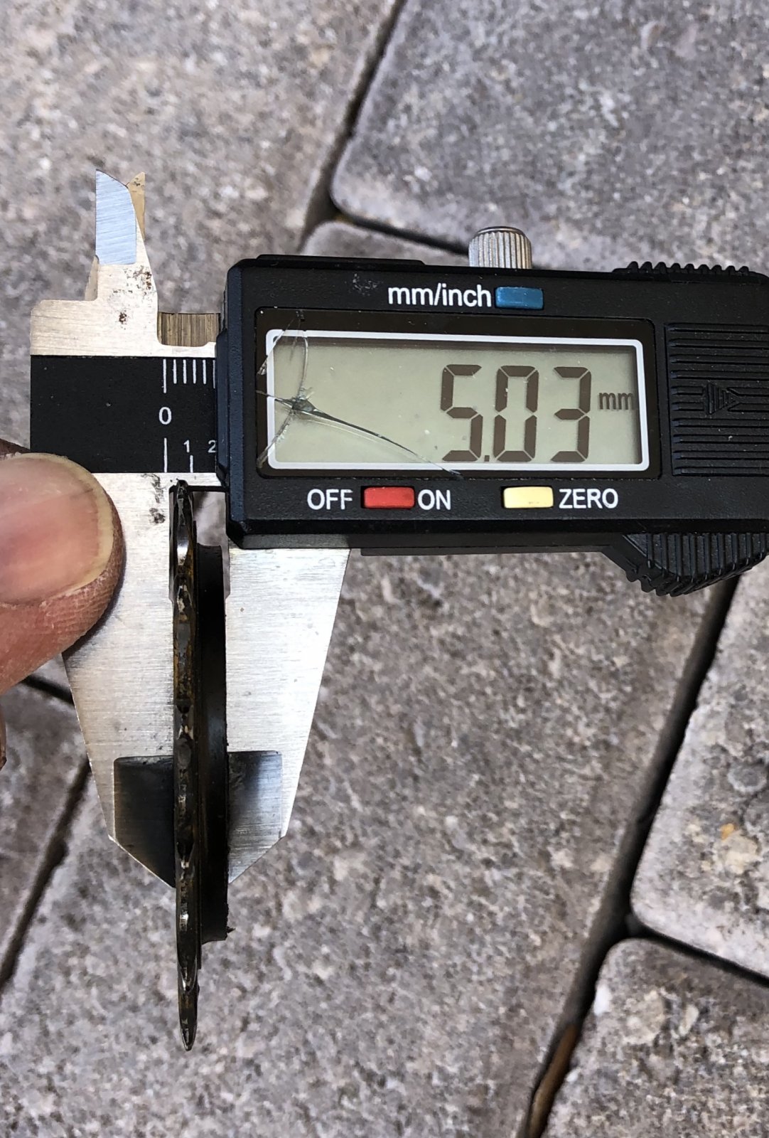

I can’t find a replacement 15 t sprocket for my Trek! Mine is having an offset of 3mm.
Where can I find it. I’m attaching a picture. Based in the US.

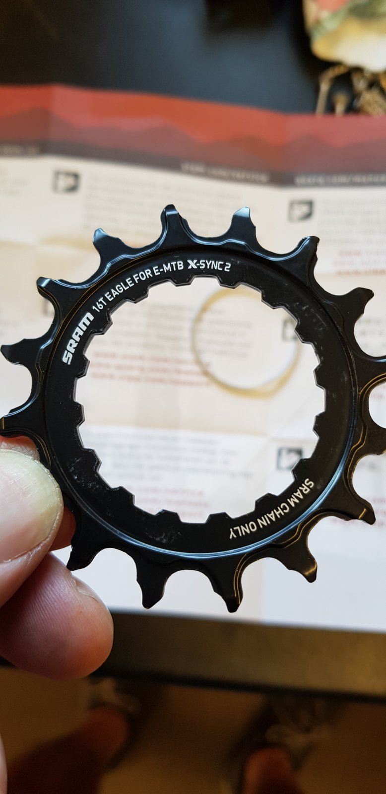

Sram do this one above that comes in 14T , 16T and 18T that is made for 12spd sram drivetrain, it has the small step you need on the Trek,I have one on my LT9.

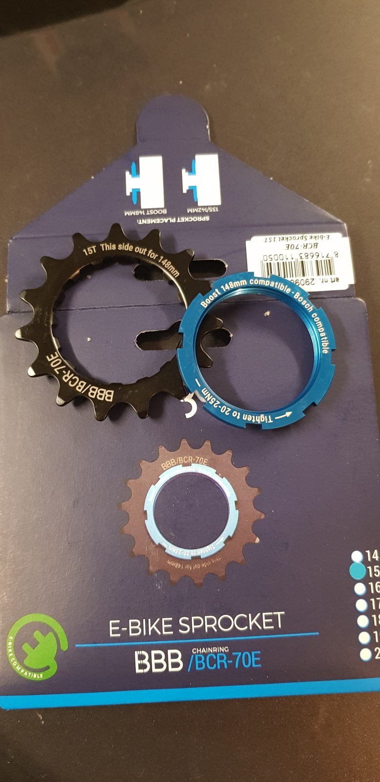

This is a aftermarket brand below, this one is a 15T which is my spare.
This also has the step.

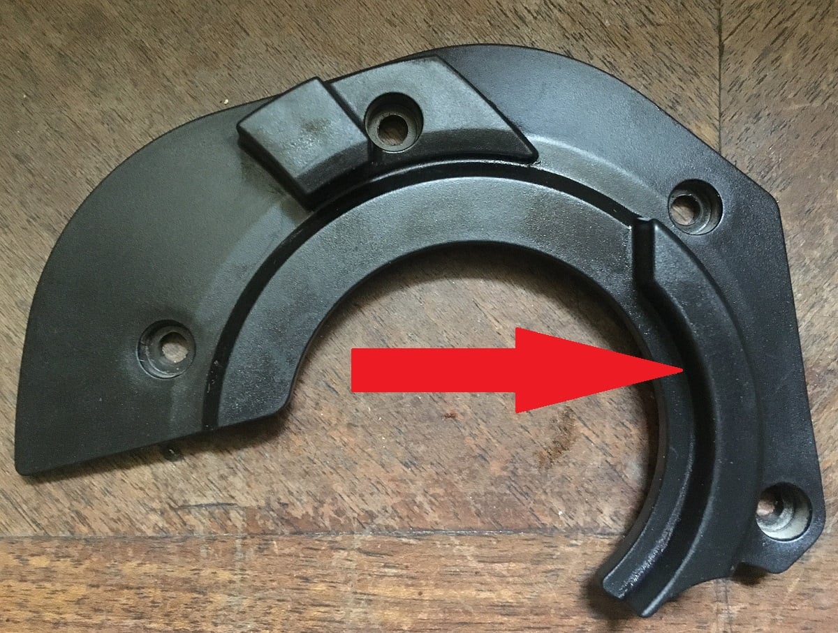

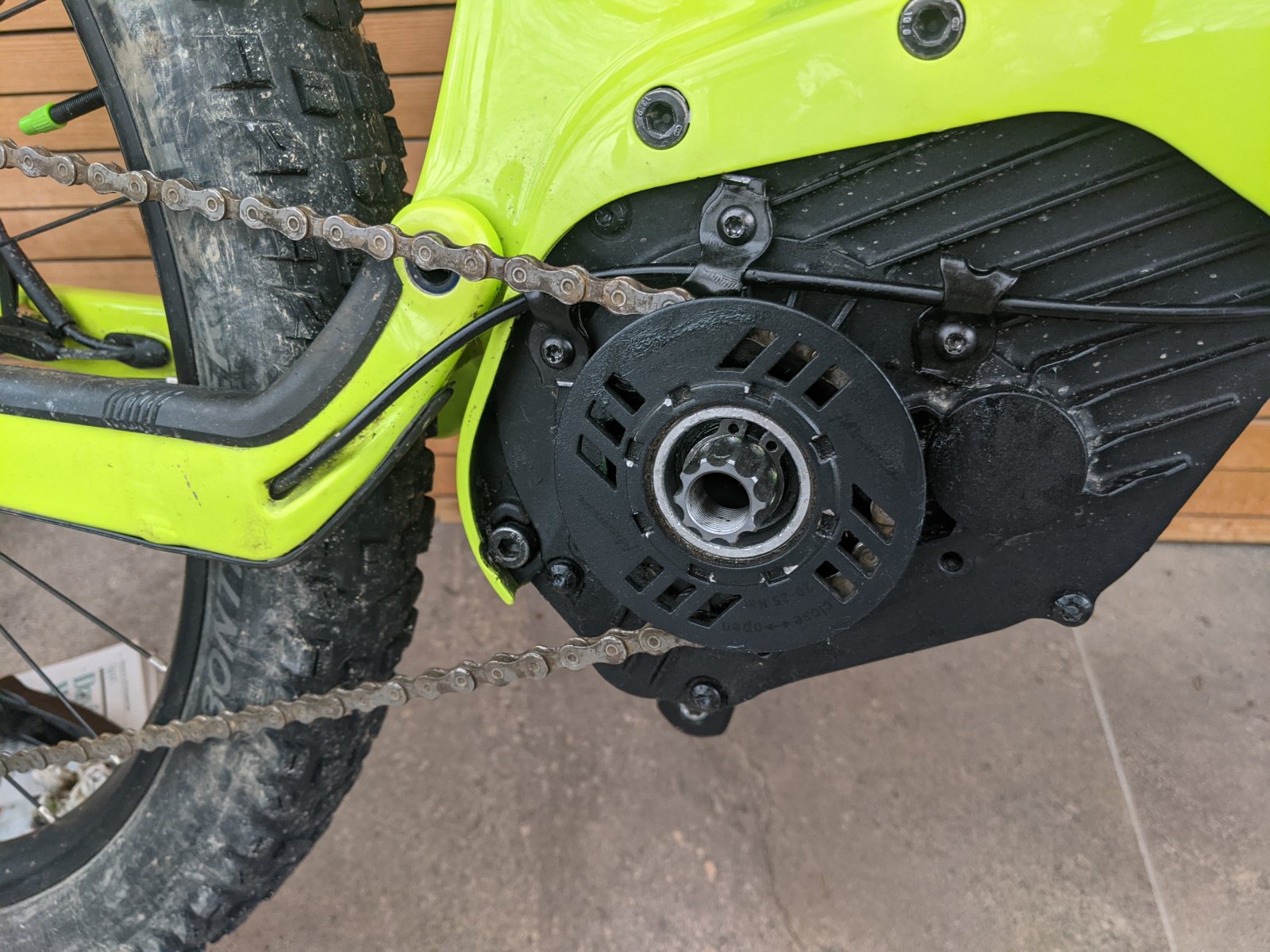

For any future thread chasers - I took the 'chain protector' off completely, secured the cable to the engine casing with clips using the protector screw holes in the casing and swapped the 15t sprocket for an 18t Miranda sprocket w/3mm offset.
Also added a mudstop and bearing seal from performance linebearings. .
Runs like a dream and plenty of room to get crud out.
