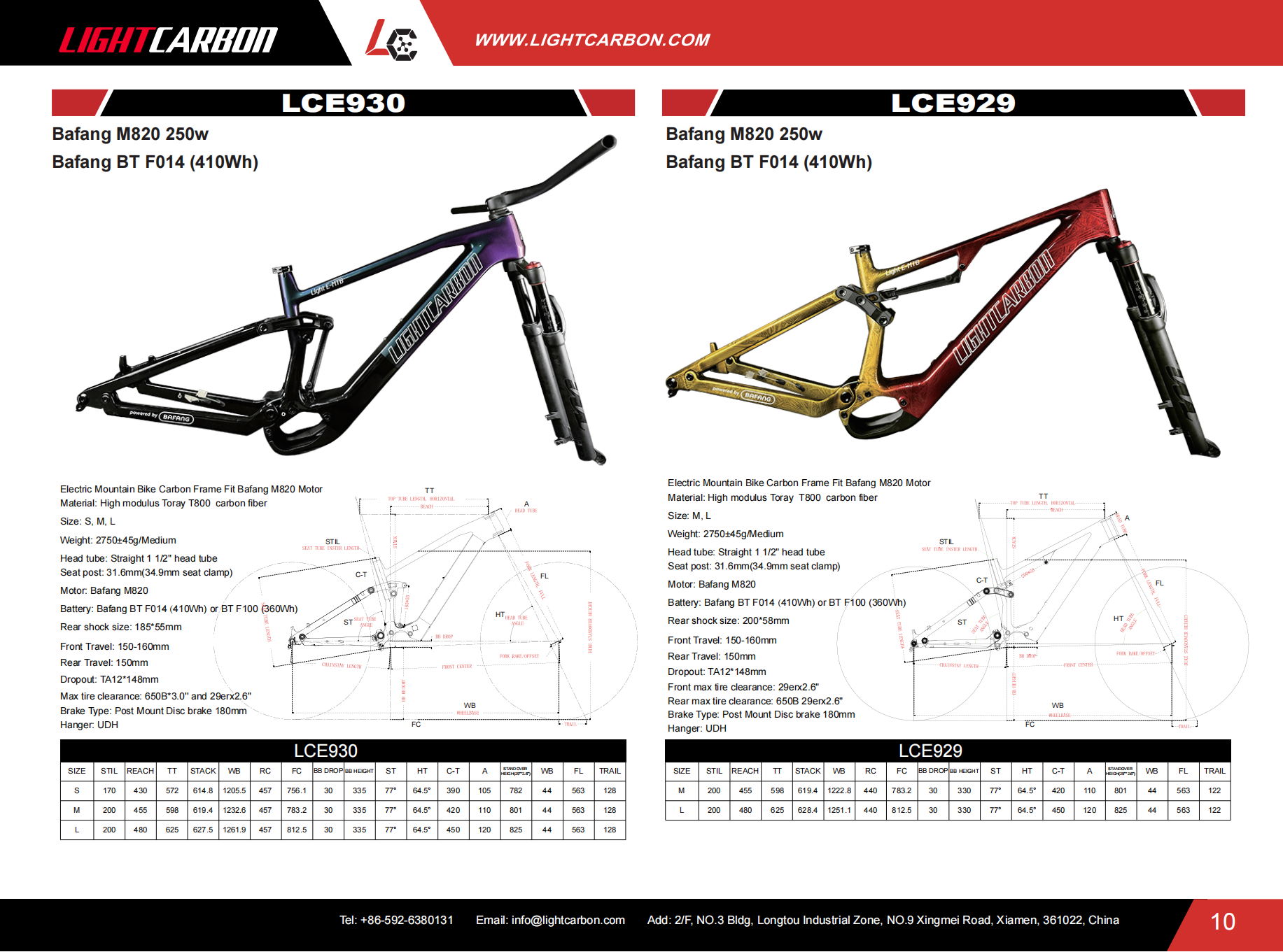

And I'm interested in the LCE929.
Did you find out why there's a difference in the overlaid graphs of axle position? It seems you were referring to a discrepancy in the attached geo charts regarding RC.
Most build advice is in the LC930 thread but I like the the longer shock and thinner top tube of the LCE929 and I reckon it holds a bigger water bottle.

Hi
The LCE929 has shorter chainstays, that is the only significant difference in geo. The LCE930 can fit a full size waterbottle.
The toptube on the LCE929 does look nice but the shock is actually more or less same size. The 185mm shock is a trunnion size that is why the total length is shorter. The 200x58(57 more probably) is an old shock size standard, so availability will be bad and with time get even worse.
Regarding motor voltage, the higher voltage you have then less amps you need. But on ebikes the amps are so low anyway there is probably no practical difference from the riders perspective. Third-party extenders are generally 36V or 48V, so can be hard to find 43V unless Bafang make something or you go DIY.
Because LCE 929 is developed by us in cooperation with other brands, not only us, we do not keep inventory and need to make it to order, so the waiting time is longer.

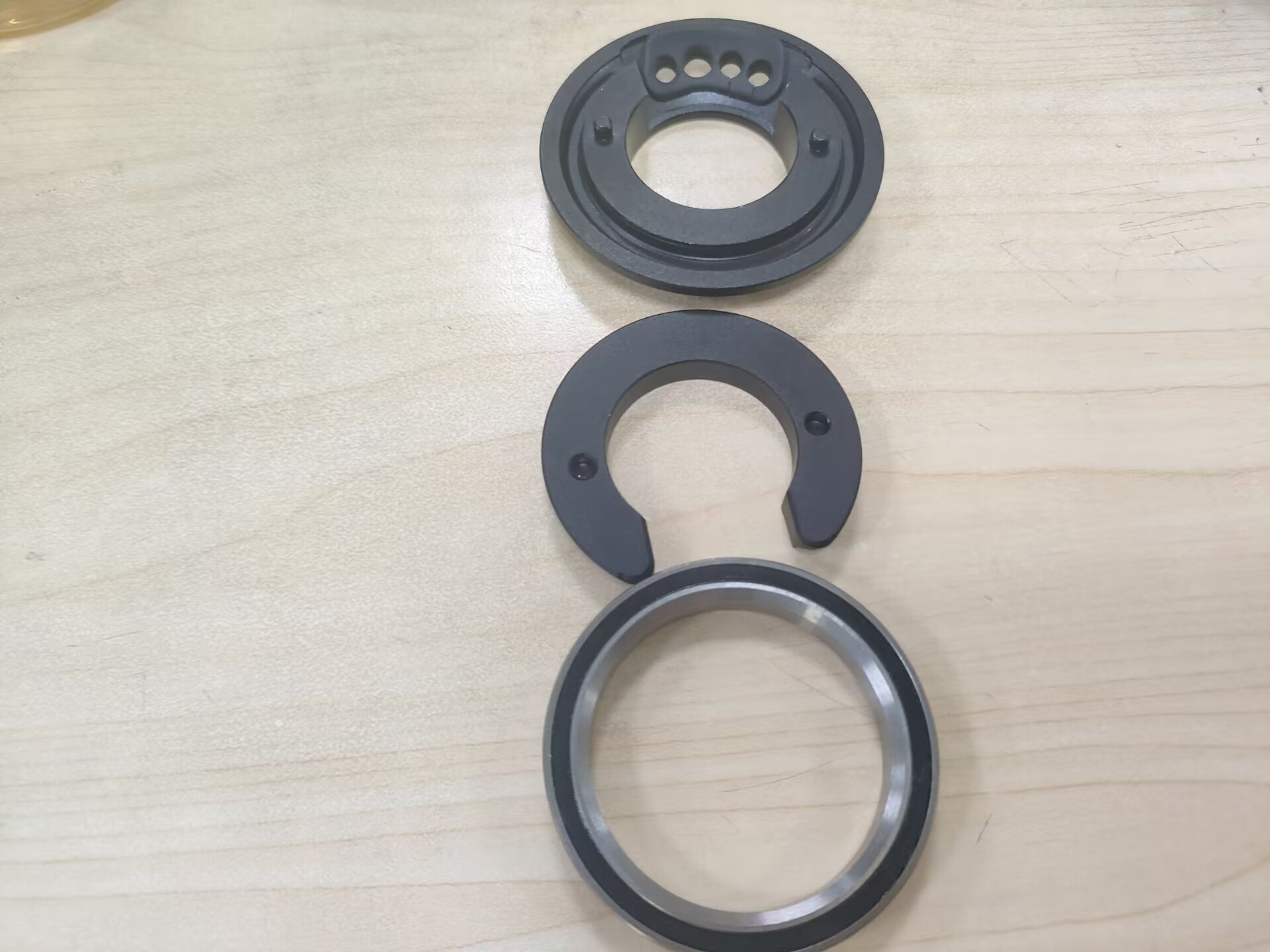

and we will have a new cover of head set, now is on testing!

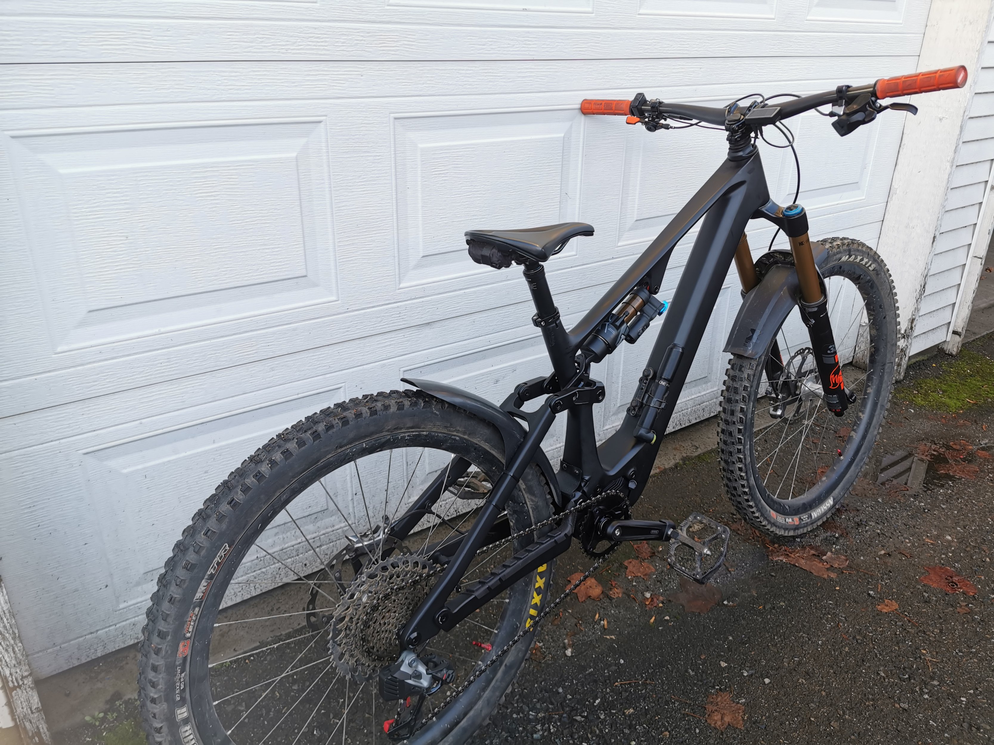

Hi, I built up a bike with this frame but there is a serious issue with the frame design. As mentioned by other, the shock specs an outdated size but the real issue is the clearance. A shock with a larger air can or a coil shock will interfere with the top tube of the frame half way into its stroke. I learned this the hard way!
nice bike!!! with that type of kinematics I expected some interference problems with spring shock absorbers... but if the X2 fits, I think 90% of the air ones fit... I think it's one of the largest with air. .. apart from that, tell a little more about your bike if you feel like it!!! I see a 27.5 wheel on the rear... would a 29 fit?
How much travel does the 38 have? bafang battery or do it yourself?
weight?
How are you feeling with the suspension?
in short...you've built a beautiful enduro bike!!!!how do you feel about it?
weight?
Thanks for your reply! Unfortunately this bike has been disassembled because the x2 does not fit this frame nor does any coil shocks. Only shocks such as older Fox DPS and Monarchs with slim air cans. I was so excited about trying the bike that I didn't check everything over before hitting the trails. Needless to say, the frame took some damage and so did the X2 air can. I checked to confirm what shocks would interfere and I have a bunch of shocks on hand luckily. I decided I didn't want to ride it with a low end shock so I am planning to do some carbon modifications to the frame to allow for a large air can and coil shocks. I'll probably give it a paint job as well while I'm at it.
Regarding the battery - it uses the Bafang battery but there is another issue here, LOL!! The battery goes into a "deep sleep" mode after 45min of inactivity. This means there's no way of turning it back on unless you wake it up by plugging the charger in. You could imagine what this would mean if you drive out to the mountains and it takes you over an hr, then you go to turn the bike on and nothing happens. I don't think most people will carry their charger with them and have a power source to plug into to wake the battery up.
Anyways, I suspect the battery management system has a design problem or maybe I just got a lemon. Bafang says their trying to figure it out, whatever that means. I hope others can comment about their experience with the stock Bafang 410whr battery (BT F014.410.C)
I am currently waiting for a warranty replacement but who know when I'll see it. Until then I'll build my own battery and get this bike going again.
If you're considering this bike, I'd say check out the alternative options like the LCE930 or the CEF50 - way less hassle and seems to be proven platforms with so many great build by people on these forums.
temon10 - I'm very curious to see how you get on with your build. I hope you don't have as many issues as I have.
