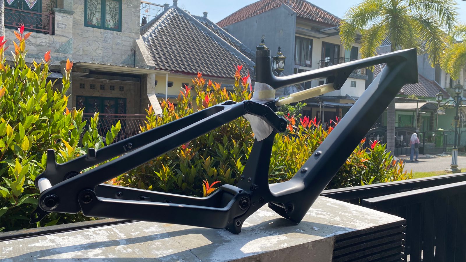

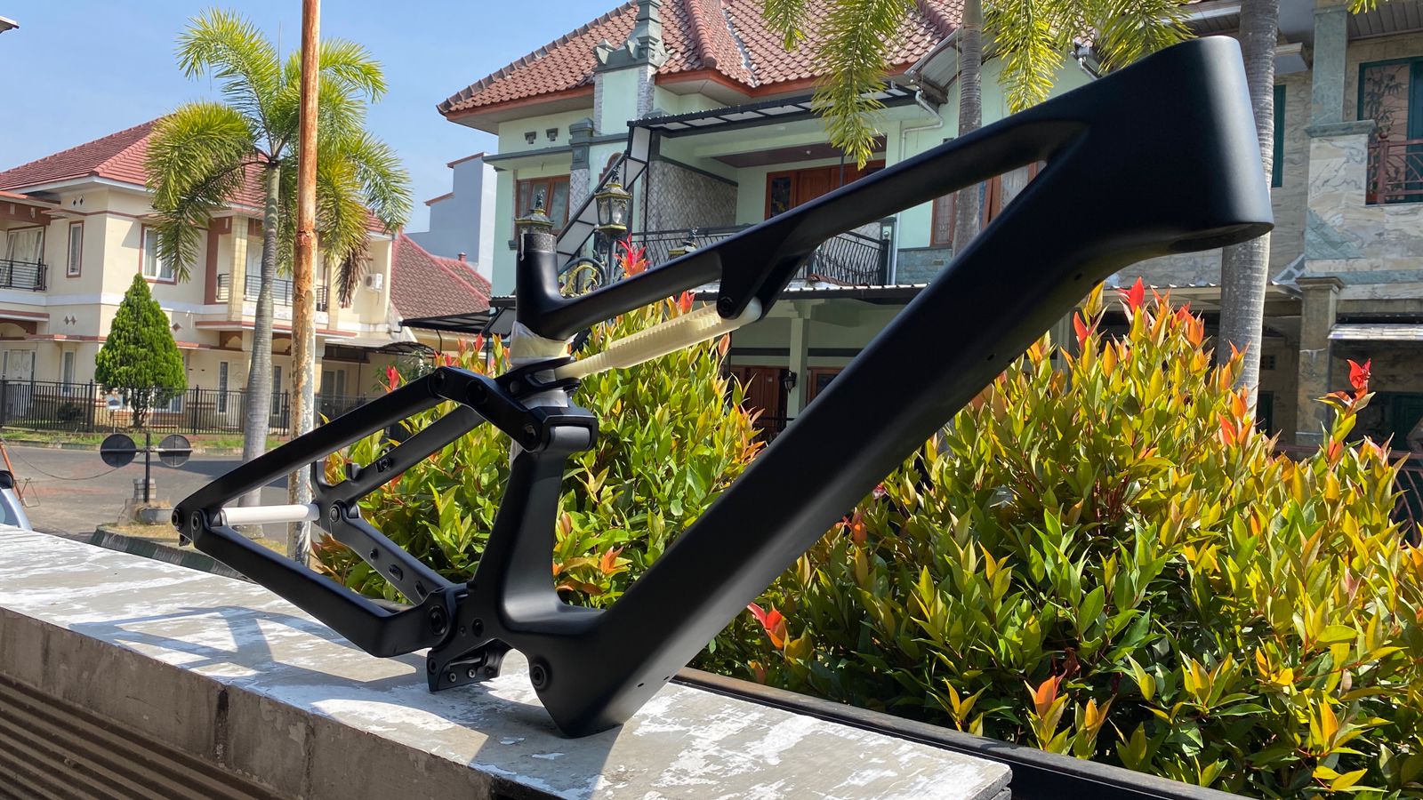

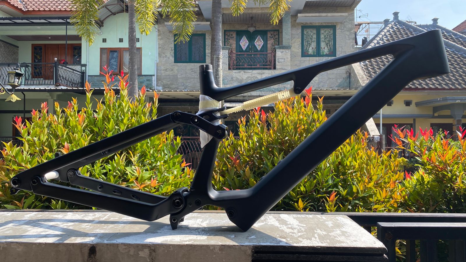

New M820 frame from Seraph/TanTan, the E67.

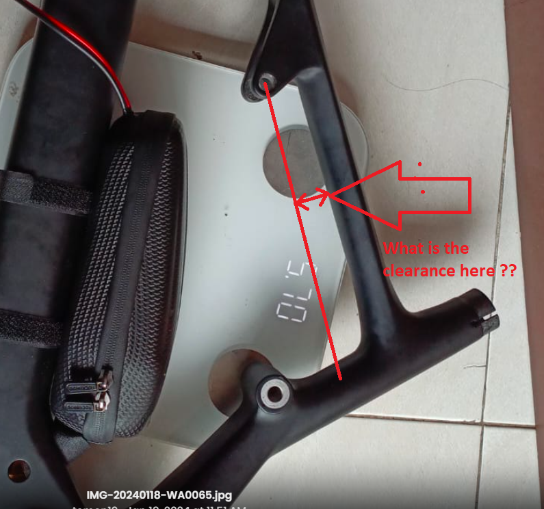

Is everything okay with the new frame? There have been no new messages for a long time. Will the company fix the error in the frame?

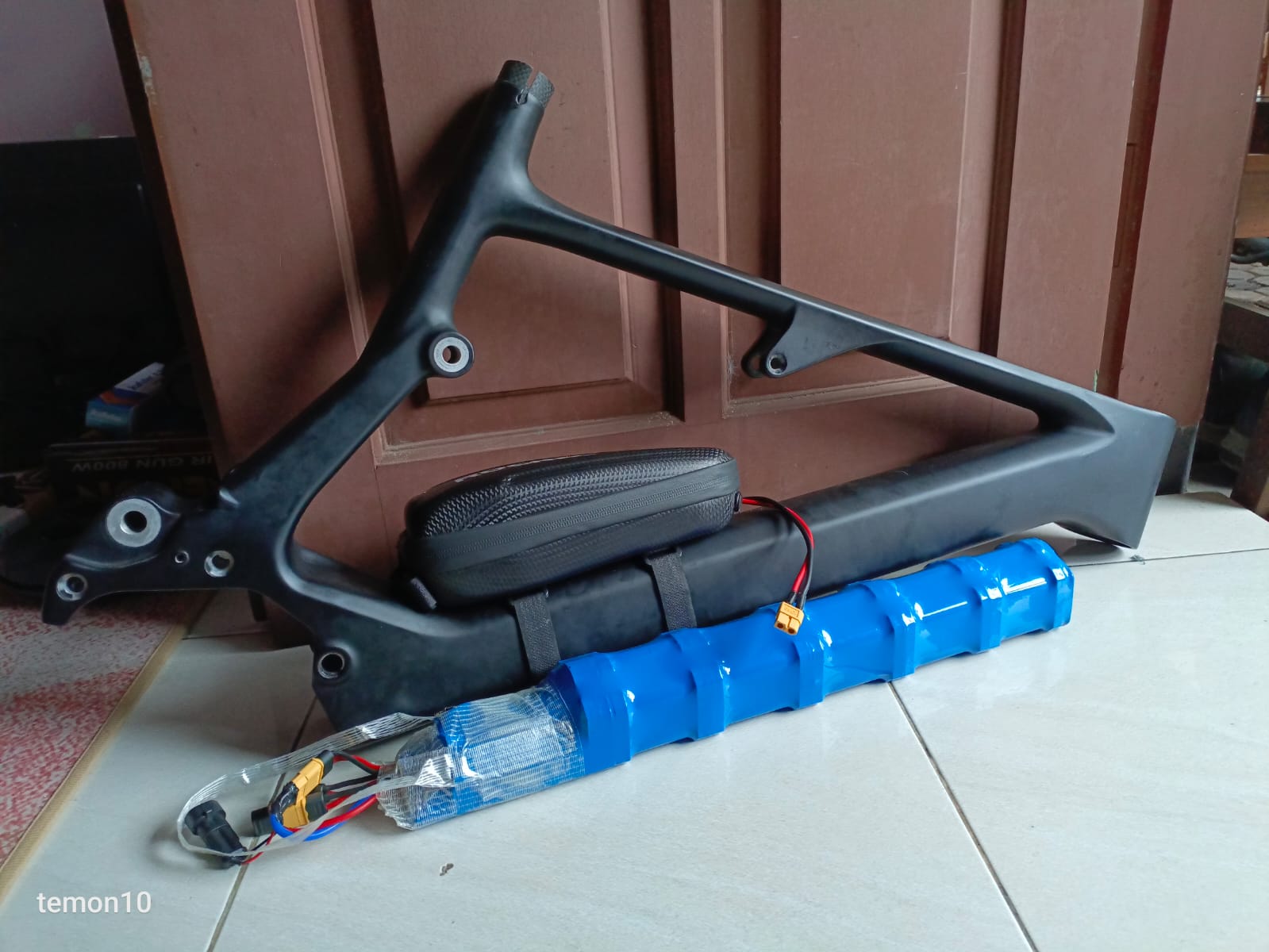

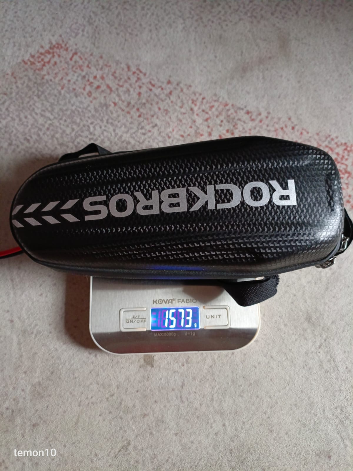

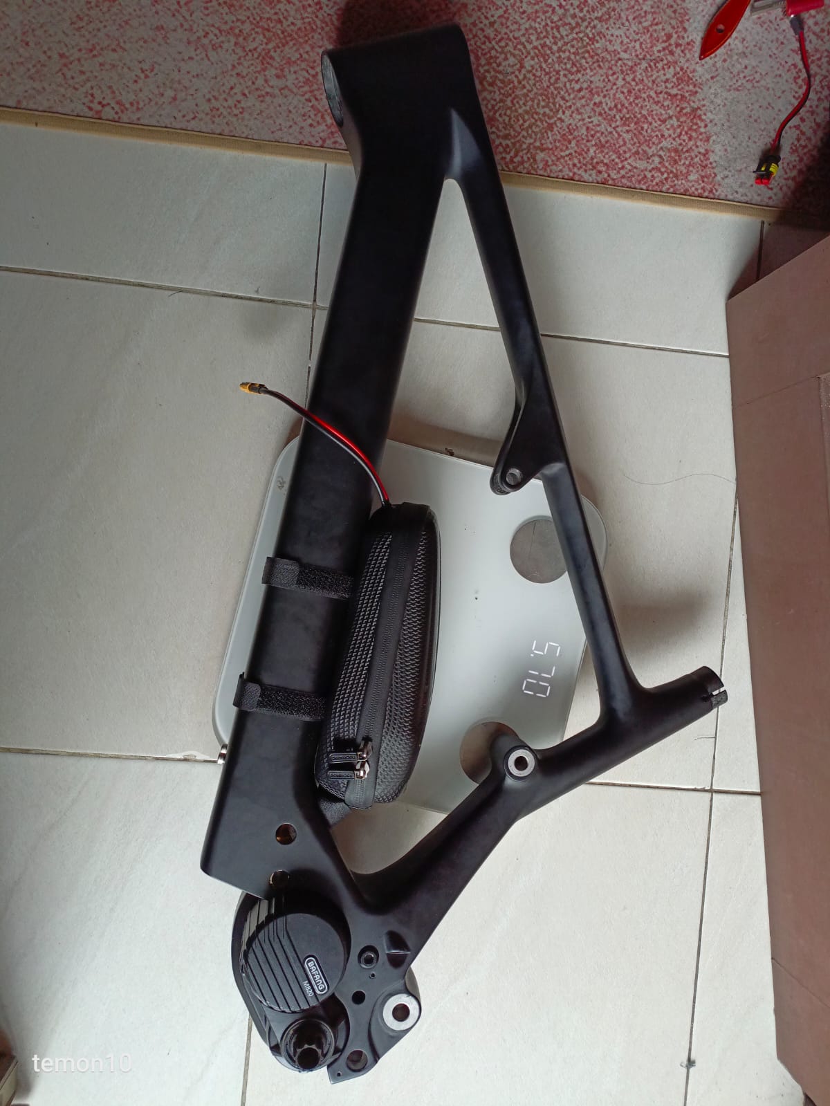

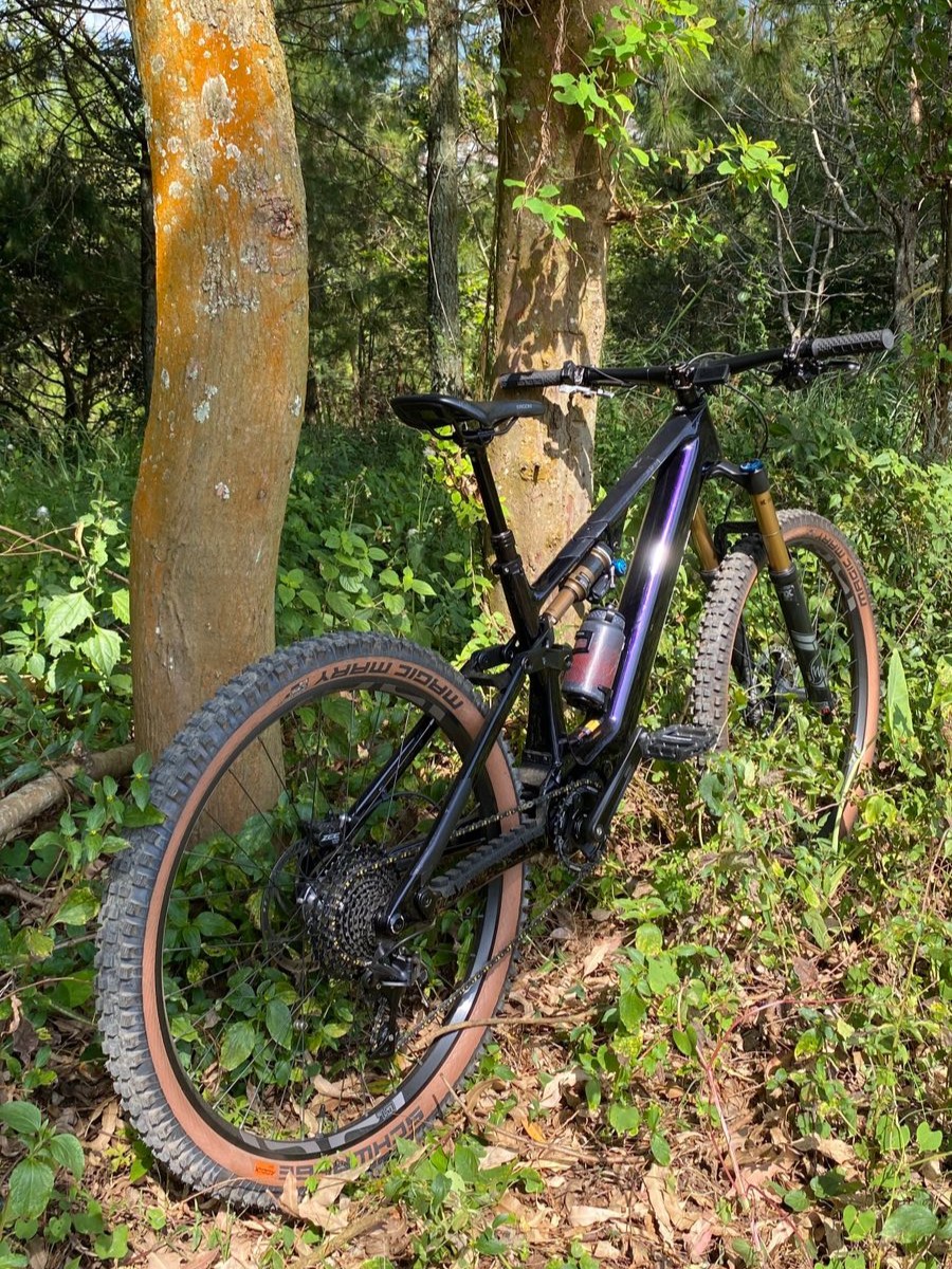

Finally I can finish my E67 build. Final weight with 540Wh DIY battery is 20kg. Little higher than expectation but with tight budget it's OK. Maybe I have to change that heavy Magic Mary tire to Maxxis Dissector to get less 600gr weight.
Today I test ride about 26km and 580m elevation gain, battery left 88%. Later will test the range with my 360Wh and 180Wh battery extender.
SO far the bike looks so good, slim and easy to handle downhill or uphill.

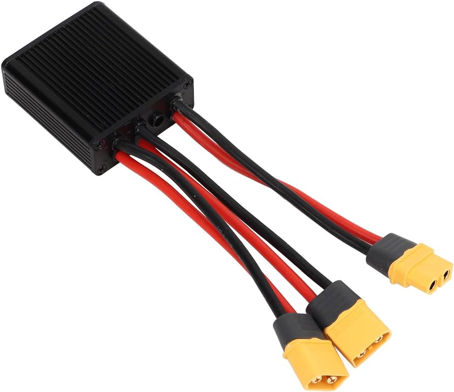

How do you connect the extenders? How do you balance the main battery to the extender?
