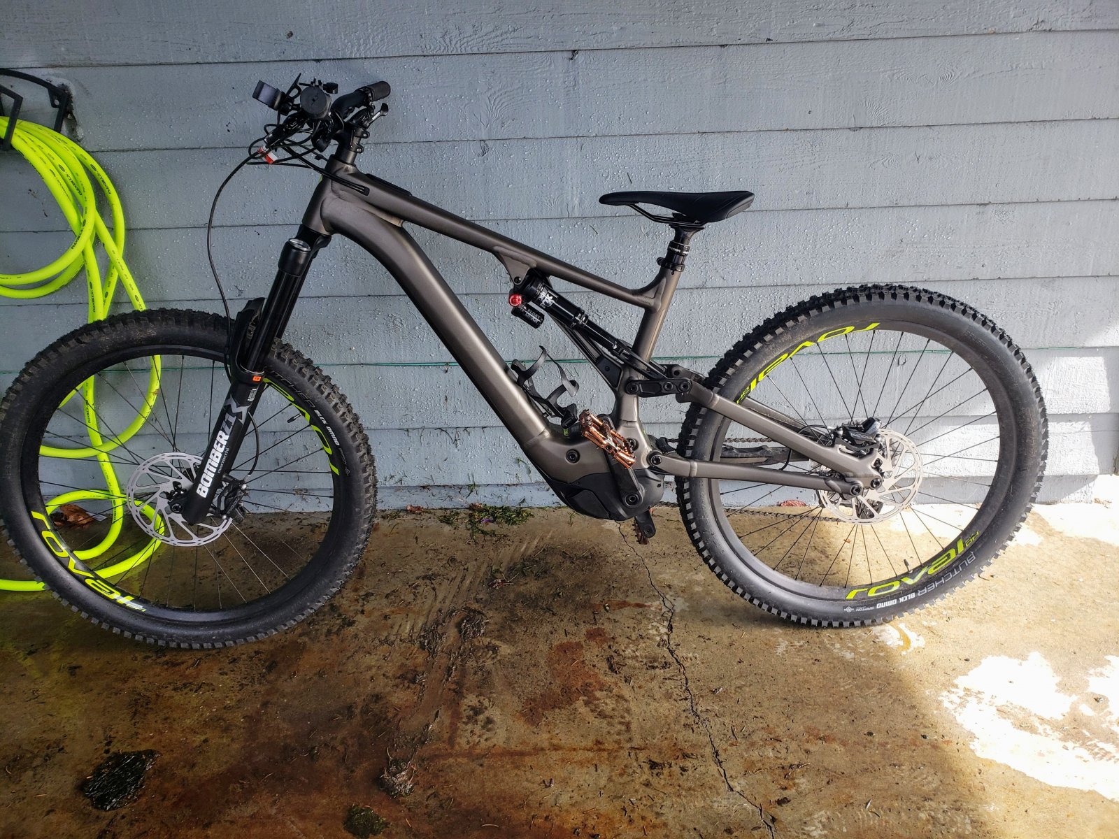

Hey all looking for some advice given the issue I'm facing.
I just bought a 2021 Kenevo and I'm starting to realize it may have been to big of a bike for me. I had been testing bikes all morning which were too probably too small for me (thanks bike shortage) when I came across a S4 Kenevo Comp. Right away the Kenevo felt really good but on second thought it may have just been the turbo/motor making it feel nice and nimble. Now on 1/hr rides I'm feeling REALLY stretched while on the saddle in a uphill position and end up with upper back pain.
I'm 5'11 230~lbs which makes me think I should be able to make a S4 feel good but when I'm on the bike I just don't see how.
Things I've done / planning to do.
  • Moved the last spacer under them pushing it up.
  • Pushed the seat all the way forward(This was after I had upper back pain so its hard to tell if it was enough until I have some rest).
  • Bought a 30mm stem reducing 15mm from the stock 45mm stem(not installed yet, on the way).
  • Considering buying a backsweep 40mm rise handlebar around 760mm compared to the stock 800mm 27mm rise.
With that said I wanted to get some advice on the situation and any thoughts on reducing the reach with new handlebars or how I should go about this. I don't think/know if there's anything specialized can do for me since its ben ridden down trails already and selling it would make me lose a ton of money off the bat so I'm kind of stumped.

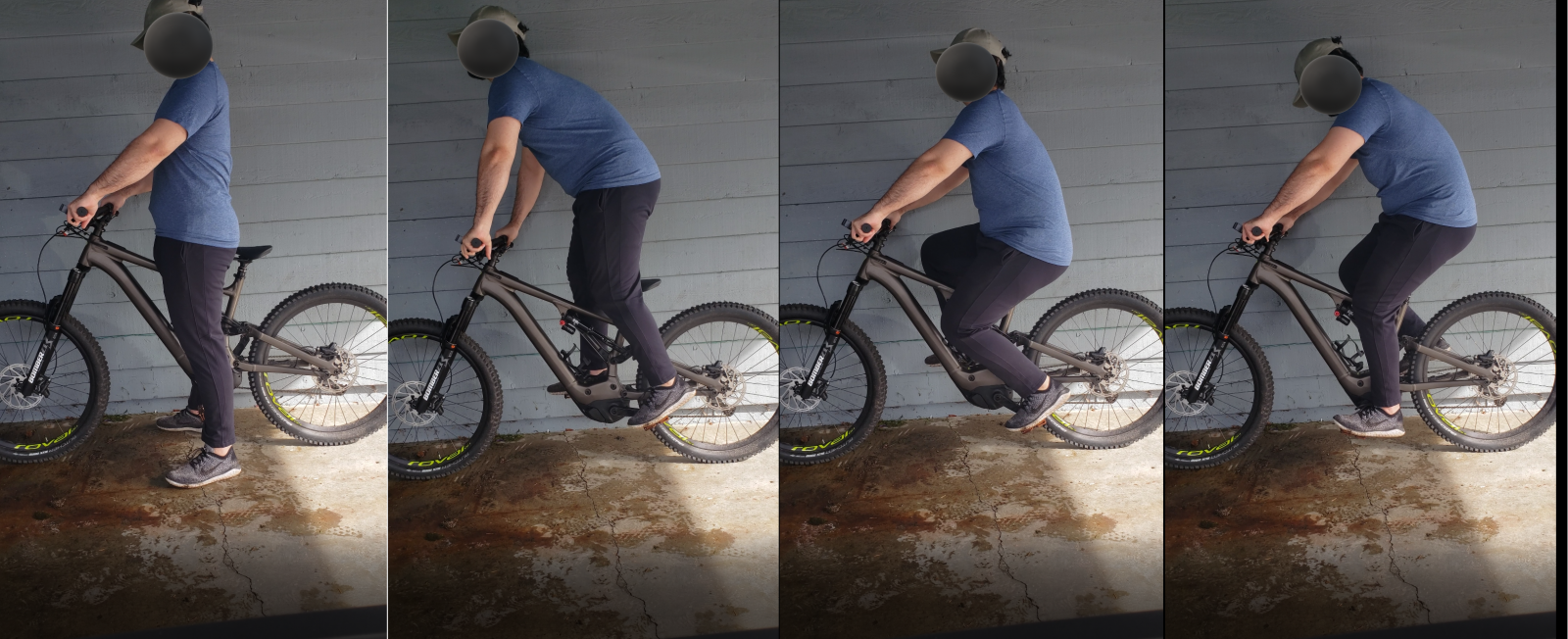

So after recording myself in various positions the bike doesn't seem as big as it feels. Going downhill the bike feels great and I can fully use the long wheelbase even touch the rear wheel if I lean back too far. The only issue I have is arms locking out / reach feeling way too long in the uphill seated position. I think I should fully be able to make this bike work but I'm not sure what the ideal fix would be here to make it more comfortable.
This is what I have on hand + on the way to play around with
  • Truvativ Hussefelt Handlerbar Blast Black, 700, 40mm Rise, 31.8mm (Cheap just for testing)
  • Industry Nine A318, 31.8 x 30mm, 8 Degrees, +- 4.4mm Rise
  • Can pull handlebars off of old bike: Specialized All-Mountain low-rise, 6061 butted alloy, 720mm wide, 8º backsweep, 6º upsweep, 31.8mm
Can you take a picture of the bike from side on ?

In both seated positions your posture is bad... extended periods of time in those positions while pedalling and going over small bumps isn’t going to do you any favours. I realize that those are just pictures and might not be your riding posture but still. Try to push your chest out and pull your shoulders down and together.
It’s a cheaper fix than buying new stuff!

Yeah genuine 5'11" barefoot and spills over closer to 6'.And you're definitely right, after seeing myself on the bike it doesn't look as huge as it feels. I haven't ridden for 10~ years and know I have really tight muscles from overdoing the gym without stretching previously so I'm starting to think that's part of the problem here. My arms still do lockout though and the reach seems to be the problem even though my ape index isn't negative.
Yeah.
In the pic of you stood on the bike you're barely bending at the waist and leaning forwards taking all your weight upper body with your arms. That one pic screams poor flexibility to me and also hints towards you not having a very strong core for your body weight.
looking at the seated pics where you also have your arms locked when the saddle is both raised or dropped backs this up.
also if the last pic is with your saddle at full height it looks to be a little low. Too low a saddle does tend to tip your torso /back rearwards and more upright
In the fifth pic you seem to have your hair straighteners and cord tangled up in your brake cables,
By all means try the shorter stem but I wouldn't raise the bars any higher. They already look quite high.

As I watched the pictures, I agree. No need for a higher bar.
And remember to start stretching. I had a big problem reaching the road bike lower bar position, but this yoga Child's Pose Stretch helped a lot. 30 sec at a time is enough. At the beginning A couple of times a day and when you start to stretch once is enough, easy.

Thanks for all the info. Sounds like in the end this is more of a issue revolving around being massively unfit and aggressive bike geo. The saddle is at its lowest position so I can raise the dropper quite a bit still.If I shouldn't raise the bars and reach still is an issue should I look into taking 20mm off them or getting same raise with backsweep?
No. If you want a modem geometry mtb to work for you simply ride more and increase you're fitness, skills and core strength.
You don't look to be old or physically impaired.

I see on your picture your seat post is fully slammed in the tube. Mine is at least 15cm out of the tube, and I am only an inch taller than you. Maybe raising it up will help with your posture?
