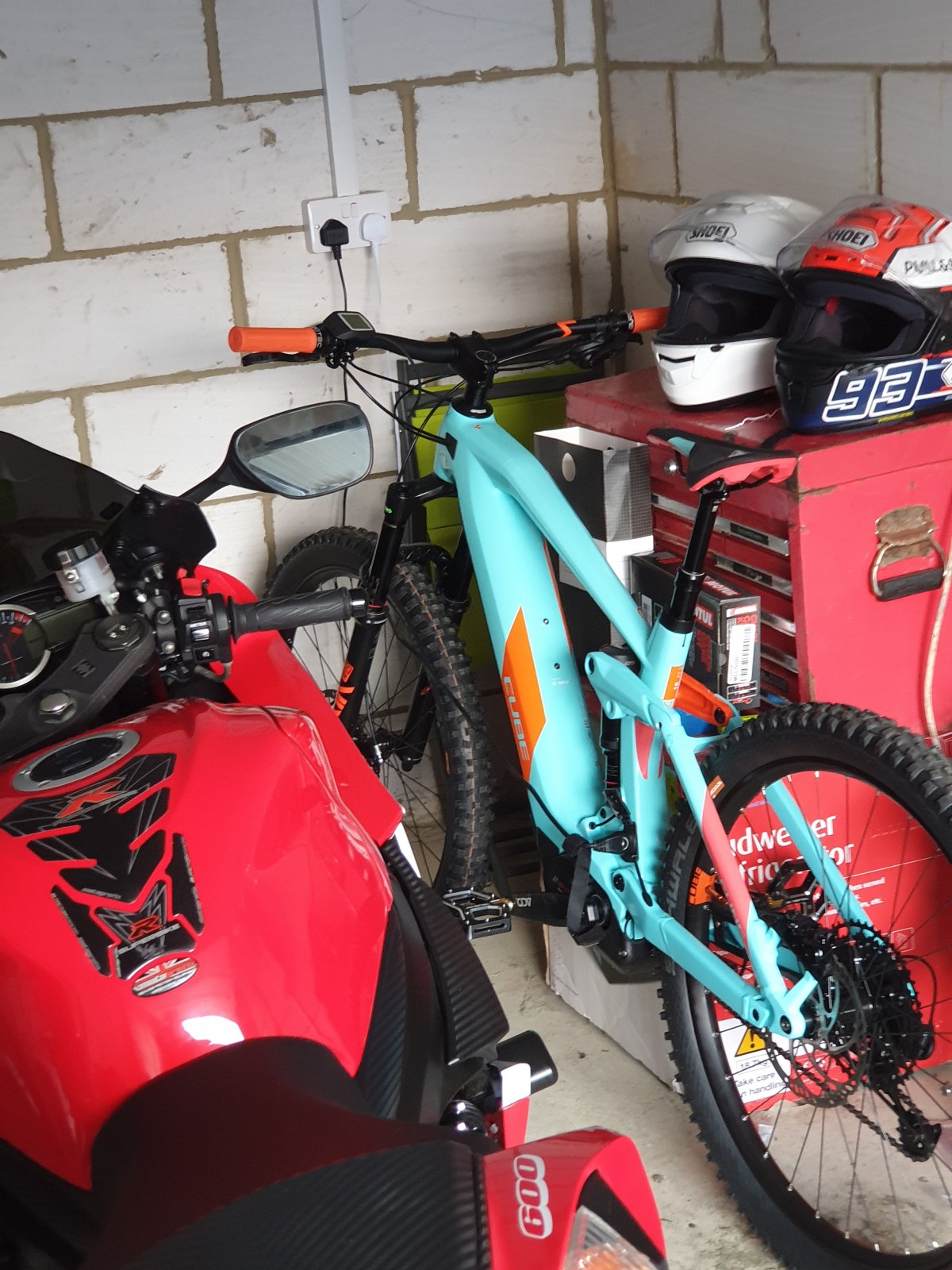

Pick up new sl 160 on friday,charge up for a few hours and I'll ride around d the doors like a 10 year old lol...charge overnight and out Saturday morning,then home and leathers on and back out on my motorbike for the rest of the day...home,beers,maybe get lucky then sleep..definitely not working this weekend no matter what they offer me

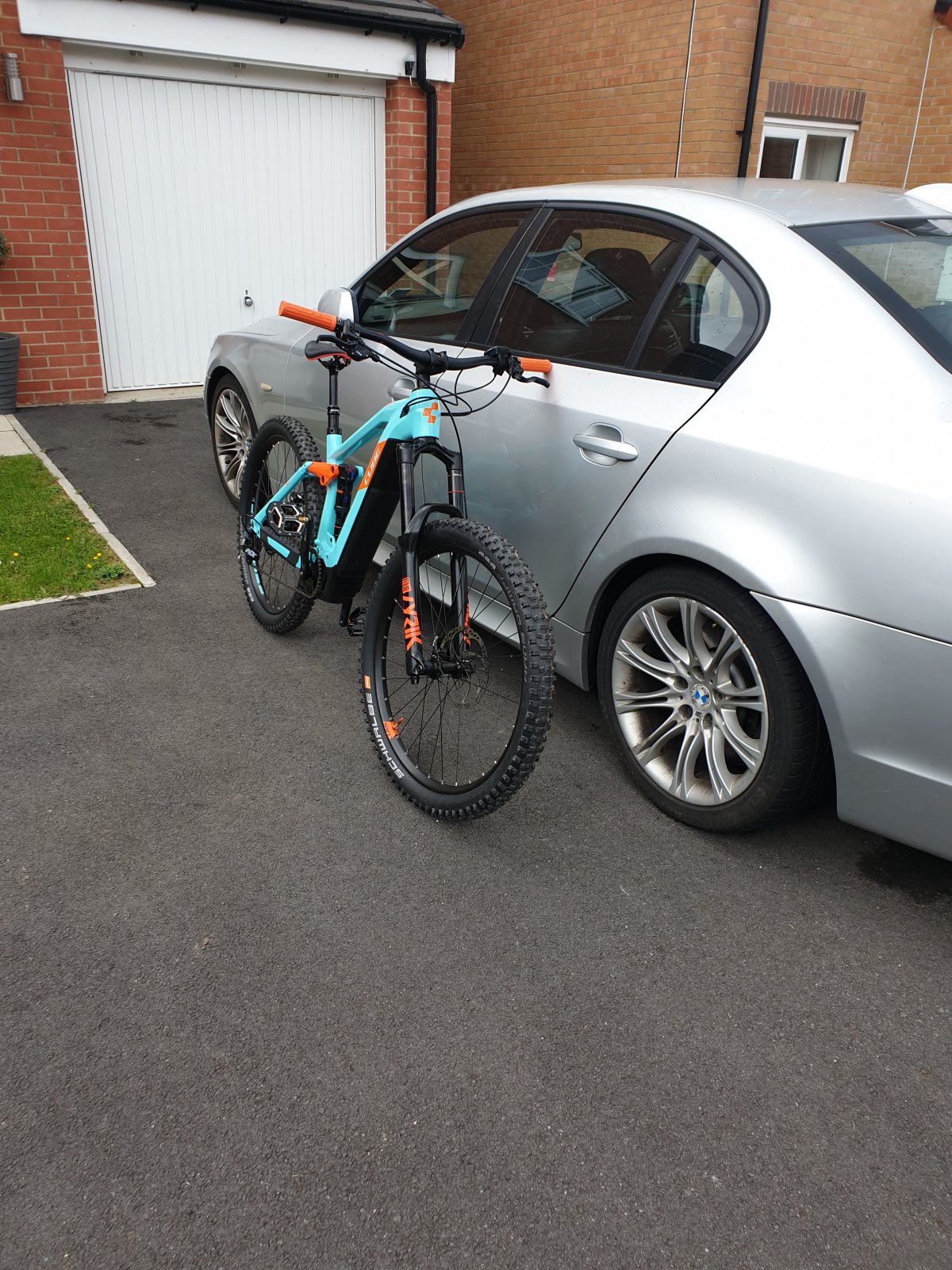

At long last,I finally have it !!! The blue.is actually very greenish,still cool though...85nm update is back of July which will either be free from bosch or cost £40 through Infinity..cant imagine needing more but its day 1,and let's be honest,everything is great on new toy day regardless..pics and bullshit to follow
Far too soon to offer any real opinion,but in the few early miles I need to move the actual seat back on its rails,even an inch for my natural seating position,rear shock needs sorting,Bob's a bit when powering uphill,maybe more air front and back..motor noise is so far 99%unnoticed,bo creeks or rattles at all,over 15/16mph on the flat is absolutely fine,ah I will be putting long pins in shimano saint peddles..strangely I'm spending more time over speed limit of the motor which at times I think have I got something I dont need,but its getting to those speeds that always killed me lol..so far I'm really pleased with my choice and have zero regrets...Ive only got 10 poxy miles on it lol,many many more to go..done 5miles this morning just to get out in honesty but the purion displayed ranges in each modes that also correspond perfectly to miles I'm doing,again, I realise this is in no way an accurate assessment of the bike,I'm.just an enthusiastic new owner who.wants to talk shop..happy days,well apart from the shitty weather
Far too soon to offer any real opinion,but in the few early miles I need to move the actual seat back on there rails,even an inch for my natural seaton position,rear shock needs sorting,Bob's a bit when powering uphill,maybe more air front and back..motor noise is so far 99%unnoticed,bo creaks or rattles at all,over 15/16mph on the flat is absolutely fine,ah I will be putting long pins in shimano saint peddles..strangely I'm spending more time over speed limit of the motor which at times I think have I got something I dont need,but its getting to those speeds that always killed me lol..so far I'm really pleased with my choice and have zero regrets...Ive only got 10 poxy miles on it lol,many many more to go..done 5miles this morning just to get out in honesty but the purion displayed ranges in each modes that also correspond perfectly to miles I'm doing,again, I realise this is in no way an accurate assessment of the bike,I'm.just an enthusiastic new owner who.wants to talk shop..happy days,well apart from the shitty weather
