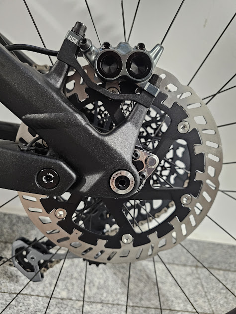

I was able to make the stock code brakes work by going with Magura 220mm rotors front and back. I also changed to MTX gold pads which work great, even wet. The only downside to the huge two piece rotors is they get bent really easy. I finally got tired of dealing with it and went with the new thicker SRAM rotors. They seem to be close to the Magura and the biggest difference is how they handle heat. My main trail has a 3k’ continuous descent and the SRAM rotors have a bit more fade than the Maguras.

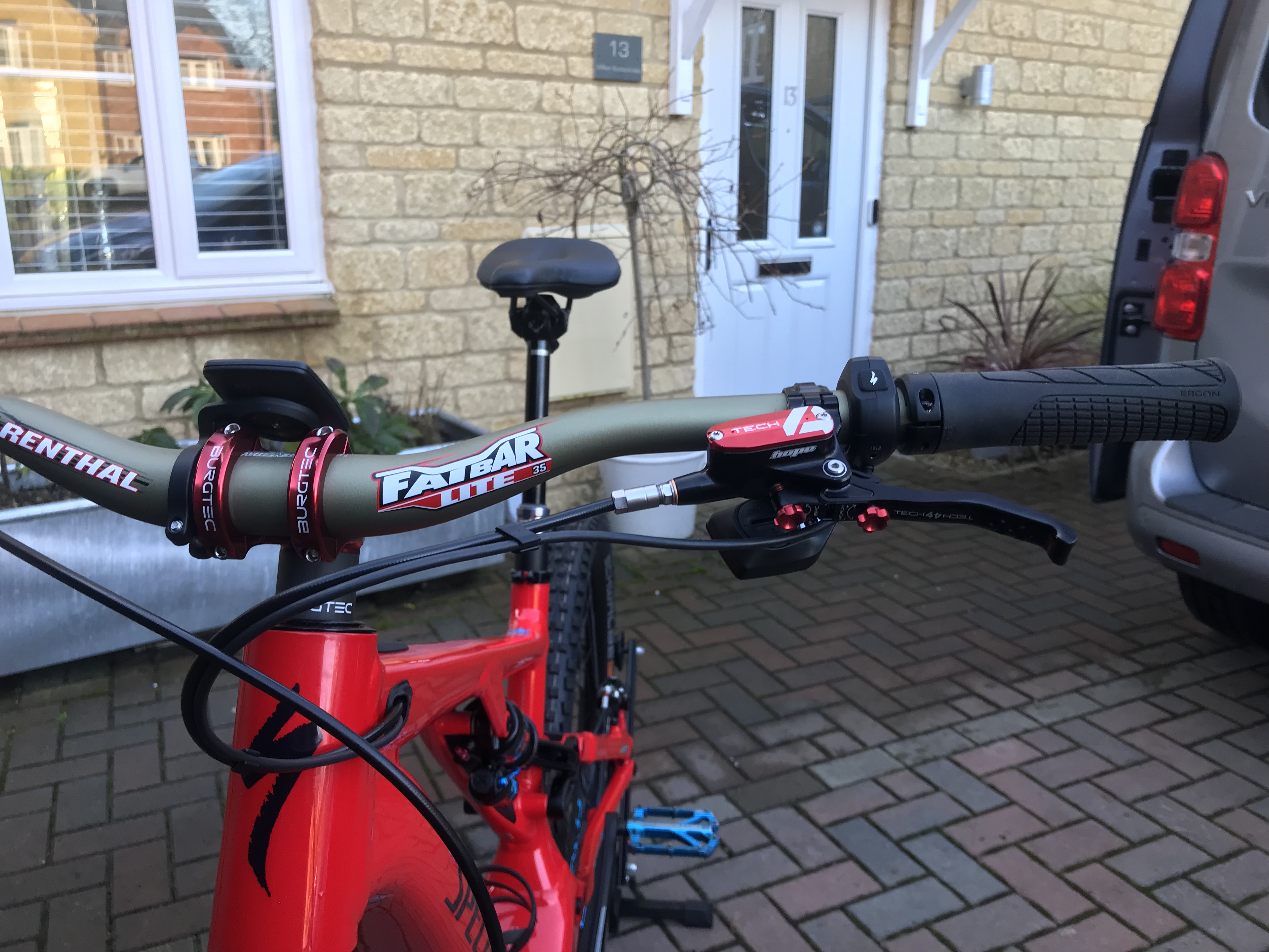

I just upgraded the brake setup on my 2022 Turbo Levo Expert. Went with Code RSC Levers, HS2 rotors front and back and new stock Code Sintered pads. Very happy with the results. Good feel and engagement and great stopping power. Also much better heat dissipation on HS2 rotors on long descents. Like the added leverage and adjustability of the RSC levers.

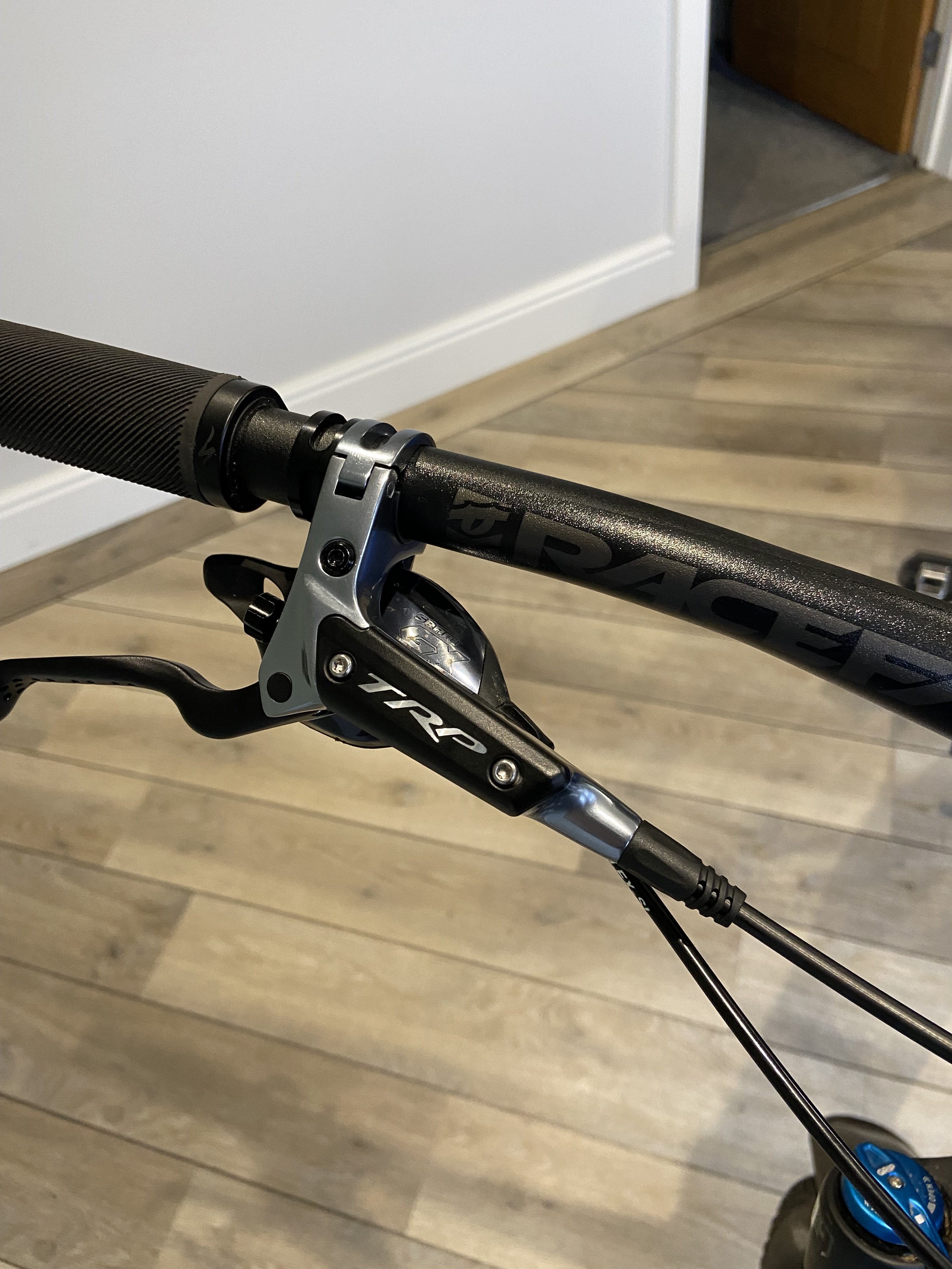

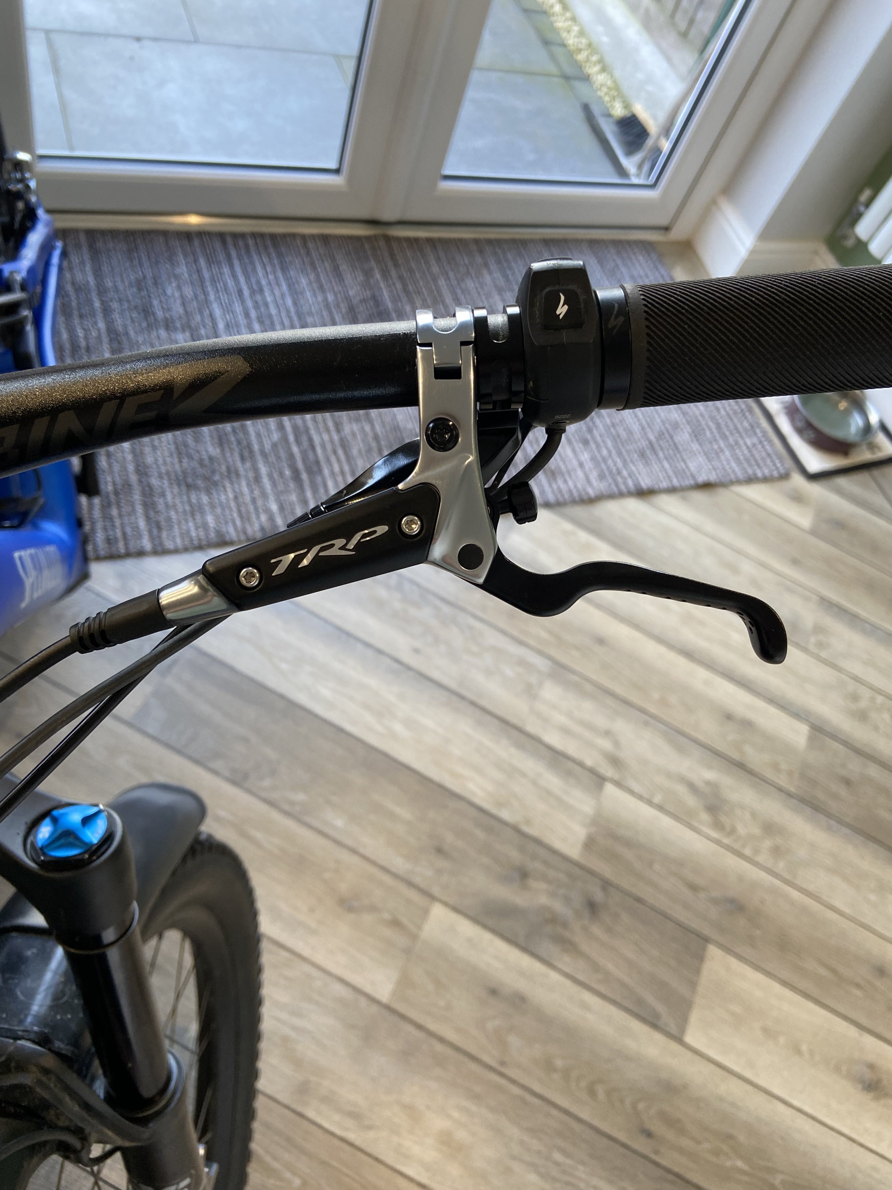

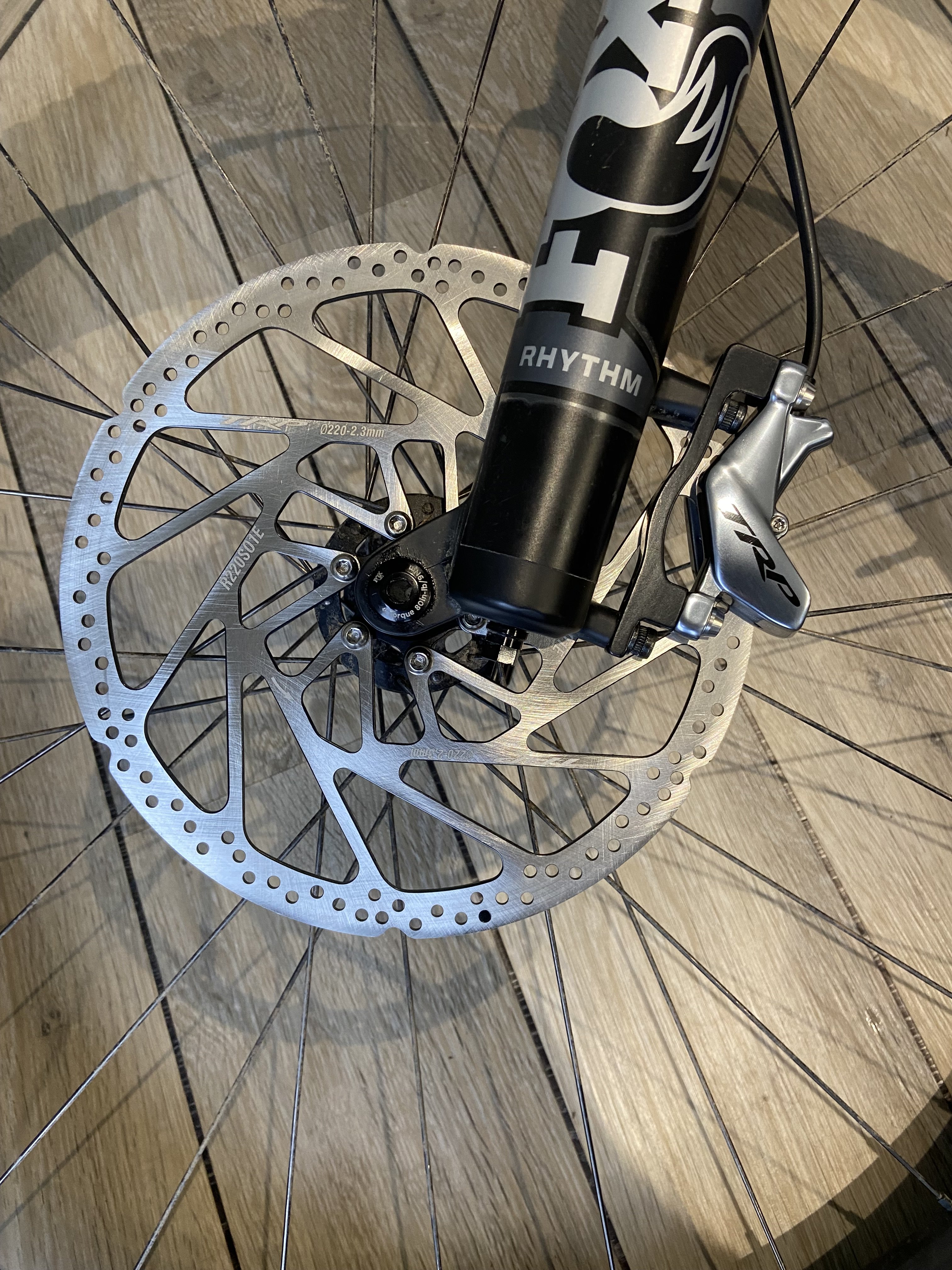

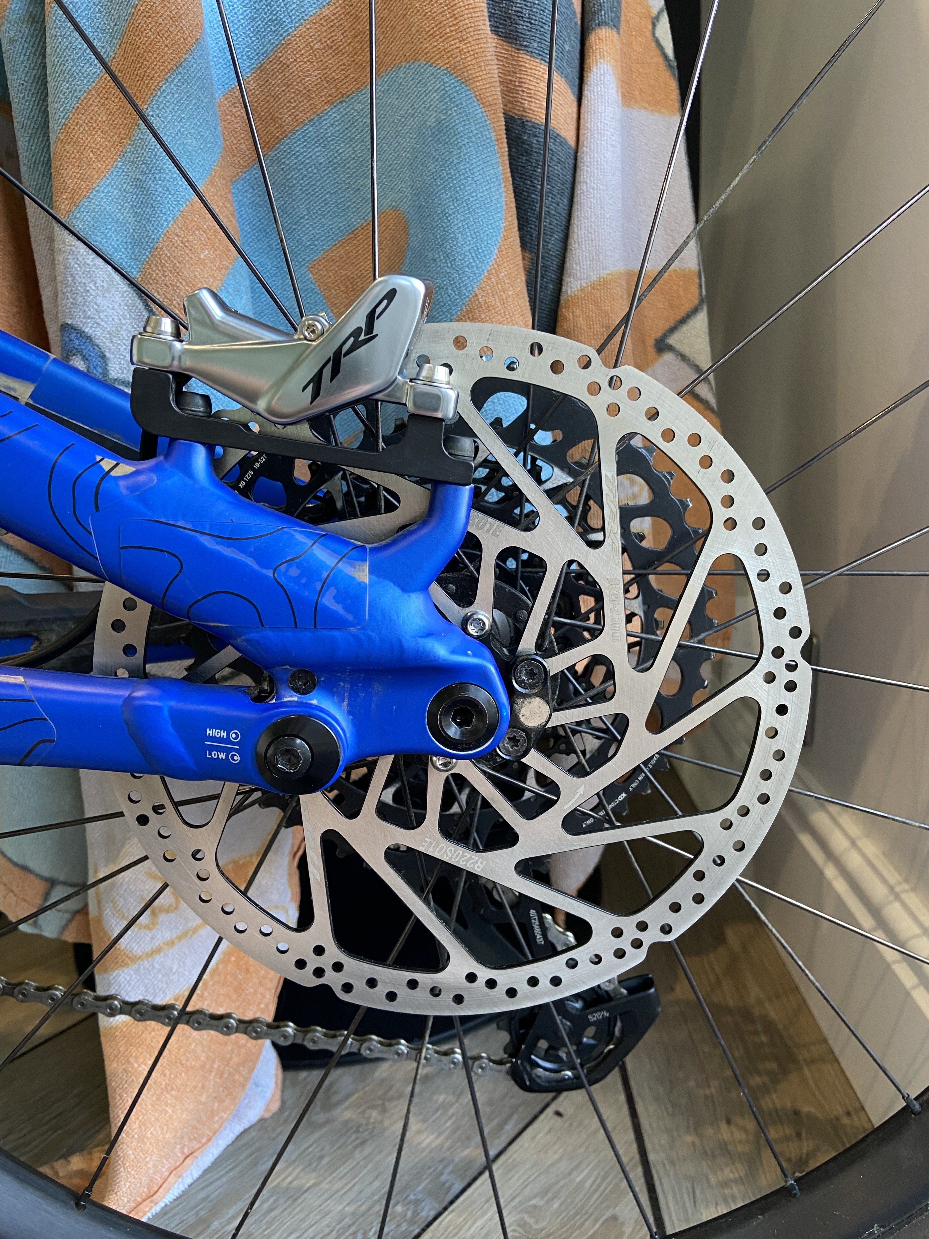

I went with some TRP DH EVO in the end with 220 rotors front and rear. I’ve read so much about all makes of brakes and the TRP get some good reviews and a lot of positive feedback for fit and forget reliability.
Only just fitted them so need to get out and bed them in before a proper ride but so far the lever feel is great and there seems to be ample stopping power.

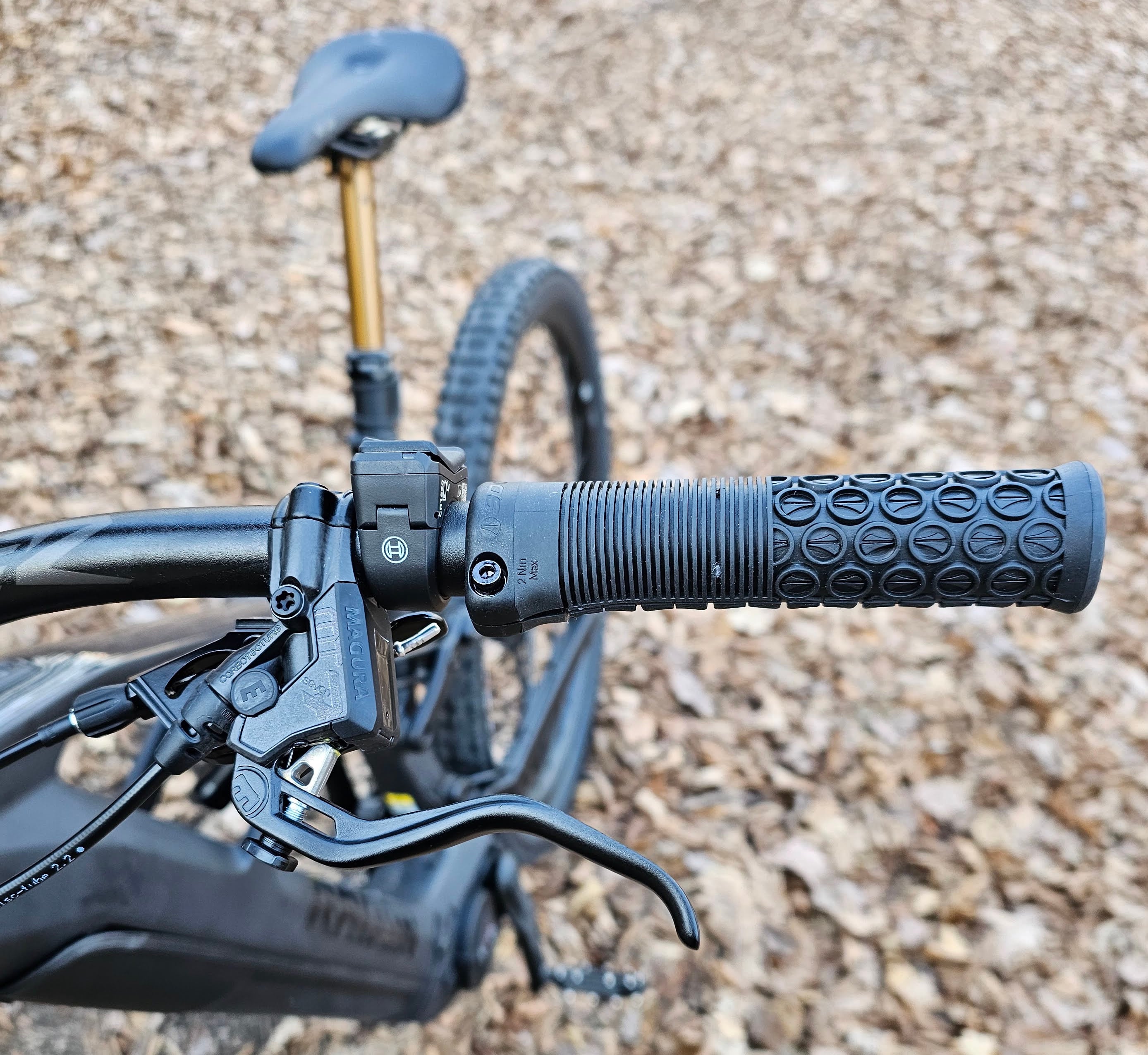

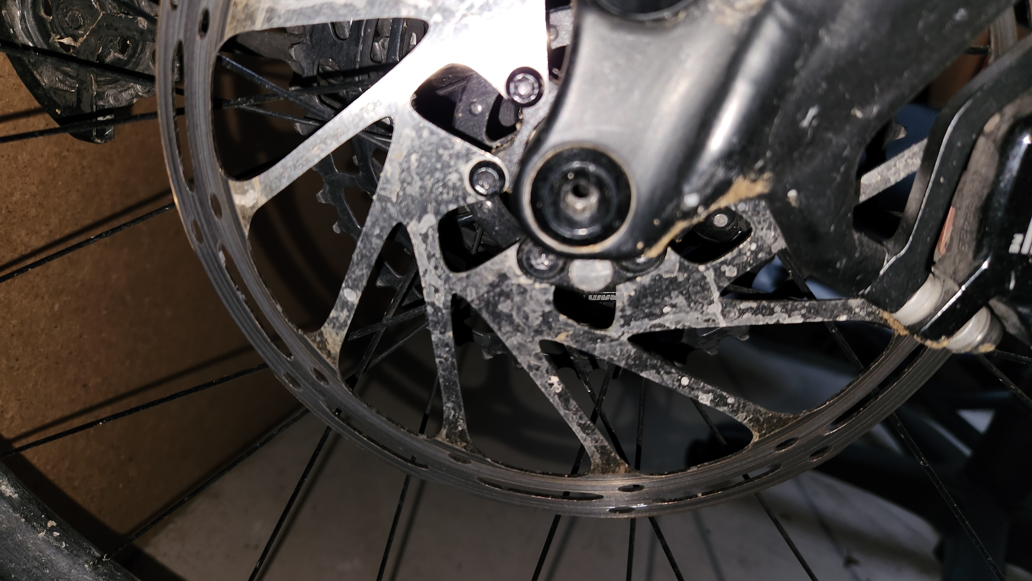

I run Shimano XTR with Hope rotors. This gives me the stopping power with a bit more modulation. I used to run the entire Hope package but felt like the Hope E4s required a bit more grip strength. Love the adjustability of the Hopes though. Haven’t tried their latest version of the brake yet. I personally can’t stand any of the SRAM brake products. They are heavy, seem to always make noise, and are a pain in the butt to work on.

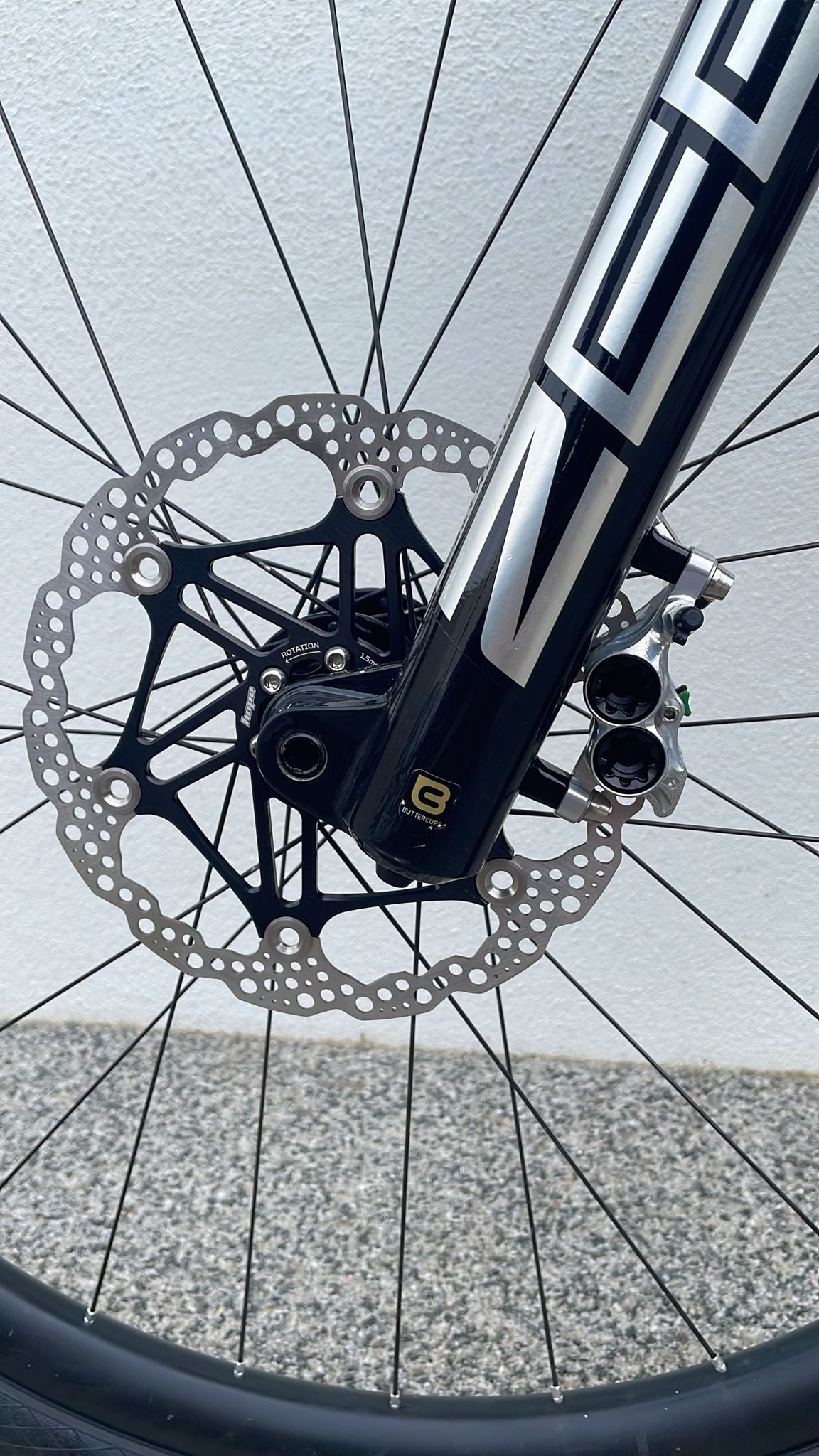

Magura MT7 220/203mm on my eMTB:

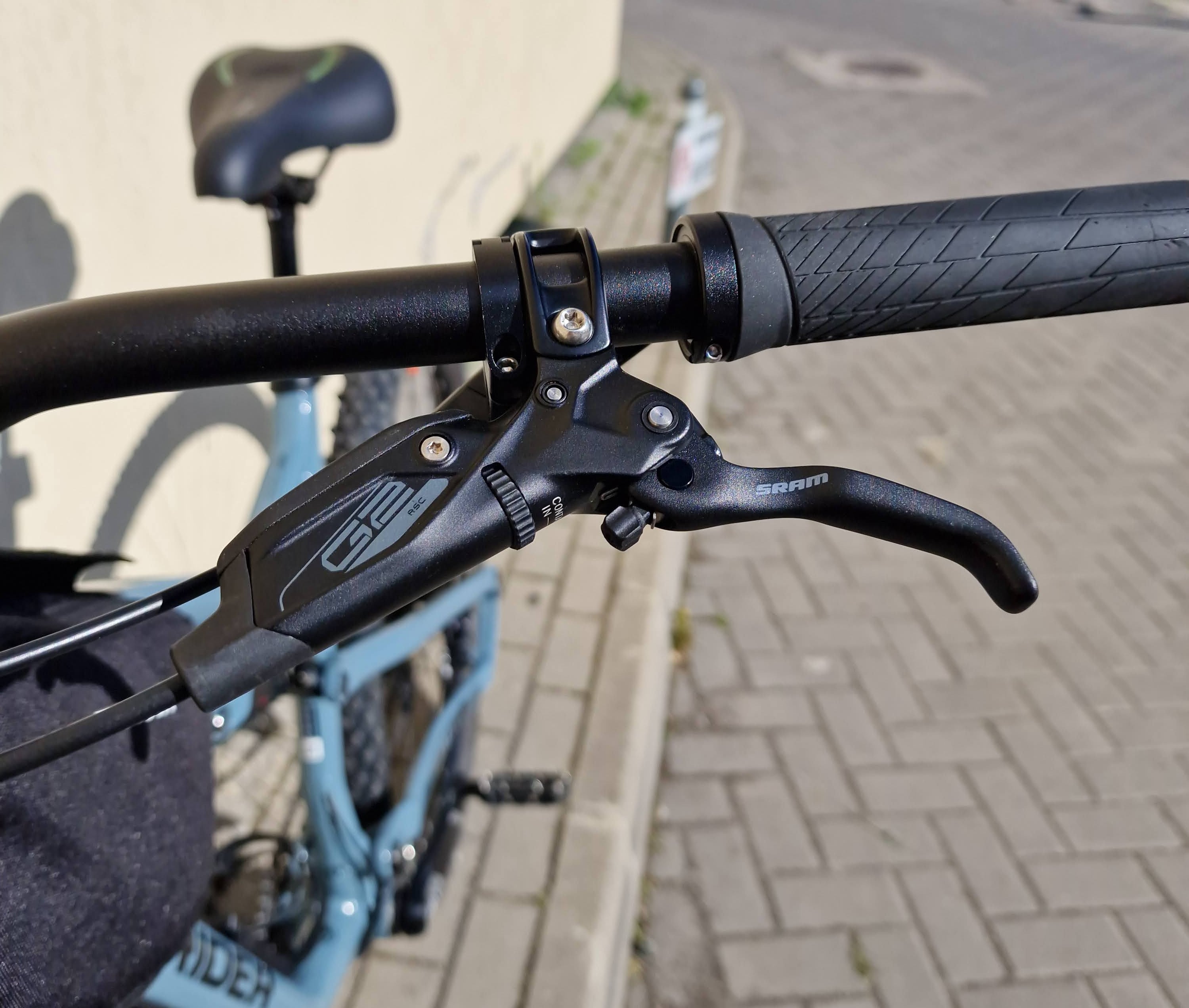

I know people don't like SRAM brakes, but I honestly didn't have problems with my G2 RSC. I've correctly setup them and they work great. They might have a little fade on downhill runs, but nothing too bad. I'm also a lightweight rider, so maybe that's why I don't see any problems with them. I really like the feel of them on normal descends.
I like the SRAM G2 RSC, but I love the Magura MT7. They are great. Exceptional power. I didn't have the chance to test them enough yet, but after 5 rides, I love them.
If you are looking for low maintenance and longevity you have to use the biggest diameter rotors (220mm or 223mm?) and calipers with biggest contact area brake pads with sintered metal compound. Magura quad piston calipers offer probably the biggest brake pads.

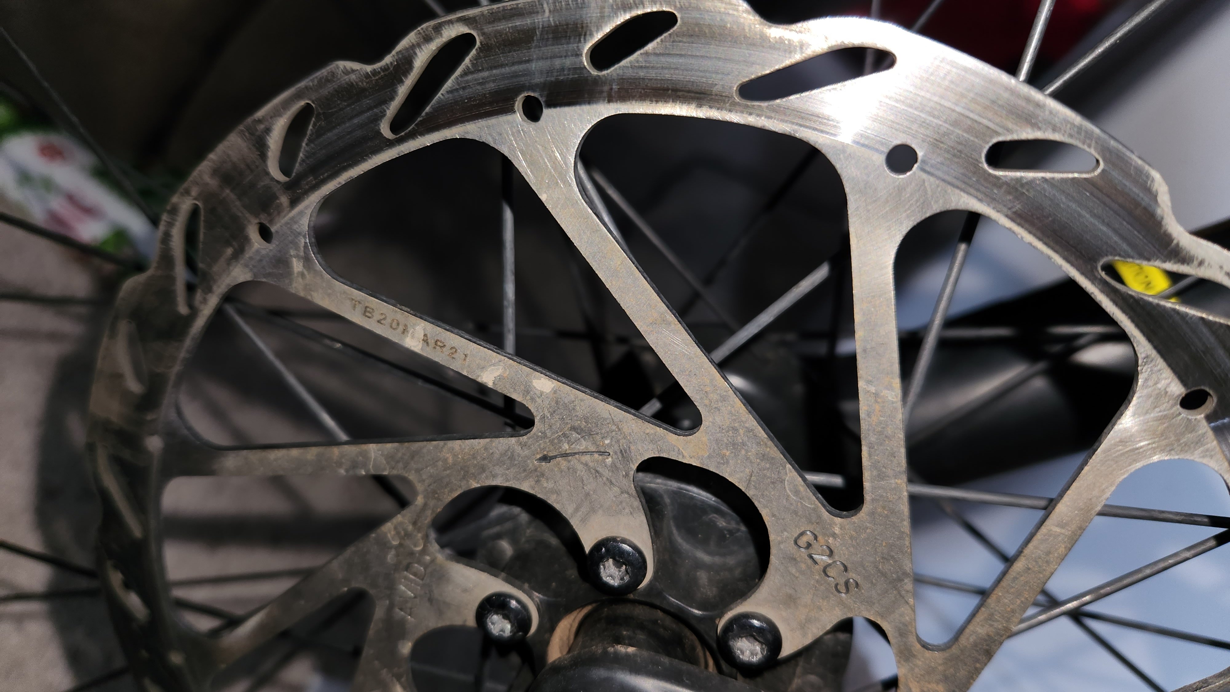

shimano br mt420s they came on the bike. I'd say they stop well but the levers are kinda meh. I've had an issue with the rear brake lever, currently its stick and not returning, Im guessing it needs a bleed. I switched to mtx gold pads so that helped too.
Also the rear brake seized on me a few times on really long descents. The lever basically jacked up and the rear brake would make loud vibrating noises and the lever wouldnt pull in much at all. Maybe it was getting overheated?

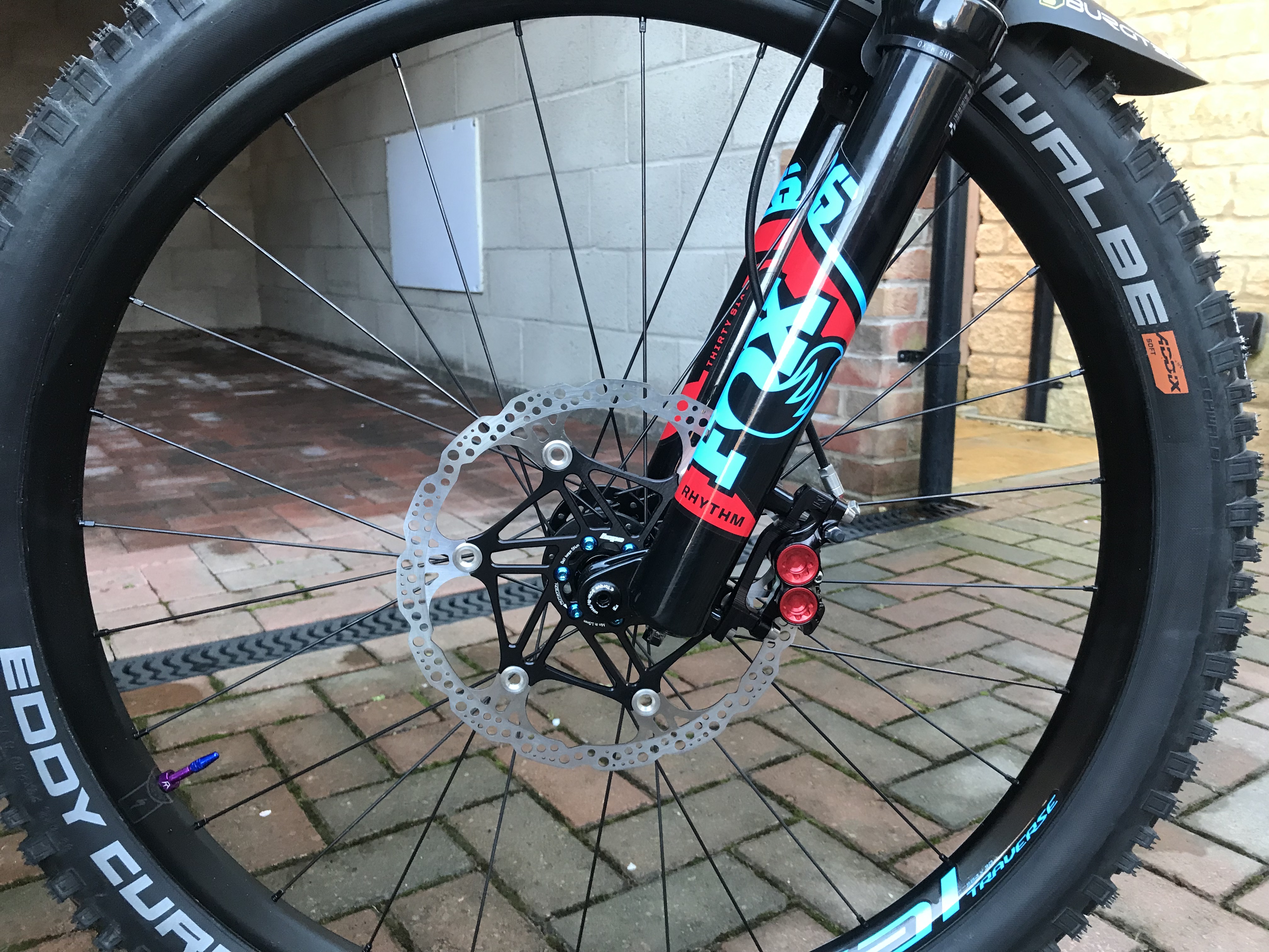

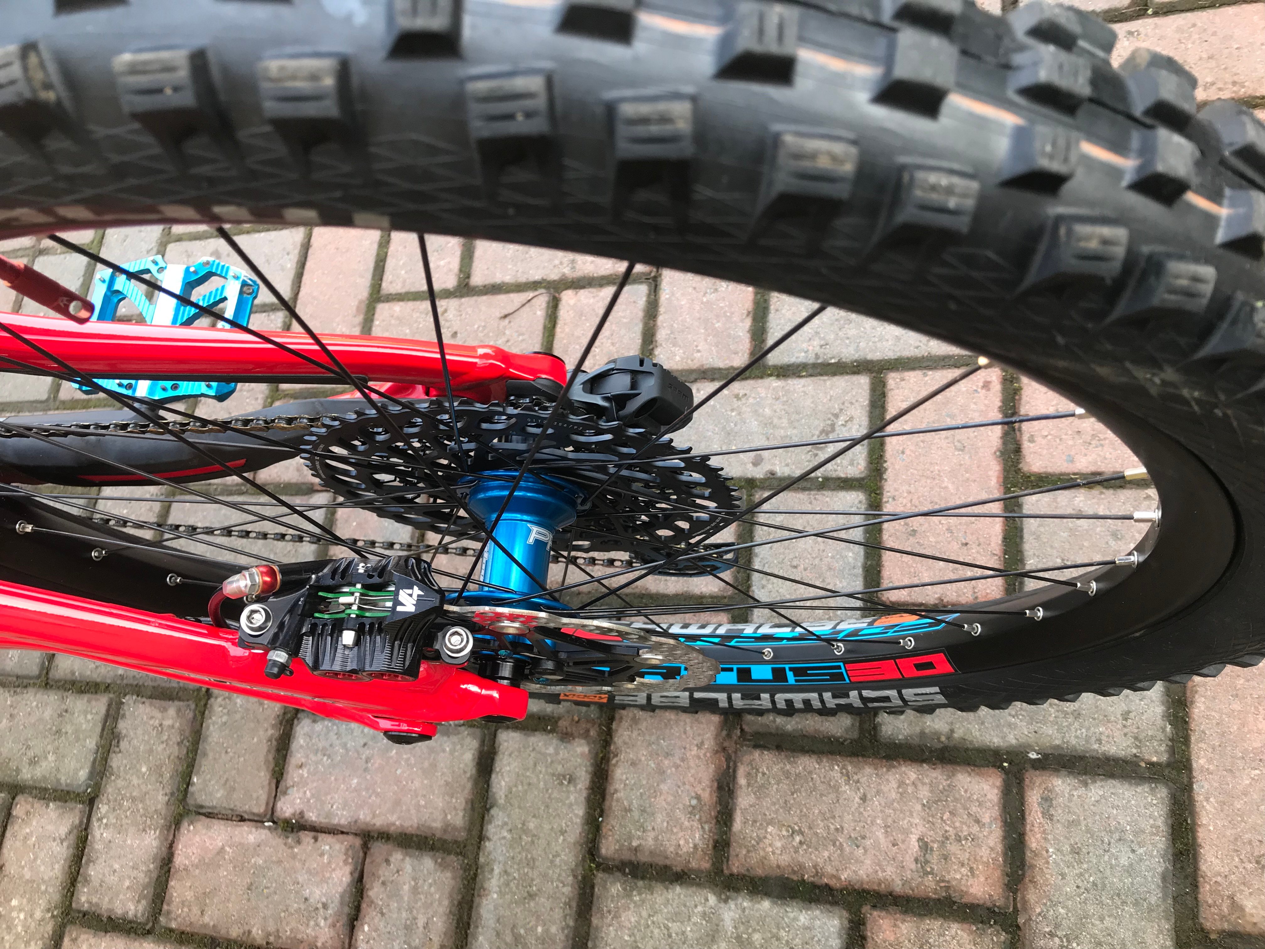

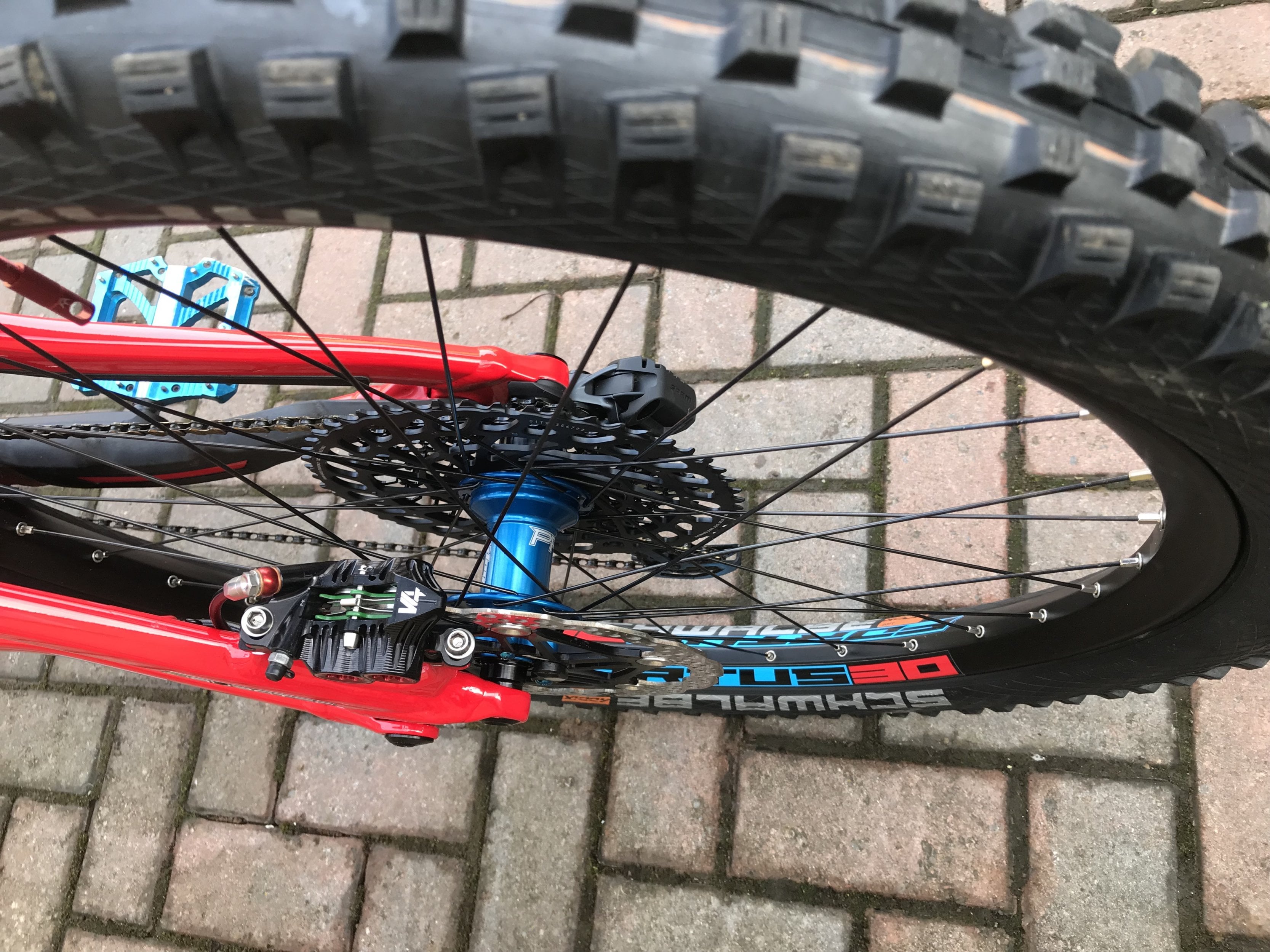

Loving the Hope V4’s, running them with the purple Ebike pads and heavy duty 2.3 discs, 220 & 200. Nice feel and great adjustment for reach and bite point.
